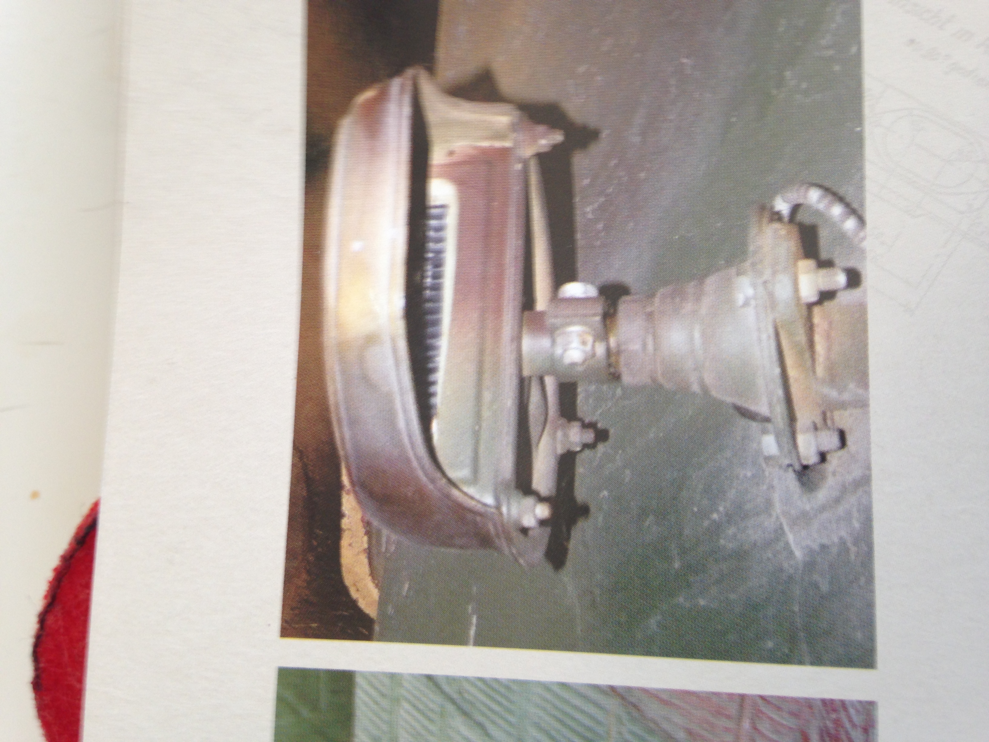

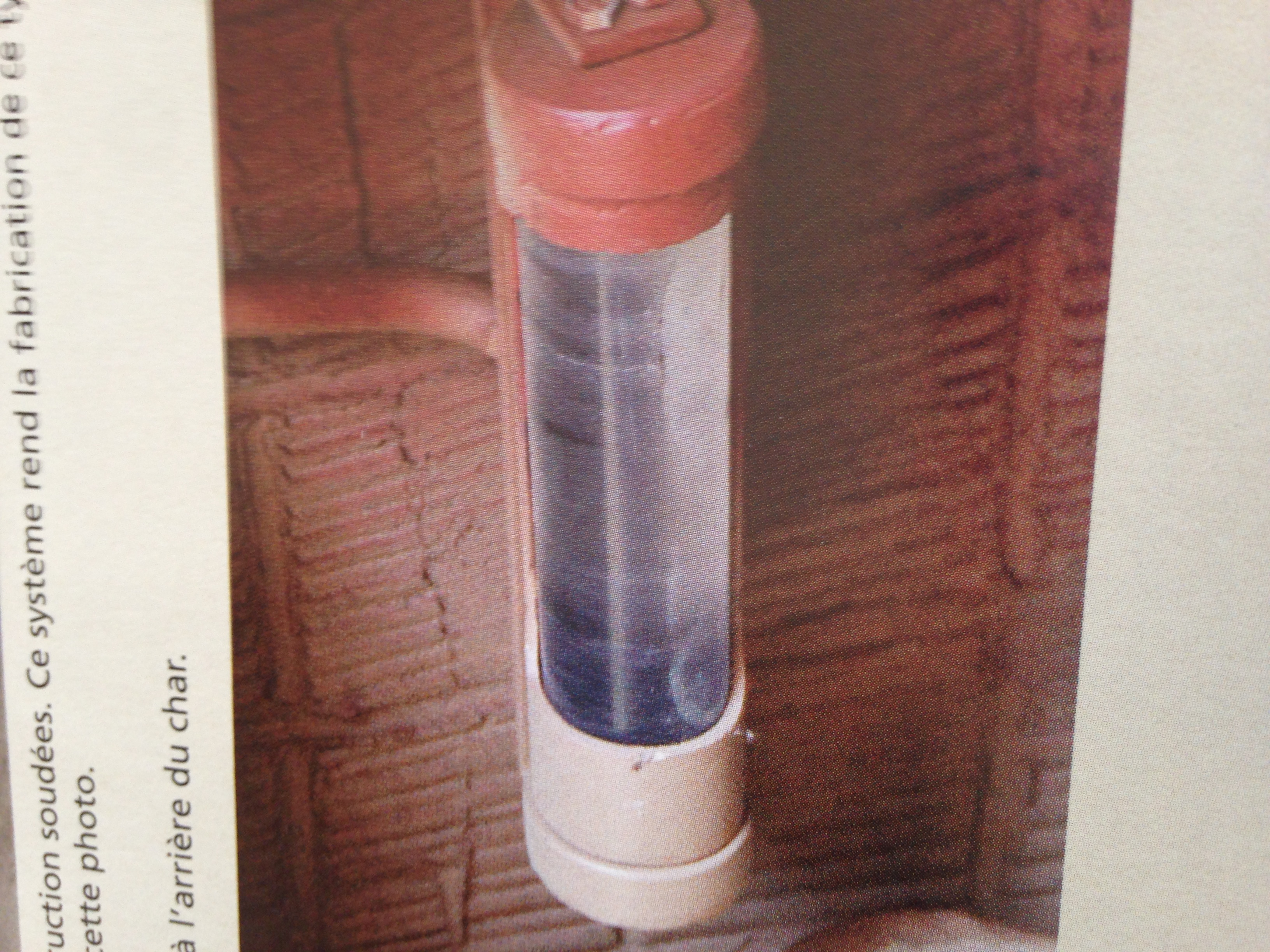

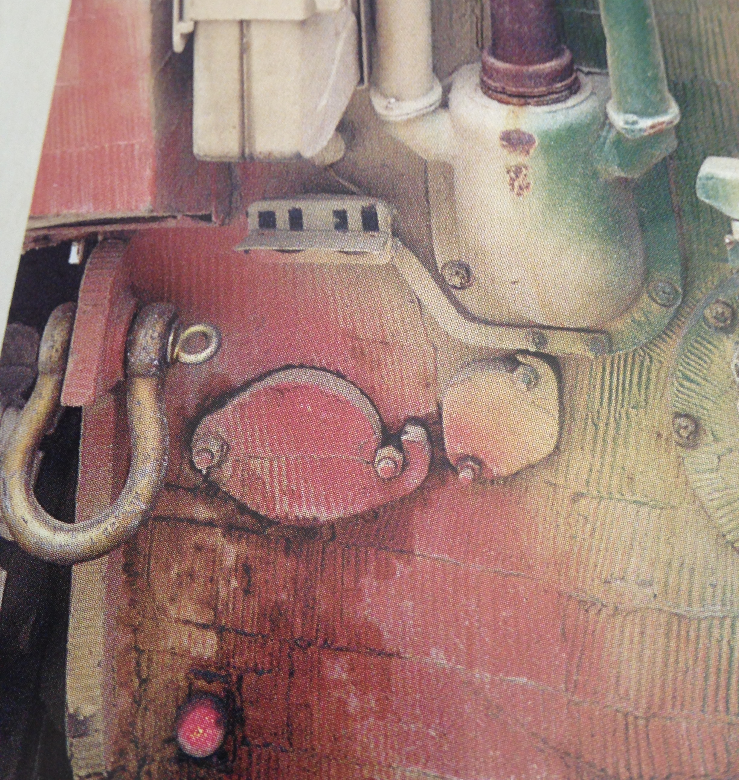

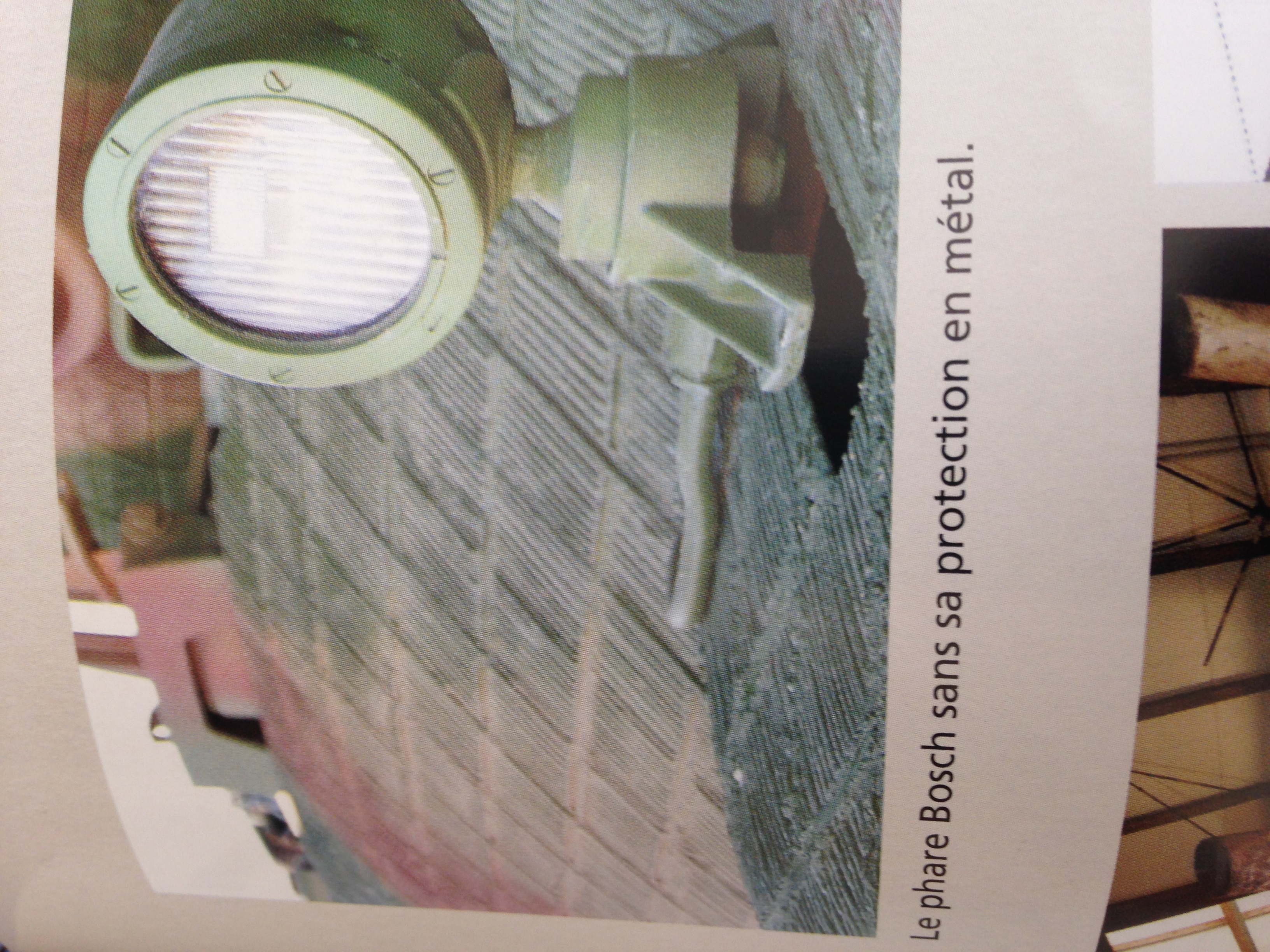

Good morning,
for info, photos of convoy fires, and others on Panther, seems different depending on the type of tank, or can be supply? I read somewhere that there was a particular suggestion, depending on what the follower tank saw to light up, color and placement, in the case of the first photo, or the tube system, also comprising for some 4 compartments
Headlight and Notek
