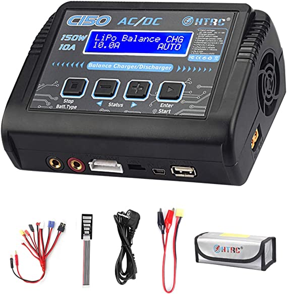

Hello,
normal nimh charger? yes, but is this a so-called "intelligent" charger? that is to say which takes care of all the necessary parameters, depending on the type of battery? A 5000 Ah battery is charged to 1/10 of its capacity, i.e. 500 Mah and this is equivalent to a minimum of 15 hrs of charge,
regular charger
Charger, called Intelligent
Elmod is designed to work with different types of batteries and voltage, in the case of Lipo, there is a so-called "Cut Off" system which will cut the power supply below a certain voltage, in order not to damage this type. of batteries? hence my question: have you programmed correctly, the type and the voltage? very often the first breakdowns are due to battery charge problems!!!
