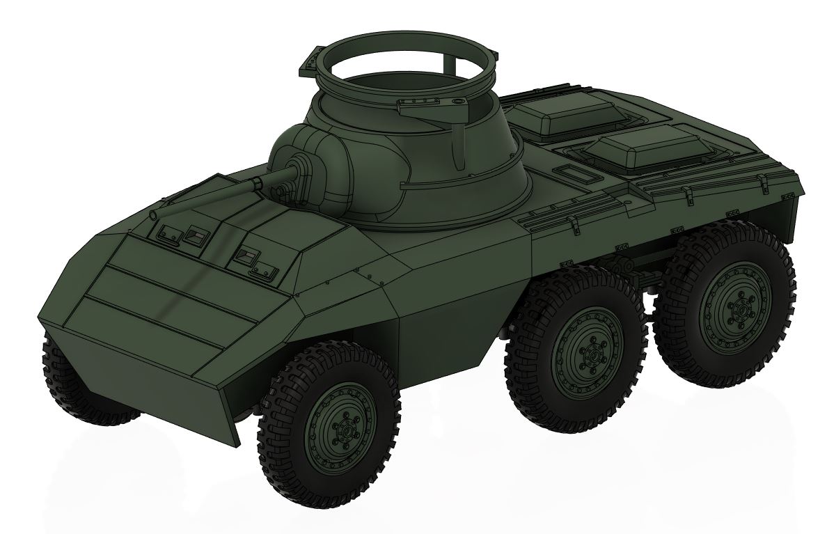

For my first vehicle I have decided to do an armoured car, mainly because I think designing my own tracks and idlers etc is a little ambitious, but I also want to be able to have a turret and cannon. I decided on the M8 Greyhound because it has a relatively simple shape, and due to its mostly small size it should be easy to print. I've also been inspired by the story of one of these supposedly managing to destroy a Tiger.
I imagine most of you know what the vehicle looks like but I'll attach a photo anyway to demonstrate the rendition that I'm aiming for (with both the front and the rear side skirts fitted, as well as a rear mounted 50 cal):
More to follow soon.

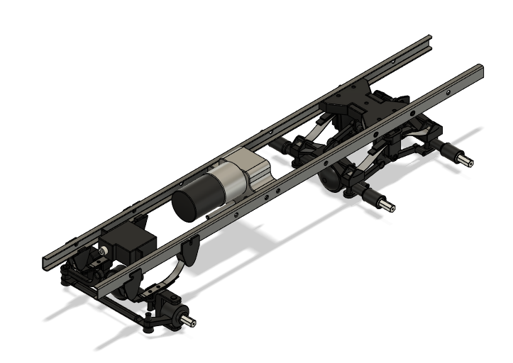

I'm going to use a WPL B16 for the base, and so designing starts with a crude but good enough mock-up of the chassis. This took me much longer than I would like to admit, but for an accurate print I needed to make one.

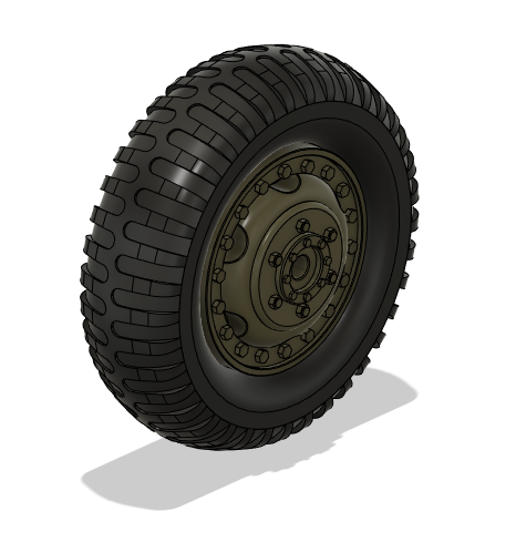

Here is the current state of the rim and tyre. I'll add hub caps later but I'm too lazy at the moment.

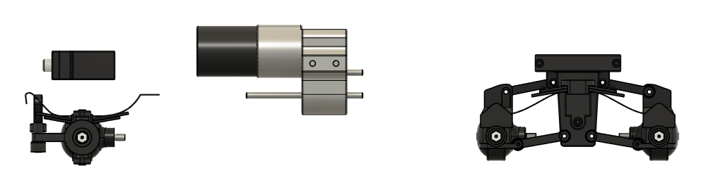

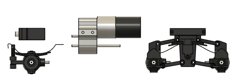

Once the axles are aligned with the blueprints it's very easy to see just how close they are to each other. Here are the axles in their normal arrangement:
Compared to how they are aligned with the blueprints:

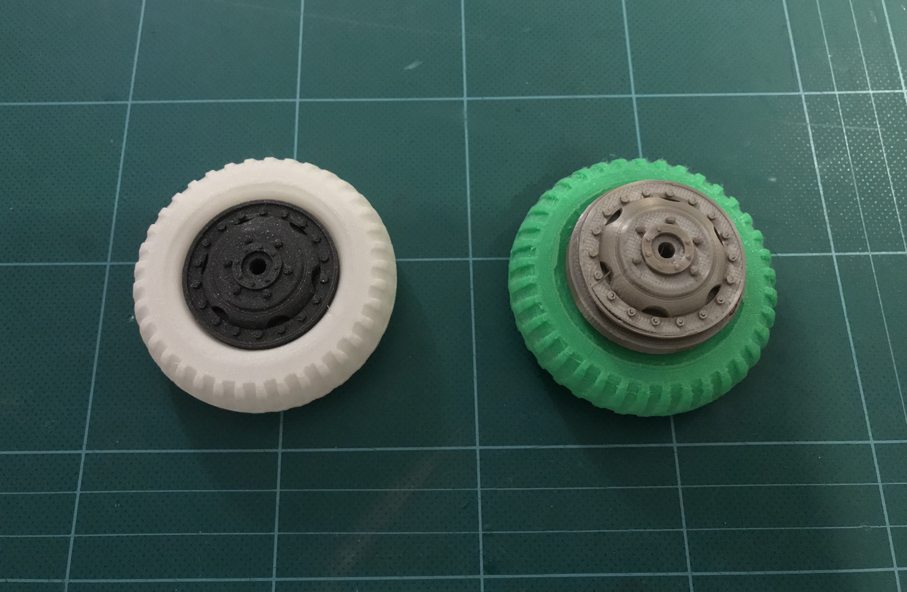

Here are a couple test prints of the wheels. Green and green is version 1, and black and white is version 2. Both rims are printed in PLA, and both tyres are printed in TPU.
Unfortunately, I still can't get the wheels to fit onto the axles right, and so more changes will be required.
