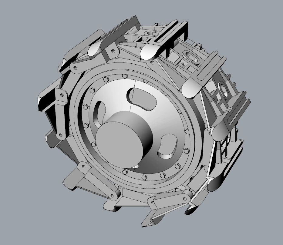

This is a Churchill Mk.IV (not AVRE) which is very rusty, but a very good candidate for photogrammetry. You can find it a Colleville-Montgomery, Hillman site.
I took about 450 pics of it and then recreate it in 3D using photogrammetry. It will be my first reference when it comes to shape, size, thickness of the part etc...
You can see the result here :
Some things to take in mind : it's missing some armor plates, top rear engine doors, it has some boggie units from a Mk.1. etc...
To help me, I get the AFV Club Churchill AVRE from my wife for Christmas. It's a very nice kit, however the photogrammetry of the real Churchill will show that AFV club is wrong in many aspects. A nice base to help me figure things though.

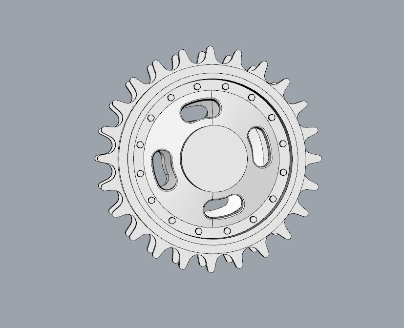

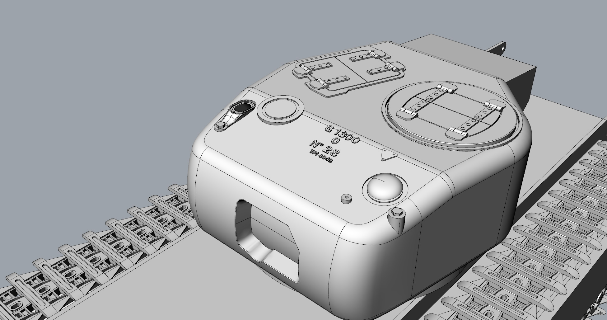

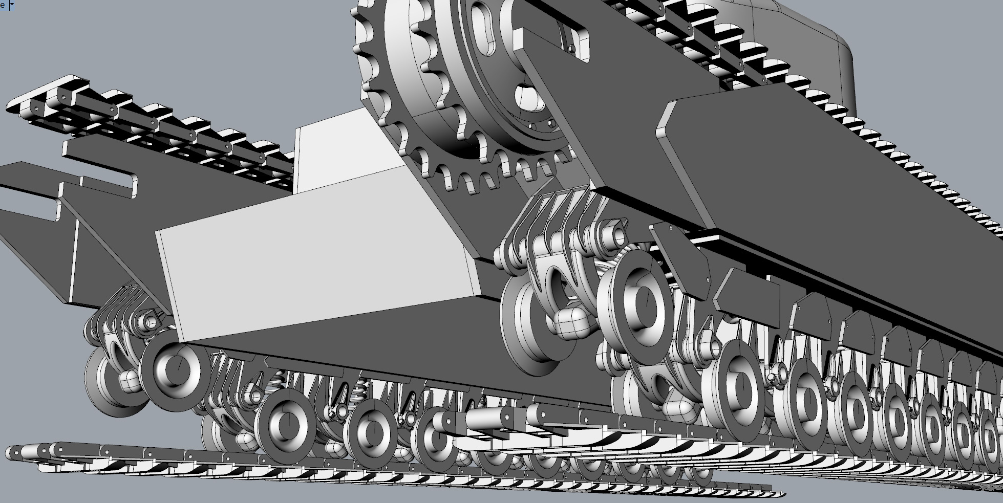

I then started to 3D model the Churchill in 3D.
You can see the first draft here, the 3D model has been greatly improved since.

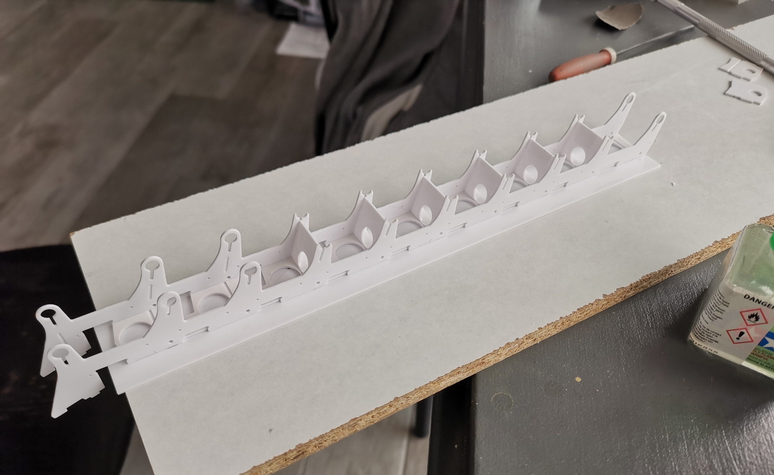

And the first styrene parts :
Left panier is more or less done, and you can see most (but not all) of the parts for the right panier.

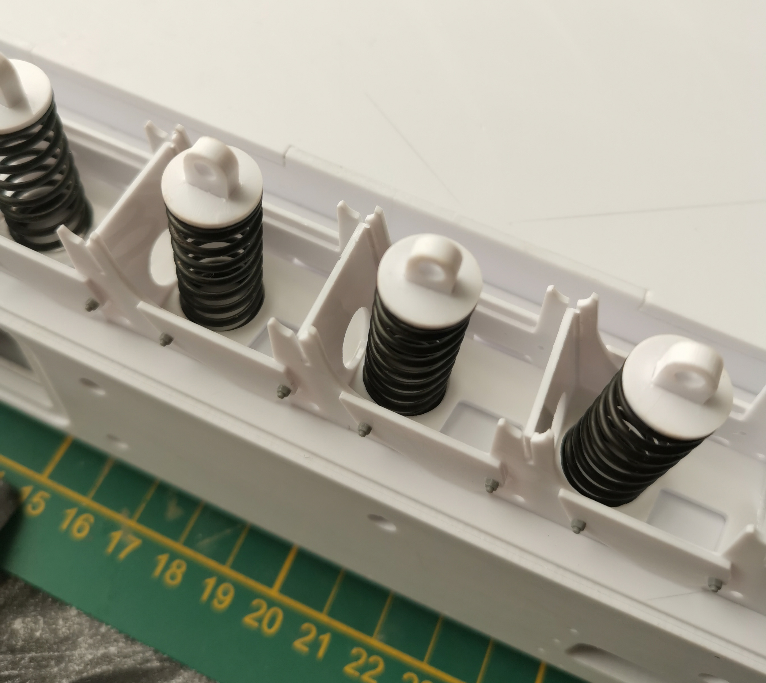

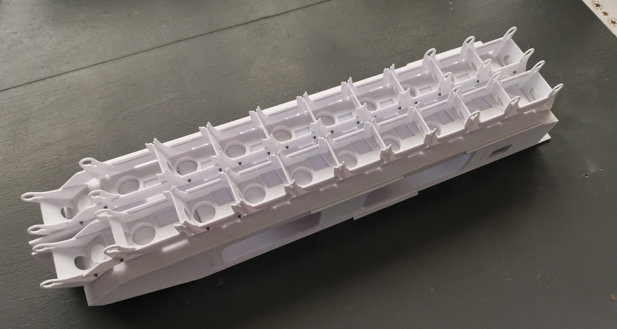

Continuing with the other side...

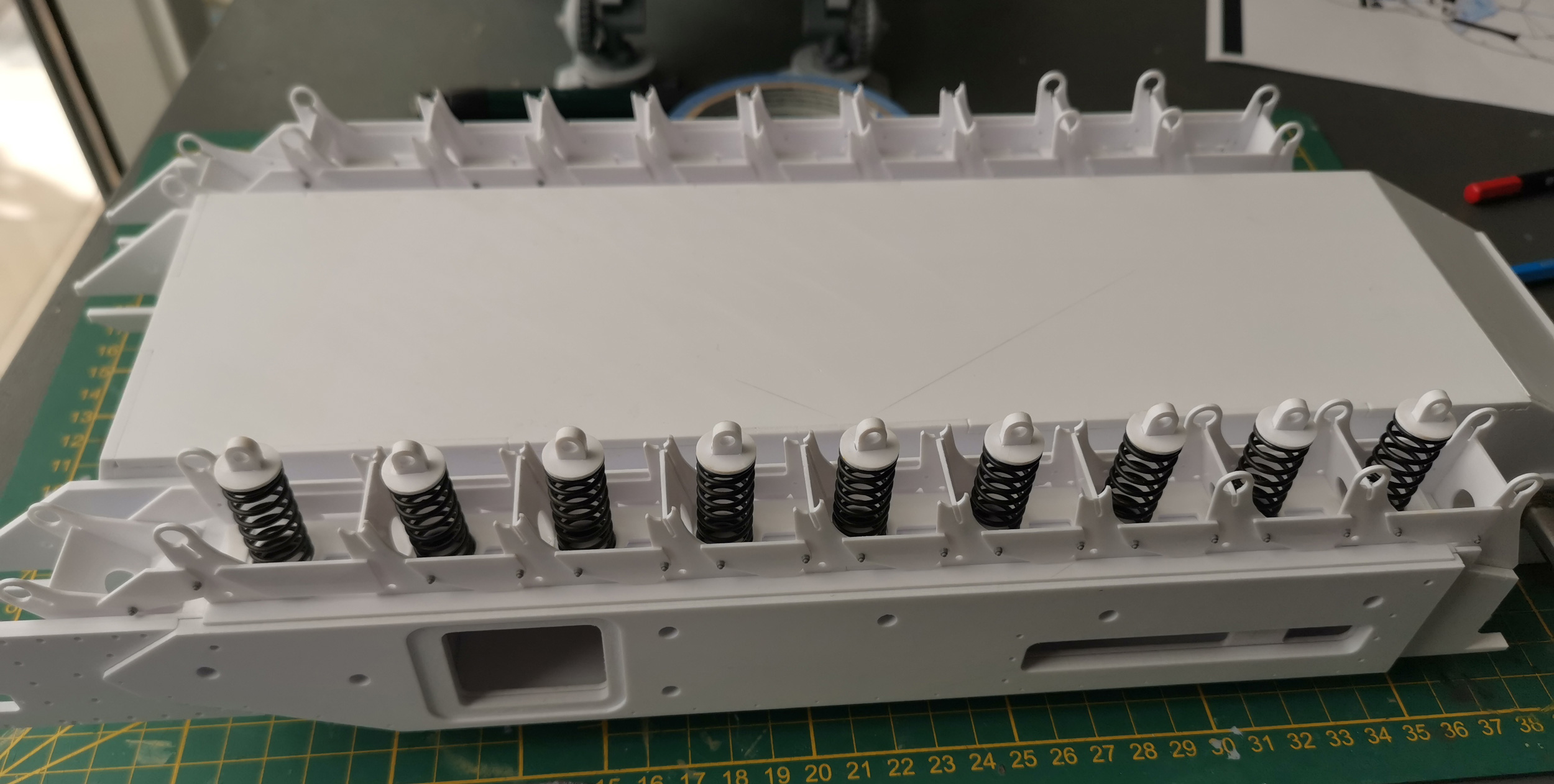

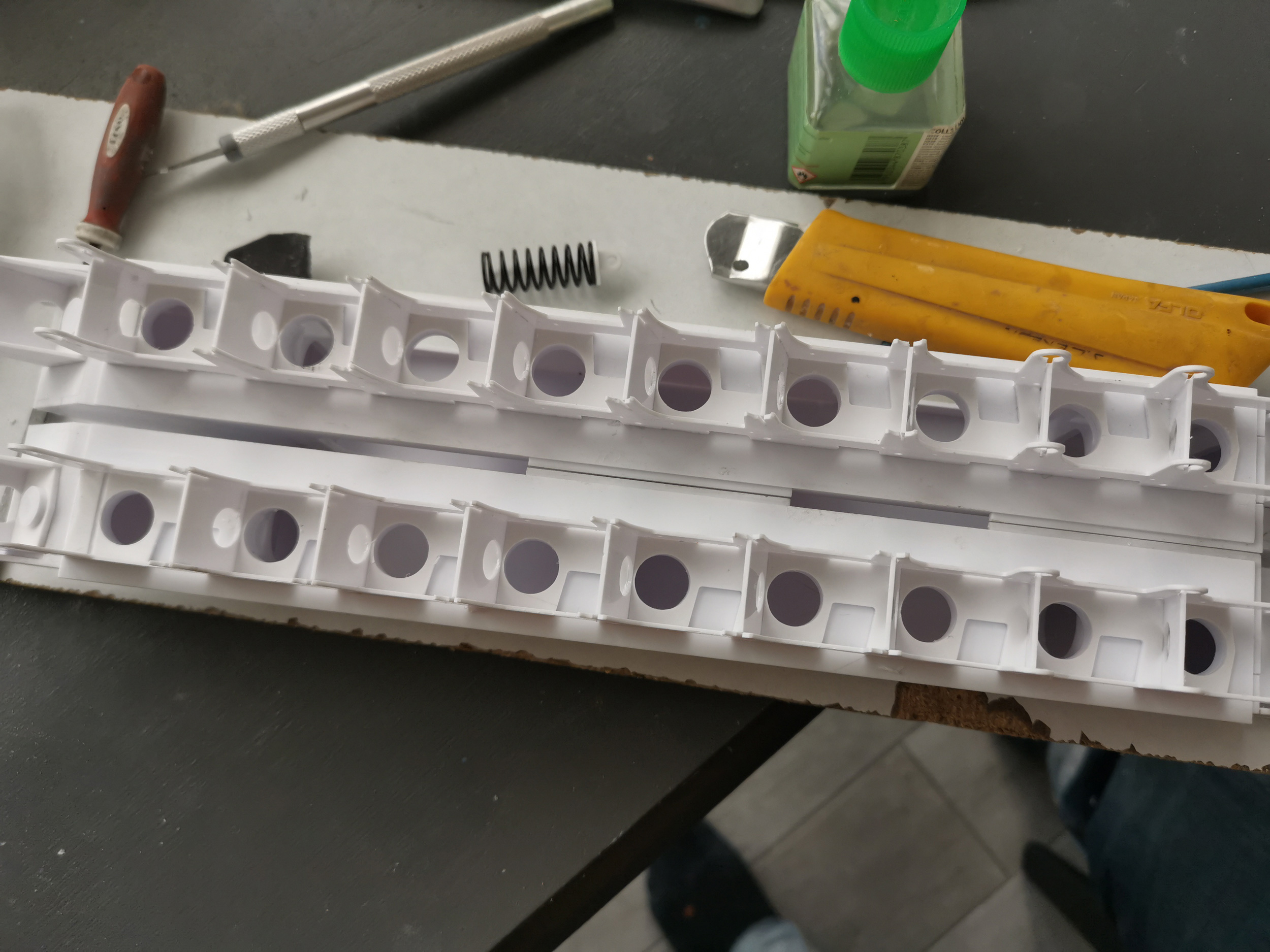

My suspension springs are bit too long so I decided to mill the location holes and add a back plate. It's now 4 mm deeper but I guess it won't be enough and the suspension would be too hard. I'm not sure if I buy some shorter springs or if Im going to cut them yet...
Deeper holes :
With the suspension springs in place :
The small plates that link each boggie unit of the real Churchill (on mine they are just decorative as the boggie units are a single piece).
They are all bolted but on the Churchill AVRE the plate that link boggie unit 2 to boggie unit 3 is welded. I think it was the standard for the above version of the Churchill. Not all AVRE have these, some have been retrofitted after war but the one in Graye-sur-Mer had the welded plate on D-Day.
Some Meng styrene nuts are added :
Both left and right paniers are done :
Deeper holes :

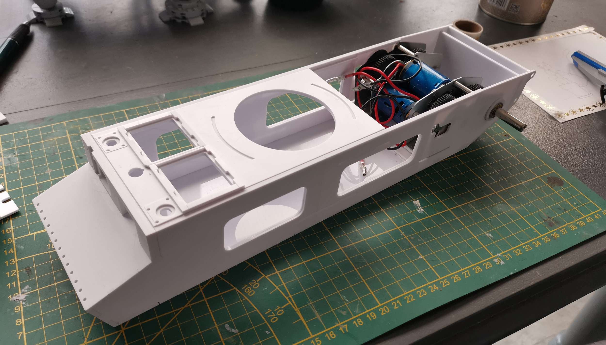

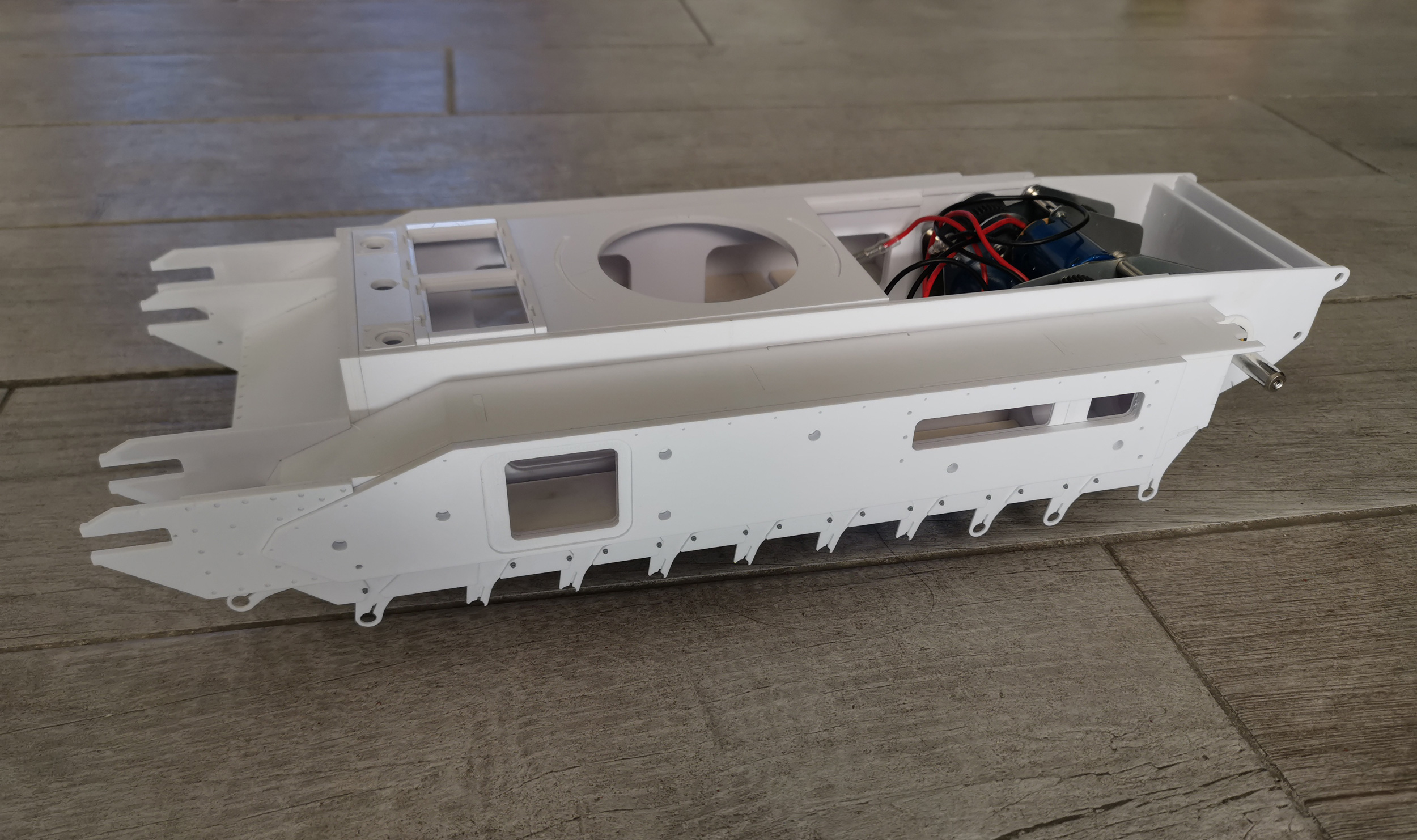

The center hull.
I milled a slot on the inner side of the side walls. This way I can insert a 3X3mm styrene profile that will support the upper deck.
The hull is quickly built.

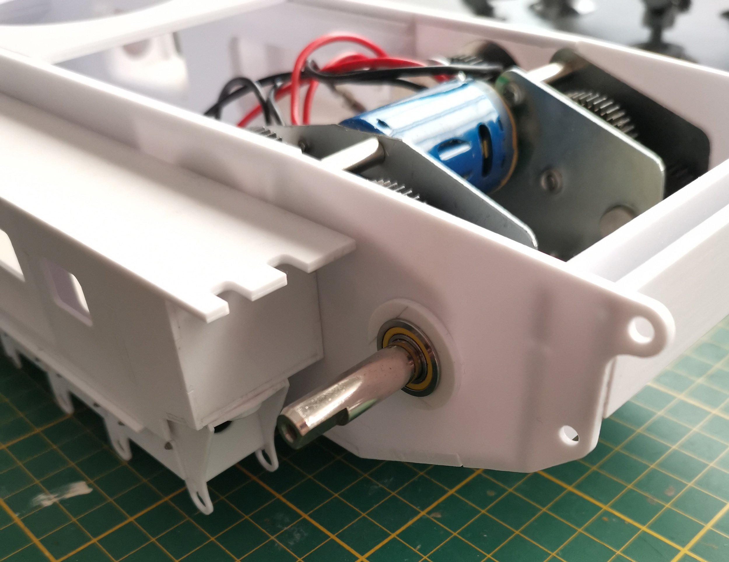

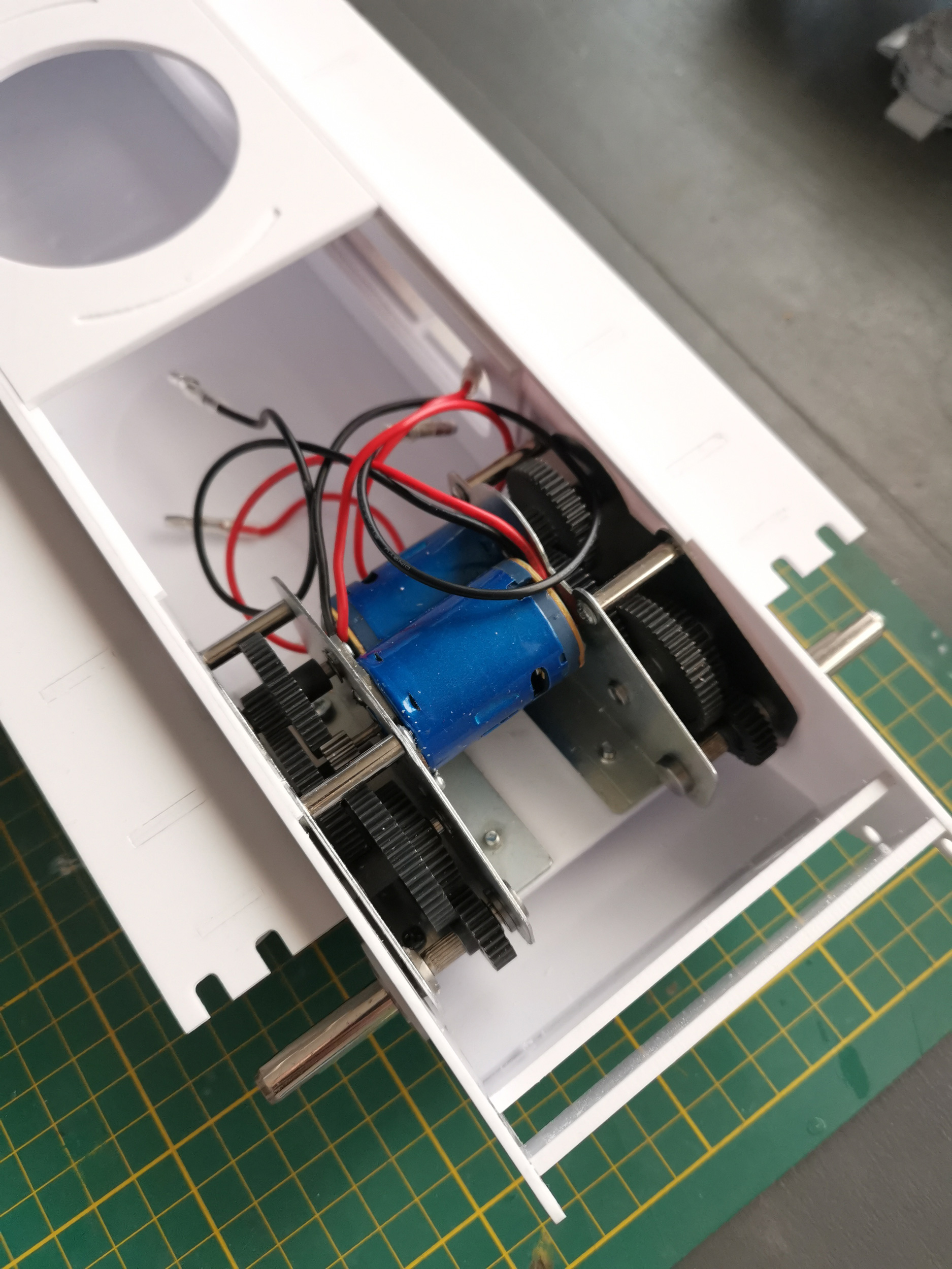

A Heng Long steel gearbox with blue motors will be used in these.
Unfortunatly I had orderer the wrong one (with the high profile motor). So I had to take a frame from plastic HL Panzer III gearbox, and switching with the steel gearbox frame. Of course I had to chance the small bushing etc... Took me more time than anticipated !
I put some ball bearings to support the shafts.

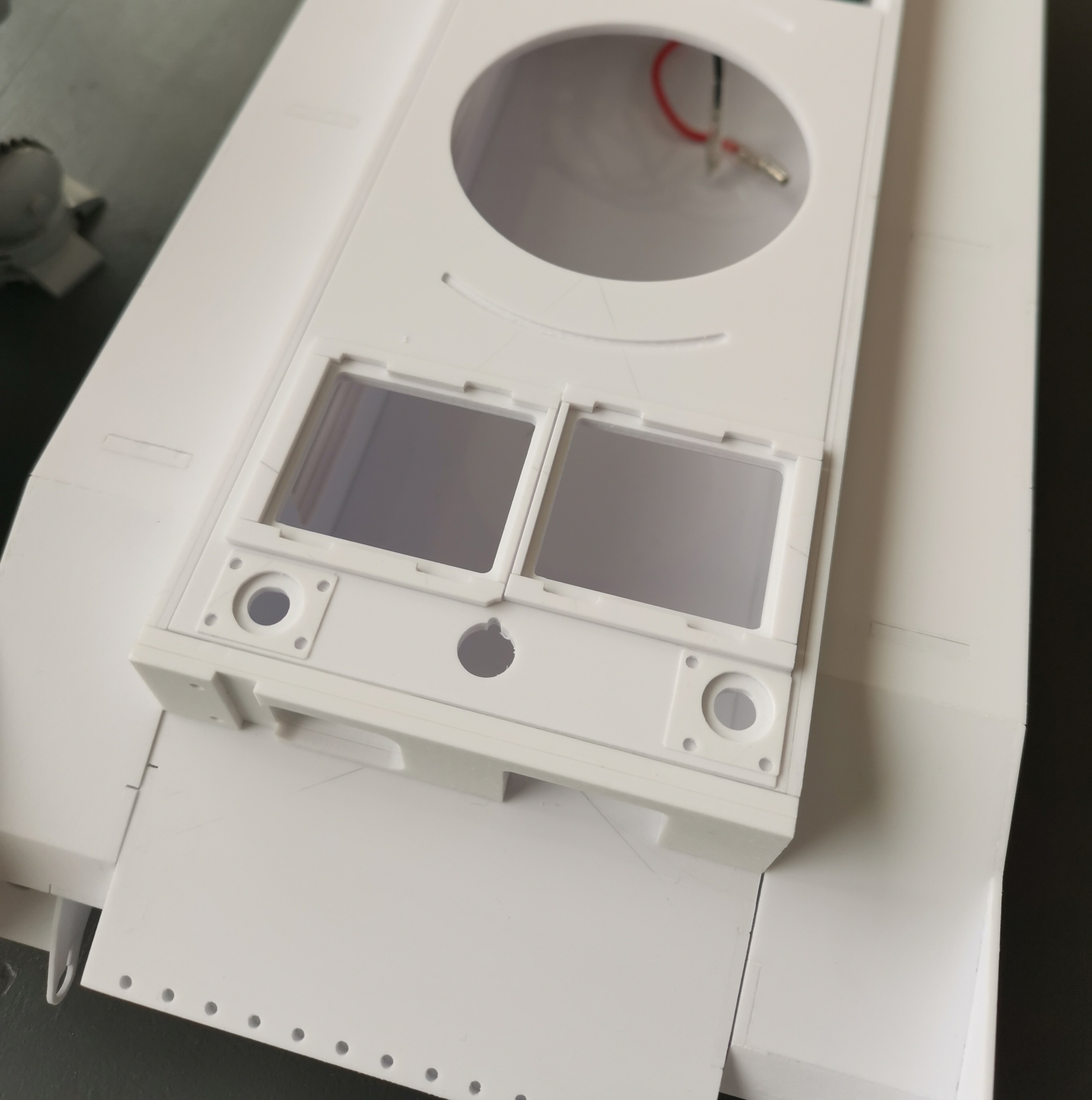

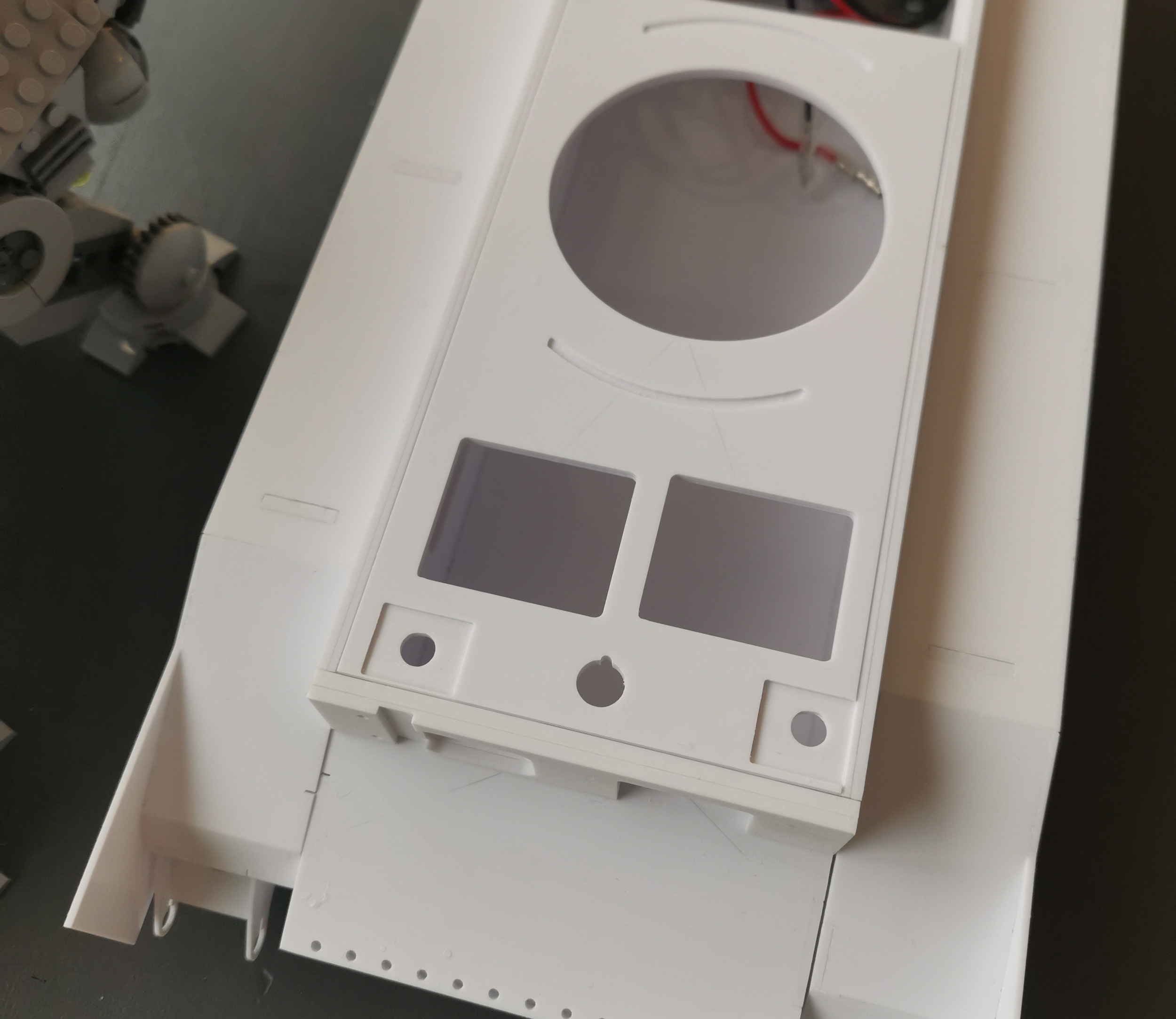

The front deck of the hull.
I relied only on my own ref pics because the AFV Club kit is not very accurate there.
Slot are milled for the episcope plates then the plates are inserted.
The frame surrounding the driver and the loader hatches are separate parts, like on the original.
Center hull :

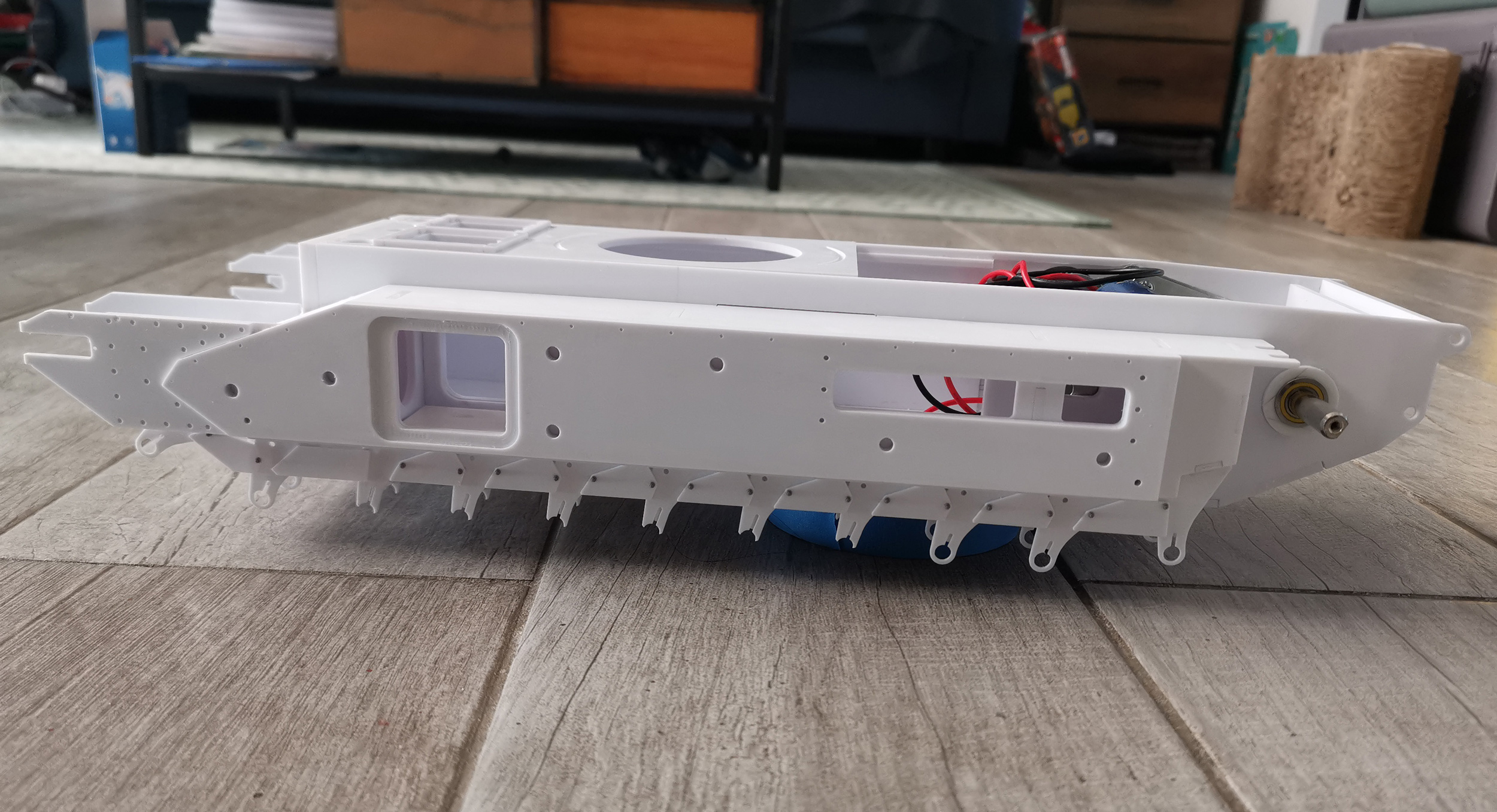

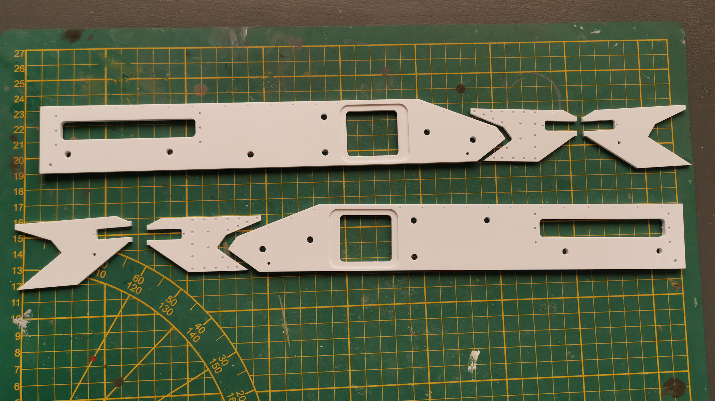

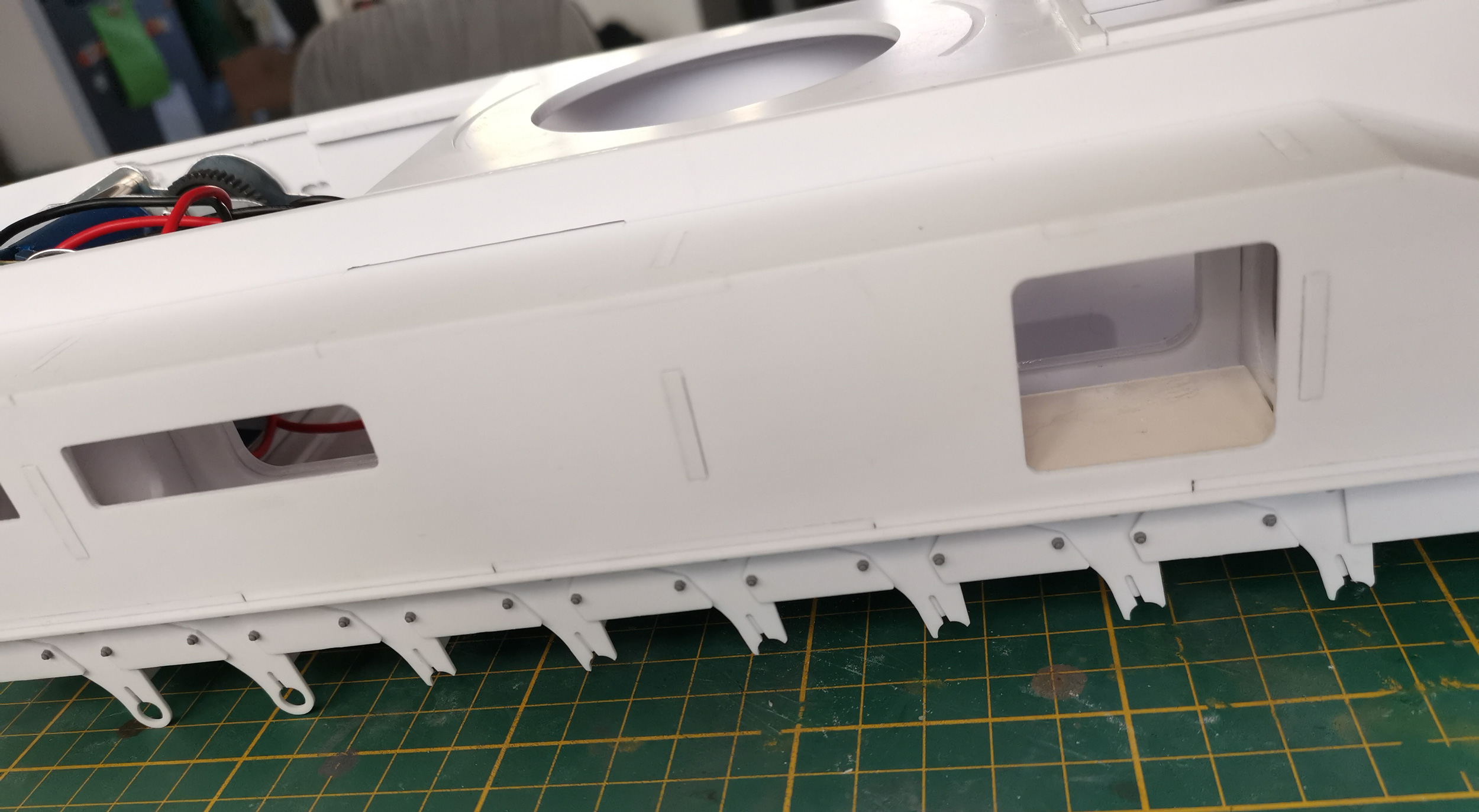

Now it's time to : assemble the side panier to the center hull, put the bolted side armor and the track tensionner plate on.
The track tensionner plate should be 2.5mm in 1/16 scale. I used a 3 mm styrene sheet that I reduced to 2.5mm with my mill.
Small holes are drilled to place the rivets. I haven't been able to find existing rivets with the correct sizes and shapes (and there are a lot of different kind on the Churchill !) so I'm going to 3D print them all.
And once everything is glued together :
Thanks for looking !
