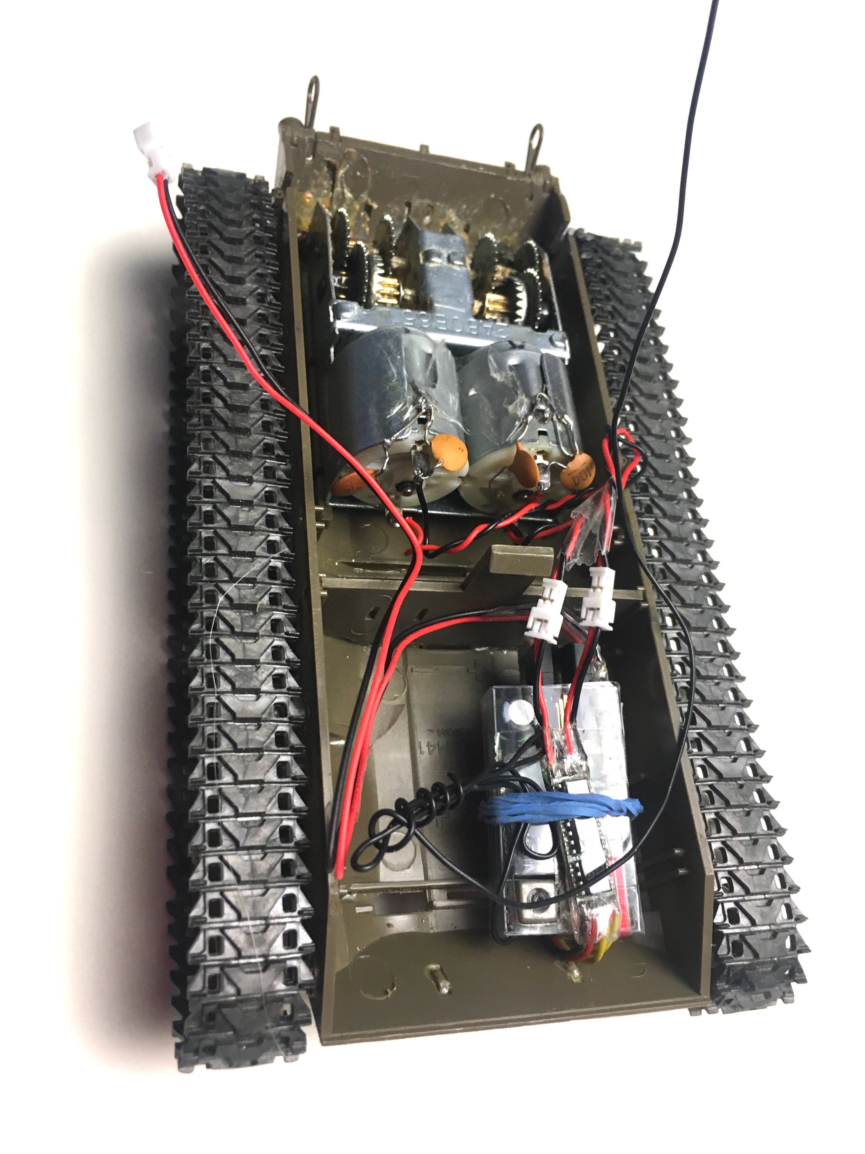

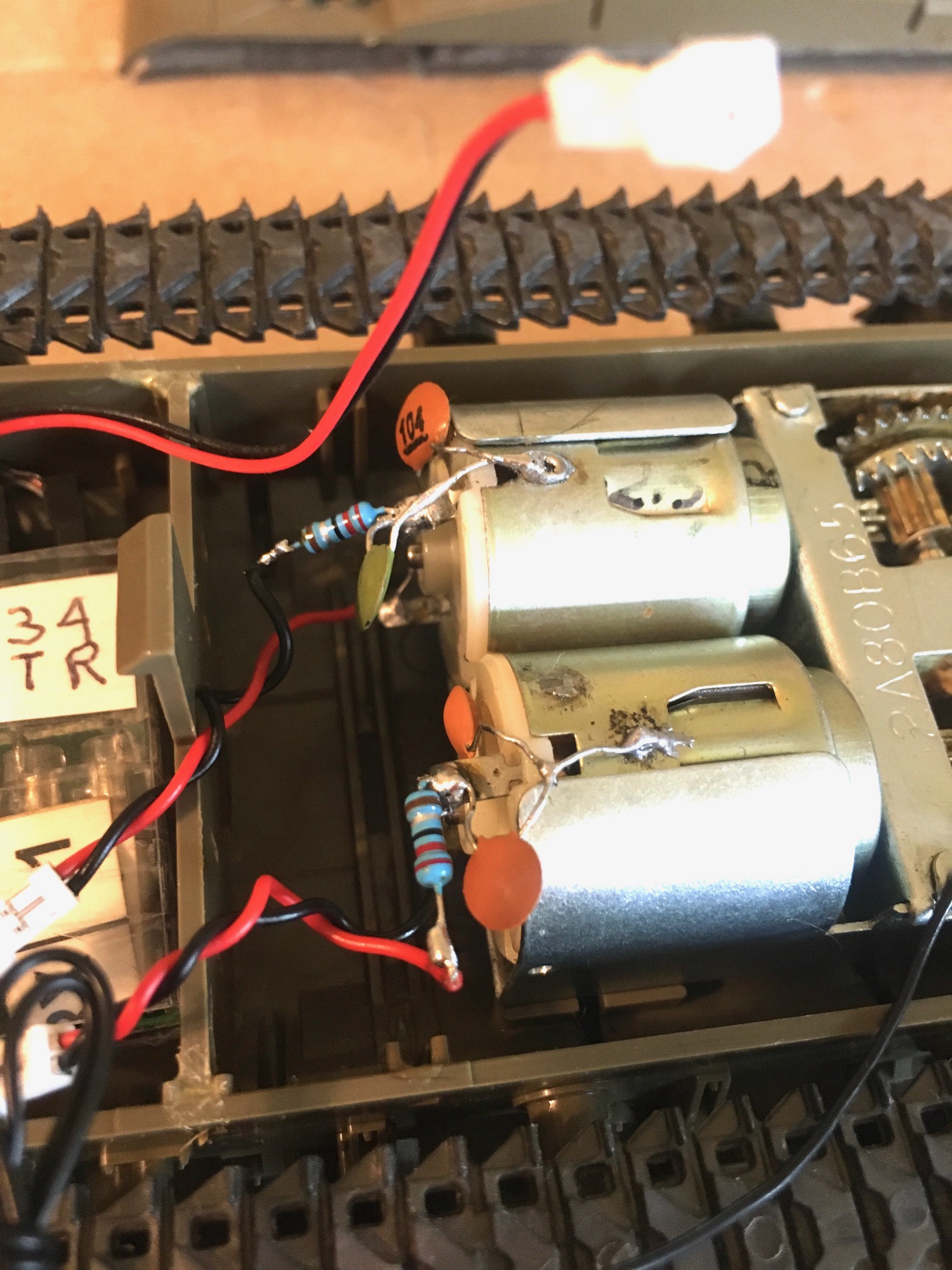

NOTE" 2 decoupling 104 capacitors per motor must be used or glitching will occur when the motors run at any speed. If further info is needed on this topic, let me know and I will do a thread on that.

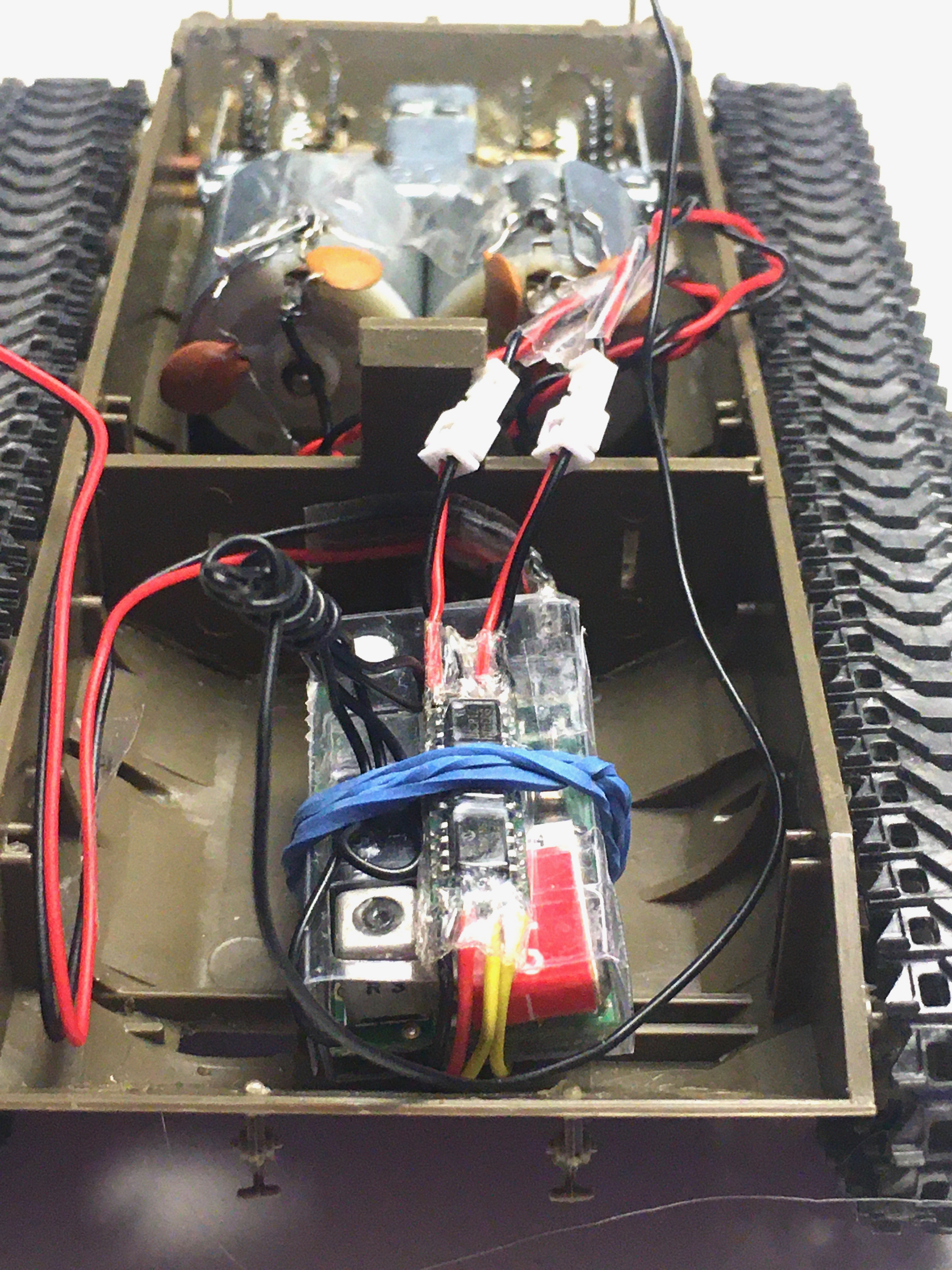

The first one to get a vintage 72 Mhz setup will be a 1\35 M41 Walker Bulldog. In this Tank I will be using a DasMikro 1s dual 2 way ECS with tank mixing.
I have been trying for quite a while to get this DasMikro 1s dual ESC to work with DSM radio gear. I thought these ESC's were bad as all 4 that I bought on ebay refused to work and I even tried to get my money back from the ebay seller but he refused (the ad does not mention incompatibility with Spektrum R\C gear) so I kept trying and then tried it with Legacy 72 Mhz radio gear and all the sudden they work with this old gear. I will talk further about the DasMicro dual ESC in the future in a separate thread.
So I will be using all 4 of these ESC's with 72 Mhz receivers in this thread.
These only work with POSITIVE SHIFT 72 mhz Transmitters!!! I have not been able to get these Das Mikro ESC's to work with DSM Specktrum Transmitters!!!

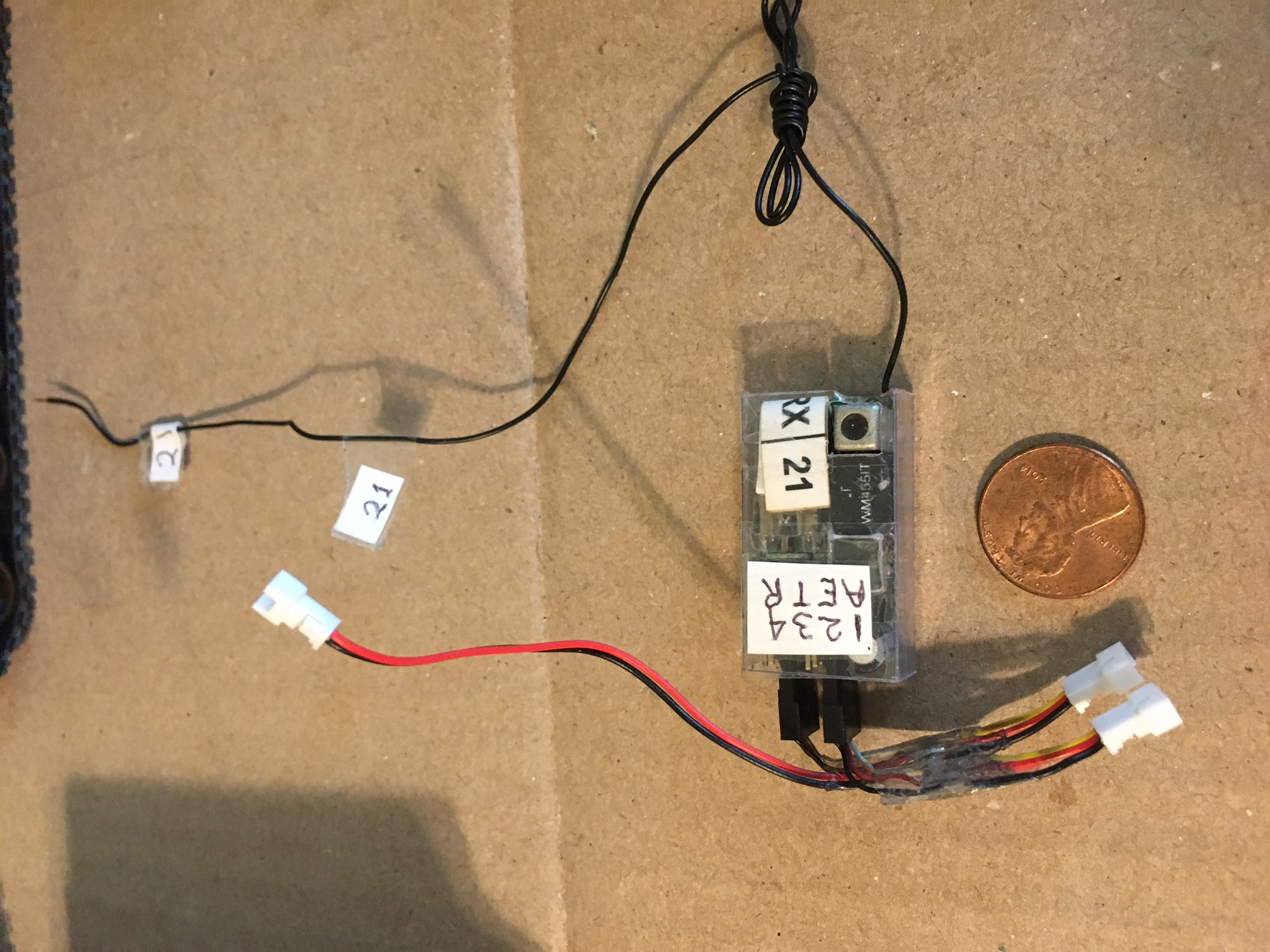

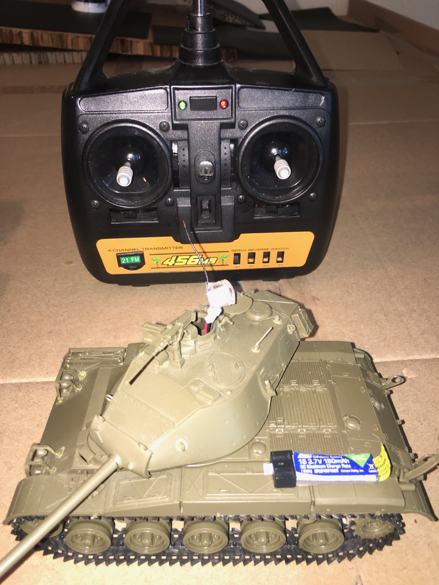

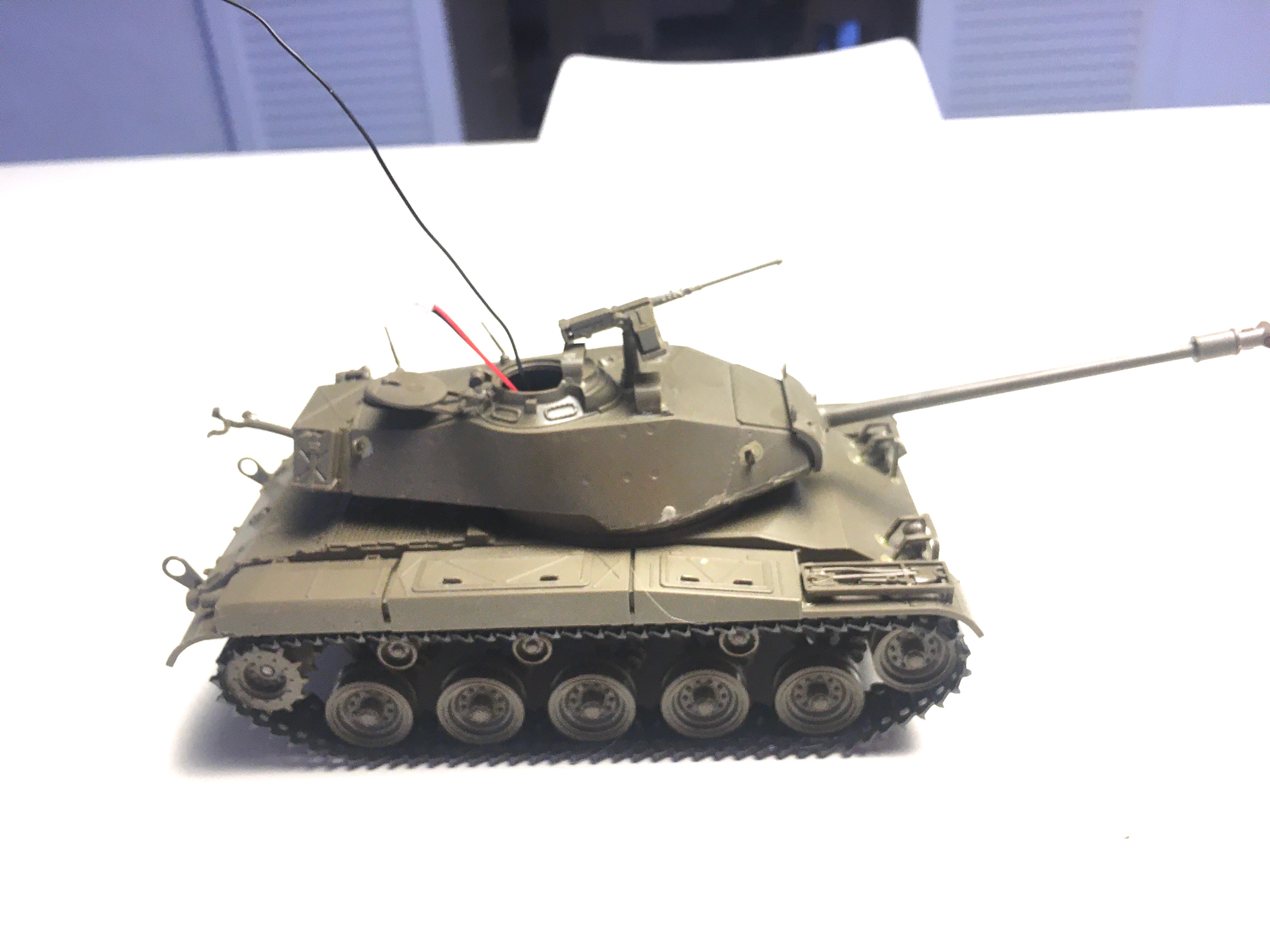

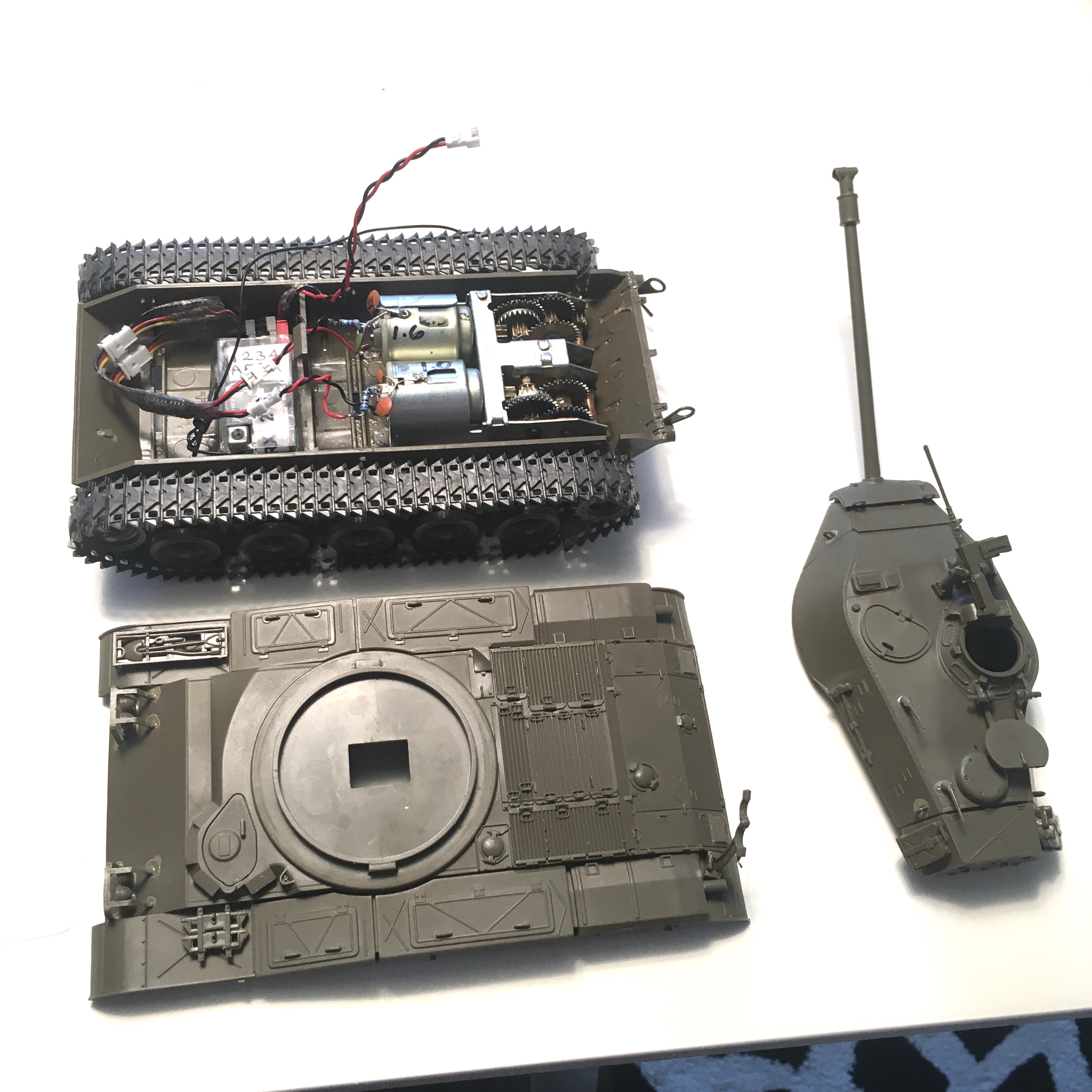

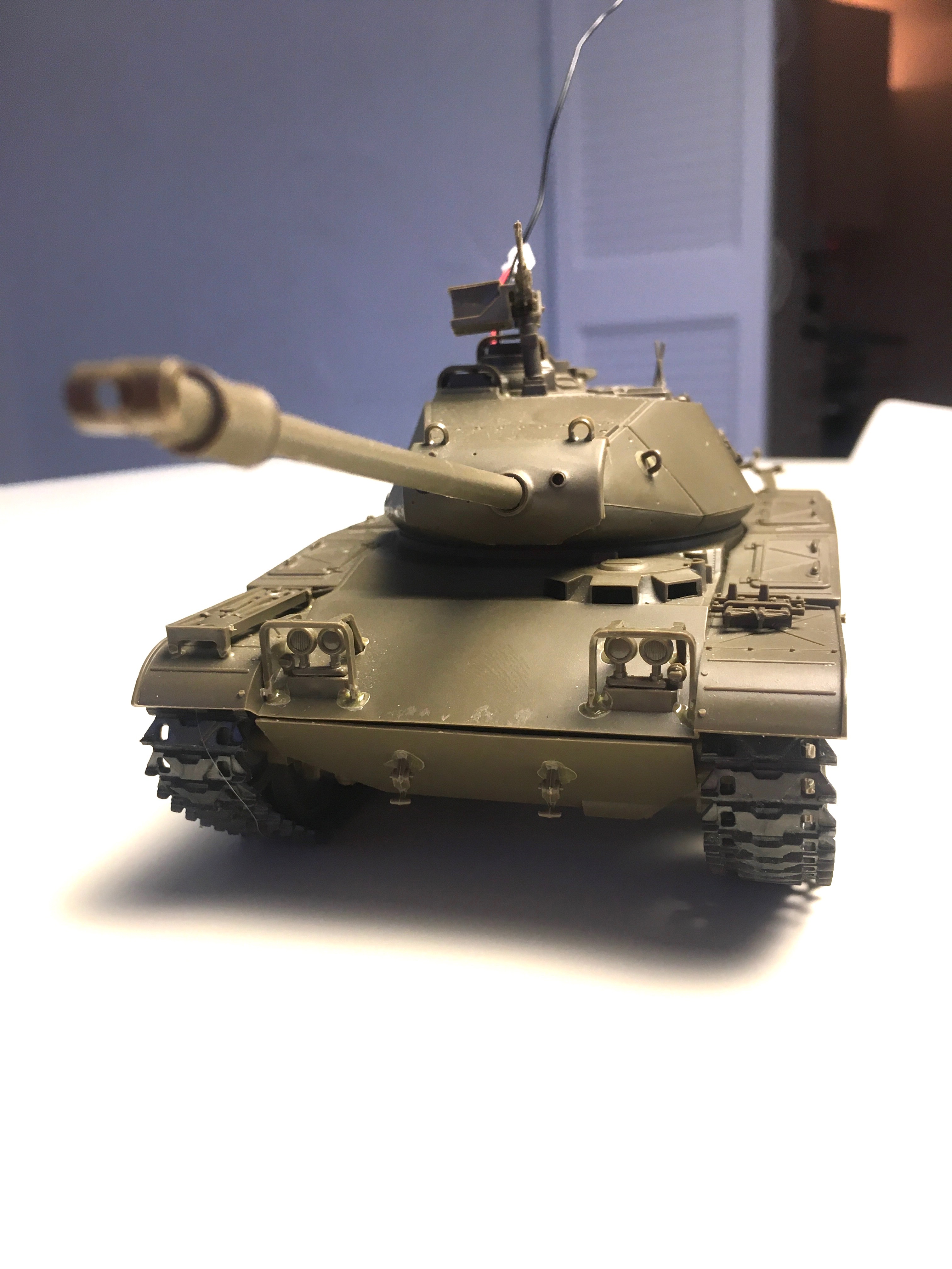

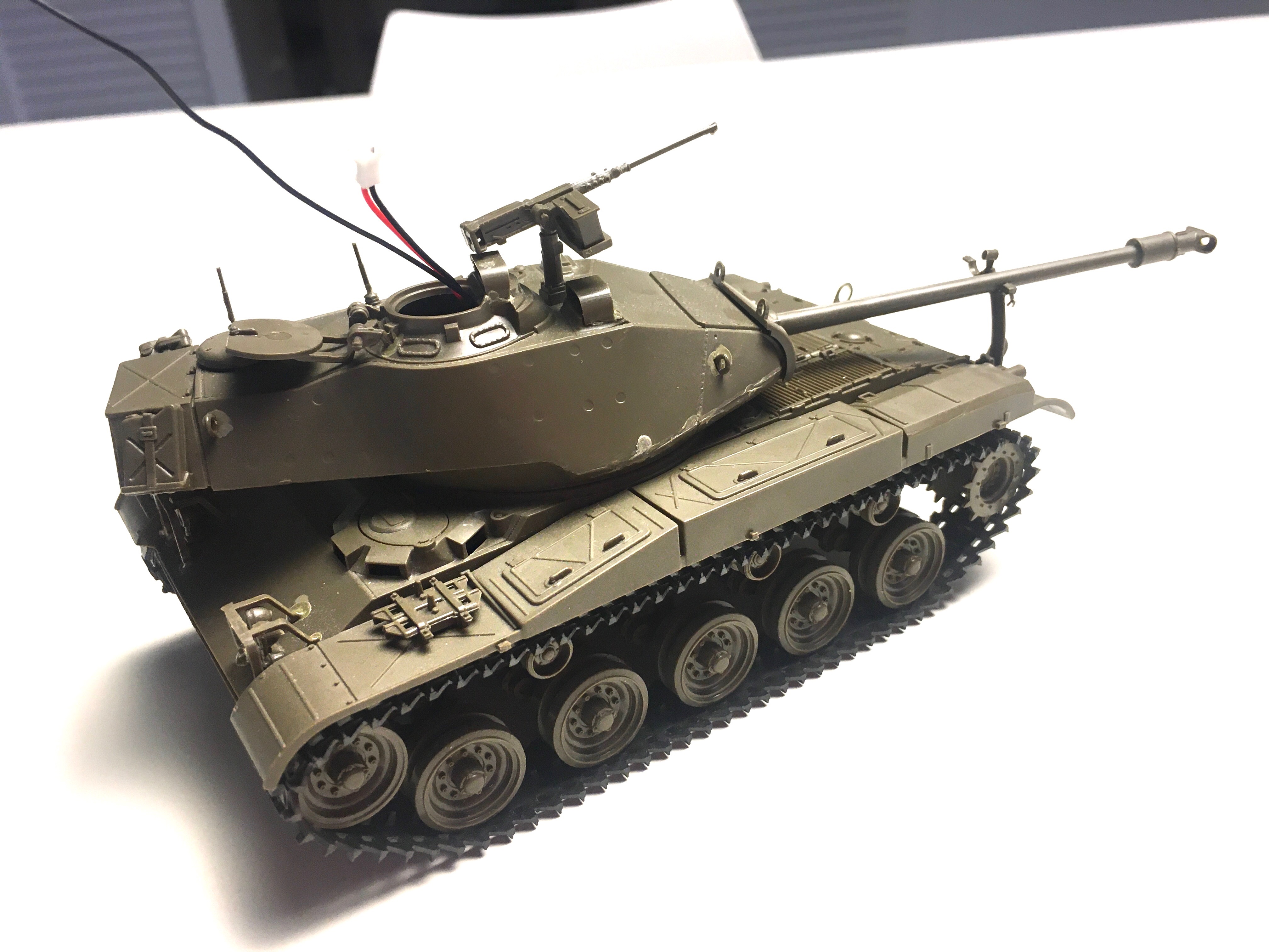

Here are some pictures of the Tamiya 1\35 M41 Walker Bulldog. It seems to work very well with this 72 Mhz GWS micro receiver with a DasMikro dual ESC.
I will be doing at least 3 more 1/35 Tanks using 72Mhz radio gear with the DasMikro Dual ESC's.
M41 ready for action
Even enough room for a battery in there,
These are the smallest dual ESC's around but they do not seem to work with Spektrum DSM radio gear.

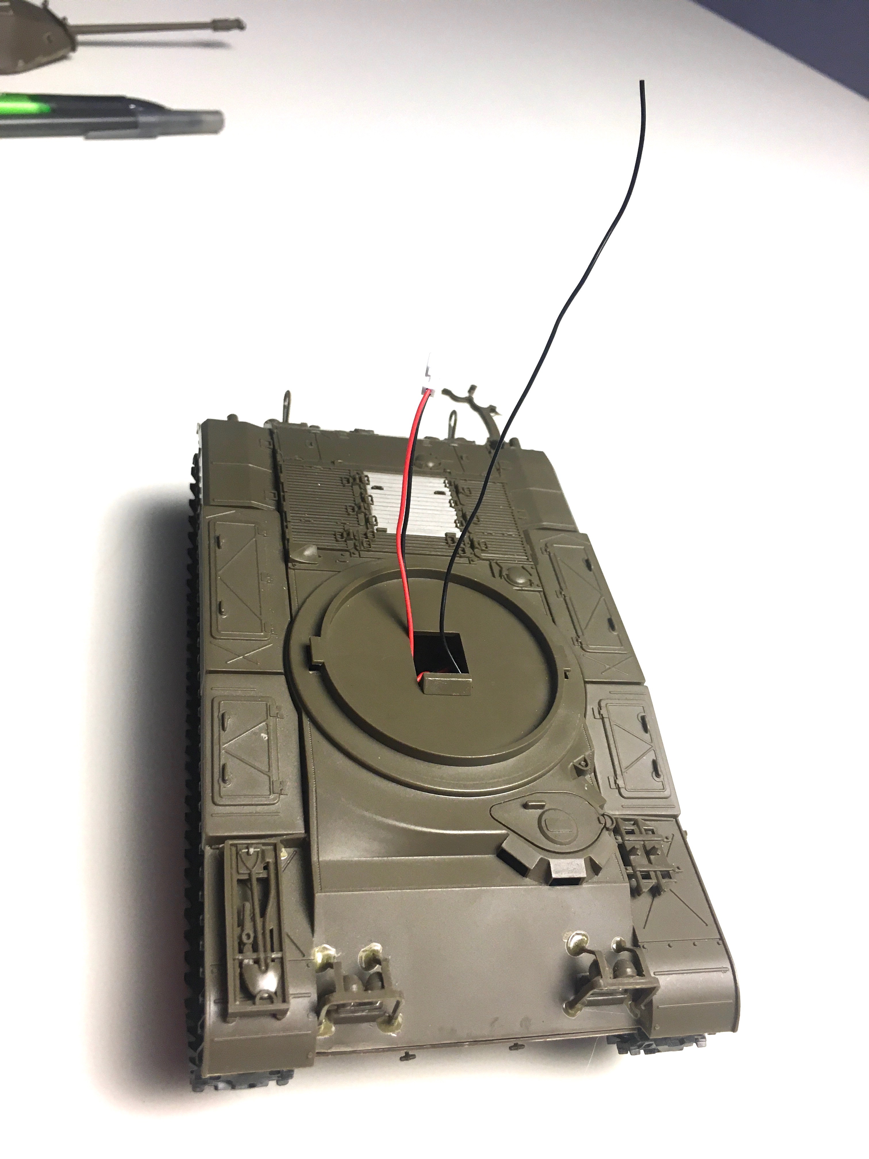

There is not a lot of room in this Tank for anything but this micro GWS 4 channel fits nicely.
This is a motorized remote control version of the Tamiya M41 Walker Bulldog.

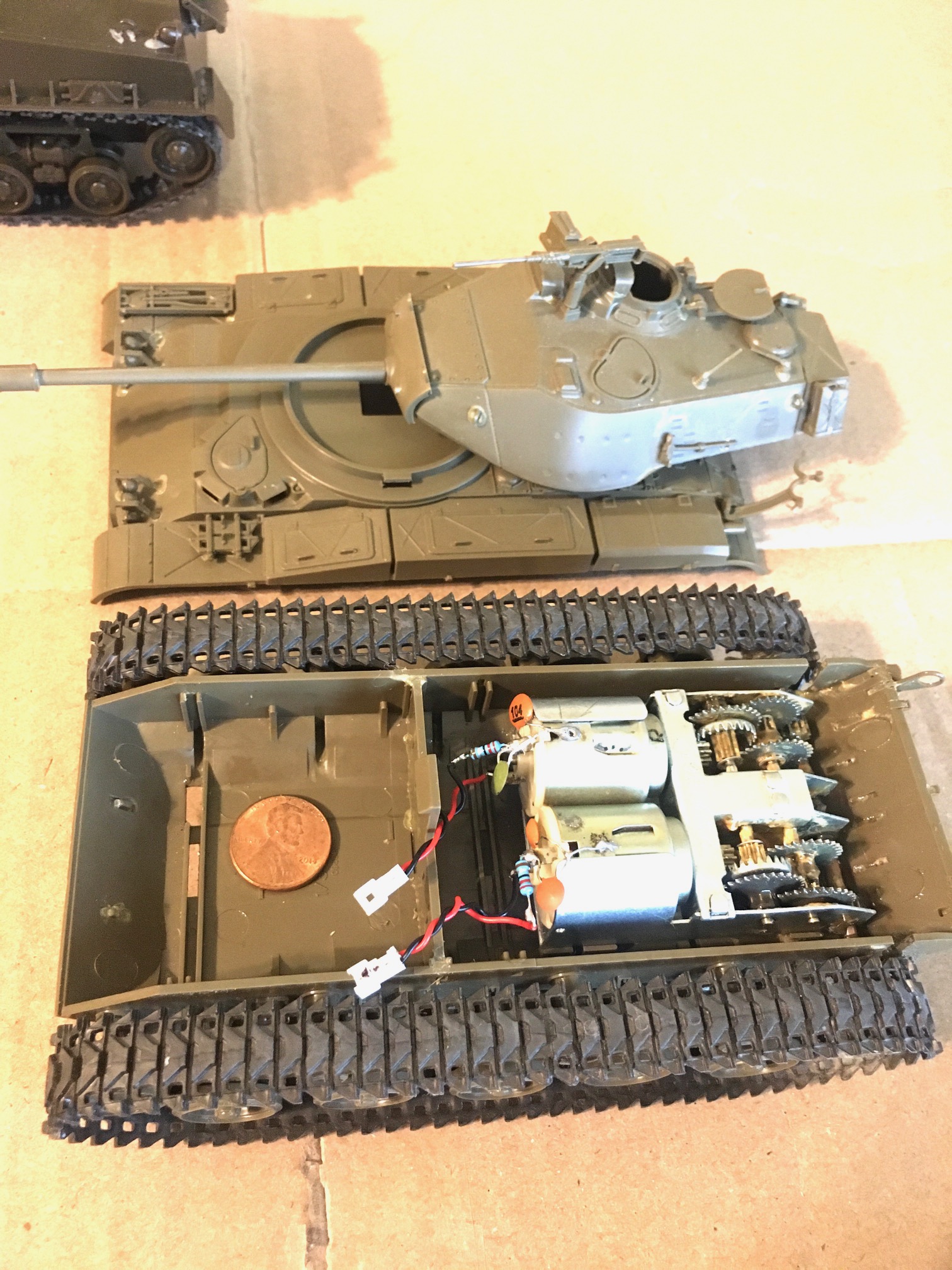

Herr Dr. Professor wrote: Mon Feb 06, 2023 3:47 am I've built the static 1/35 Bulldog--there's no much space in the lower hull. Yet it's obvious that it was once a motorized Tamiya kit.
The one shown here had no gearbox and was $20 on ebay, I had a spare gearbox and installed in in this Tank. Not much room in the hull for radio gear but then there is enough with the right electronics.

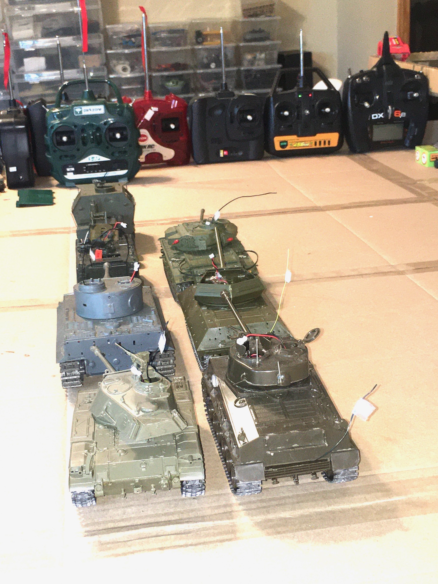

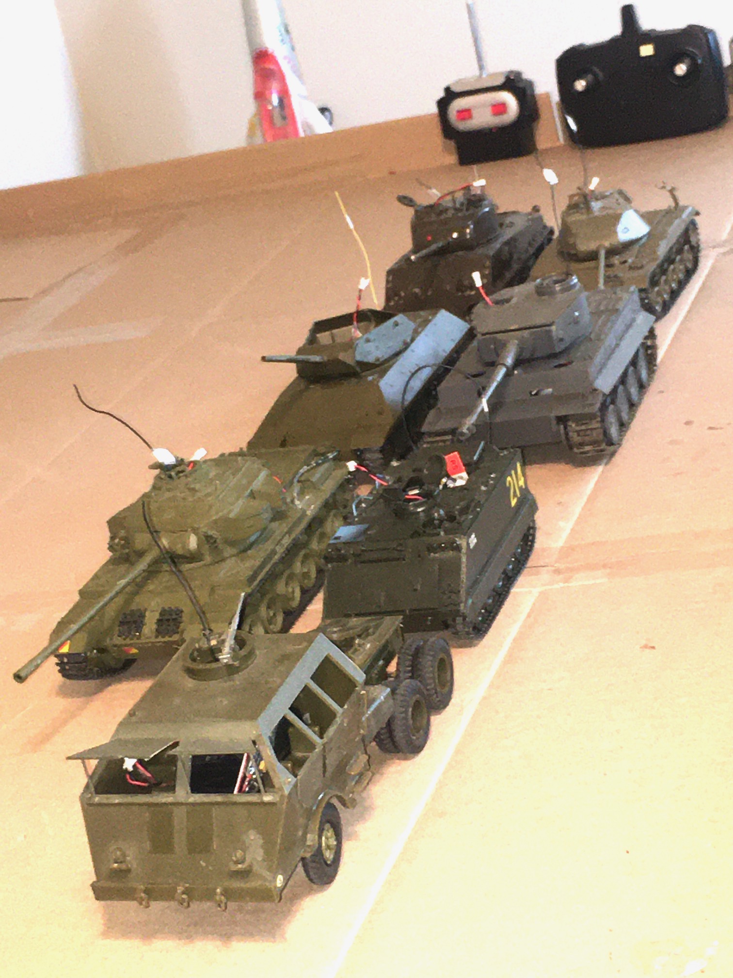

Well, I have about 7 models so far with aircraft electronics. Why you may ask? I have a fair amount of this aircraft gear laying around in storage and decided to put it back to work. Most of the Vintage Receivers, Transmitters are 25 years old or so but still works great :D

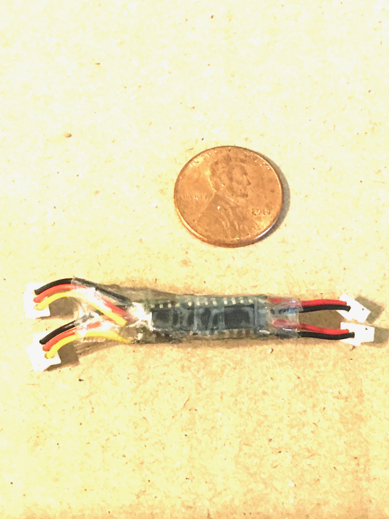

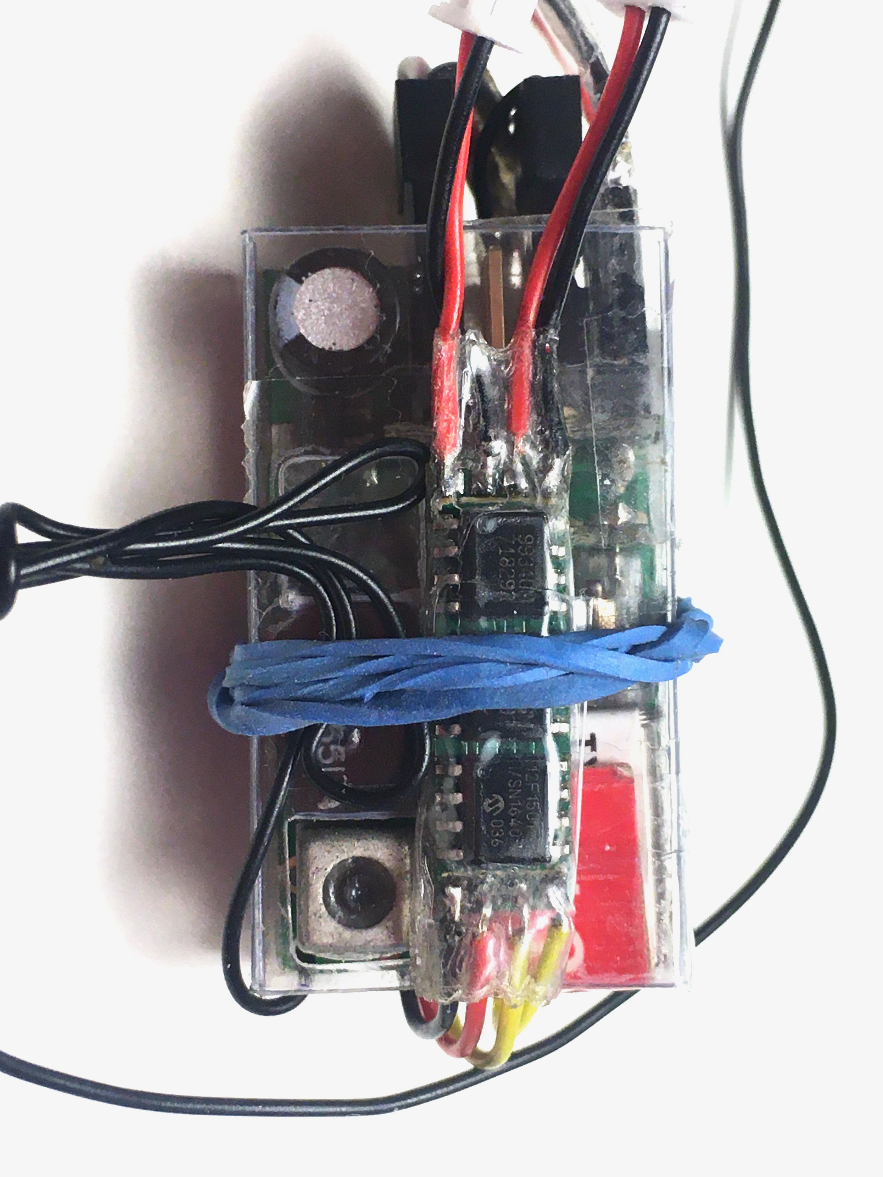

What is needed to make this stuff work in small scale military model is modern 1s 2 way speed controls that are fairly cheap on ebay. For this project I use three different types of ESC's.
1. Das Mikro dual 1s ESC with LVC and Elevon mixing. (picture below) This ESC has issues with DSM(x) radios and does not seem to work with them, however, they works with certain 72mhz radio systems like used here. 72 mhz "positive shift" radios seem to work good with this ESC. Of course they do not say that in the ad. It took me a year to figure this out :O They are the smallest dual ESC know to man but they have issues so I don't recommend them. They also have to be wired by hand which requires good soldering skills.
I found a dual ESC with or without a mixer that is even smaller than the Das Mikro! Have not had a chance to evaluate yet but as soon as I can I will report how that work.
Das Micro dual 1s ESC with LVC and Elevon mixing.

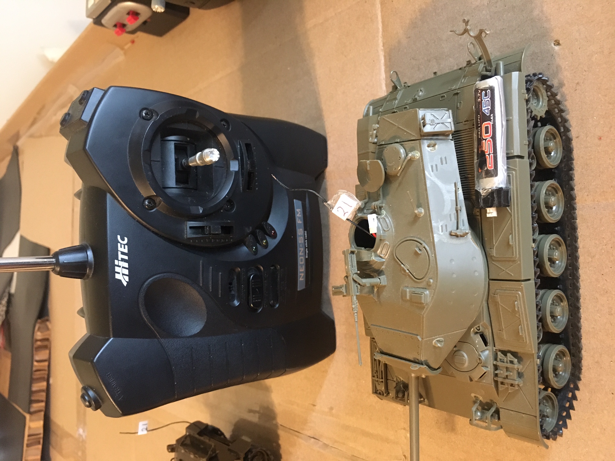

This is 1 of 2 transmitters that can operate this M41.
Here is the finished M41 with Vintage Aircraft rc gear.
Shown here with a dual stick Tx channel 21.
Here is the lastest smallest dual ESC known to man...
Vintage 72 mhz receiver from 1999. Pretty small for its time. Stil works very well. Came from a Phase 3 aircraft model and was flown quite a bit in its day. In retirement, it now runs a rc Tank.
7 1/35 scale models with Vintage rc gear. 1 truck in there as well as a APC.
These are all using <br />Vintage rc radios with newer style  1s ESC's
These are all using

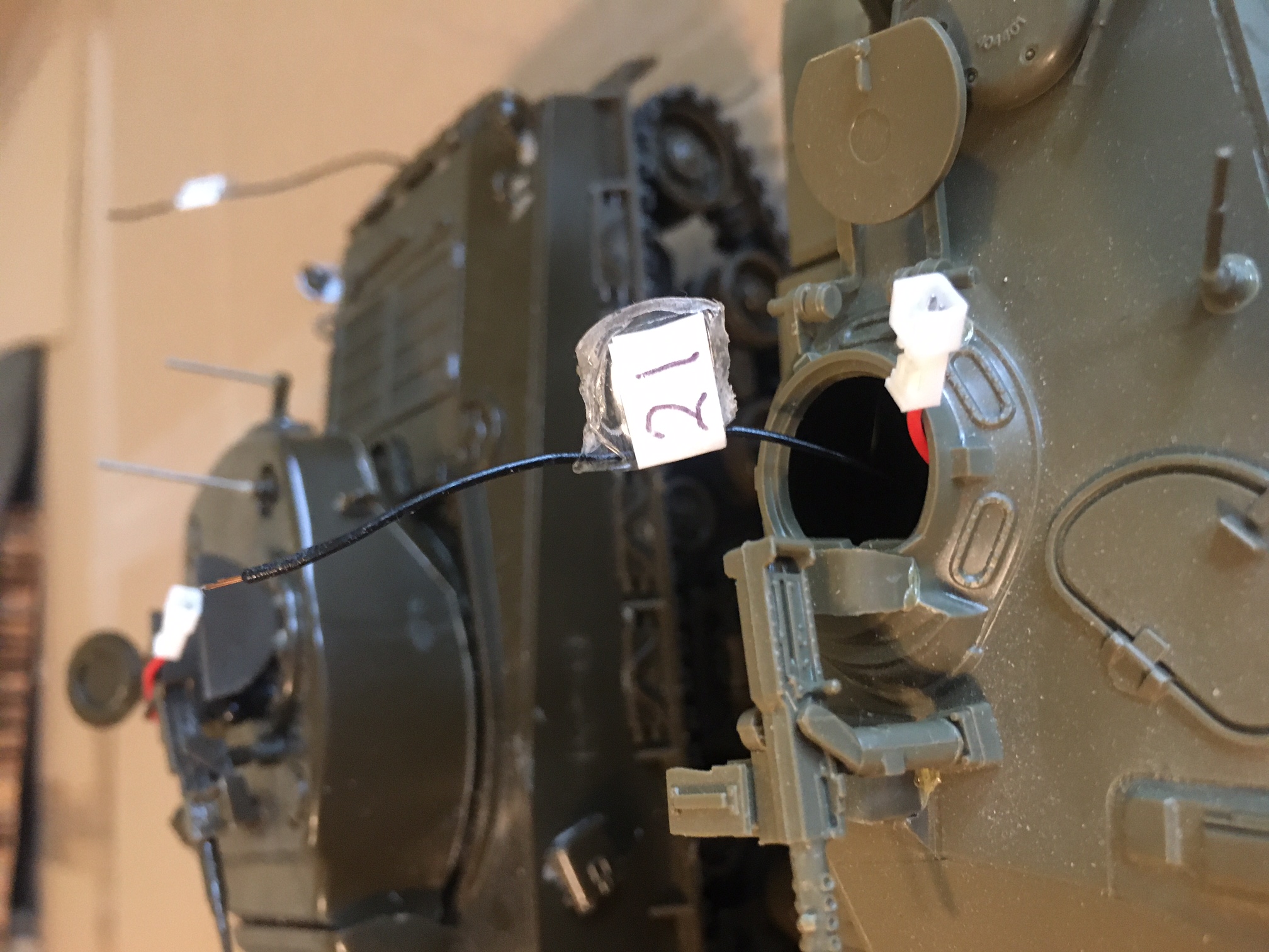

Channel 21. Positive shift, 72.210 mhz.

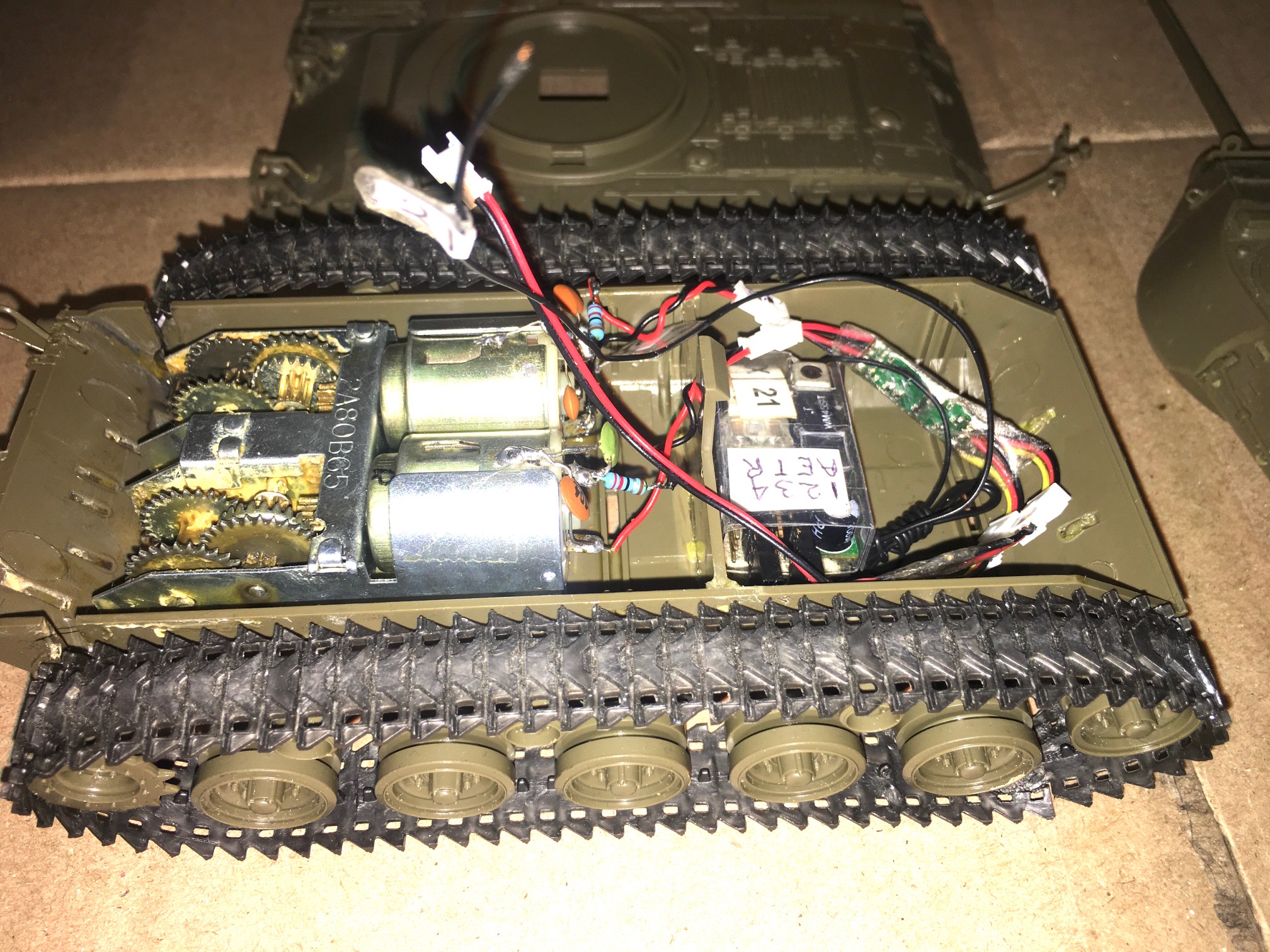

2.2 ohm resistor on each motor  tune these 2.5 ohm motors to 4.7 ohms and allow smoother operation at low speed.
Not much room in here so radio gear must be small

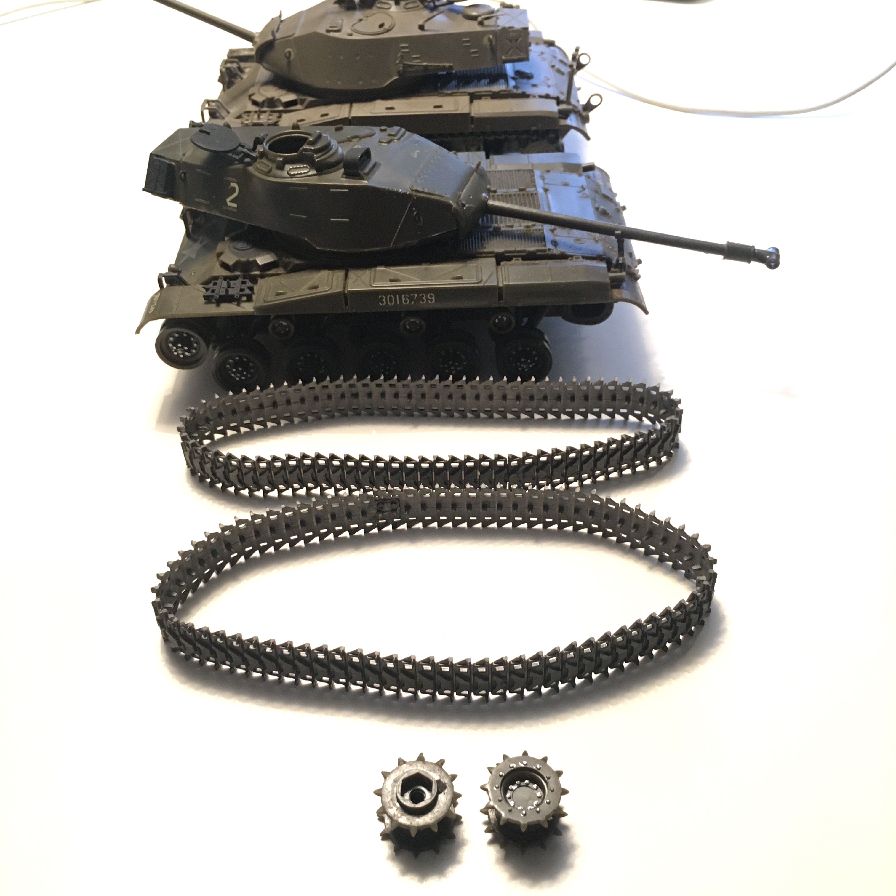

The box No.55 says &quot;plastic tracks&quot; but they are actually flexible soft polly tracks. these are a must for RRC conversions unless you what to go all all out with metal ITL tracks.  Oh, you also need those keyed drive sprockets to interface to the metal gearbox
The box No.55 says "plastic tracks" but they are actually flexible soft polly tracks. these are a must for RRC conversions unless you what to go all all out with metal ITL tracks. Oh, you also need those keyed drive sprockets to interface to the metal gearbox

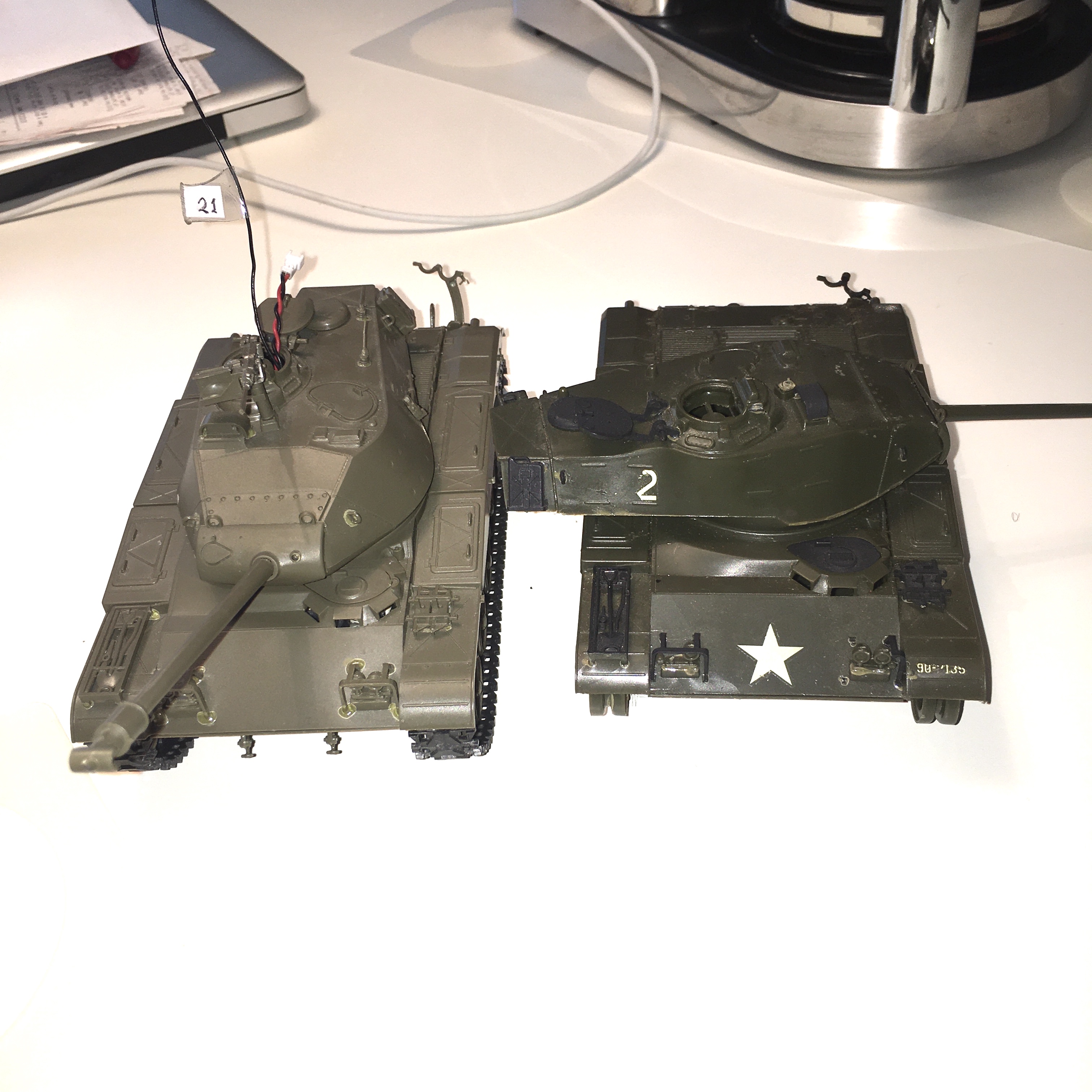

the model on the left is the No.55 kit while the one on the right is a real motorized remote control version dated 1969 on the inside of upper hull.

Two channel 72mhz legacy radio gear with the mysterious Das Mikro twin ESC with track mixer (elevon mixing). I say mysterious because this dual ESC circuit boards does not work with spektrum radio gear for some strange reason. They work excellent with this legacy radio gear.

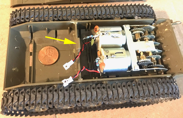

Posts: 5859
Re: Old R\C Aircraft radio gear recycled for model Tanks
Ah, there is a bulkhead reinforcing the lower hull. The bulkhead is intended to snap the upper hull to the lower, making is possible to open the hull halves to insert batteries. But the bulkhead is indicated backwards in at least two of the kits from about 5 or 6 years ago. This is useless information--unless someone wants to build one and even RC it.
