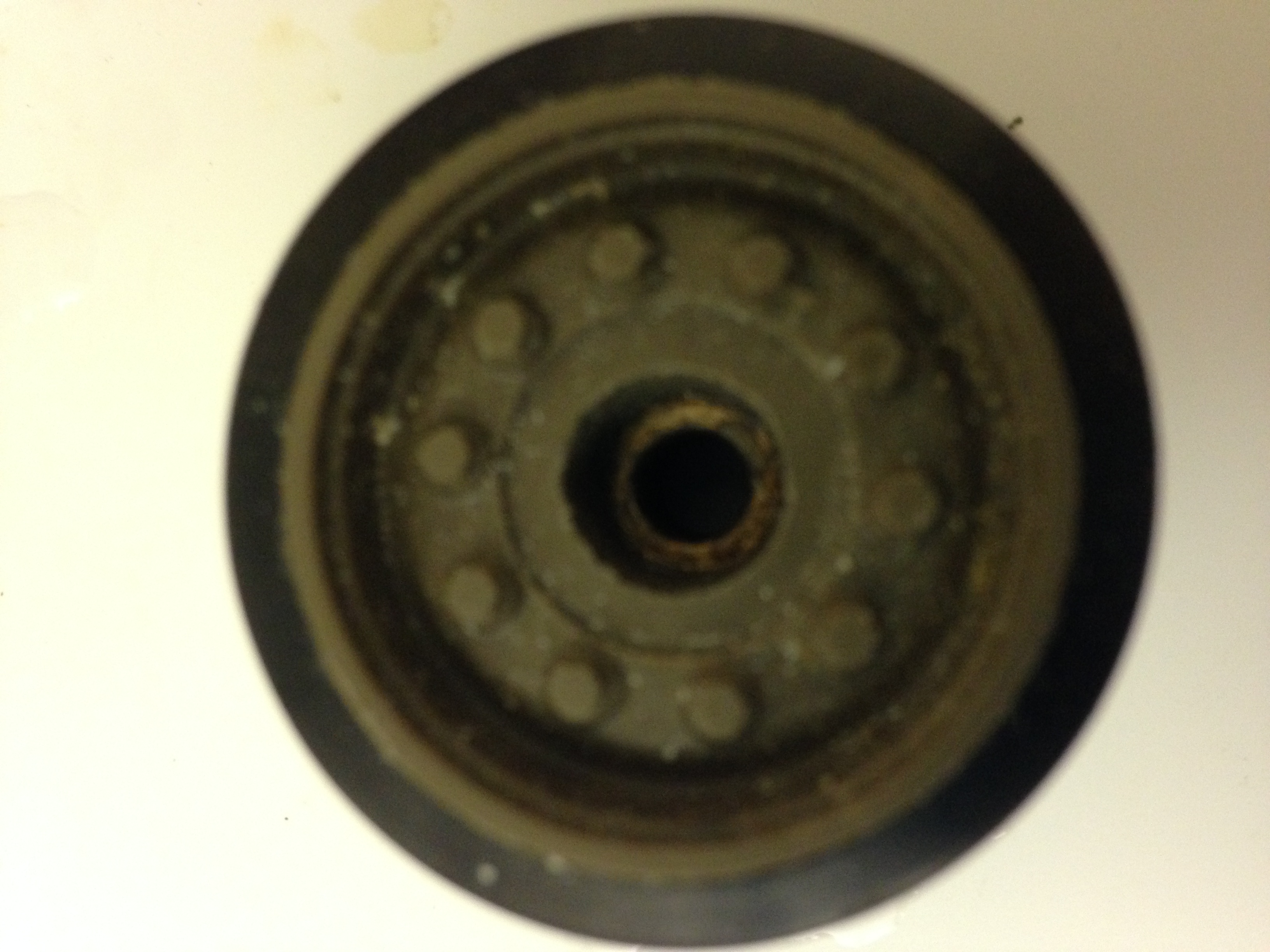

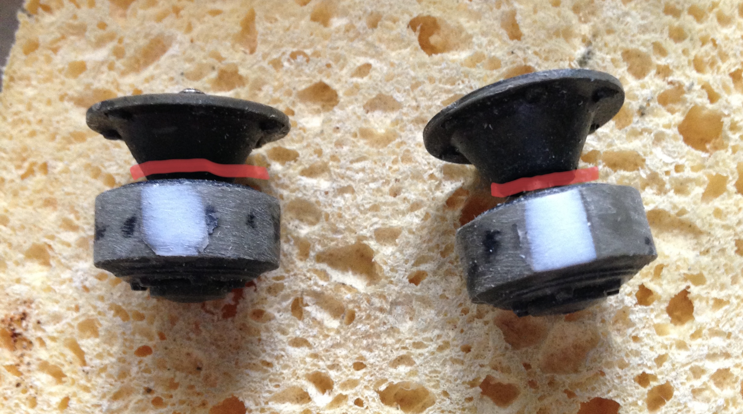

Without specific tools, I was looking for a while, how to improve the Sherman Tamiya idler wheels? here is what i did

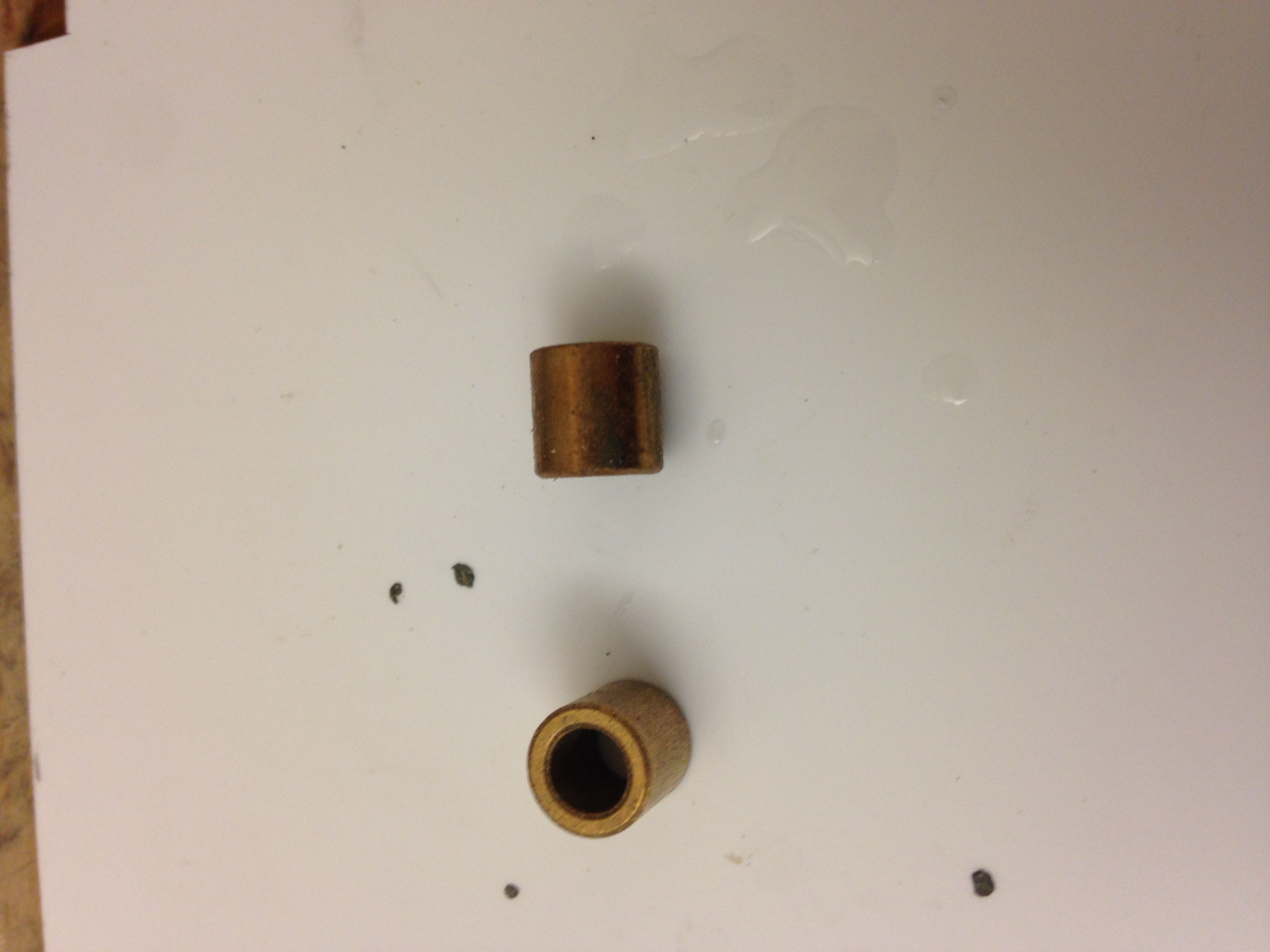

ordered on the net, sintered bronze rings, outside diameter 10 mm inside 5 length 10 mm
Saw the original e, pierced (4.2 mm) tapped at 5 mm through
add the brass ring, glued cyano
As I could not reuse the original cache, reproduced in PVC, will be glued, and if I lose one? not complicated redo
for axles? used 5 mm BTR screws, with a non-threaded part, which corresponds just to the length of the Bronze bahe, cut, because too long, and shortened the head.
I had considered bearings? but nothing to machine the inside of the wheels properly.. and found these rings, a little play to get them in, but it works, and more metal against plastic

:) Hello, and thank you Rad, for the compliment, I have been going around in circles for a long time, looking for a solution? but am quite satisfied with the result. I just have to find Thermo sheath, to copy your idea on plastic wheels

:) Hello Rad, I'm going to do the same on the smaller wheels, because I noticed on some, a flat spot, which I think is due to the friction of the tracks, on parts that don't turn? I stuck a little piece of Abs, and got back in shape

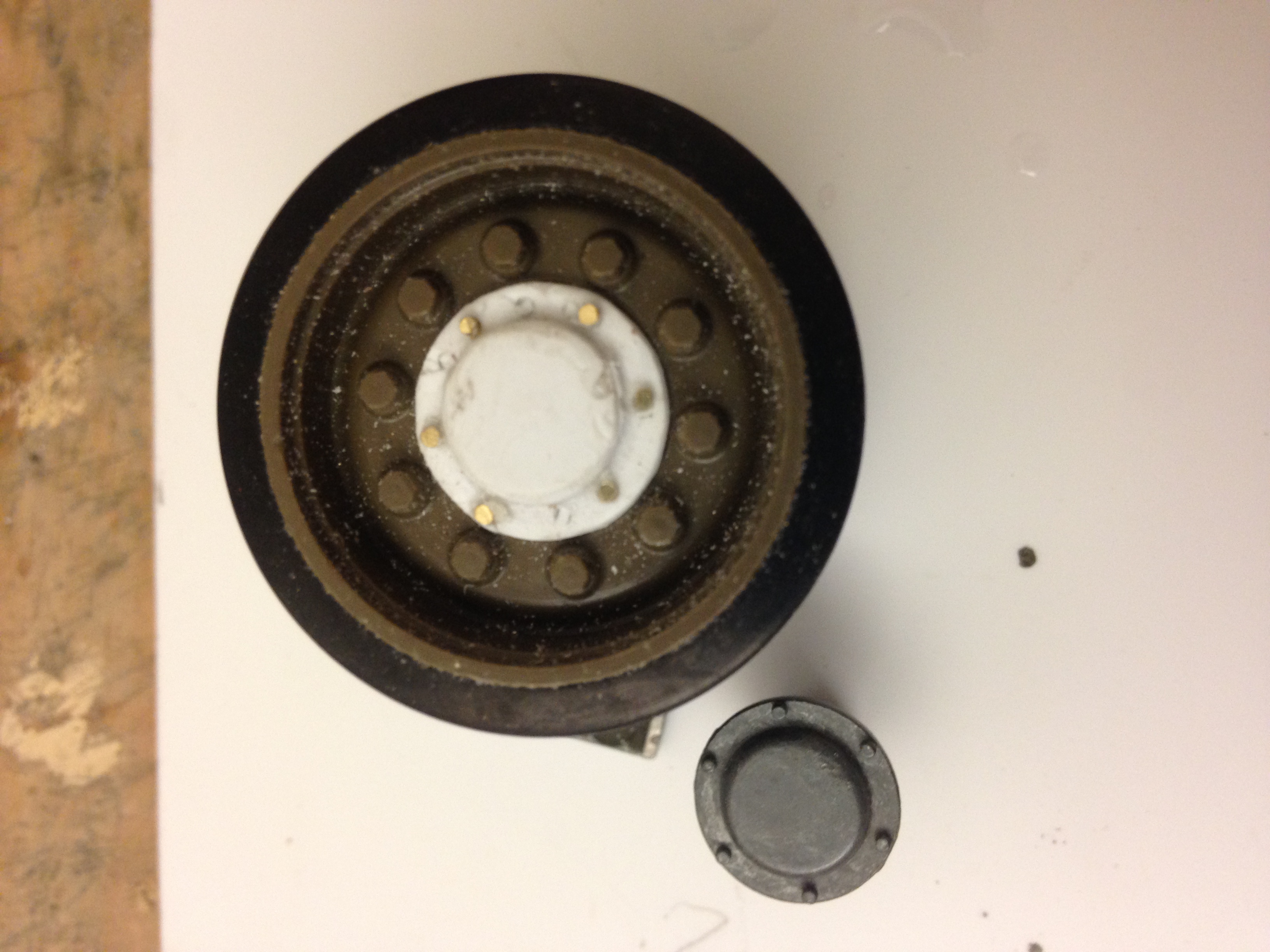

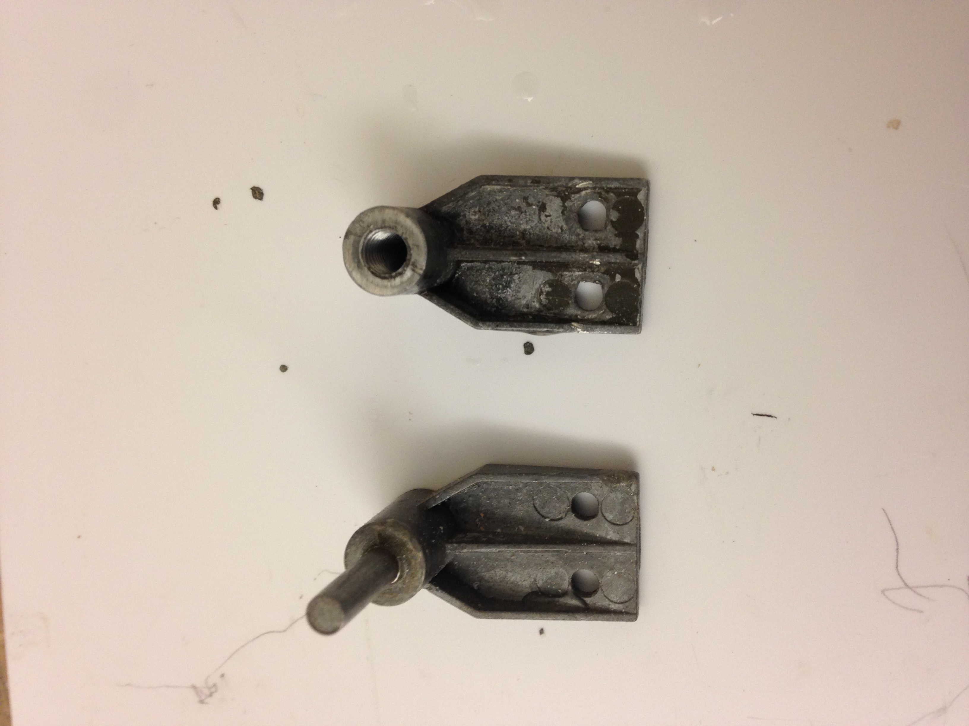

so I found what was wrong with these little wheels!!! after dismantling, I noticed that it was not turning freely, after having removed the threaded axle, I noticed that the wheel is too thick, which means that once tight to the chassis, the support comes to press on the wheel, preventing its rotation, placed a piece of sandpaper on the table and rub the wheel on the inside to remove a bit of material, and now turns without friction (hence the flat spot on some)
in red, the part that rubbed, the conical part once tightened, prevented the rotation of the wheel, because it came to press on it
