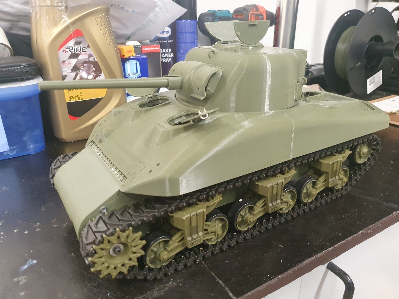

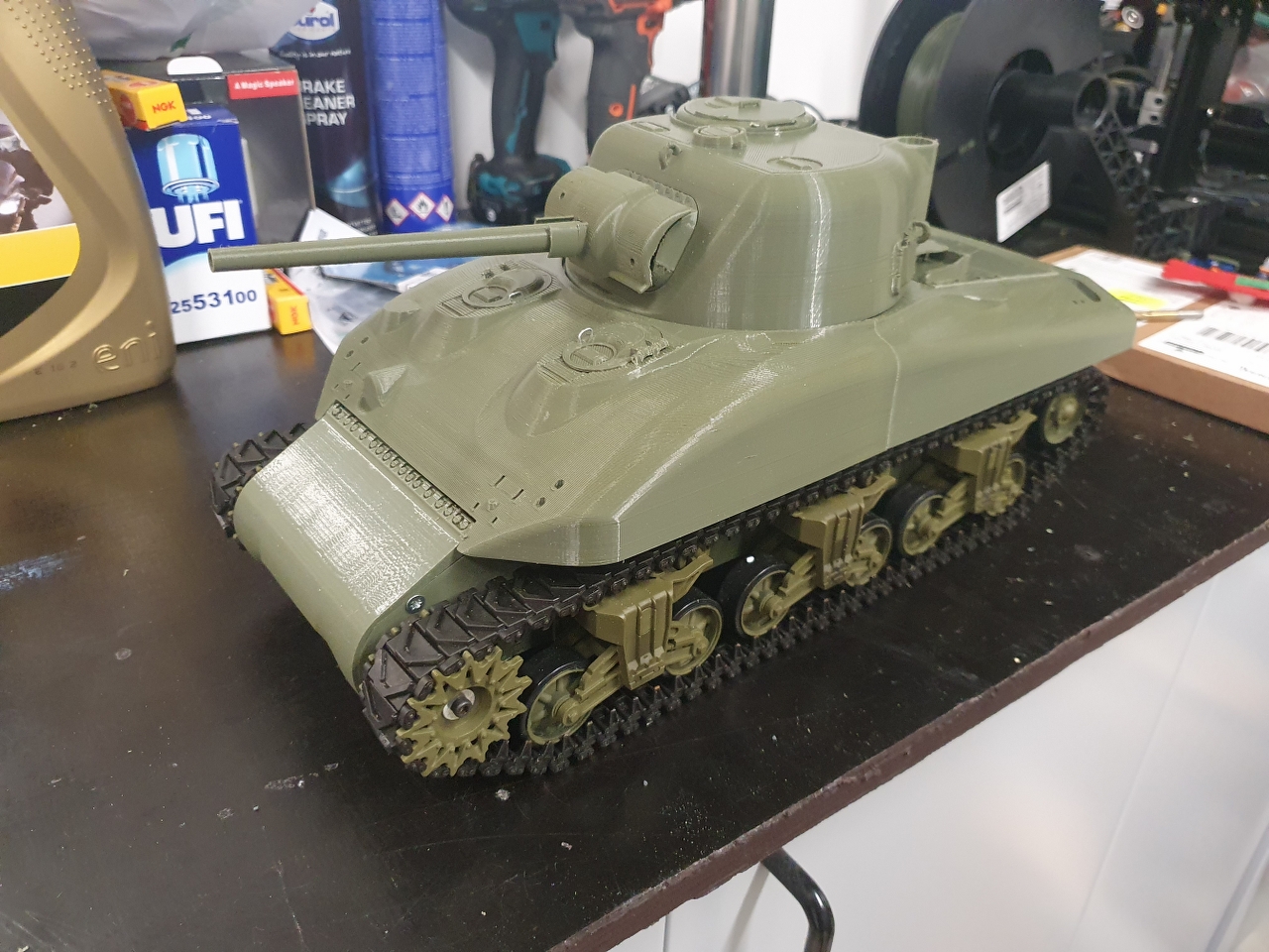

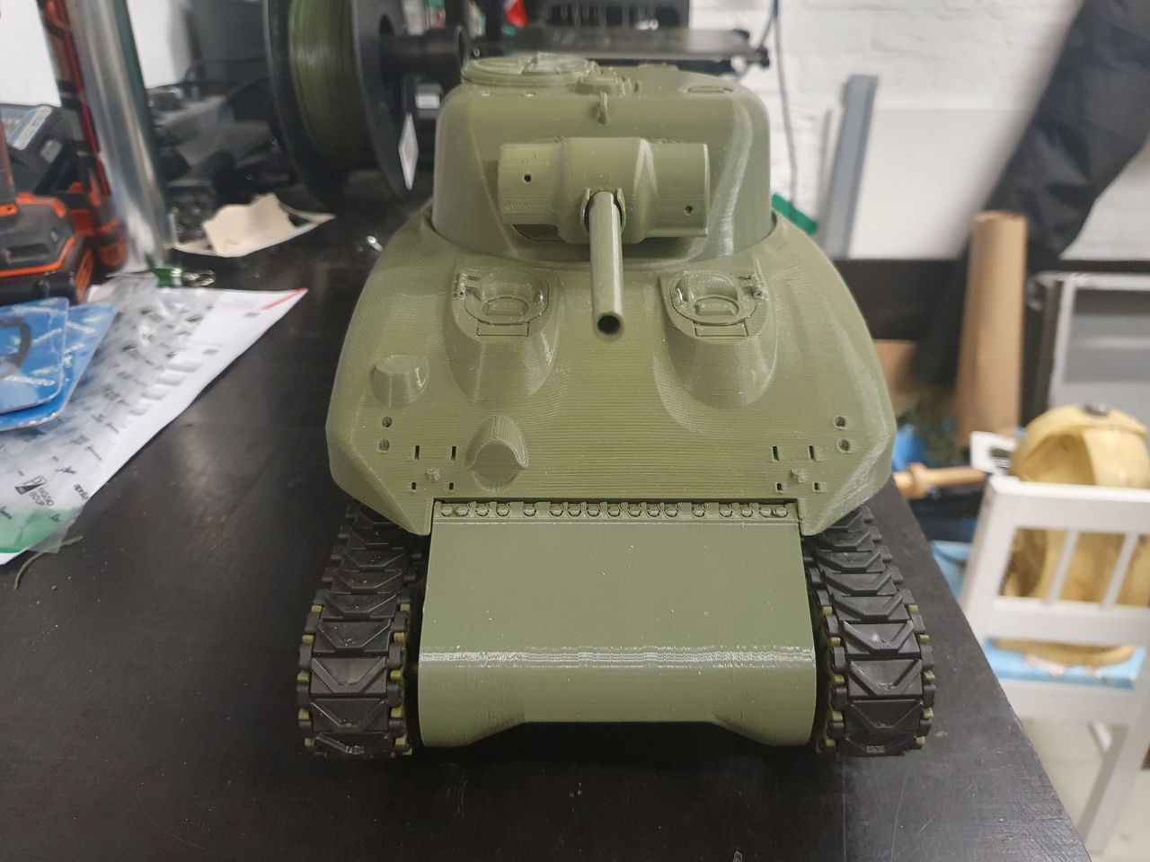

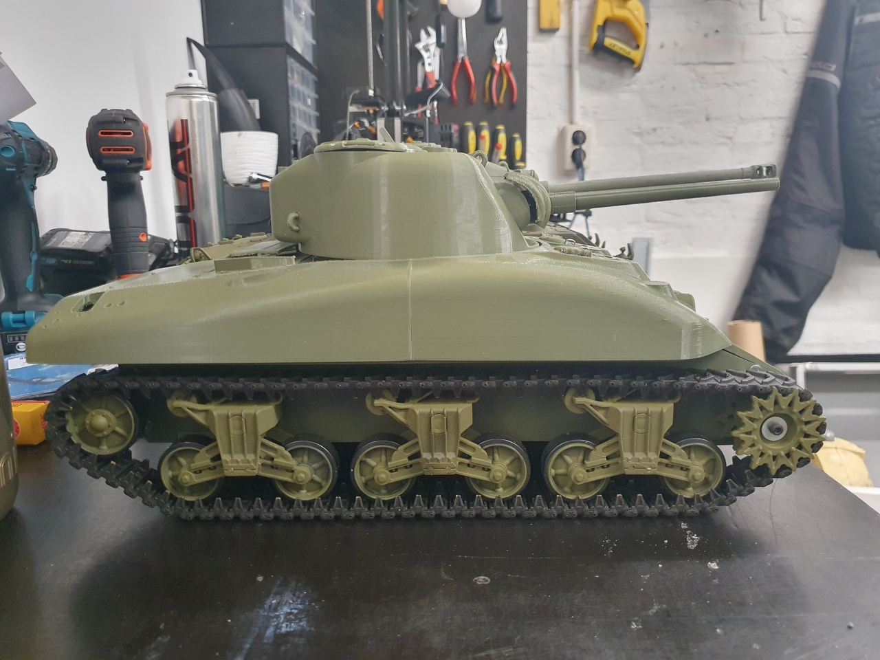

This is another project I've been working on for a long time.
Now with some leftover suspension parts from my HL donor (for the HVSS suspension design), I thought it was a good moment to design a HL-like bottom hull to use the HL suspension on.
Then I finalised the early M4A1 cast hull design, together with the low bustle turret, I 3D printed everything and here's the result. Pretty pleased so far!

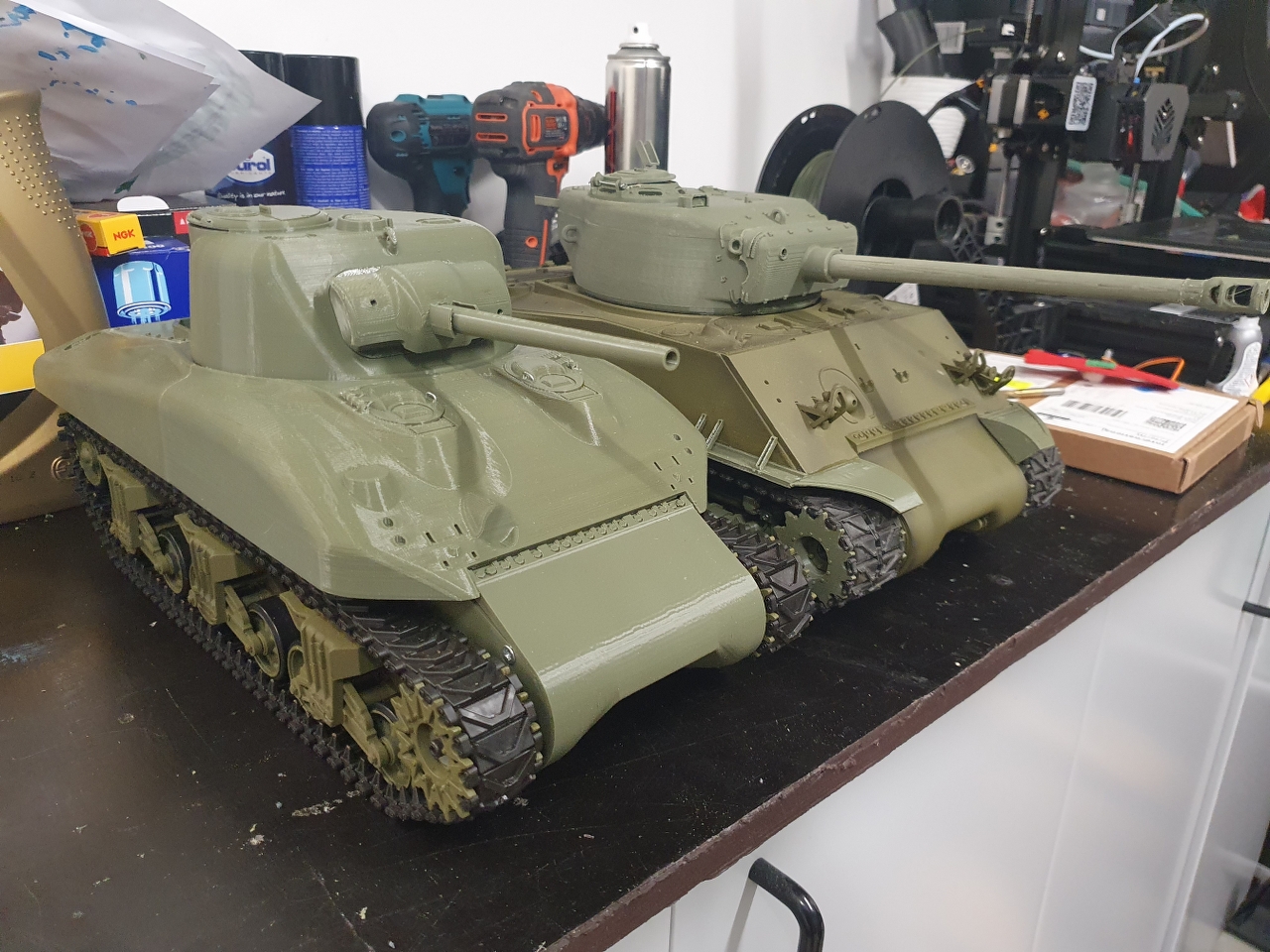

And a nice comparison to the later Sherman variant.

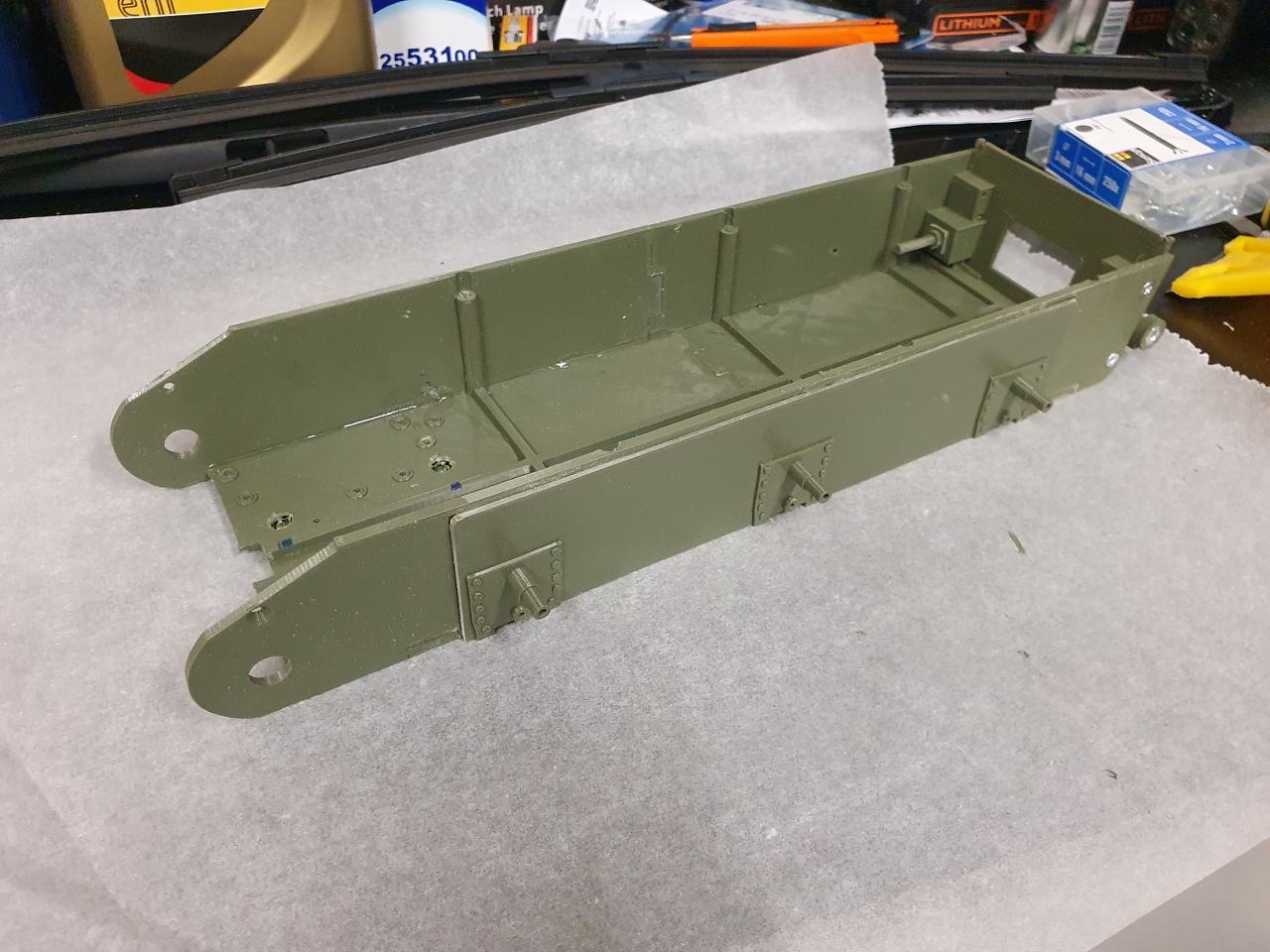

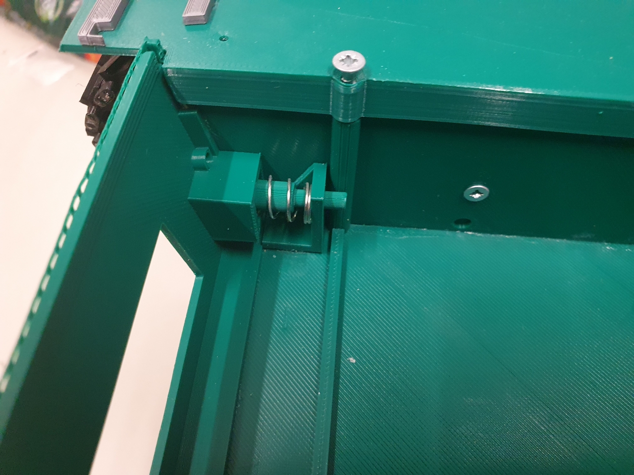

What a terrific start. I know there is a ton of engineering behind the scenes, but that 3D printing makes it look so easy. Is the lower hull printed too? Tell me about those boxes in the rear corner of the inner hull. Idler adjustment?

Ecam wrote: Sun Dec 18, 2022 12:53 pm What a terrific start. I know there is a ton of engineering behind the scenes, but that 3D printing makes it look so easy. Is the lower hull printed too? Tell me about those boxes in the rear corner of the inner hull. Idler adjustment?
I have a printer, but thus far have managed only to turn it on.....
Yes everything is 3D printed except the running gear, which came from my HL Sherman donor.
Everything does take some time to design and takes some practice to get right, but I've been doing this for about a year now in which I've learned a lot. Great fun to do!
The boxes in the rear of the hull are indeed for idler adjustment. My initial thought was a spring loaded idler adjuster, so that it has a kind of automatic track tensioning system. It's not like the original, which has an offset idler axle. I've tried that as well, but that's just too weak to use on a running vehicle.
The method I'm now using is much stronger, so should do well when used in the terrain.

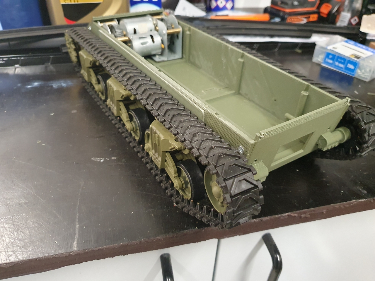

But your tensioner is somewhat functional? I love what you are doing. I'm for sure, tuned in!

Ecam wrote: Sun Dec 18, 2022 3:31 pm But your tensioner is somewhat functional? I love what you are doing. I'm for sure, tuned in!
Yes it is functional! Here you can see how it should work, as it is fitted to my Firefly Prototype. It is spring loaded and the idler "housing" can move forward or aft, which will tension the tracks.
