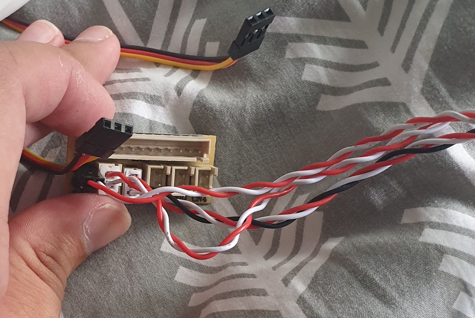

I have purchased an elevation and recoil unit for my t-90 project I'm working on and it appears my 7.0 henglong board isn't compatible with the plugs needed, does anyone know where I can purchase both a mainboard and board for the turret that's compatible? And with shipping to Australia
I've attached an image to show my problem.

Those Yellow/Red/Black wires are servo wires and do not plug into a 7.0 board. You would need to use a 7.1 board. The 7.1 board has servo connections. OZ Armour is probably your best bet for the 7.1 board and it will work with your current version 7 radio once bound:

Does that 7.1 board come with the little board that attaches to the slip ring aswell because I want to the turret to be able to have 360 degree rotation

No. You would need to do some custom wiring to get the slip ring to work. I can't help there as I don't use slip rings. My tanks are setup for IR battle and the slip rings have been known to induce noise into the IR firing circuit.
