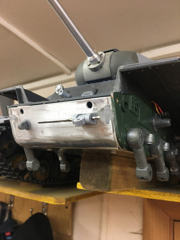

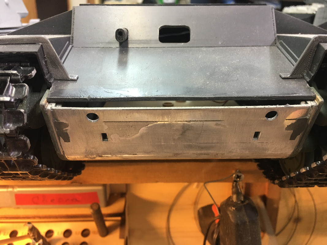

Replacement of front shackle attachments:

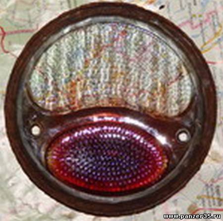

Hello Met5 . The lower front plate must be completely dismantled. The rear light of the KV/Su-152 tank was two-piece: the brake light was red; the marker light was blue

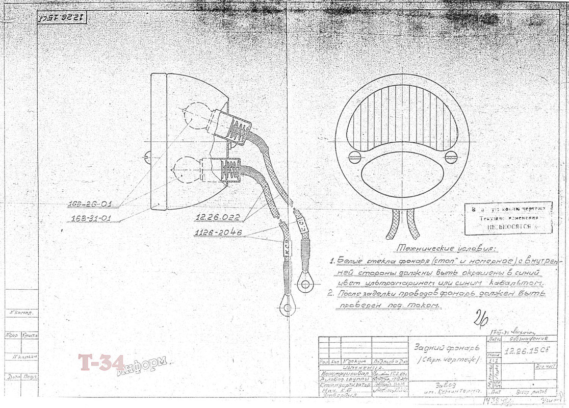

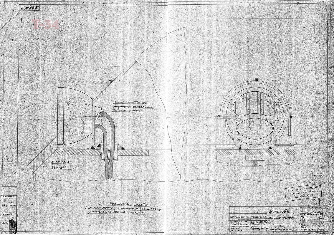

More tail light info...
Artem RedArmy
Posts: 95
Joined: Mon Oct 25, 2021 6:08 am
Re: SU-152 Zvierboi
Post by Artem RedArmy »
I don't want to upset you, but this is the author's fiction. The same taillight was used on all KV-series tanks, as well as on T-34 tanks. And he had no options.
