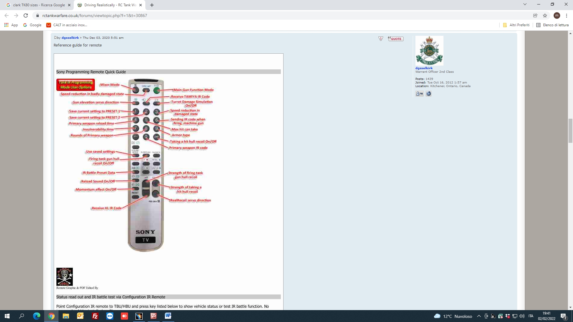

I would like to know what is "Rounds of primary weapon" function (button 8 of the Sony programmer)

Are turret turns or cannon shots meant?
What is it for in battle?
How do you reactivate the shot?

Cannon shots. I suppose it is used to add some extra realism to an infrared battle scenario, but I'm not sure how it is reset as I've never used it.
