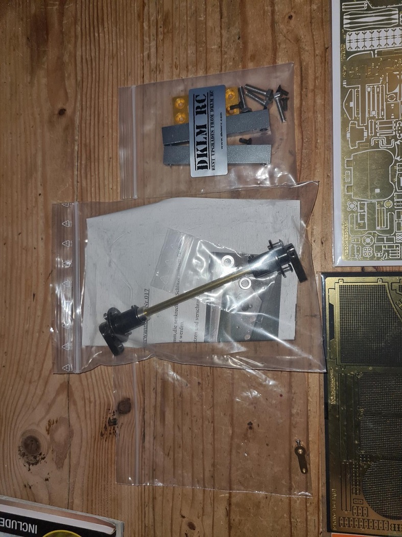

just about to start my KT build. Have asked questions on here before about the bits that would be needed to make the kit better and workable in some instances. Have the :
Henntec track tensioner
brass elevation arm
DKLM gearbox brace.

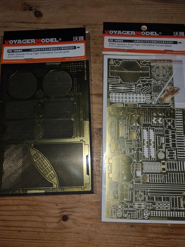

Aesthetics have some of the voyager photo etch

Aesthetically the kits ok, just ok though, the moulded handles are a p*ss take for 600 quid, however some brass will remedy that. MG is awful, hull one too.

A bit hard to get hold of but the schumo mg34 and mount are very nice. With the idler upgrade and brace you should be ok with metal tracks. Just make sure you get some tamiya compatible ones, I don't think the Toro ones were when I checked last time.

Thanks John, had a look through your thread and the supports look good, found them on rctank and I will get those ordered. Looking through the Pre Prod thread you have a 2mm base plate to stop the flex, something you made or bought from somewhere? Is it worth doing or will the gearbox brace be sufficient?John Glover wrote:Hi Mate.You could look at my post [Pre Production King Tiger] to see what I did to try to make mine as bullet proof as possible using stock transmissions One thing I would add is a set of of axles support bearings . If you cant get the Schumo ones,here is two options of suppliers that have their version for a KT. Panzer parts Modellino and R C Tank de. With R C Tank de, school across the top of their front page and you will find Tamiya parts. You will find their axle support bearings for Tamiya KT there. I have used a set of these.Lots of photos .Regards John.

HI. I made the 2mm belly plate. The transmission brace plus axle support bearings will help the life of your transmissions and I think a must if you are going to run steel tracks. I have three Tamiya King Tigers. First two I used the Schumo axle support bearings and the RC Tank de bearings on the third .Easy install. I am getting close to my assembly of my second King Tiger and will post this soon. Enjoy your build. regards John.

The fasteners for the belly plate are 3mm x8 and 4mm x20 for the transmissions. These are panhead Allen key or some refer to hex drive. I avoid using Philips head screw fasteners when I can because if you strip one your stuffed. The 3mmx8 I got from Ali Express[cheap as ]and the 4mm x20 I got from a local engineering shop[you only need four. A little bit of advice. The DKLM brace has a gold cross bar which is held together with four countersunk screws and once these are tight it is locked together exactly how it is made .Of coarse but you may find you need a slight adjustment with the brace when installing the transmissions to get them sitting correctly and parallel to the hull. When you are happy with the transmissions positioning ,now tighten the four countersunk screws of the gold cross bar. I use a jeweler's screwdriver and don't forget to use a little bit of lock tight. I use the kits lock tight as it will enable you to disassemble as its not to strong but it is not meant to be .I cringe when I see someone using a powerful lock tight as I think [Good luck if you ever want to pull that apart] I also have a Daryl Turner brace and he only had two countersunk screws in his cross bar so he realized that you may need some adjustment .Hope that helps. Regards John.
