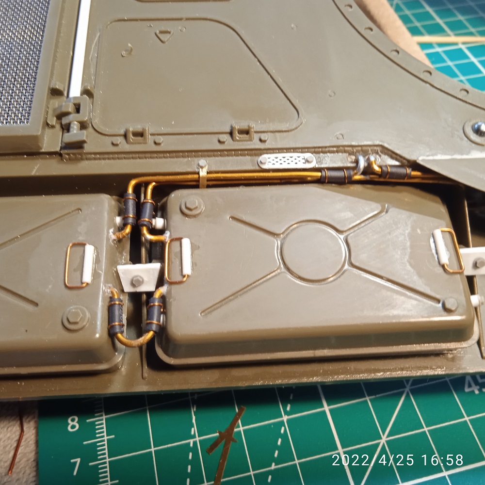

One of the first, with low-quality casting, defective parts, in the hole for the gun barrel, where a mouse can still crawl...
And the most offensive of plastic that does not want to be glued, I used dichloroethane ....

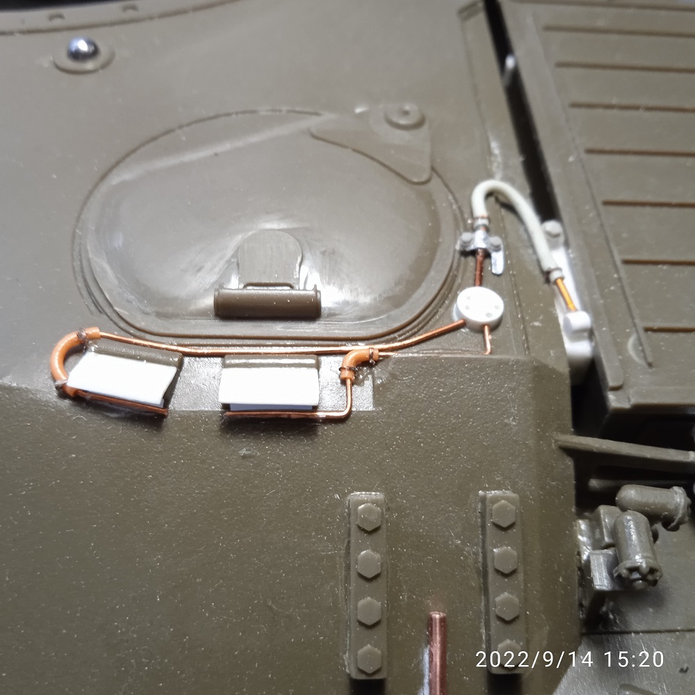

A great start with the rough old kit, Pavel. I especially like your plumbing for the external fuel tanks!
I'm a big fan of any T-54/55 so I'll be keeping an eye on this. :thumbup:

Agree, the set up of the fuel tanks sets the high tone for the rest of the build :thumbup:

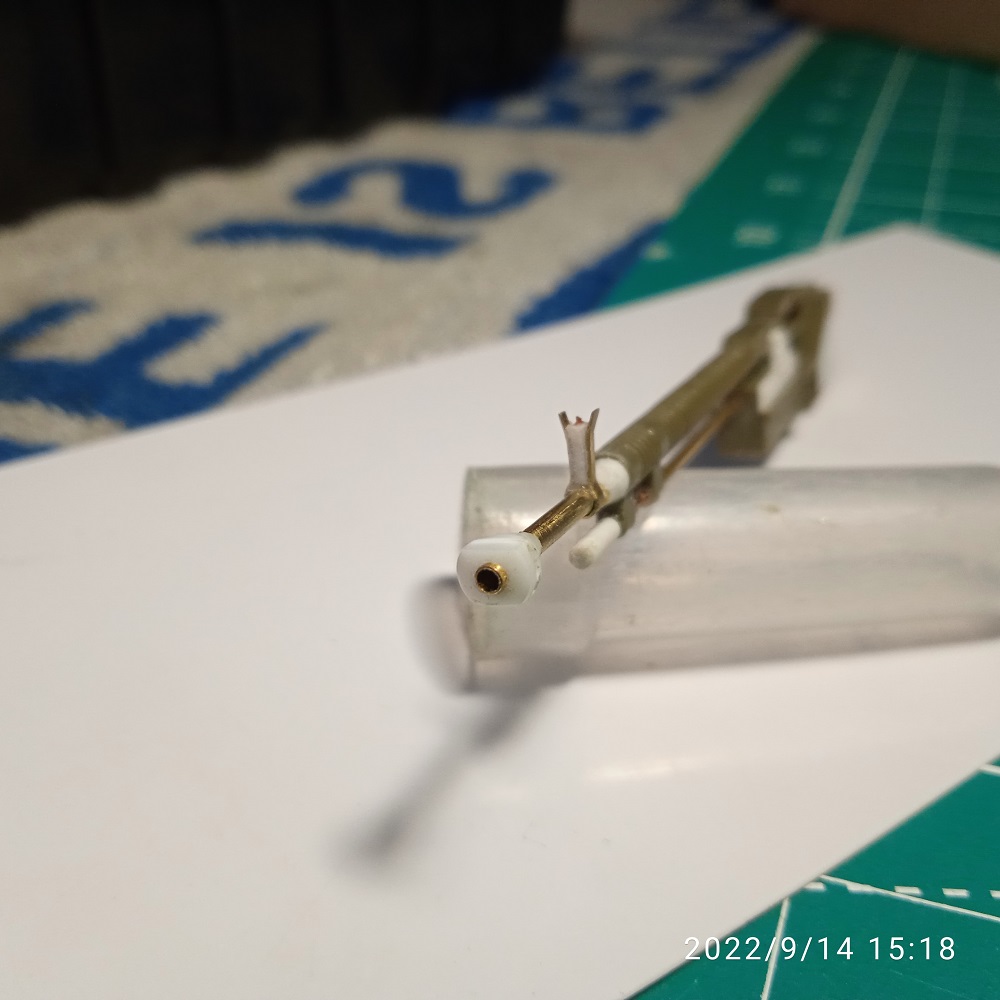

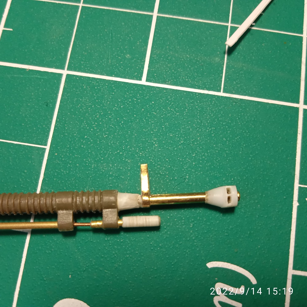

Tomorrow I’ll show you an unfinished DShK machine gun, I wanted to buy a ready-made one (for sale, well made), but the price ..... I can’t afford what I can do myself ...

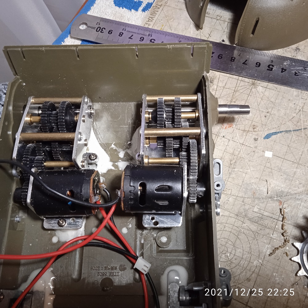

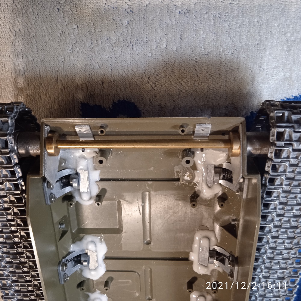

I replaced the gearboxes, installed bearings and my oil seals, proven over the years (I showed them in the Challenger 2 thread)
Made track tensioner....

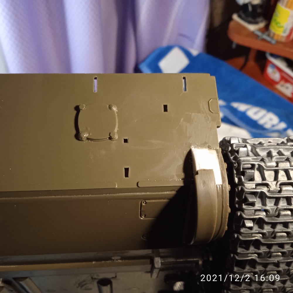

The driver's hatch opens by pressing it, under it there is a "on-off" button with fixation and when pressed, the button raises the hatch cover and it can be taken aside ...

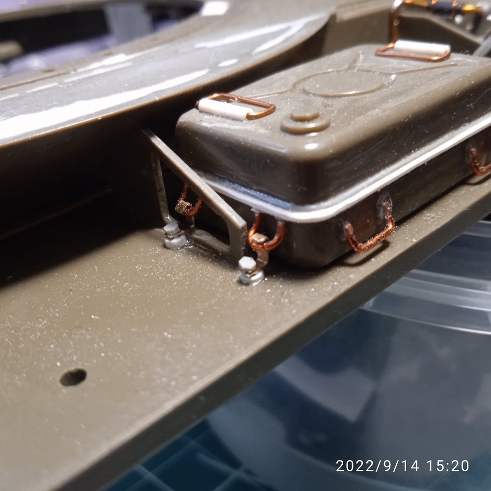

Slightly improved the attachment of additional tanks.
I tried to bring the oil tank to a state similar to the original ...

Some next level detailing there!

Stunning details

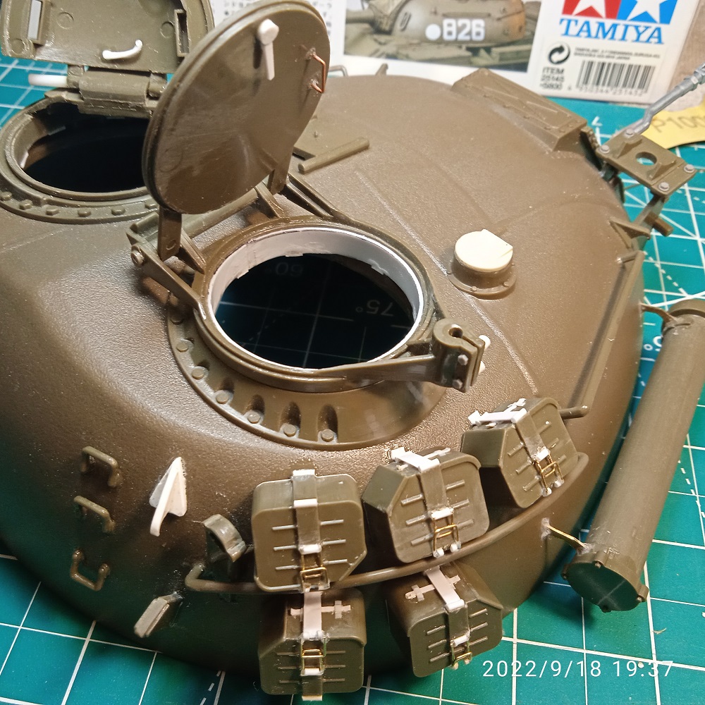

Something I didn’t like Hooben’s version of ammo boxes ....
Maybe my version is far from the original, but a little better than the stock version...
I made the mount of the pencil case for underwater movement from metal, I was already pretty tired of breaking it off ...
