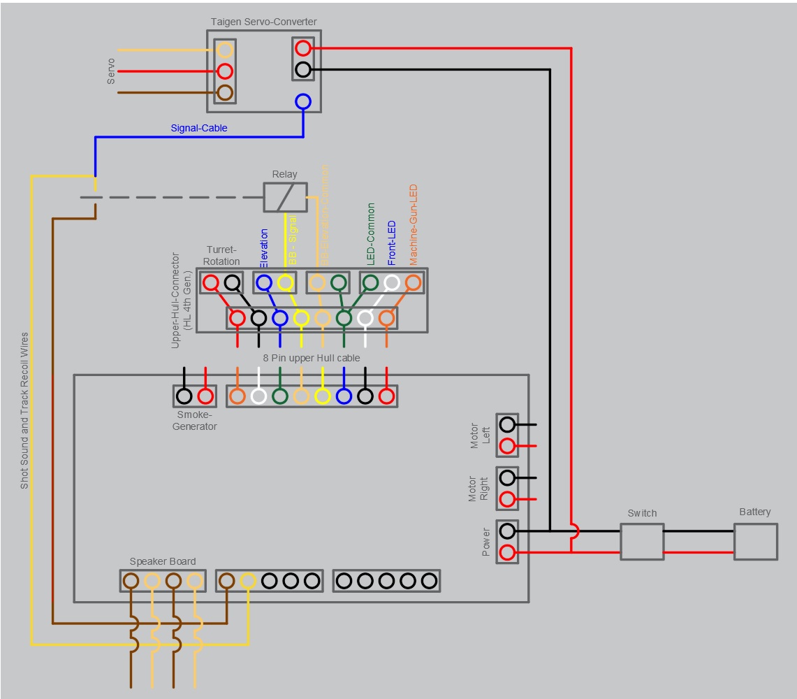

    Problem now is: If you dont have a BB Unit, pushing up the left stick doesnt close said circuit. This is where you will need a relay like this:
    What this does is essentially the same thing as the BB Unit, just quicker: Once you give Power to it, it closes a circuit, easy as that.
    Heres a little schematic I drew of the electronics, hope this helps with understanding my explanation:
    Once you pull the trigger, upper hull, beige and yellow cable get power -> closes brown yellow circuit -> Gives signal to activate Servo

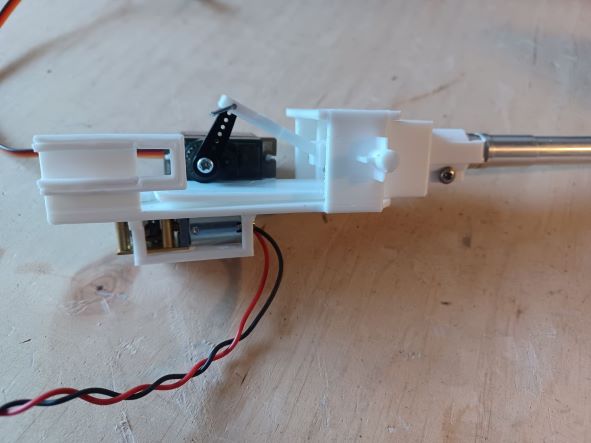

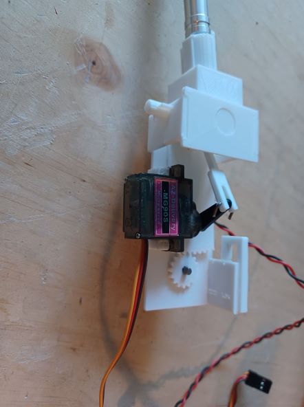

    My goal was to design a new bracket, wich allows me to move the gun horizontally, while still using the same elevation motor the BB unit uses aswell and without any Servos obviously, because the Taigen V3 cant control those.
    First of all, here is the "finished" design (Added the " because it still has some flaws, wich I will explain later)
    I designed it in AutoCAD and 3D printed it on a small printer I bought some time ago. (Took like 5 Versions, until it worked as intended)
    For the Horizontal Movement I used this motor:
    It works perfectly. At first I had the fear, that it might be too strong, as I had no grasp for how to judge the tourge figures, but in reality, once the Barrel reaches the maximum angle it just stops without any ugly noises, or shaking, even if i continue to push the stick to the side.
    For the vertical movement I used the same motor, as the BB Unit, I just had to do a tiny modification.
    With normal Taigen Tanks the turret rotation is controlled by moving the left stick left and right and the vertical movement is controlled by moving the left stick downwards, wich will make the turret go up and down periodically. With the STUGs elevation motor you cant do that, because it has a little plastic bump on the arm attached to it, wich blocks the motor after half a rotation. You can simply take a knife and cut that nob of, wich allows the motor to freely rotate 360°, so you can wire it up like any other Taigen Tank.

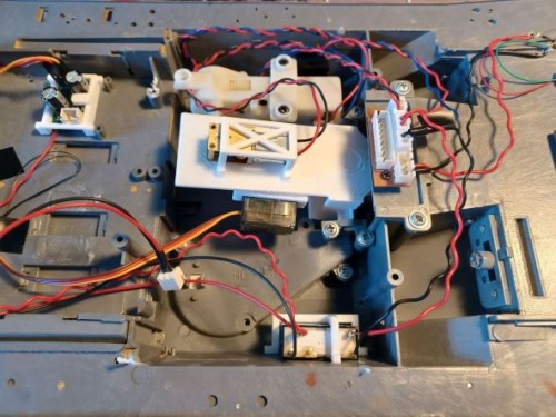

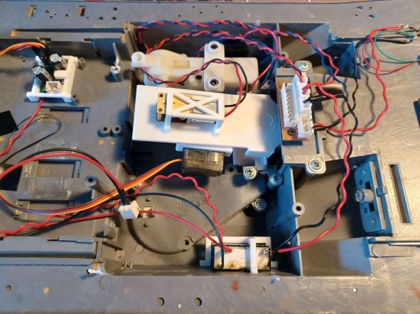

    Here is a picture, of what the upper hull looks like fully assembled:
    And here is a video of the final result:

    1. As you might be able to see in some of the pictures the 3D printed bracket flexes quiet a bit. This is probably easy to fix by just adding some supports underneath, or just print the one piece with supports added to it from the beginning, I just didnt get around to do that yet.
    2. The way the Servo is connected to the Bracket: Well its just glued on right now... As you might be able to see I added two pillars on the one piece to screw the Servo into, but they broke when I tried. Making those wider would limit the treverse, so that wasnt an option. I would have to redesign the whole thing, make it longer to be able to make those pillars bigger, wich I just didnt have the patience to, so glue did the job just right.
    3. The traverse isnt nearly as wide, as it would be historically acurate. In rela life the STUG III would have an Arc of 24° (12° each side). My model only has about 12 -14° in total and I dont see a way to fix that, if I want to keep the elevation motor. I would have to move the axis for the horizontal movement further towards the mantlet, wich I just cant do, because of lack of space, so it will just have to stay this way.
