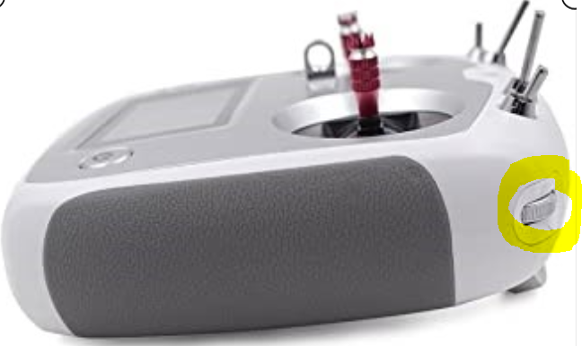

I was thinking my Clark TK24S was the problem but it's not, Maxxmekker in a PM asked me to check the outputs in real time and yes the VrA and VrB sliders do not re-centre themselves, they do on the radio but they don't on the channel outputs that's why I was in an infinite loop with the cannon firing and both MG outputs .
What do I do now the radio is not that old it would still be under warranty but if there's a quick fix .
Do I open it up and re-solder some stuff ?
Cheers and THX for reading .

Mate Maxxmekker made me aware of the issue and has told me that yes they should be returning to an
off" state . And yes he's right as in every video of an SBUS Clark board the VrA and Vrb sliders go back to an off position once released , and yes HobbyKing has been informed and they've asked me to send the radio back to be fixed or for a new one .
HobbyKing has told me it is not working correctly so I'm good with that .
Thank you for input.

OK, so I'm confused, these are not rotary knobs as I understand it, ie like a potentiometer, neutral in the middle and plus/minus right or left? hence my misinterpretation :O
n fact it's an inter, controlled by a rotary knob, in view of the photos from the radio, well, I would have learned something today :wave:
tankme
Posts: 3202
Location: Elgin, TX
Re: Turnigy TGY-i6S rotary buttons .
Post by tankme »
It's a spring loaded rotary knob highlighted in yellow. It goes back and forth, but always returns to center...or supposed to.

tankme wrote:It's a spring loaded rotary knob highlighted in yellow. It goes back and forth, but always returns to center...or supposed to.
It is physically returning to centre but it's not electronically , the function is staying set not switching off .

:) Ok, personally I resonated in terms of a rotary knob? in fact it's like a 2-position switch with return to the center as soon as released. For that I personally always do a test with servos on the RX, which allows to visualize a possible problem, more easily, than directly with the card !!!! but hey you have the solution and it's very good :thumbup:

I agree. Not sure why they call them VRA and VRB as to me they do operate just like a 3 position switch (left-center-right or MG-off-canon).
