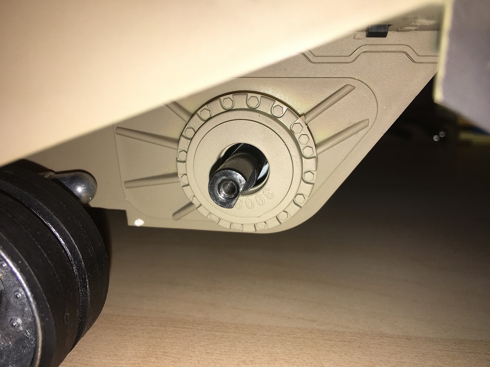

    The opening is ~12mm, and I've attached a photo for reference.

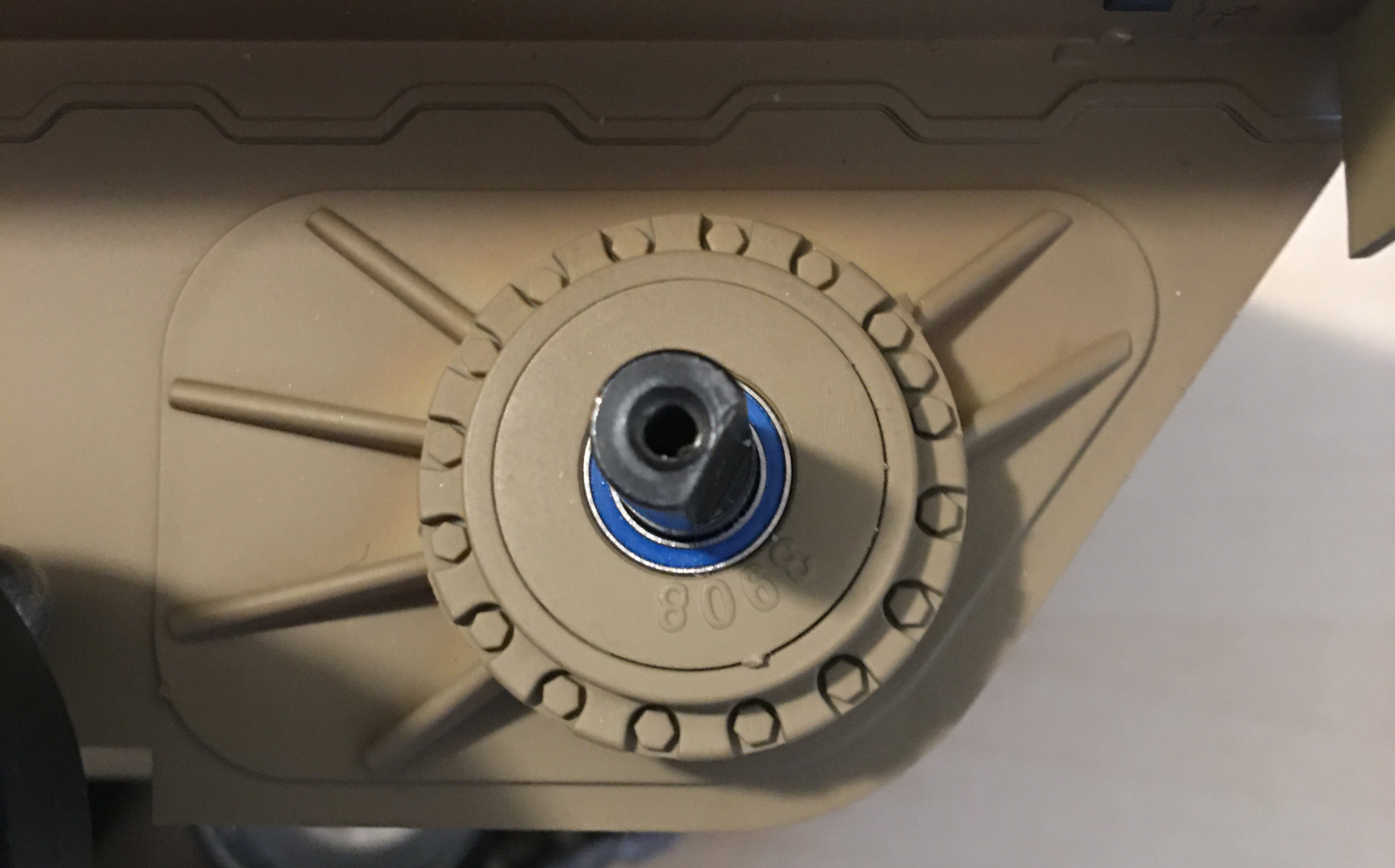

I'm still curious if the bearing carriers I've seen serve a secondary purpose, or if they're only because v6 and earlier tanks had a different size drive axle opening. I'd appreciate if anyone can answer this.
However, just to share some information, a 12mm O.D., 8mm I.D., 3.5mm thick bearing will fit the drive axle opening of a v7 Challenger 2. I used MR128-2RS deep groove bearings from Uxcell.

You mentioned making sure the flanged bearings don't interfere with the tracks, that's what concerned me about some of the 3rd party bearing carriers I was seeing. They stuck out quite a bit, and at least on mine, there's not a lot of clearance between the new built-in bearing carrier and the flat spot on the drive axle. I was concerned the ones I'd seen would push the drive sprocket out. If I pick up an older model again, I will use flanged bearings on them.

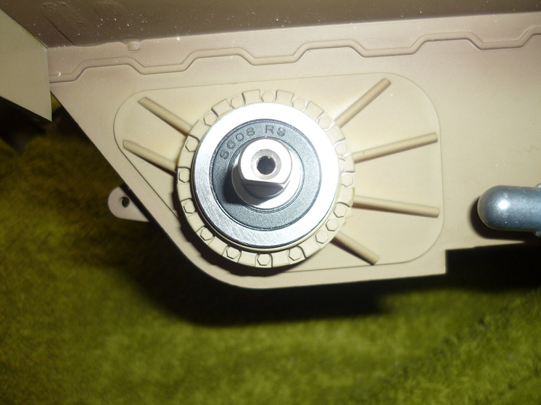

Re: 7.0 Challenger 2 support bearings
good morning, heres the flange bearing as fitted to my challenger 2
