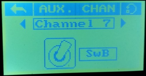

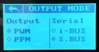

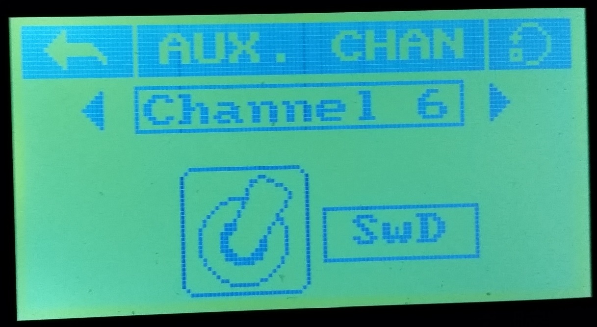

How to Setup FlySky i6s Radio with a Clark SBUS TK Board
Plug the FlySky FS-iA10B or FS-iA6B receiver wire from the TK board into the receivers port labeled as SERVO.
NOTE – This will apply only to CH1 of the TK40/TK50 series board if there are multiple receiver leads. Other receiver leads will not be connected in this scenario.
NOTE – There will be only only receiver lead from the TK board for TK60/TK80 series boards.
Make sure the receiver wire is plugged in correctly.
NOTE – The metal contacts will face outwards and the wires will generally be colored from left to right – black, red, white.
On the FlySky i6s radio, tap on the Settings icon.
Tap on the System menu tab
Tap on the Output Mode menu tab, then tap on both PWM and S.BUS.
PIcture at foot of page .

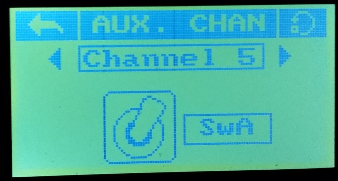

Tap on the Function menu tab, then tap on the Aux. channels option.
Tap on channels 5-10 and assign as follows:
NOTE: Channel 9 is your main cannon and MG1. Swap the channel mapping, with CH9 to VrA and CH10 to VrB to map main canon to VrA.
To set your drive stick as the RIGHT stick – under the System menu, go to Sticks mode, and set as M2
To set your drive stick as the LEFT stick – under the System menu, go to Sticks mode, and set as M3Tap on the Function menu tab, then tap on the Aux. channels option.

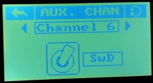

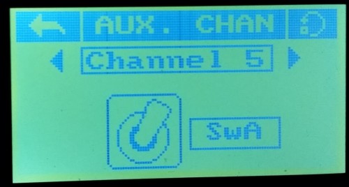

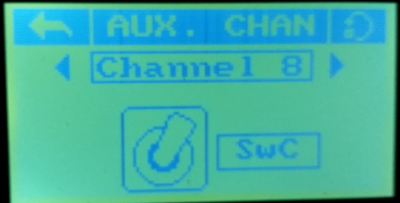

TK24S dedicated page .
S.BUS setup ( FlySky i6S )
Transmitter:
1.Turn on Transmitter i6s and enter setting function, go to system->output mode, than set Serial to S.BUS
2. Enter aux channel setup, set channel 5 to SwA, channel 6 to SwD, channel 7 to SwB, channel 8 to SwC, channel 9 to VrA and channel 10 to VrB,
3. Go to system->stick mode, then set to M1 mode,
4. Go to end points page, set end point to 100% for every channel.
Receiver and control board:
1. Plug connector with S.BUS label on it into S.BUS port on receiver.
Transmitter:
- sbus menu.jpg (48.89 KiB) Viewed 3538 times
