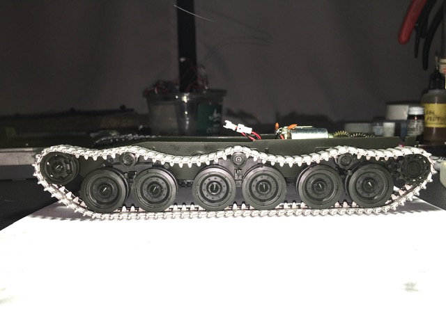

Track adjusted and ready to run
This model allows adjustment of the track via 1 screw and has enough adjustment to instal the track with the wheels and sprockets installed

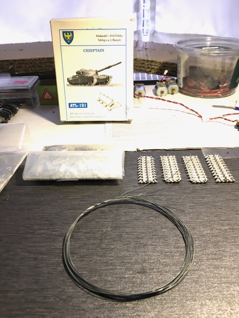

40 links and counting.
It is very exciting to see a metal track tank build on my work bench.
200 Individual track links to assemble.

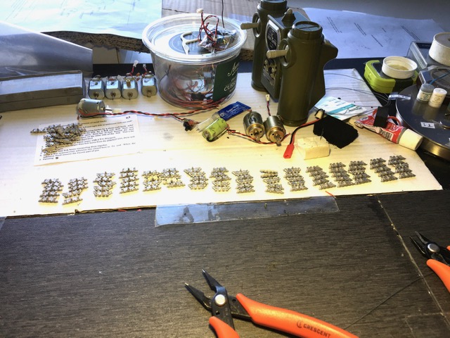

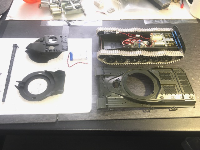

80 track links ready for assembly. About 97 are needed for each side. There are a few steps involved to get the links to this point.

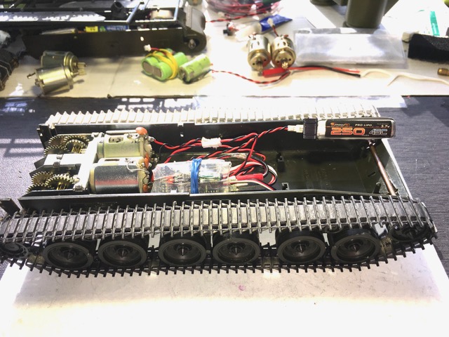

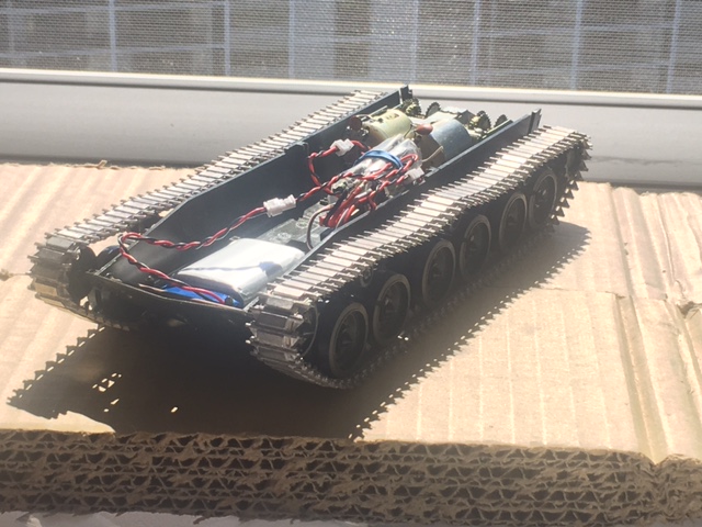

DSM 2 6 channel radio installed and it is now a runner! Notice that small Li-poly, it is more than enough to do the job.
I was eager to test this track so I only built one which took all day and used the supplied poly track for the right side and was able to test and the result was very good. so now it is worth building the right side.
The Tamiya Chieftain motorized remote control model makes this metal track conversion a snap and saves a lot of time and time is money so IMO it was worth the expense to buy this tank as it got me a metal ITL Tank pronto! One screw allows both tracks to be adjusted at the same time. This is ideal for metal track adjustments IMO.

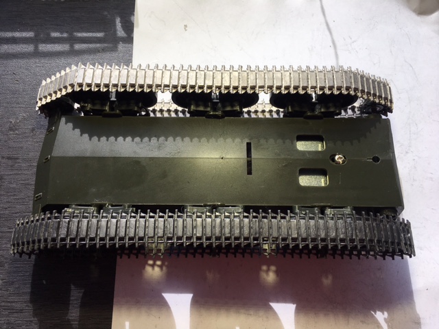

91 track links per side. The Chieftain Mk.5 Friulmodel track kit is EXCELLENT and so is the model itself. I feel this model is an excellant candidate for metal track upgrade.

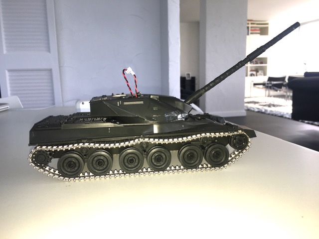

getting ready for body assembly
test complete next phase ready
tracks test run a total success

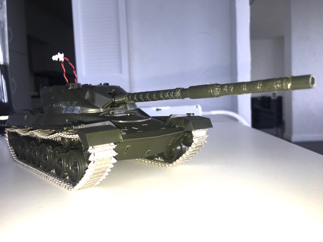

body is mounted and is ready for final assembly. Track tension is easily adjusted with one screw thanks to the gearbox mount design.
