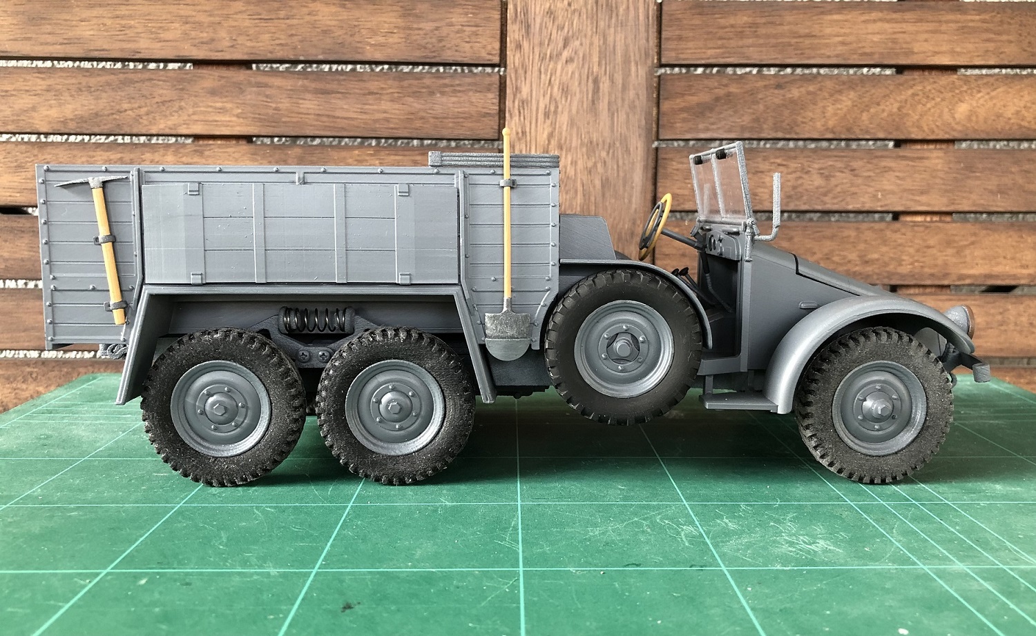

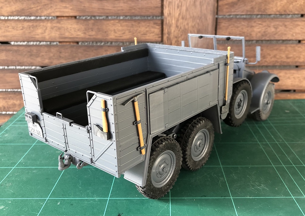

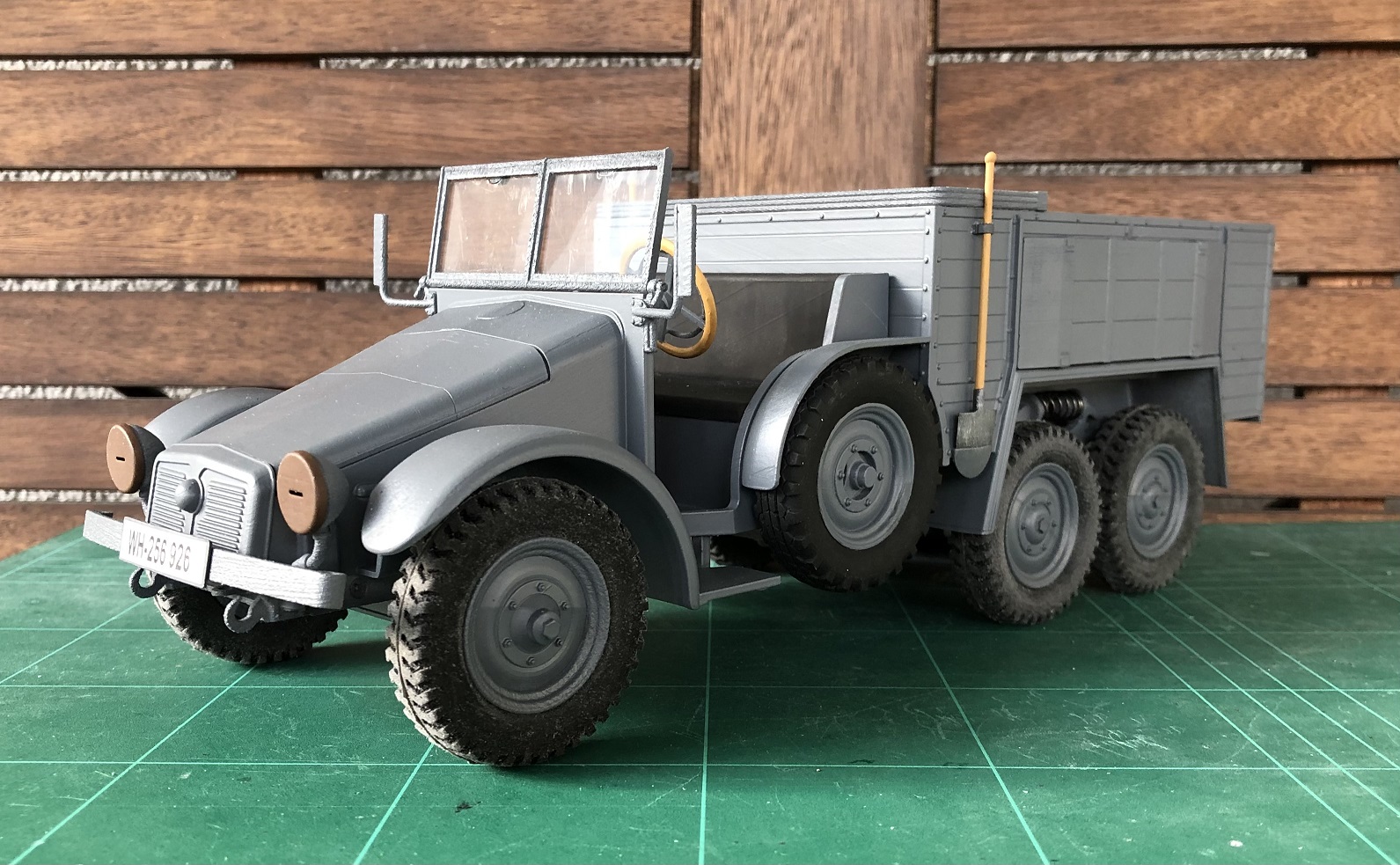

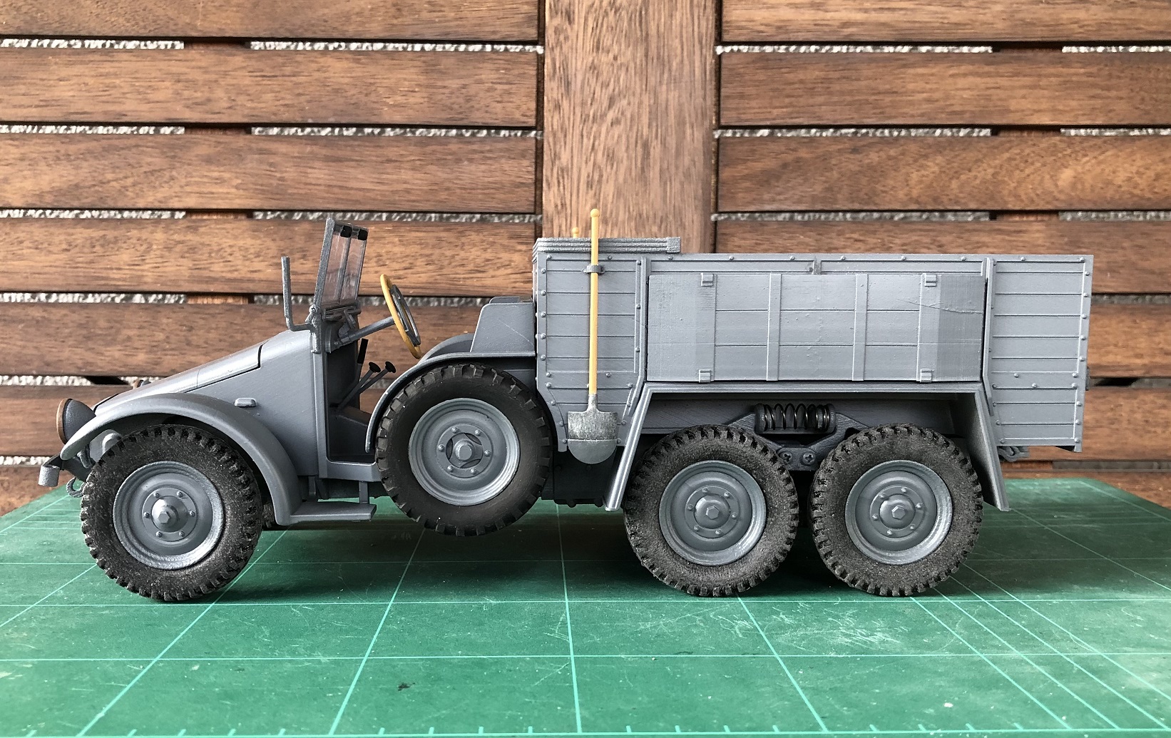

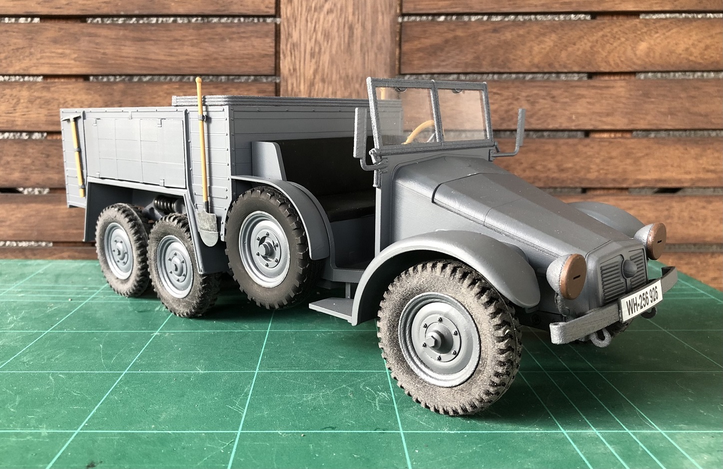

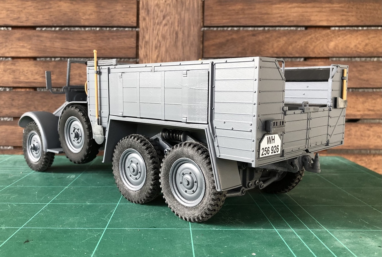

Something new to post. This time it´s not an AFV because I wanted to do something of support troops:
The German light truck Krupp Protze.

Another fantastic build from you :)

Tell us more, please. Did you build that from 3D printed parts? scratchbuilt? Just how did you do such fine modeling? What electronics does it use?

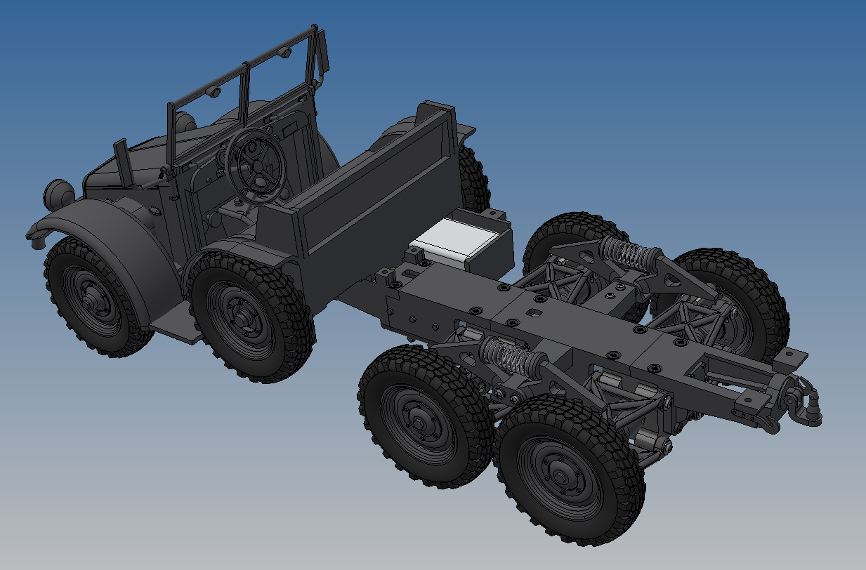

Herr Dr. Professor wrote:Tell us more, please. Did you build that from 3D printed parts? scratchbuilt? Just how did you do such fine modeling? What electronics does it use?

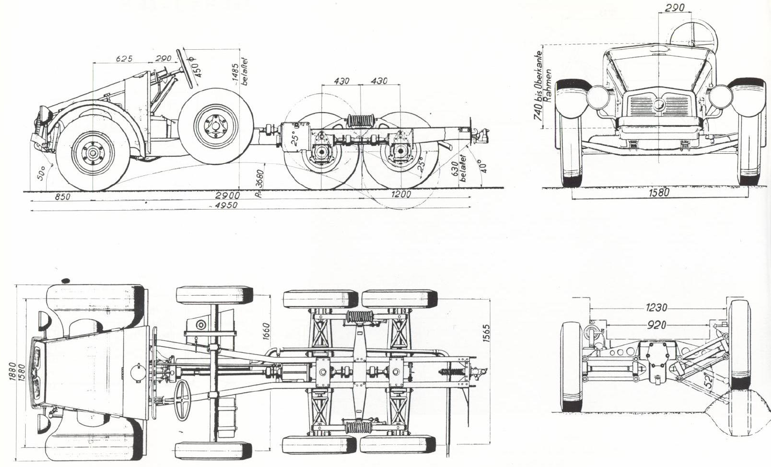

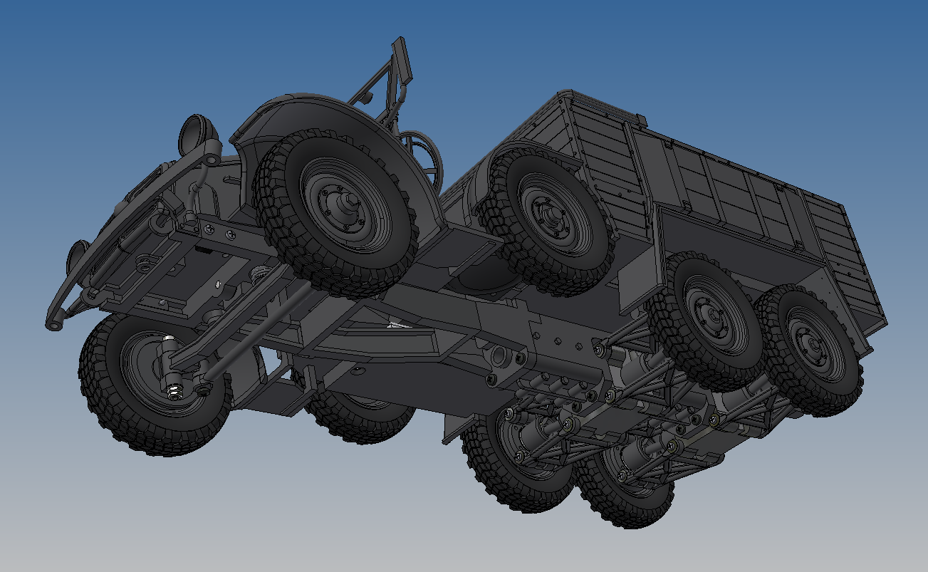

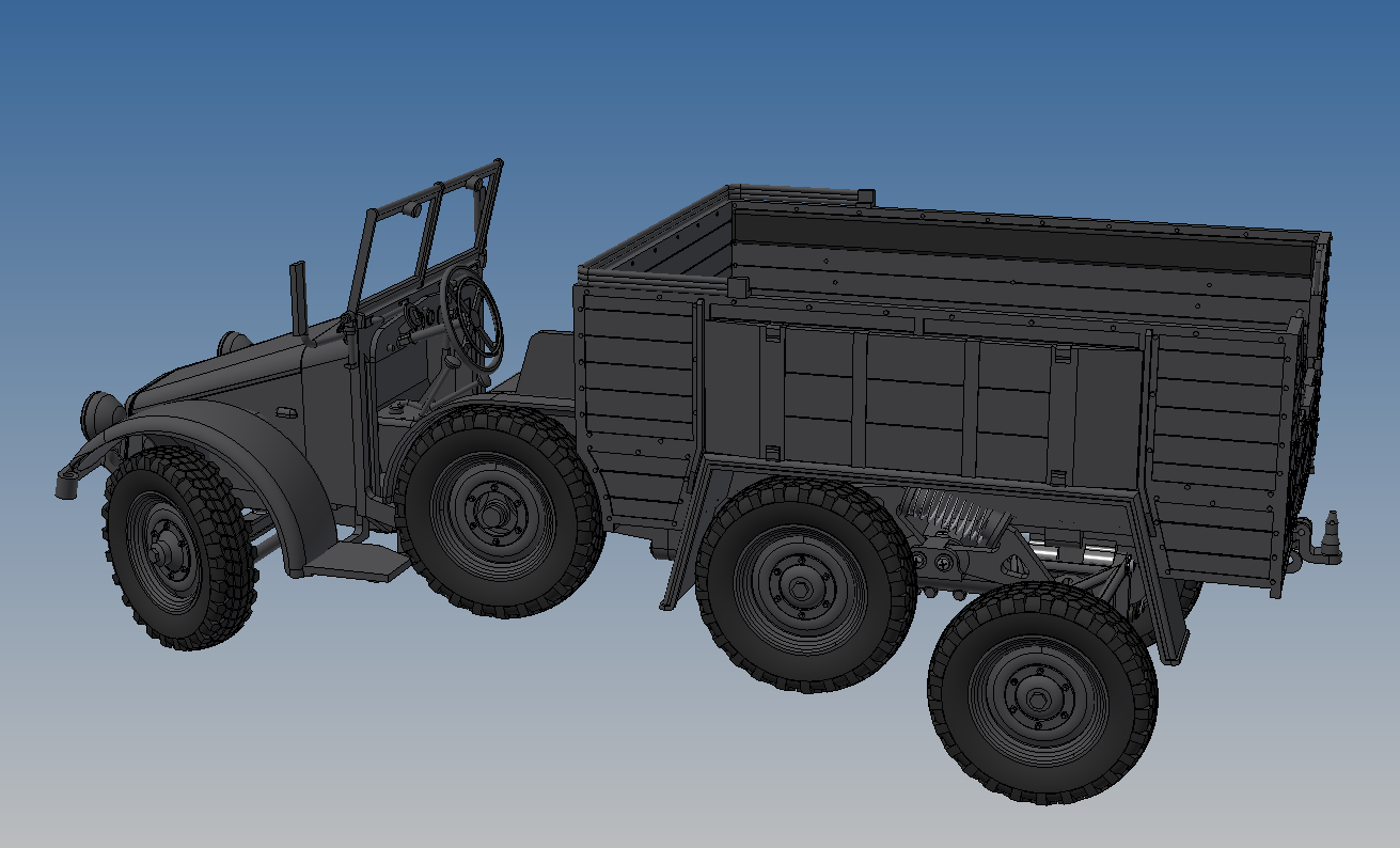

Yes, it´s all 3D printed. As usual I´ve made the overall design, but this time, no WPL parts were used. It wasn´t possible to get a good solution for the rear axles, so I tried to "copy" the original design

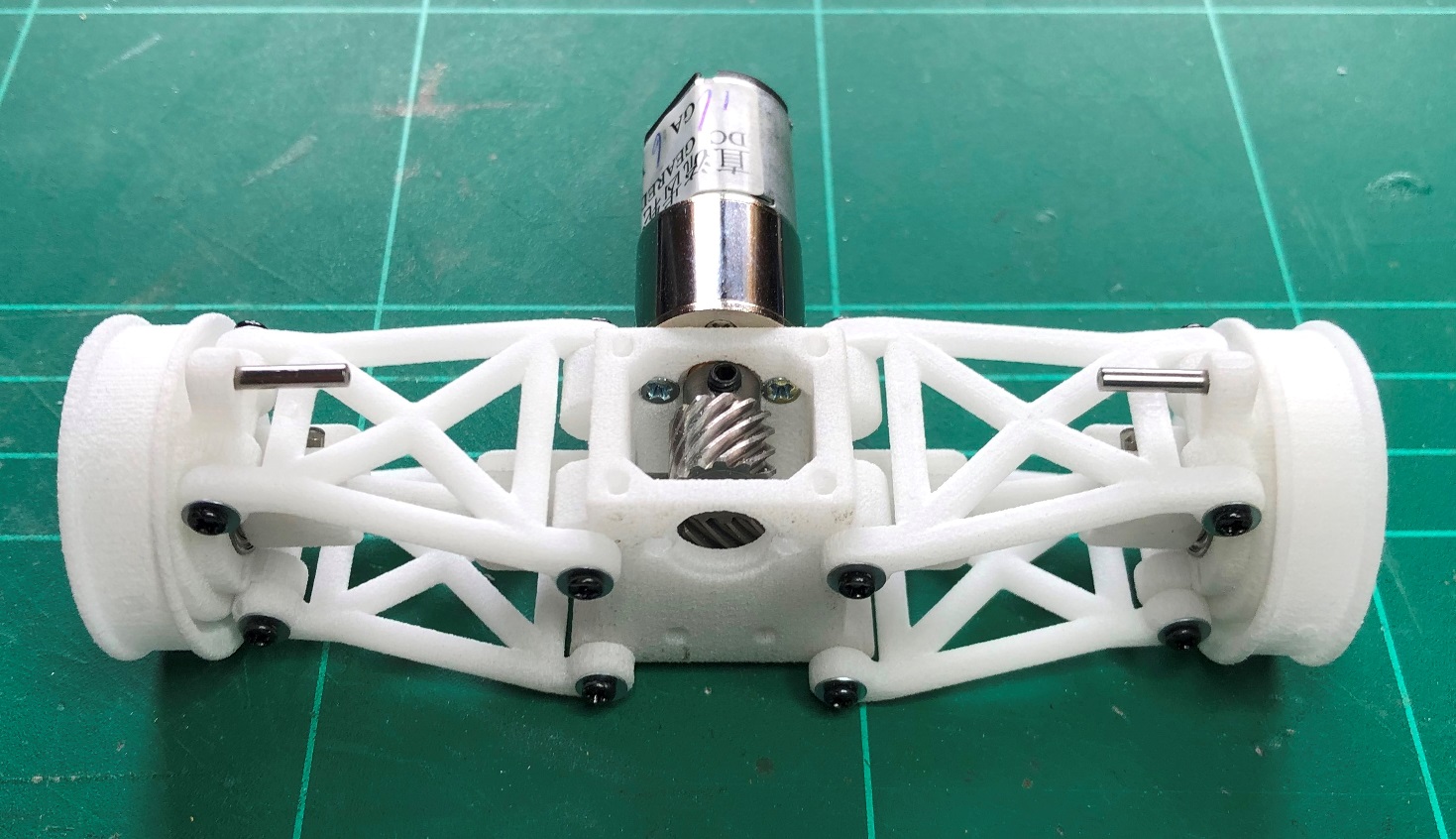

Rear axle:

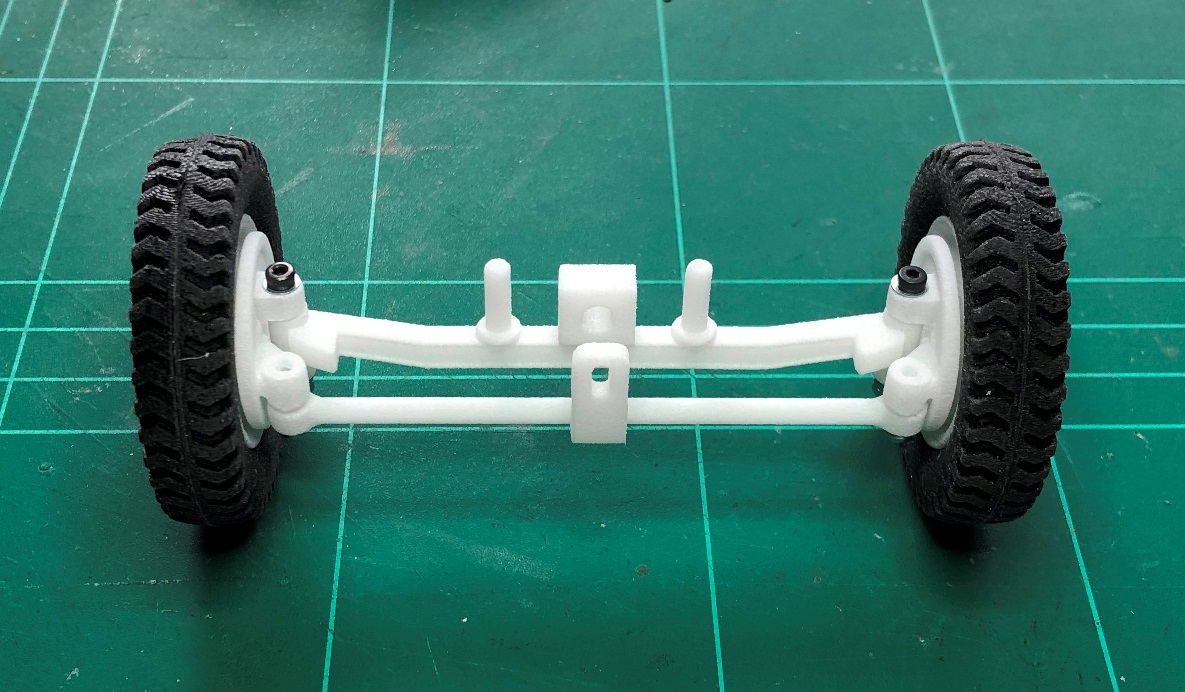

Front axle:

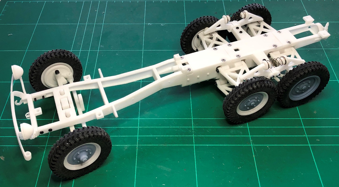

The whole chassis:
more information will follow...
