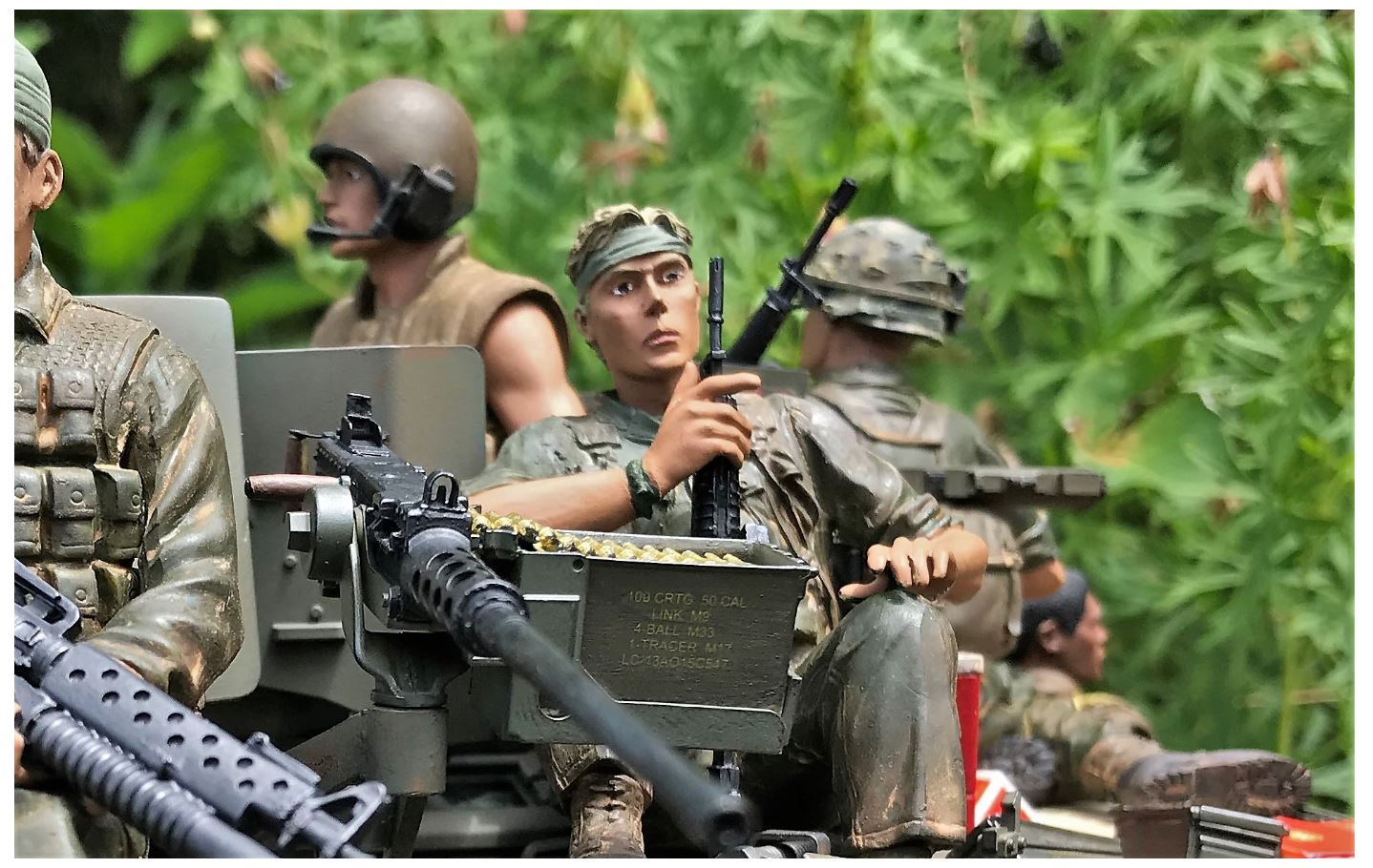

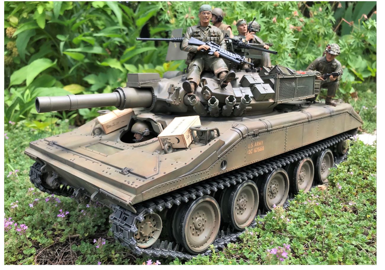

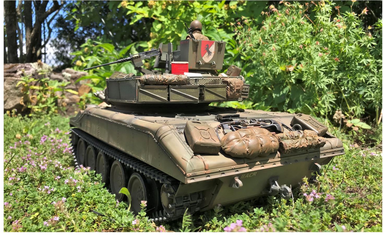

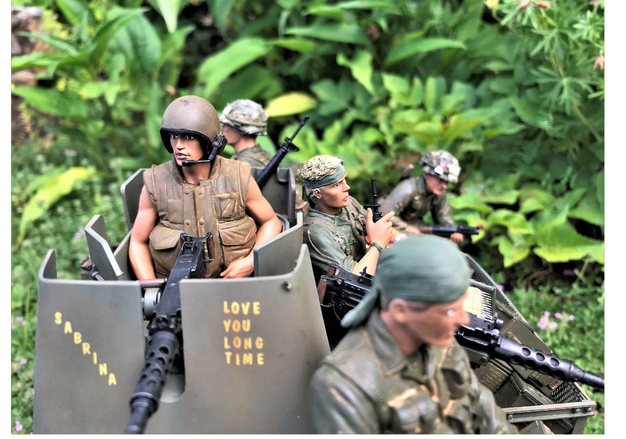

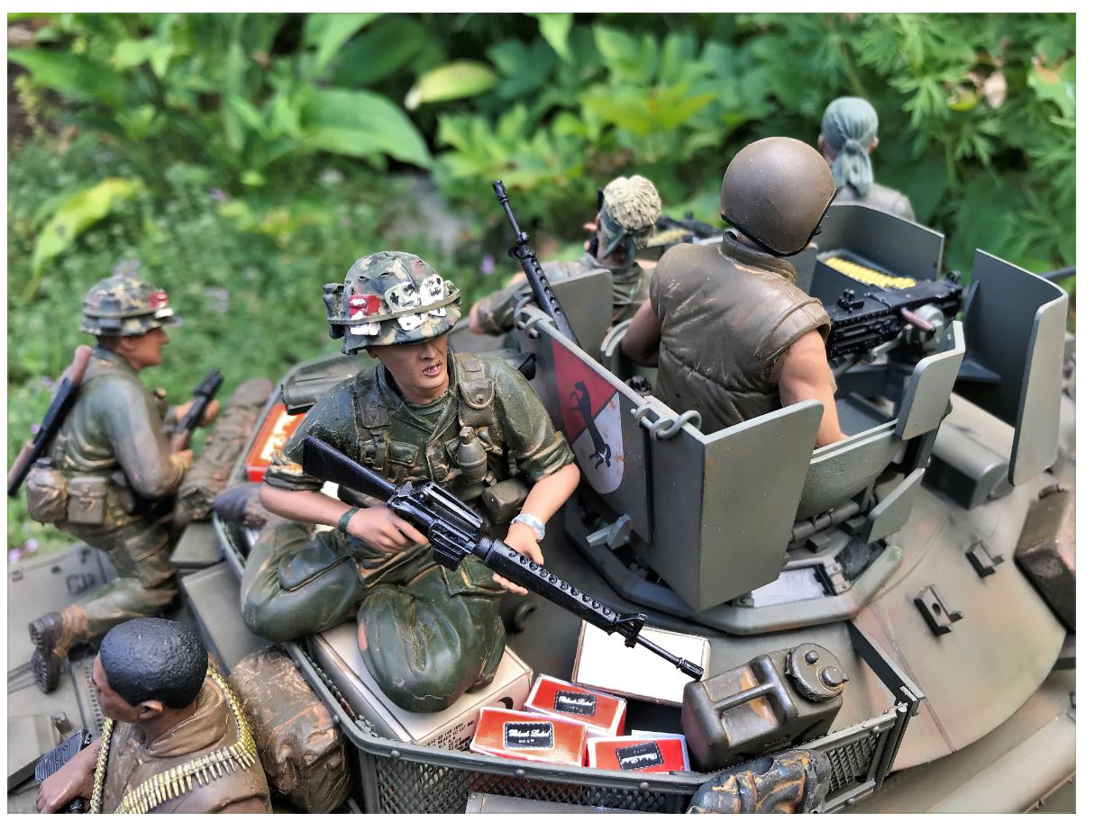

NUMBER 1 January 2021

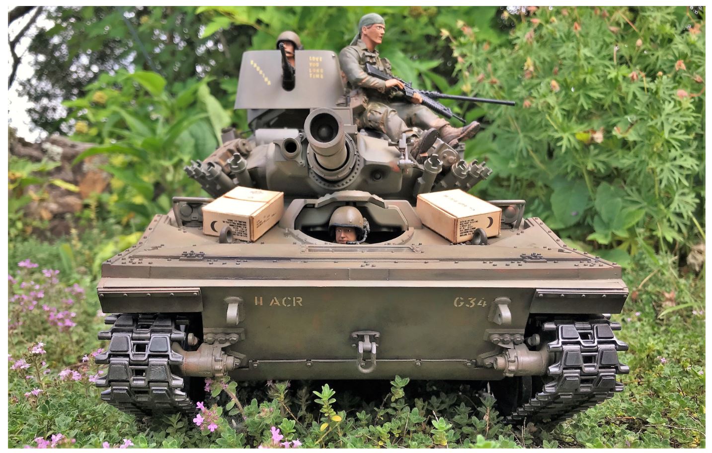

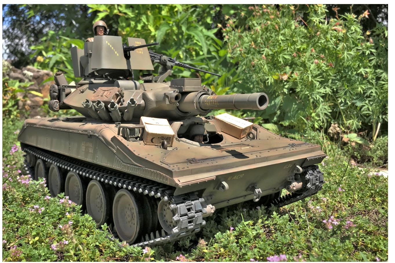

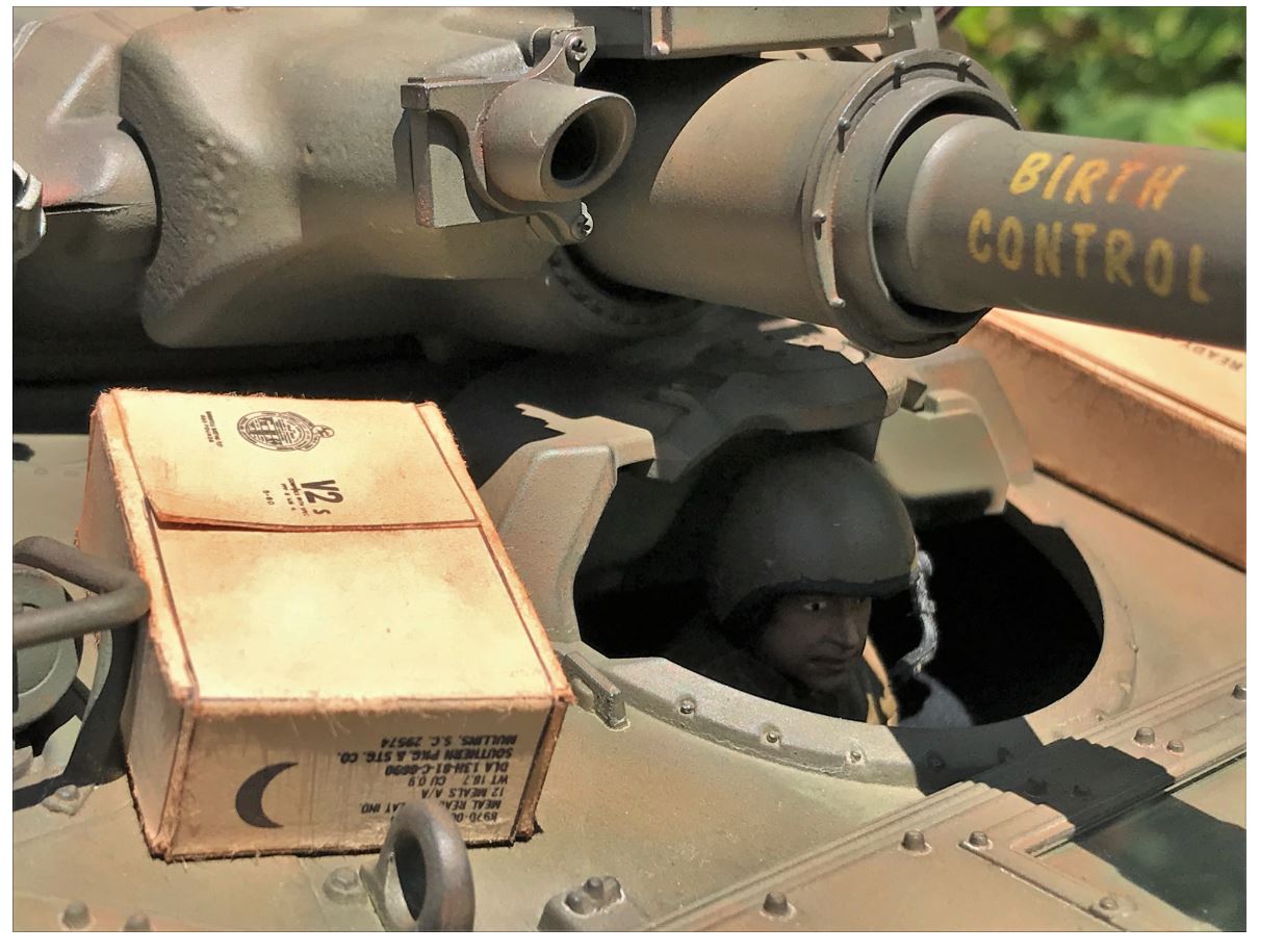

To warm up the winter, here is a Vietnam era Sheridan. Its the Tamiya static version converted to RC with Clark control board, Mato gearbox, Vietnam modifications, etc. The figures and accessories are conversions from Sol Models, Verlinden, Dragon and other. Pictured in my wife's garden last summer.
Regards, Louis
Regards, Louis

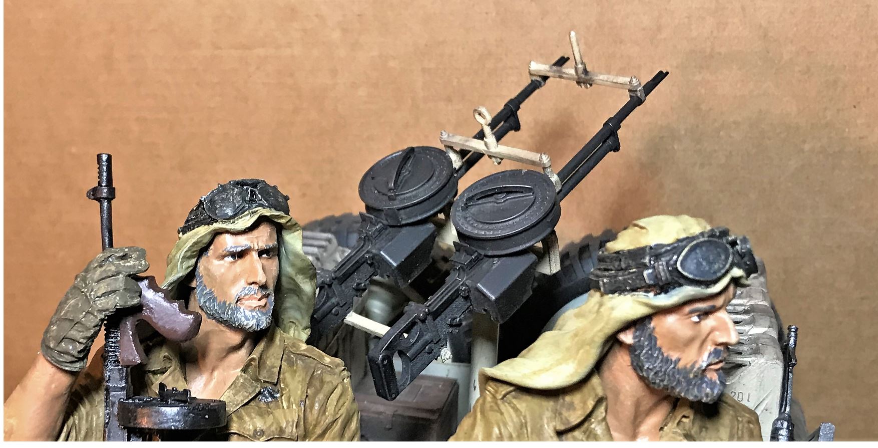

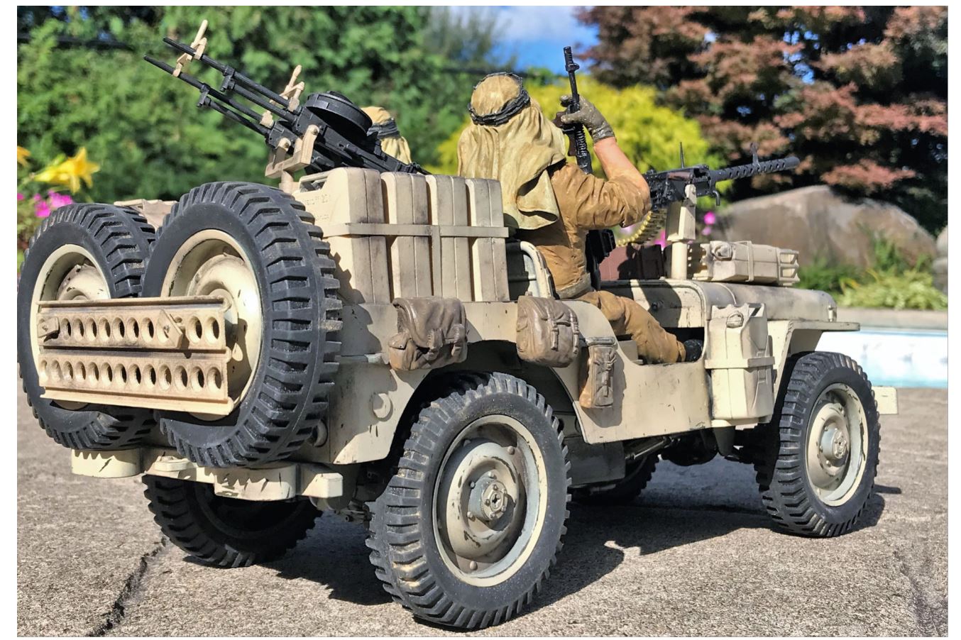

NUMBER 2 February 2021

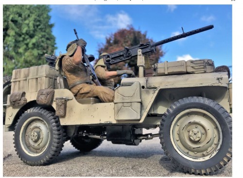

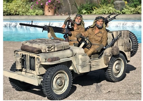

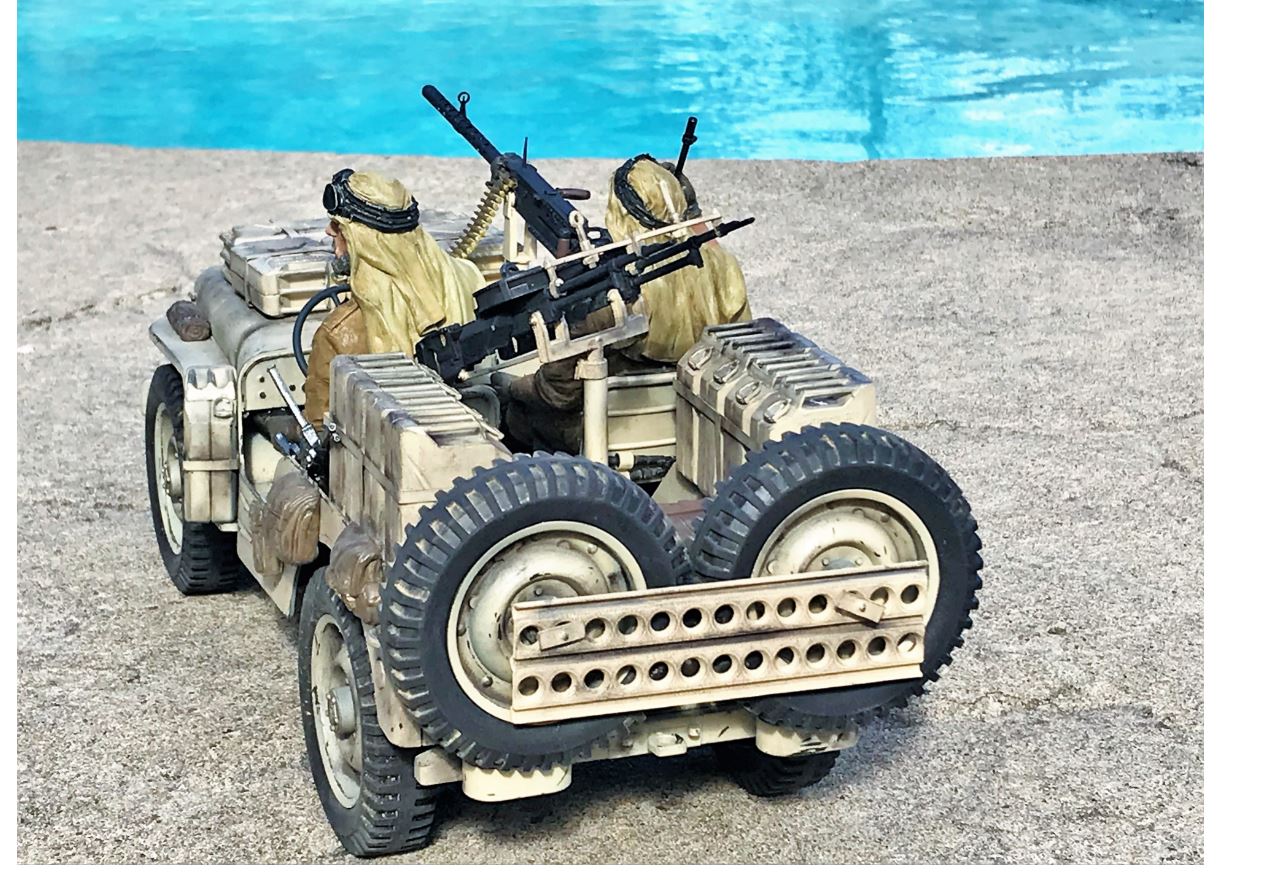

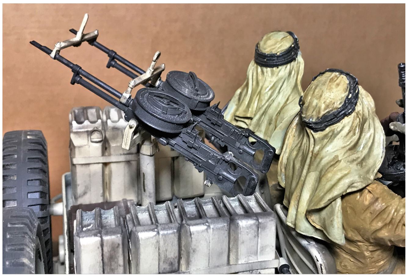

Here is a RC 1/10 WW2 British Desert SAS Jeep.
I was always impressed by the SAS "Soldier of fortune" look and feel, open Jeep, loaded with machine guns and fuel. Who would not want to take an afternoon ride with these guys.
This is a highly modified 1/10 scale Q65 truck. First, I made it a real crawler by replacing the very small motor and gearbox with a WPL gearbox with 370 size motor. Then i reworked the axels and suspension to be at the proper spacing and height. Jerrycans for the SAS transformation come from Ebay Germany Dioramaparts and Shapeways provided the twin K machine guns. As it was really weird to see an open Jeep driving itself, two figures were created from 1/10 resin SAS figure busts available on eBay, which were mounted on a modified 1/10 action figure body and integrated on a best effort basis. The .50 cal machine gun came with the resin SAS gunner bust figure. One main issue with the Q65 is the scale and dimensions, a mixture of 1/9 to 1/12 scale depending on the section being measured. The build can be seen at viewtopic.php?f=23&t=30146.
Regards, Louis
Regards, Louis

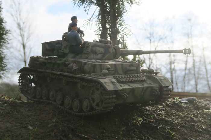

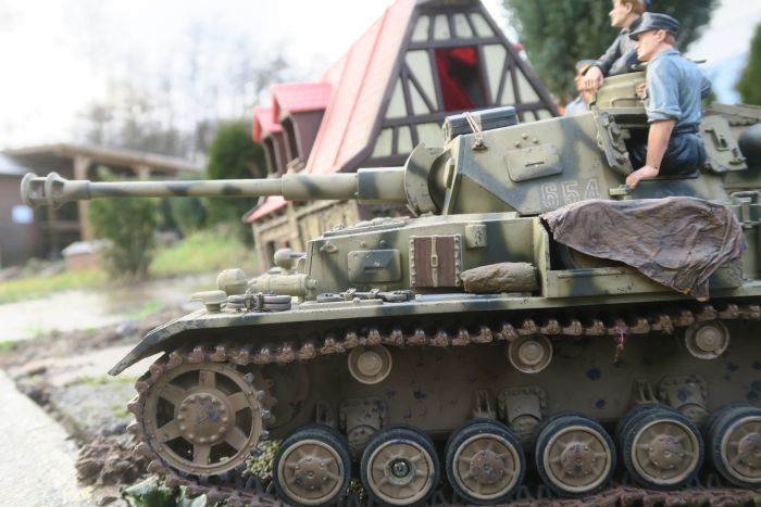

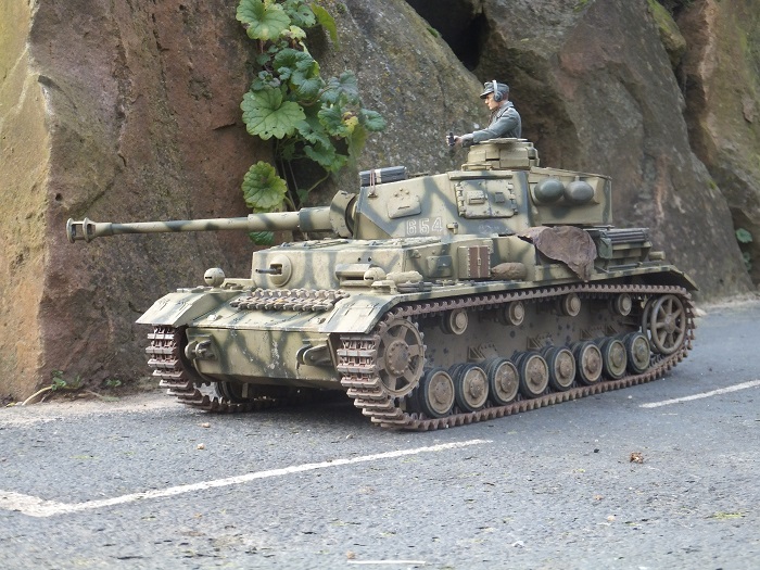

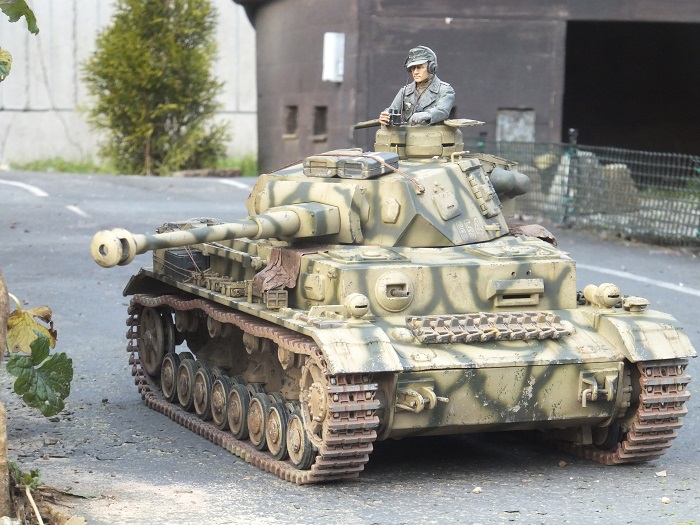

NUMBER 3 March 2021
xhelfix

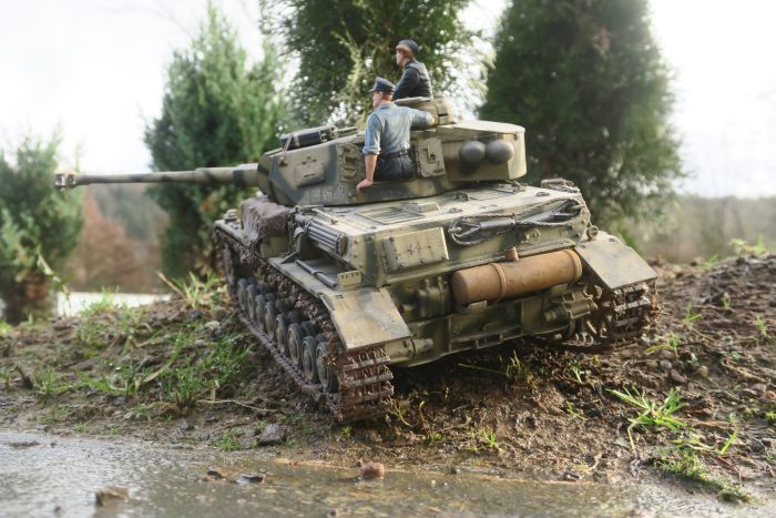

good evening,
so i will join in the party with a P4. Made some jears ago.
Its a Heng Long P4 upgradet with some detais, other gearbox, Elmod is working inside.
Paintjob and smal stuff around.
Also 3 mans of the P4 crew from licmas-tank.
So her are some pics, and a smal video
Greetz, Andy
xhelfix
good evening,
Greetz, Andy

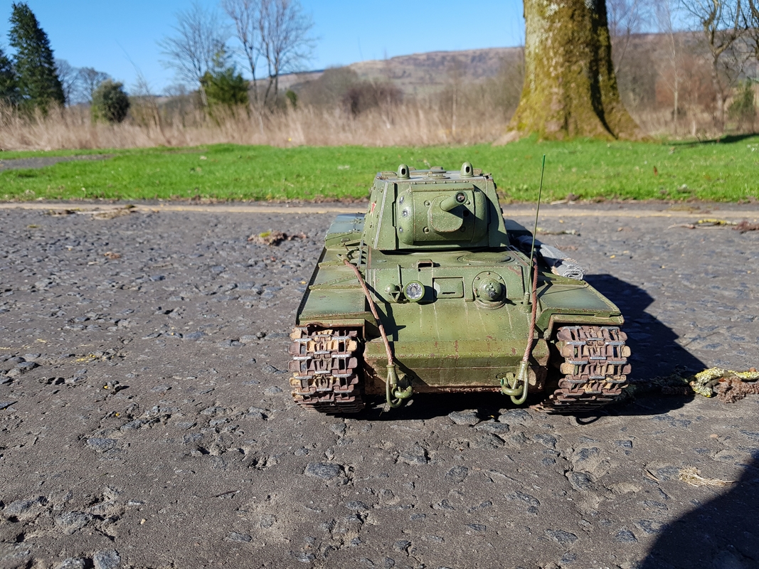

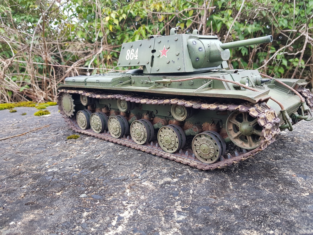

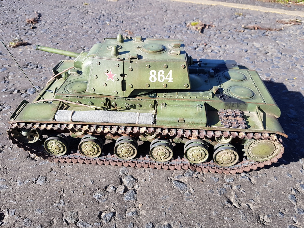

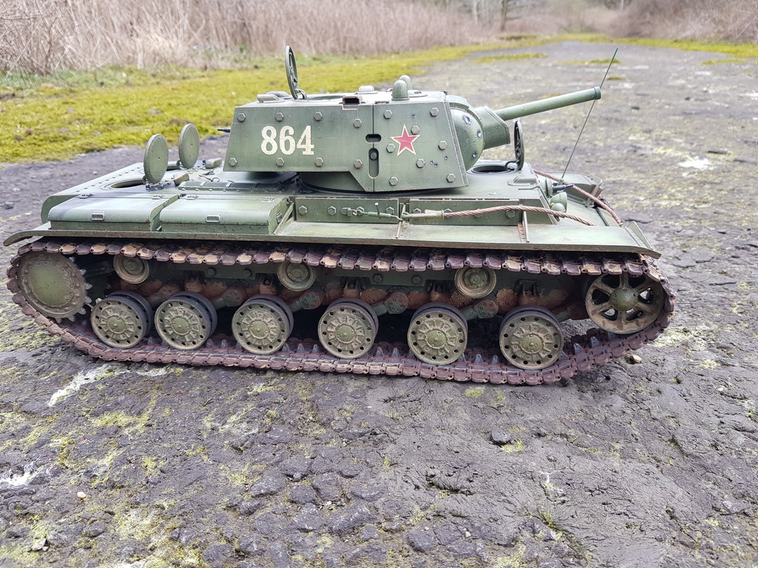

NUMBER 4 April 2021

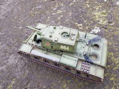

Captain Hilts
Hello,
This is a torro KV1 . I have done a small amount of detail , like mesh air intakes , bolt hooks on rear , filled in bits , and cut off bits ,like the circles on the roof ,remade the front light and added a smaller cooler led that gives a more vintage glow , made the antenna and engine cover cable and hook , it has a main gun flash and machine gun flash, and I also added 4 opening metal hatches. I gave it a repaint and weathered then added some hits . Also installed the Taigen series 3 5.1 metal gearbox and covered . Then fitted it with the Elmod Eco and connected the only servo to the main gun recoil . Also fitted the full Elmod IR battle system and fitted a Tarr smoker . Also made a new KV Sound set , all start ,drive ,stop, brake , gearchange revs etc all taking from real tank sounds and put in , also 24 user sounds installed , you can find the build thread here viewtopic.php?f=23&t=31417 . Also put all the sounds on the Elmod forum .
Must admit that this is my first attempt at modelling for about 40 years when I was a kid and even then I didn't do much . so pitting myself against a master modeller like Imcq11 and the superb SHANTY IRISH is a bit like Mr Bean going 12 rounds with Conor McGregor , in 1 corner the naive eejit and the other the master engineer . But it's about showing off what we're proud off , and I'm good at that! . And Imcq11 , I am also going to use that moving gun idea in my tiger and I've already ordered some dark steel pigment for my Sherman . Love your Stuart.
Captain Hilts
Hello,

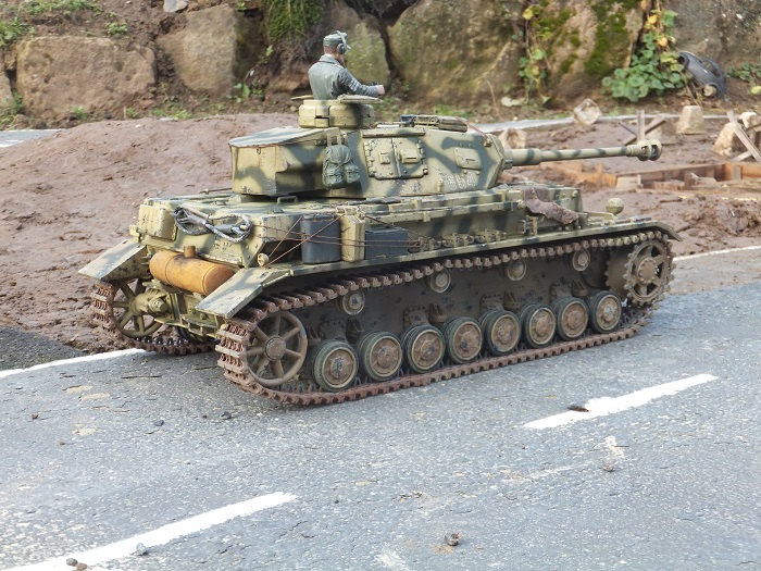

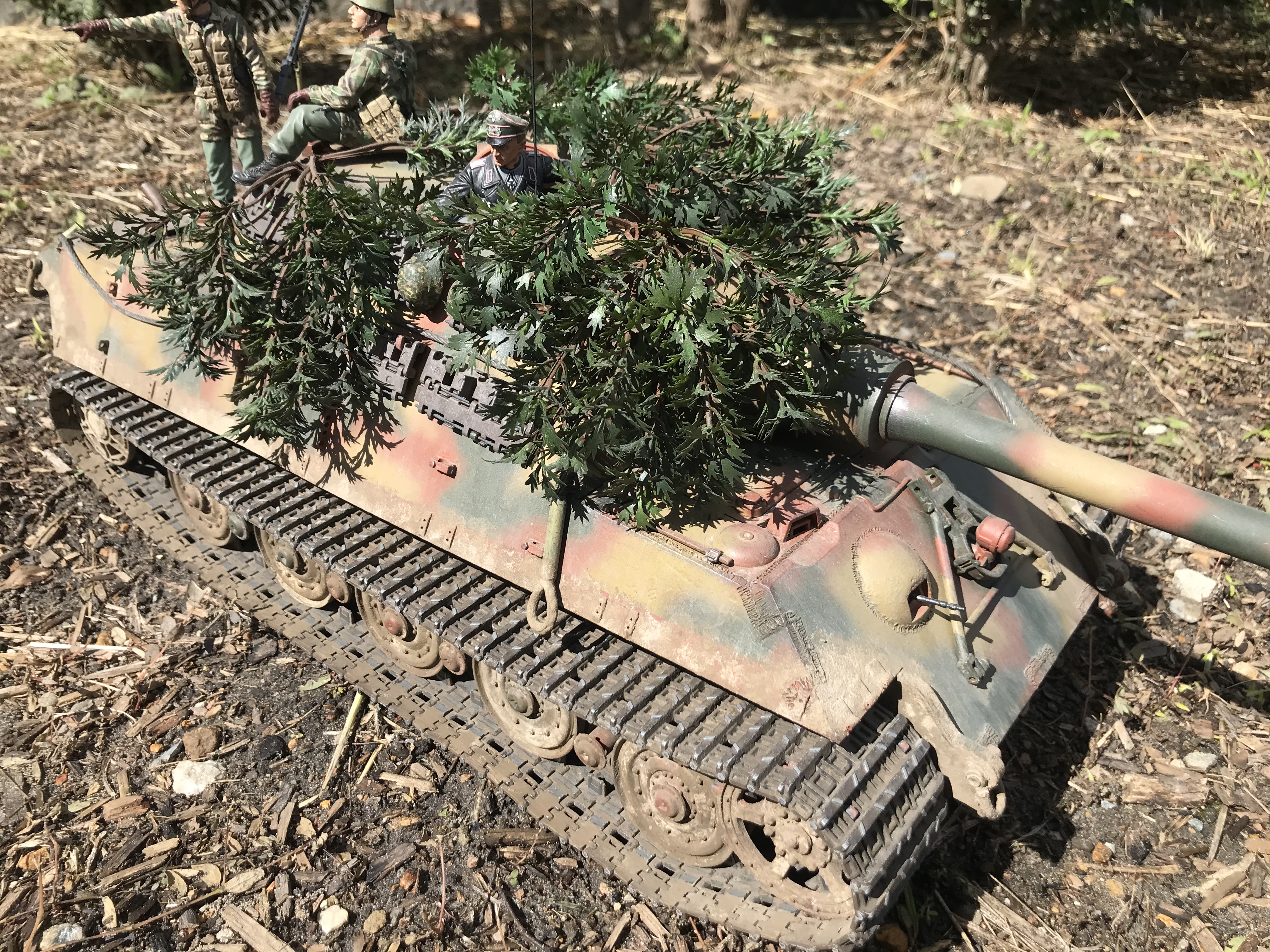

NUMBER 5 May 2021

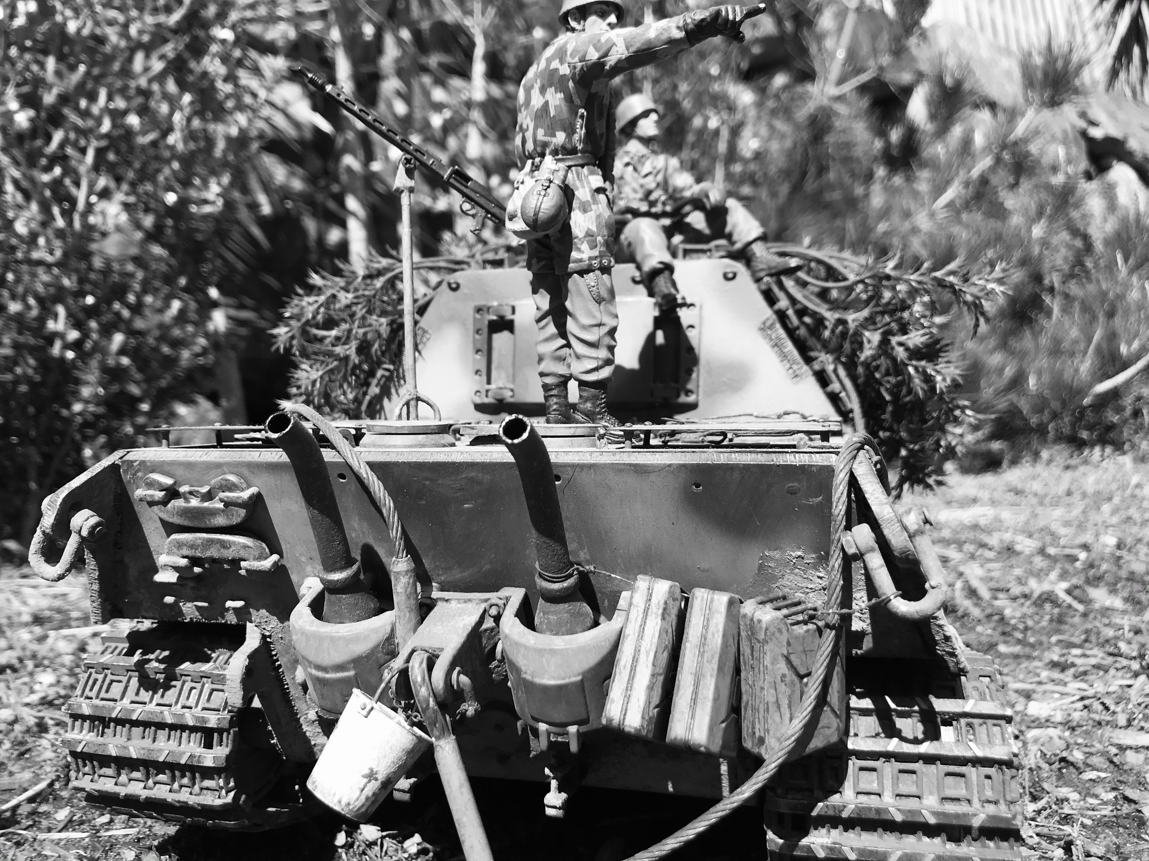

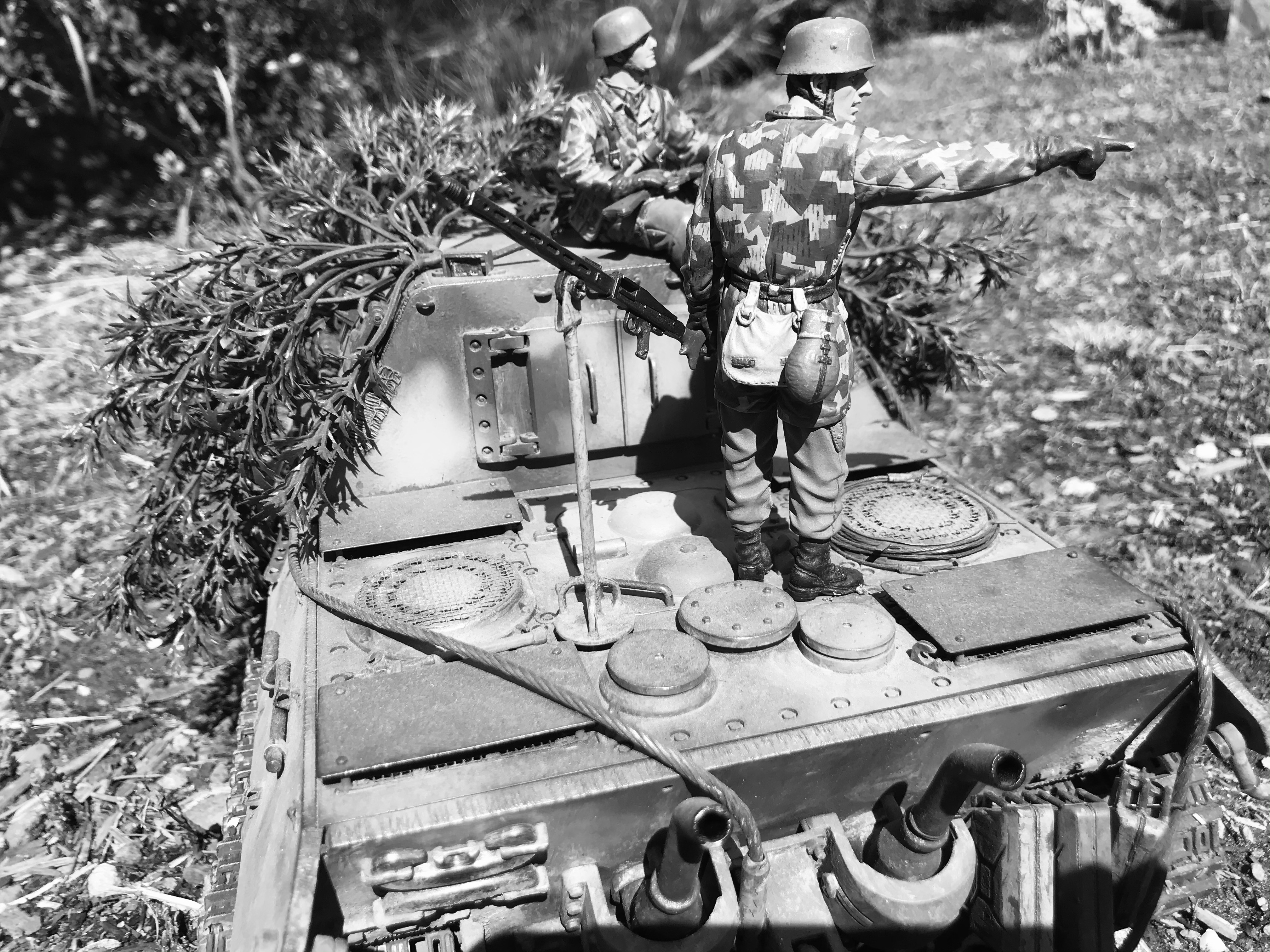

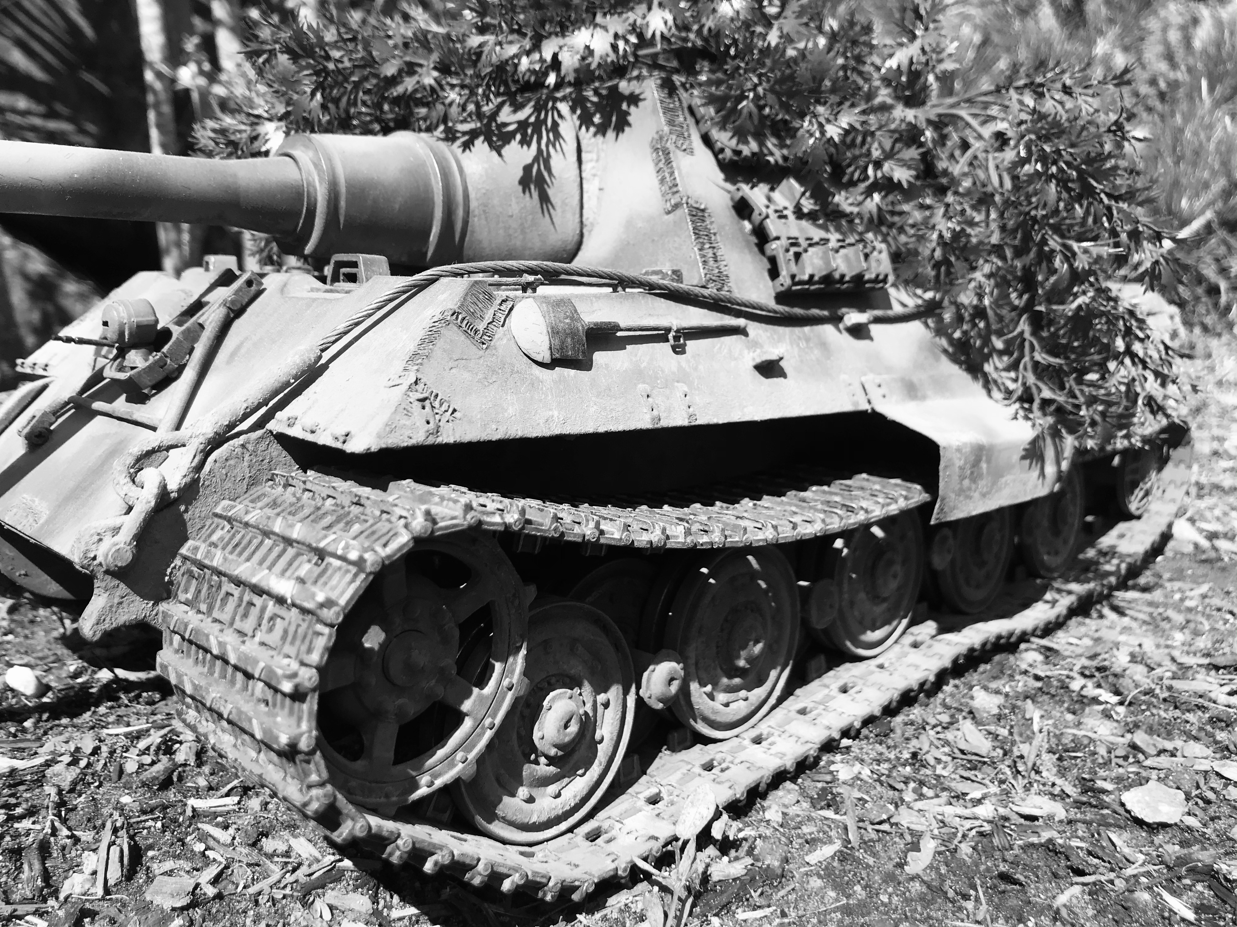

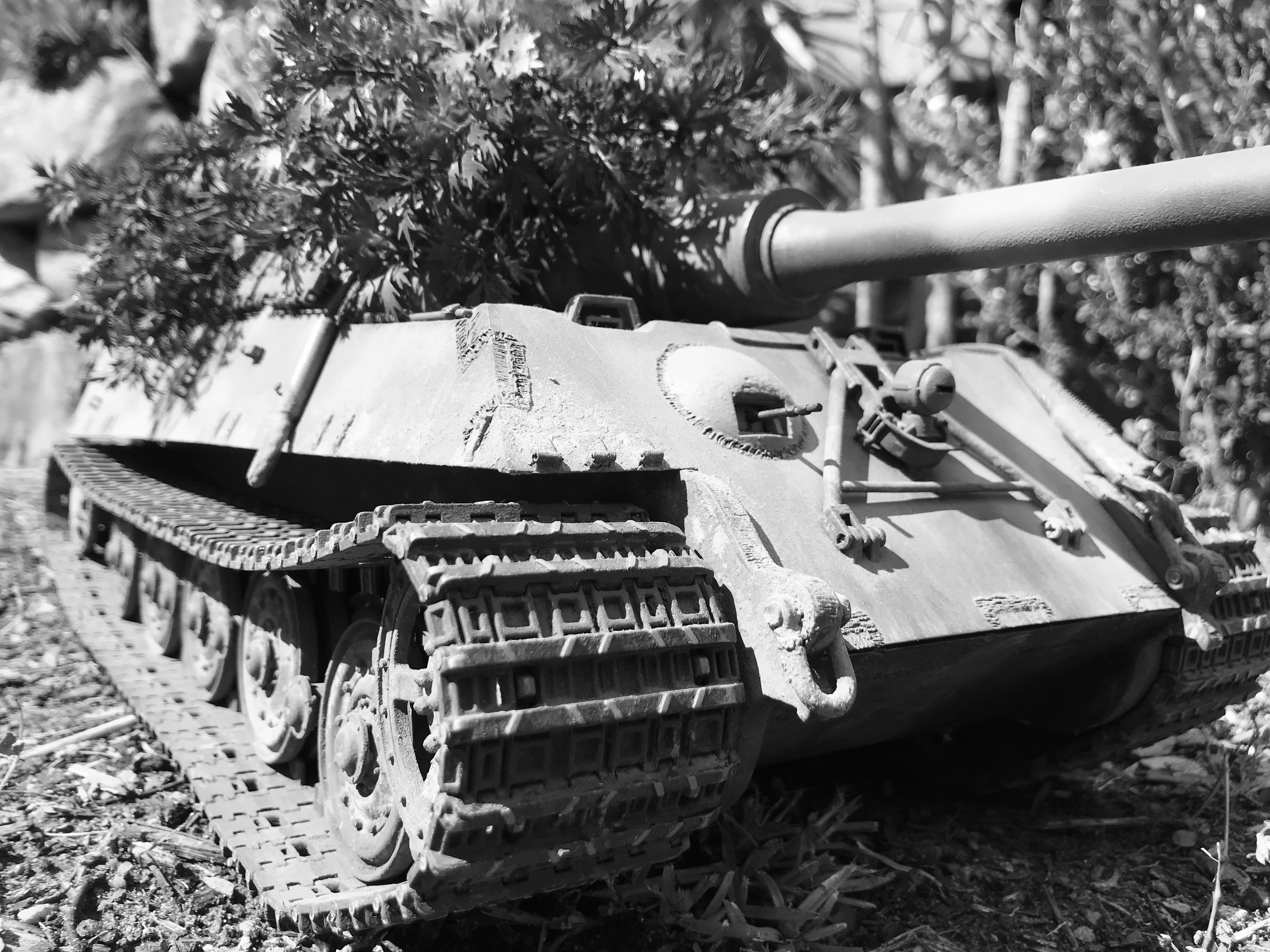

I will have a go:
Mattoro Jagdtiger conversion
Upper by Mattoro, lower by Torro( thanks Mr Jackalope) both cut and lengthened.
All metal running gear
Barrel and mantlet from Tank-Modelblau DE
Taigen elevation & recoil unit
Tow hitch from Mr Sassgrunt
Running IBU2 control system.
Patience by Jack Daniels
Painted, weathered & photographed by me.
(pics will allow zoom once opened)
Build thread here
viewtopic.php?f=23&t=20170
I will have a go:
Build thread here

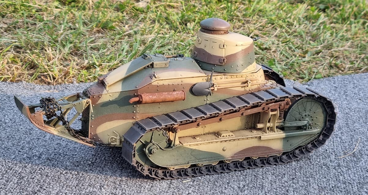

NUMBER 8 August 2021

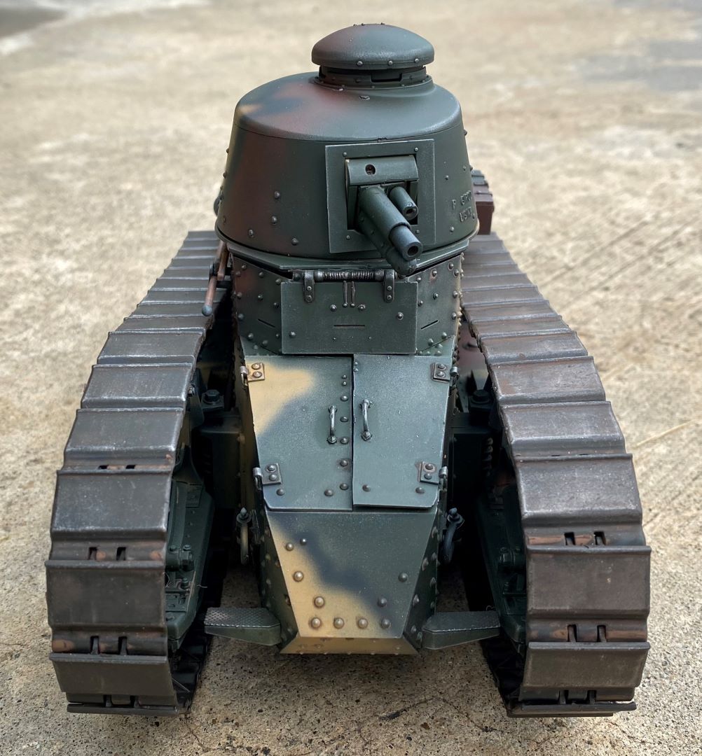

Kaczor

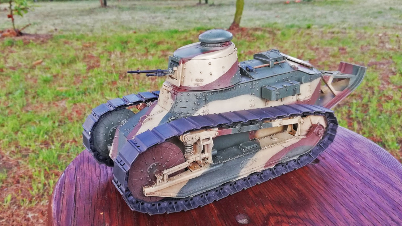

My Takom's Renault FT in Polish 1939 camo. Build thread:
viewtopic.php?f=23&t=30823
Kaczor

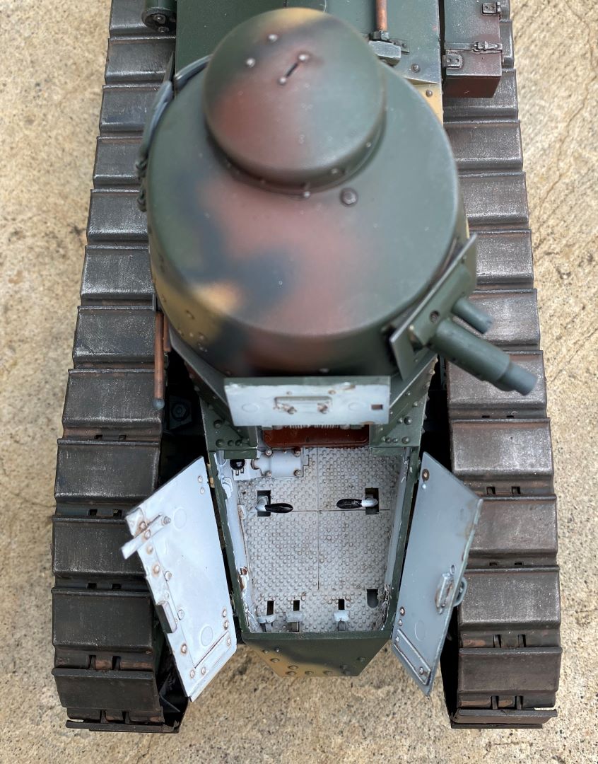

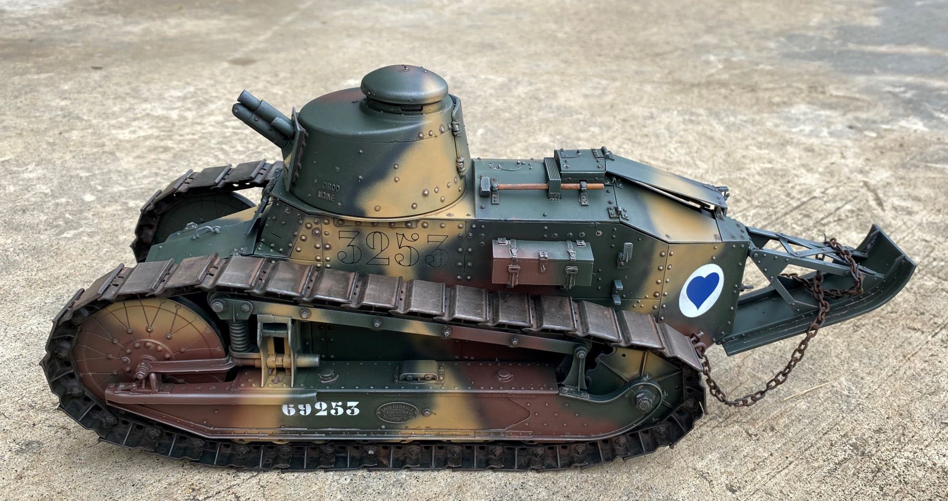

NUMBER 9 September 2021

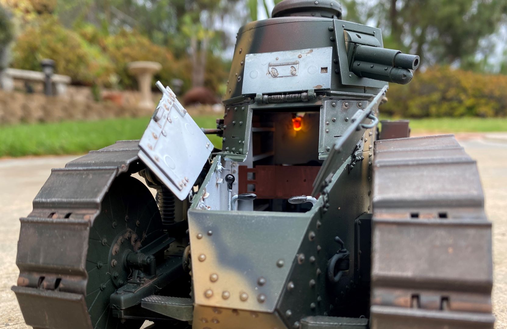

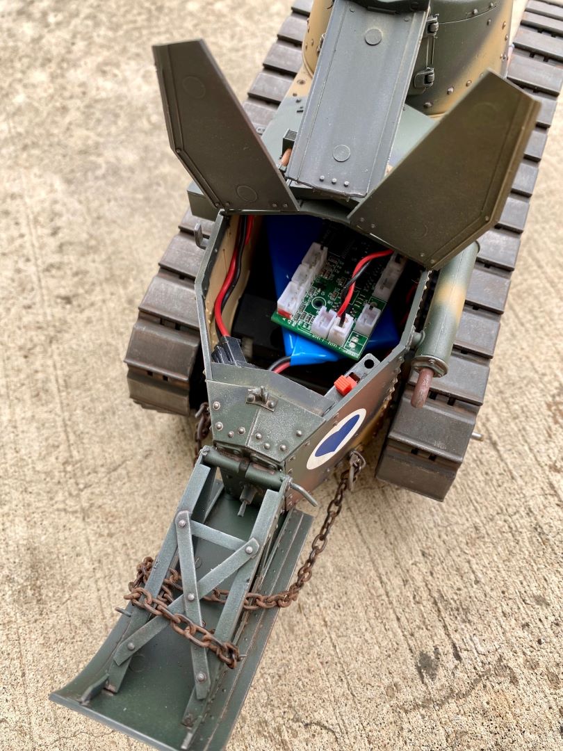

SoCalBobS

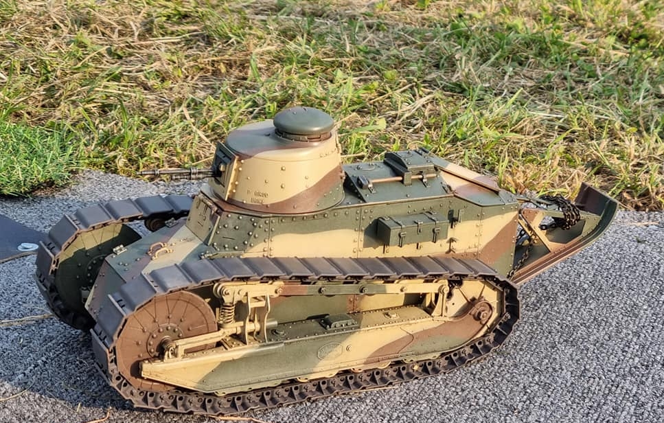

I'll start! Takom 1/16 scale Renault FT static plastic model converted to radio control. Details in my "Renault on a Budget" thread. Heng Long 1:30 motor and electronics. In lieu of turret rotation, I chose to detail the crew compartment. Crew and engine hatches made to open.
No headlight on this tank, so I placed a light inside instead. A Youtube video showing it action. Full disclosure, it's slowed down a bit!
SoCalBobS
