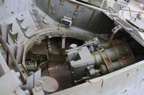

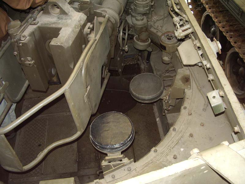

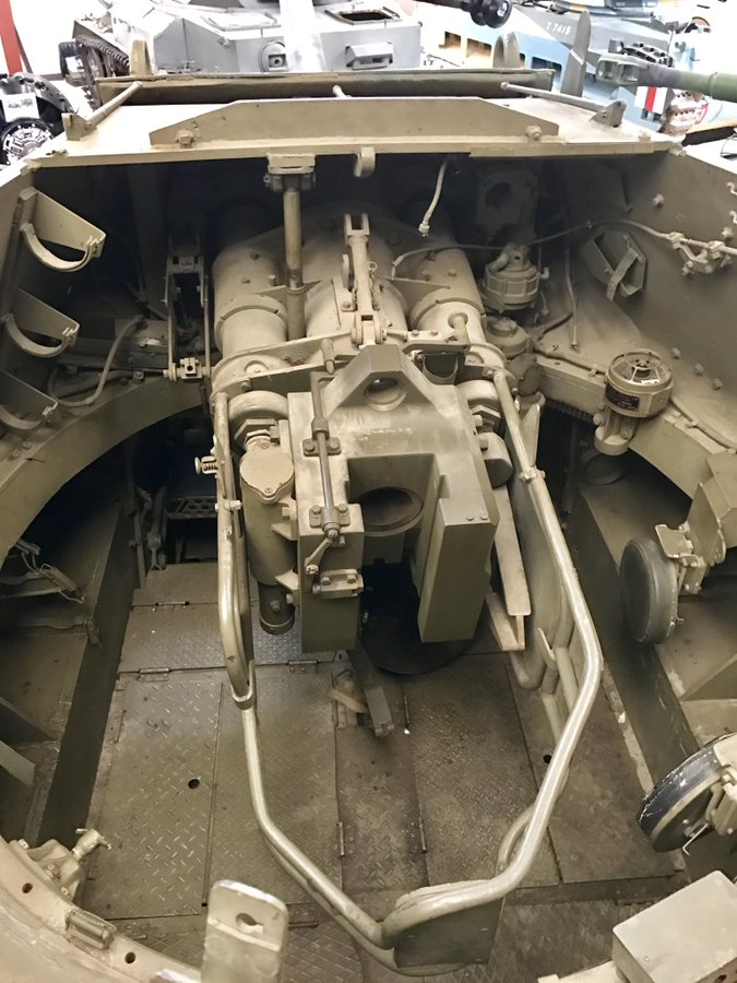

These may come in handy.
It would appear the bottom right bar of the protective barrier is meant to be curved inwards.

The design will provide for a slightly modified turret rotation ring but will still work with the hl turret rotation motor. I'm going to have to take out the usual turret floor as per the photos which are really useful thanks.
It's going to be fun fitting a battery and electronics into what's left of the hull 8O :crazy: :haha:

That first picture shows ready racks on the left front of the turret wall. They are absent in the second. I wonder if that was a field mod, or possibly a Korean war mod?!?

Ecam wrote:Son of a Gunner,
Alwyn, going to be watching this build with excitement!
Good question. I only collected those pictures for the breech detail. Maybe the pictures with the barriers are a late mod. Also there's every chance the racks were removed before the new owners acquired the tank.
I'm sure those racks were an original feature.
