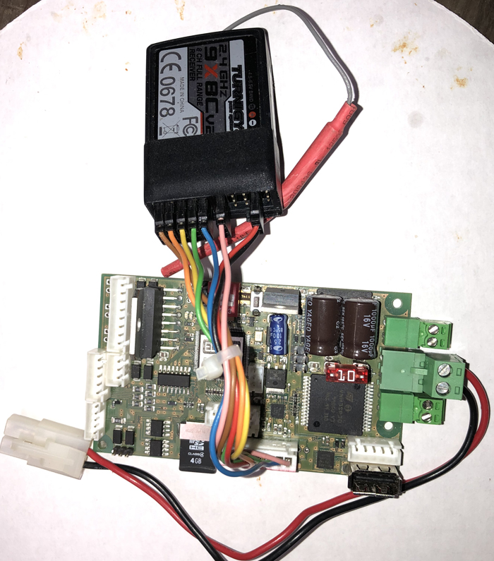

Here is a photo of the electronics Asiatam sent me when I bought the Famo kit about 5 or 6 years ago. This seems to be Asiatam's motherboard of sorts. ??? The kit came with some instructions titled "Servo Multi - Function Control Unit." The instructions do show a multi-function board, but it was not included and I cannot now find it on the Asiatam web site. From what I can surmise, the board shown in the photo here is actually to be linked to the (mysterious) "multi-function control unit."
My objective is to have some means of running the tracks (obviously) and if possible, coordinating the track steering with the front wheels (which will use a servo). I would also like Maybach engine sound, and Taigen's V3 board with interchangeable sound modules are familiar to me, as I have been putting V3 into earlier Torro and Taigen tanks.

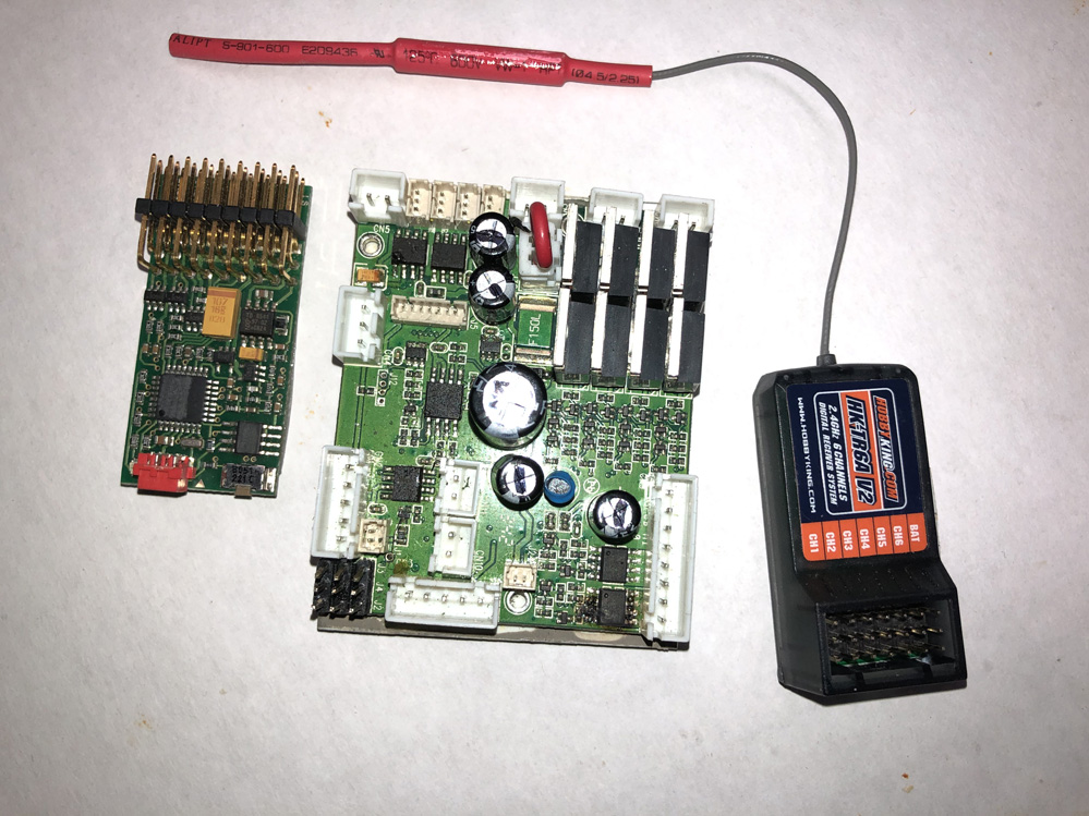

I also have other boards I picked up all at once, with no instructions or TX or RX. Here is what I have from identifications I was helped with here on RCTW a year or so ago.
Elmod Fusion and Turnigy
Benedini TBS Mini Clark TK20

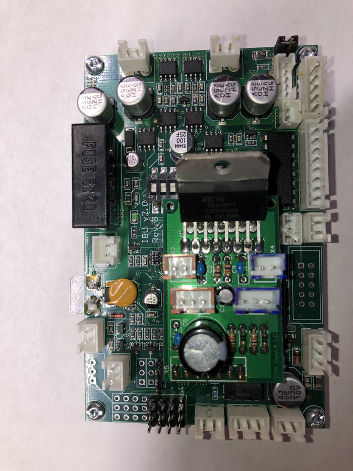

IBU V2

IBU 2 BASE: Oh, memories... That was my second hobby grade board, it should provide you all the control and options you need, but you will need to plug a servo to a spare channel in the radio for having servo steering. I have seen it comes with the audio amplifyer attached, you can remove it, the sound the board provides is in my opinion more than adequate. I believe this option would be the easiest for you.
Old Elmod. Pretty much like the IBU and the need of servo in the spare channel. But keep in mind there will be a inertia/momentum that you cannot remove. Some people absolutely love it (For example Herr Jimster) some people hate it, and some are in between like me. So it is your choice.
Clark board: I would stay away from it, I don't like clark products and triggering the functions means very advanced radio programming which you cannot do with your current radio equipment or playing mortal kombat-street fighter 2 with the control sticks.
Benedini board: That would be my personal choice, but you need a double speed controller (about 10-15 eur) The Benedini will provide you all the sounds and lights needed. But at the other hand those boards are very complicated to satisfactorily use (hence is the only one electronic I had to write tutorials in my website!) and you will pretty much need a better radio, which I always say is the most important part of the hobby and is a must, and you only need one. https://radindustries.wordpress.com/2020/06/25/radios/
Small example of what the benedini board does can be seen here, viewtopic.php?f=209&t=33312&p=329998&hi ... si#p329998 with more info in my website entry. I think it is feature rich enough even for the hungriest RC function modeller.

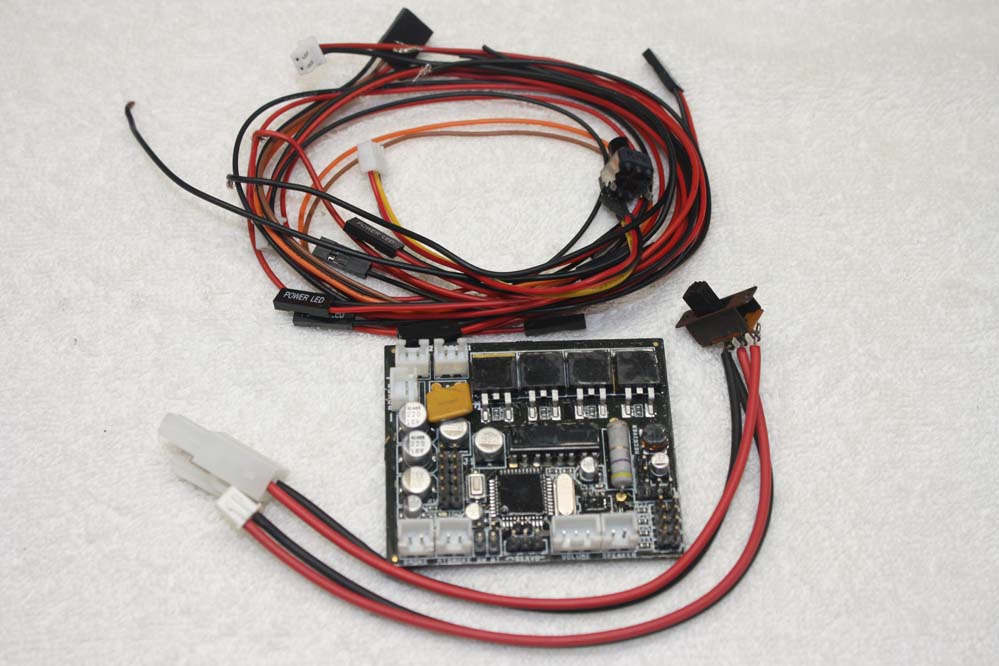

I use for my FAMO a TVC-B-10 unit in combination with a very good Benedini-Sound - all with 12 Volt. It runs very well ! First I took the asiaram-unit - very bad sound and the steeringg servo was not strong enough.
