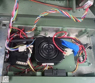

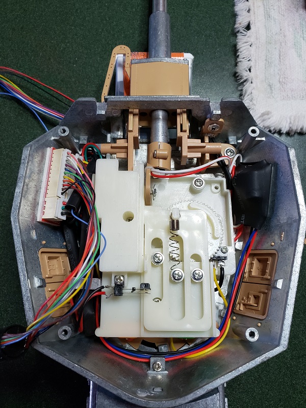

Hi thanks for your messages. I’m not really sure. I’ve attached two pictures for what the inside of my tank looks like.
- CE507CAB-B095-47C4-8E2B-8D9D7C56497E.jpeg (40.77 KiB) Viewed 935 times
- 410302E3-7DE9-448D-80D7-E09F10CEEA69.jpeg (28.9 KiB) Viewed 935 times

Re: T34 recoil Issue
the reversing system is white, surrounded by red, check that this is not blocked? on the right there is a small micro switch, with a thick black or red wire (depending on the wishes of Chinese children! and a small yellow wire that goes to the yellow motor, remove (delicately)
the spring and check that the part slides well and pinion below not blocked
