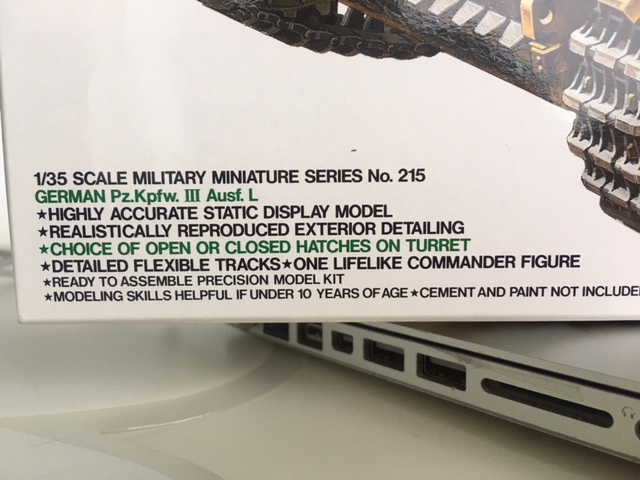

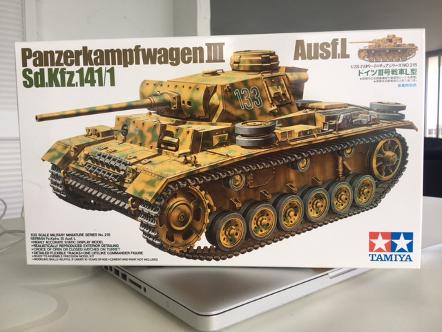

SDM = Static Display Model. No motorized version(s) available so no gearbox mount molded into lower Hull. Sprockets and road wheels are meant to be glued in place in a "static position" and will require modification to be used with motor(s)\gearbox. Tank Tracks in this Kit are a soft Rubber compound and get a lot of traction putting large torque loads on the drive system and requires Transmitter "stick tuning" for best results.
SSDM = Semi Static Display Model. Motorized version(s) are available for this type model but gearbox is not included. drive Sprockets, road Wheels have special internal mount Poly bearing and "Sprocket mount filler plugs" are all included. The Tank Tracks are a special type (soft Poly). These components make the RC conversion a snap compared to the SDM kits.
The Panzer III of this thread is a SDM and requires extra work to configure as a RC model.
I built this model a few months back and was quite a challenge and was a bit tricky to drive around on my workshop track as the tank would throw tracks if you made a fast turn going up a hill and such. I now use a Computer TX and mix programming to solve those issues.
This being my first TAMIYA HIGHLY ACCURATE STATIC DISPLAY MODEL (SDM),
I notice the tracks supplied with this SDM get a lot of traction as they are a soft rubber compound and are different than the "soft Poly track" I see in Tamiya motorized kits.
