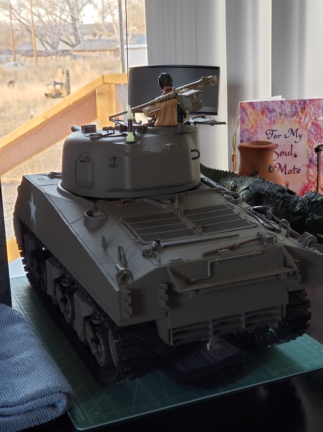

The problems started when I threw a track and didn't know it was a reverse thread. While attempting to loosen the adjustment to slip the track back on, I stripped the screw and nut, so it sat in the corner of my room until I was able to finally get around to installing the replacement tension adjuster.
While driving it around to test the track, the speaker started getting crackly, and volume lowered to almost non existent. I opened the tank up, checked the wiring, unplugged, and re plugged the wires responsible for the speaker, and it still hasn't fixed the problem.
From what I could learn, its either from the plug being loose, or if it is not the wires, the speaker itself. I made sure to push it in as far as the plug could go, making sure it was secure, and no change.So I am asking for some help trying to trouble shoot this. I did order the same type of speaker, which will be arriving in the mail in the next couple of weeks, and contacted Maltomart as well for their feedback.
I am not familiar with stripping everything out to replace them. The speaker seemed easy as it only has one place to plug into and power? Also a M10 Tank Destroyer is kinda.. obscure/rare and the program was discontinued after WW2, so they aren't really mass produced en mass for the scale RC Tank Community, Unlike the Sherman, or the Tiger.
I spent like 900 dollars on the thing as it's also all metal, and was really proud of getting one, and I was suggested in the reddit rc tank community was to junk the thing, as the electronics for it were rubbish. So I rather not just simply junk the thing. That and a you-tube video showing how to strip a Mato tank down to fully adjust things or replace electronics is non existent.
Thank you for taking the time to read this and I look forward to hearing from the replies.

Hi! So, other then the mishap of the nut/screw of the tension adjuster being stripped and needing for replacement for the mato tank,which where I picked up from a tension/adjuster for a 1/16 sherman, it hasn't really had any problems other then the newly developed speaker issue.PainlessWolf wrote:Hello!
If you get a good MATO metal tank, You're blessed and should thank the Gods of the Hobby. These tanks come with Clark boards and once they are programmed, they function very well. For questions on Clark, the Forums very own Maxmekker is a very helpful sort ( especially if you want to swap your speaker for a better one, always a good idea with MATO ) I rebuilt an all metal M36B from MATO and the worse thing I encountered on that Build was: A\ a lack of good detailing for an open turret Tank Killer and B\ the detail on that one were very crumbly as the metal mix was off. I recently got another all metal MATO , a Sherman for a dual Build I am working on. I must have performed the appropriate rituals as that Tank is working Aces and all the metal is solid. Research the speaker you want and consider a housing for it as well. Jarndice' advice on speaker type is solid or you can grab Max who has several housings and speaker sizes available.
regards and enjoy that expensive Big Boys Toy,
This is the exact type of speaker in my tank currently, and what I ordered to replace for a total of 40.00 usd with shipping. Now that I think about it after opening up the tank, there was no viewable way the speaker was being held in the tank. So I think it was just glued on? The lack of good detailing for an open turret tank killer I am working on, looking around for a 3D printed ready rack for the 1/16 ammo and shells that I got for it. The metal hasn't been 'crumbly' like, there's no tell of any flaws in the manufacturing process. But now I know I can get a better more reliable speaker? That will be my next thing to look up.
