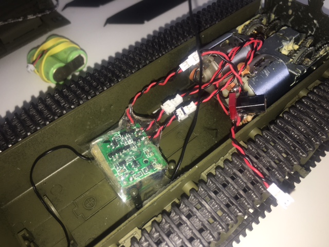

First I had to repair the left track and reattach the front track idle wheel which was missing some parts. After some time I managed to get the tracks back on the Tank then added noise capacitors to each motor as they are not installed or included with the "wired remote control system" then wired the motors with 1.5 mm micro JST connectors so I could connect a single 1.2 v Ni-mh batterie to the motors and test them and the tracks after repairs and see what happens.
Well they worked just fine so next step is to hook up a cheap Toy Grade Ultra Micro 2 channel receiver for some radio remote control action! 8) The TGUM radio gear receiver has 2 ESC's built in the receiver so it is 1 small circuit board and uses a TG 2 channel Universal Drive configuration Transmitter, Cost was $20 2 decades ago. Yes this radio gear is over 20 years old but still performs like new and though it is old Tech, works perfectly fine for Table Top Tank operation :D
The outcome was very good and the model runs so well with this cheap setup that I just left it that way for now. Have been running every since and like the simplicity and reliability of this setup.

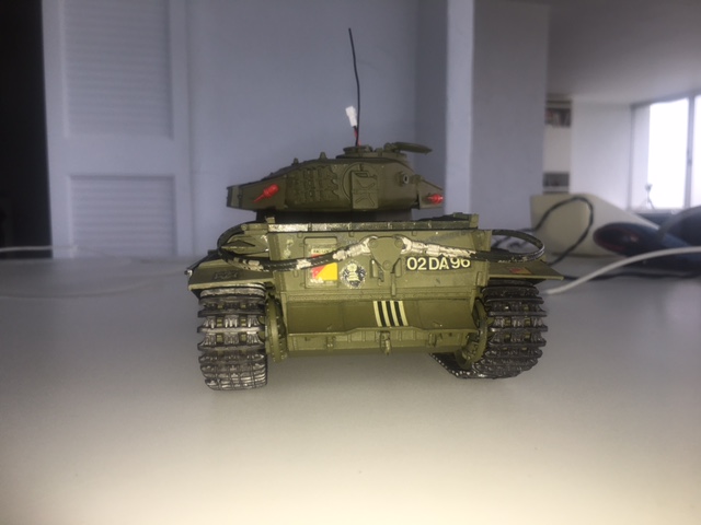

All elements of this tank.

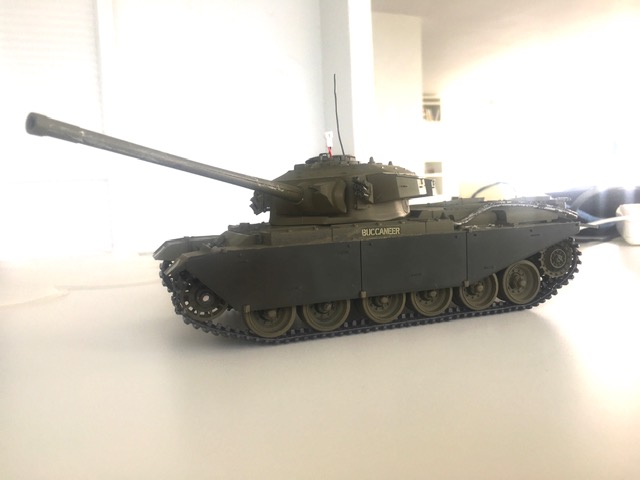

1/35 Centurion Mk III radio remote controlled Tank

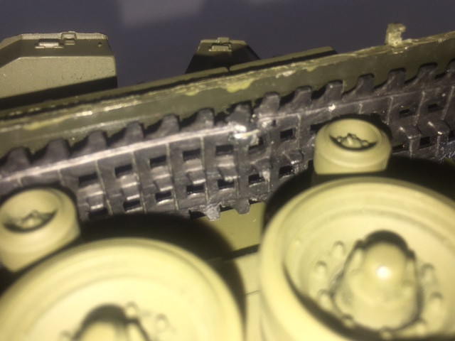

Right track repaired. snapped in two. Staples used to repair. works like new.

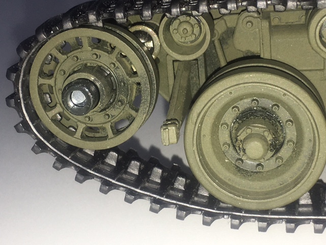

Left front track idle wheel repair. Axle and hub lock missing in action.

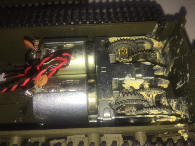

I bought this used tank on ebay just to get this rare all metal gearbox. These things can not be beat and mount in a lot of Tamiya models without mods to the model. There are about 5 different gearboxes. The 5 types have differences in width and length of the axles, mounting screw location, and motor type (round or square 130)

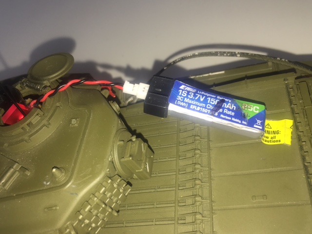

2 cell (2.2v( for scale speed, 1s (3.3-4.2) for battle speed! On\Off switch and battery can be run on the inside of the tank as well as outside. I do not leave batteries inside of my Tanks when not in use so you will see them on the outside of my models most times unless I am doing a video or such.
No one talks much about motor noise suppressor capacitors but they are required for best performance of any radio system regardless if new or old tech. I have found this configuration will improve performance of most any radio system.
Top view of the receiver with 1.5 male\female JST connectors added. Now it is Plug and play and can be removed and or switched to another model in minutes. The on\off switch\LED is also PNP and is optional. If running in scale mode, switch is not used and battery is connected directly to receiver and mounted inside the tank for scale appearance in videos and such..
Even though it came from a toy grade model, it is ULTRA MICRO and when it comes to radio gear that means EXPENSIVE so IMO it is worth the effort to mod these inexpensive radios to Hobby Grade use simply be adding the appropriate connectors.
