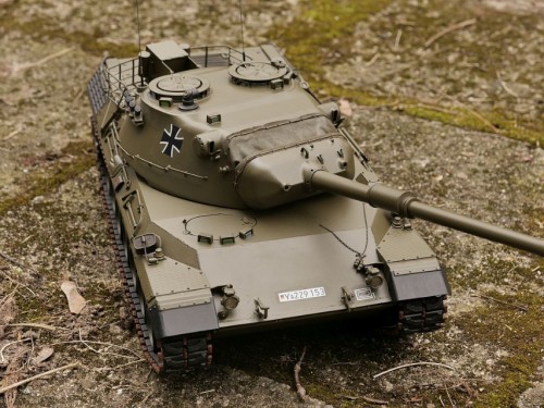

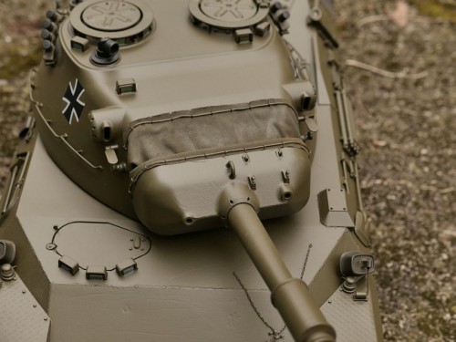

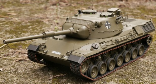

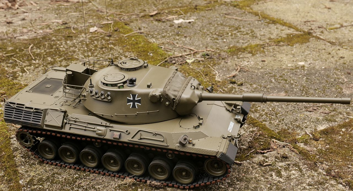

NUMBER 1
Ok,

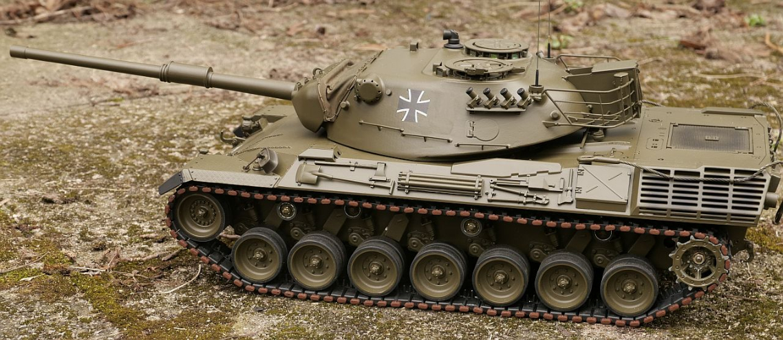

i will start:
Leopard 1 from 2.Batch 1966.
Base: Tamiya
Turret: Emma shop
Gearbox: Tamiya Leopard 2
Electronics: Beier SFR-1-D
Periscope is functional
Rangefinder flaps functional
All Lights functional
Elevation and recoil by servo
Tracks Kenny Kong
Ok,
i will start:
Base: Tamiya
Turret: Emma shop
Tracks Kenny Kong

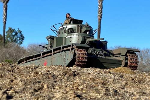

NUMBER 2

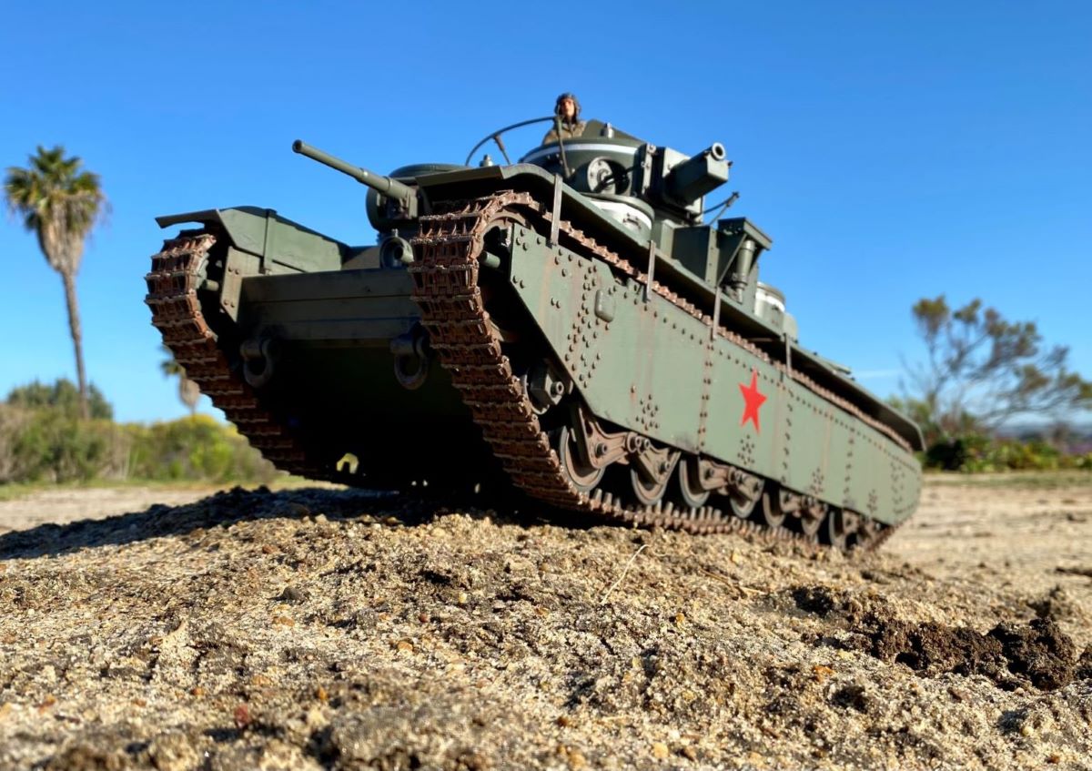

Now that it's pretty much done (never completely), I'll submit my T-35:
3D printed.
Heng Long red motors and metal gears.
Servo operated main gun elevation and recoil.
Main turret rotation by a servo altered to be a motor/gearbox.
Auxiliary turrets in servo operated random motion controlled by a Pololu Maestro motion generator.
LED headlights, main gun flash and two machine gun flashings.
Heng Long smoke generator.
Here's a three minute video chronicling the development and function:
All proudly run from a Heng Long 6.1S main board. The build thread is here:
viewtopic.php?f=23&t=32811
3D printed.

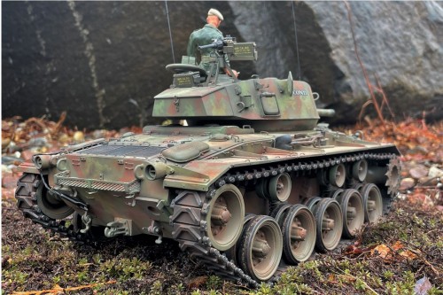

NUMBER 3

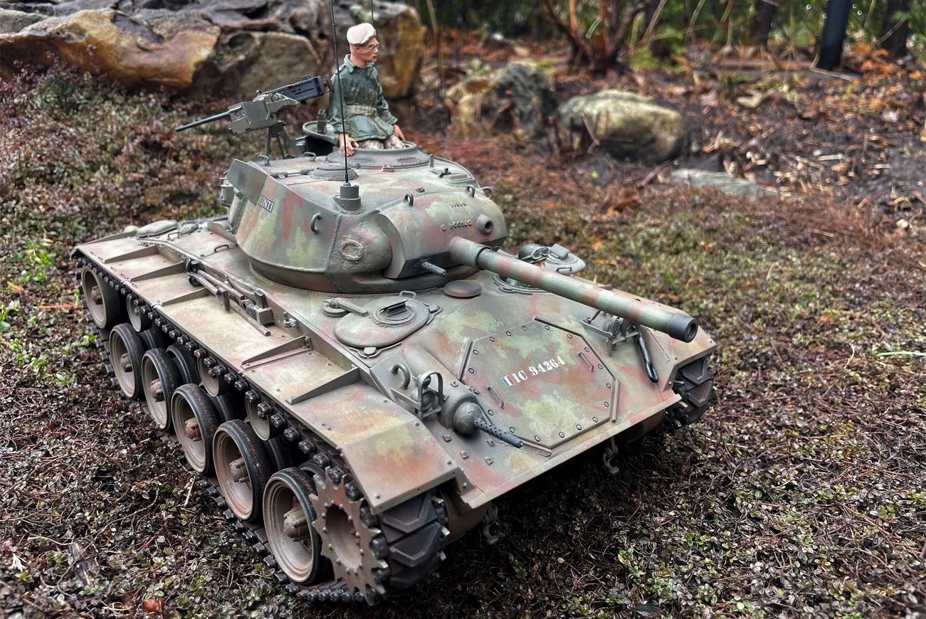

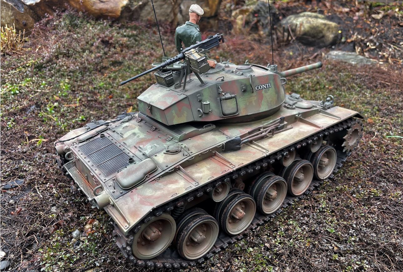

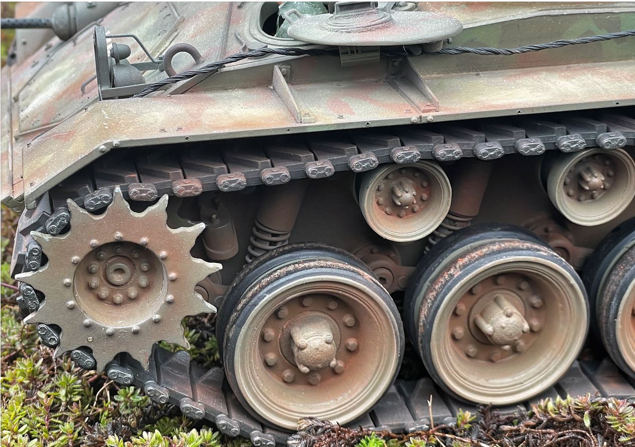

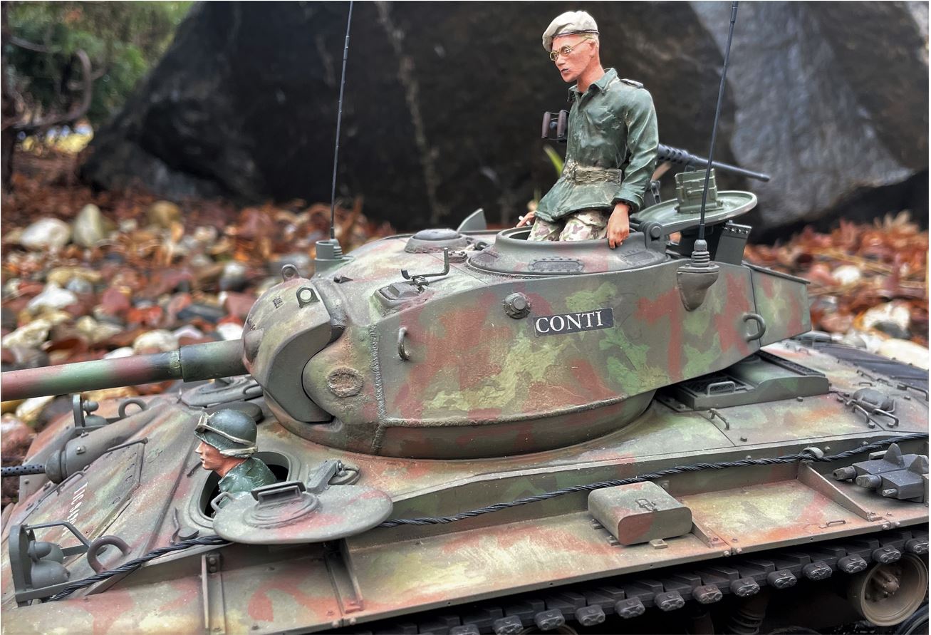

Hello everyone,
This is a scratch build RC 1/16 scale M-24 Chaffee US light tank with French Indochina camo and markings as seen during the Dien Bien Phu battle. The complete build report can be seen at viewtopic.php?f=202&t=32525
The model has the following features;
- Fully scratch build hull and turret in plasticard, brass gun barrel and other details.
- Modified M-26 roadwheels, idlers and return rollers, reduced in size and width.
- Modified double pin Heng Long Sherman metal tracks into Chaffee T85E1 tracks with central guide with rubber shoe
- Modified Mato metal Sherman sprocket
- Heng Long gearbox
- Turret rotation, gun elevation, home made gun barrel recoil, with flash and sound
- Bow and Coax machine gun with flash and sound
- Opening and closing crew hatches.
- Wired for Clark TK-60 control board
- Working headlights and tail lights.
- Modified resin figures
- home made decals for tank CONTI operated by Captain Hervouet during the Dien Bien Phu battle.
Hello everyone,
- Heng Long gearbox
