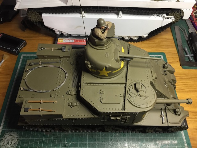

Luis, you are truly one of the masters of scratch building on this forum. Wonderful M3! How/what did you do to those bogies? It is a wonder for many who want a pre Sherman or even an early M4.

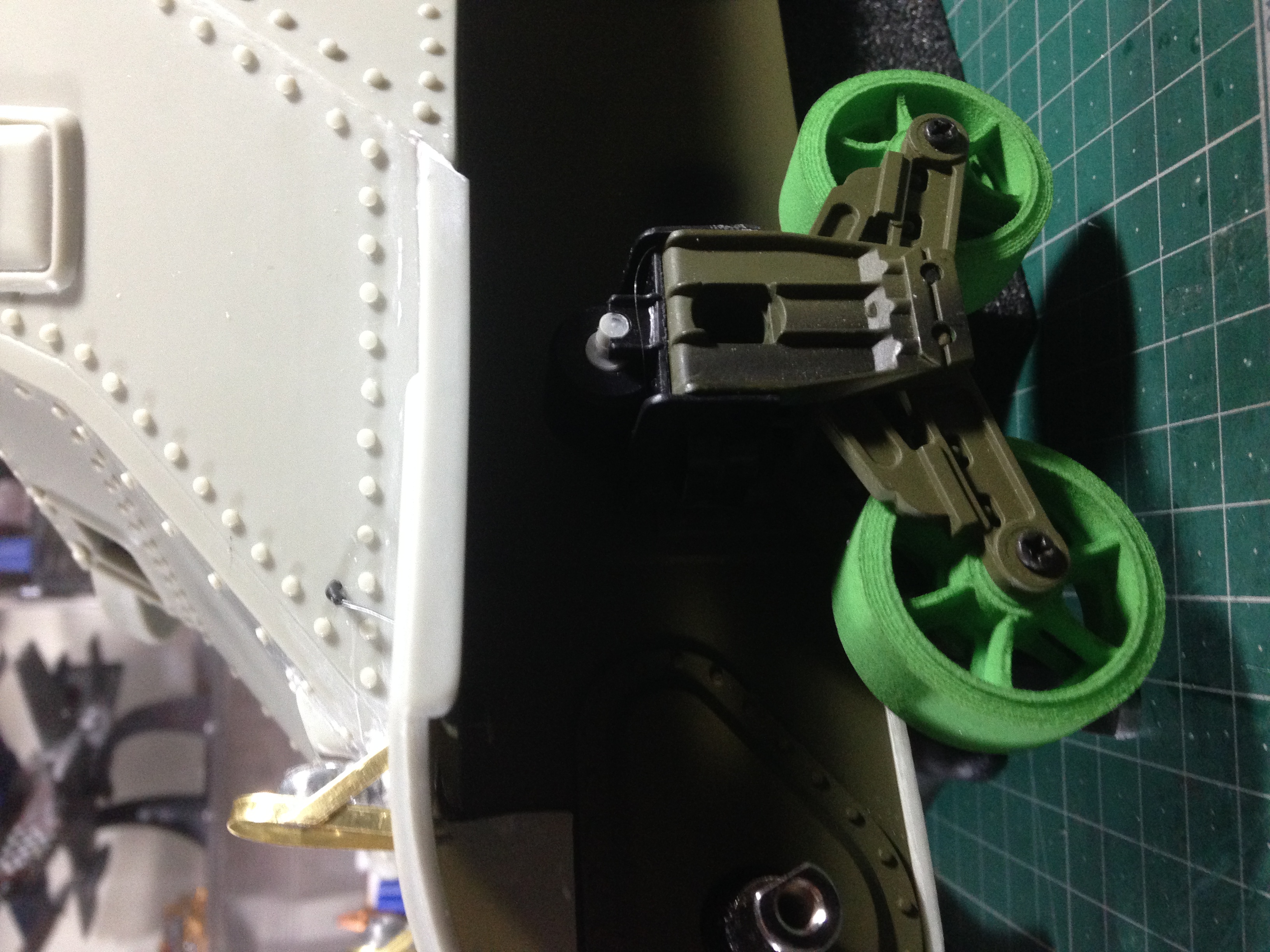

This is the 3D printed conversion set from shapeways Ecam, as shown in the first picture you cut just above the screw hole which also retains the spring for the wheel suspension, you can then fit the top part over this and it will work just like the original setup :thumbup:
Cheers, Lee. ImageImage

Hi thank you very much for your words about my models.
I used vandra models resin conversion set for M4 bogies with shapeways wheels
