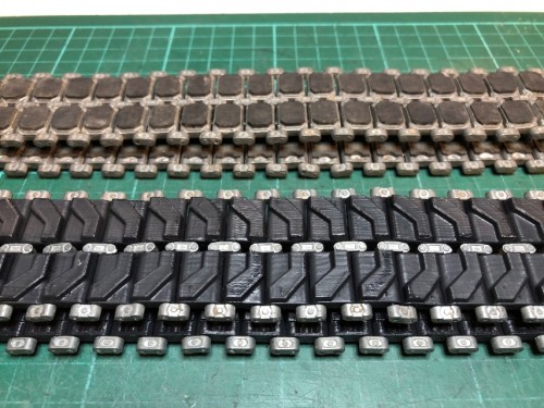

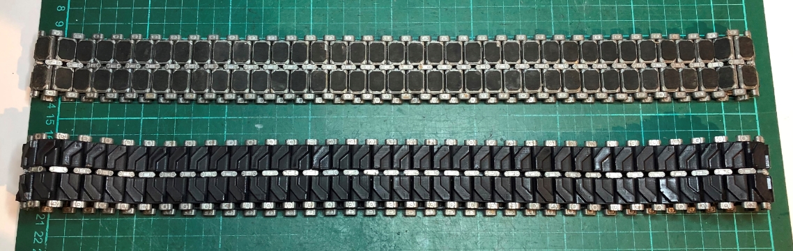

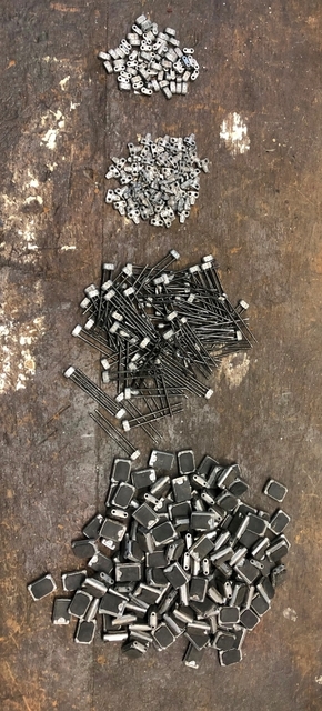

Only for an idea, because I didn't find a place to get the T156 tracks for my M48A2C, I've rebuilt M1 tracks with printed chevron parts.

Wow...that must've been quite a lot of work. Did you design the STL yourself or was it available online to resize? I do have a set of full metal HL Abrams tracks that I'm sure would be great for this since I doubt I will ever use them as is.

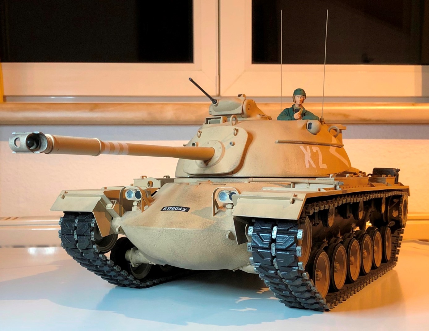

this is the result 8)

M48 looks great. What material did you print the pads from? Guessing ABS?
And thanks to, Panzerjaeger66, not looking for the T97E2 Chevron type tracks anymore. Thanks!

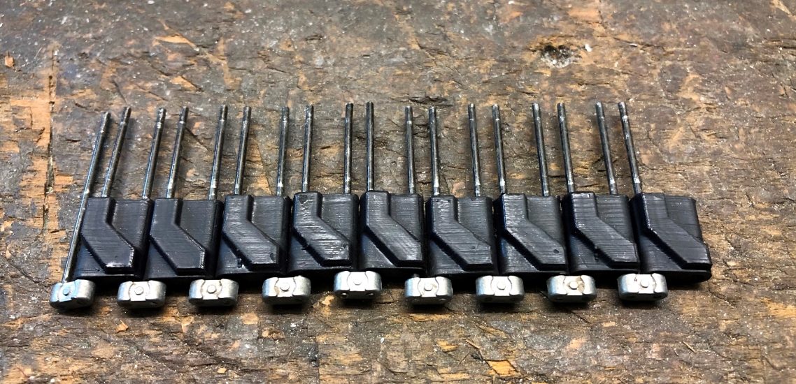

these were printed in PLA; that's not an ideal material but still works good. Better would be ABS, but PA12 would be best; all my printed tracks are made of PA12 even if they are still so tiny.
for example:
