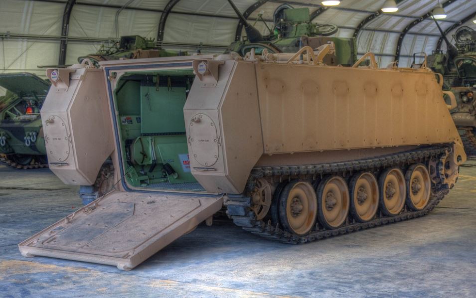

I've scratch built four RC 1/16 M-113 vehicles in different versions so i know a bit. Looking at the pics and video of the DKLM M-113A3, here are a few observations;
- the hull shapes, dimensions and overall details look good and accurate.
- A drawing seems to show that the trim vane at the front can be lowered realistically and the engine hatch can open, i like that, but the cantilever hinges for the trim vane are likely very fragile if they are not made of metal.
- It also show that the arm that locks the trim vane in lowered position is extendable, again very fragile mechanism if this is 3D plastic.
- No mention or display of working headlights or tail lights, which is weird as it would be easy to provide.
- Toy like commander's cupola rotation feature, surely there is a way to slow it down.
- Browning M2 and barrel is not very good looking.
- No ACAV gun shield option.
- There is an opening rear ramp but no interior details.
- Unclear if the small rear door can manually open and close.
- Side skirts look good but hopefully these are removable.
- Use of Panzer III tracks instead of proper US T-130 or T-150 tracks is very disappointing.
- Unclear if the rear external fuel cells can be easily removed for anyone wishing to back date this vehicle to an earlier version.
- The suspension looks weak during operation.
- Missing spare tracks on front glacis.
- Commander and driver hatch can open, but unclear if the rear compartment top hatch does.

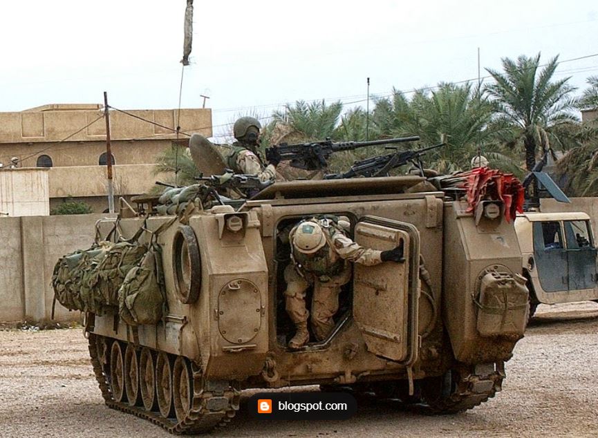

- M113A3 in Iraq show a added belly armor that is not present on the model.
Overall, It is nice to see an M-113 offering for guys who do not want to scratch build one.
M113A3 with T-130 tracks
M113A3 with T-150 tracks
M-113A3 with ACAV shield, showing T150 and T130 tracks side by side, with added belly armor.

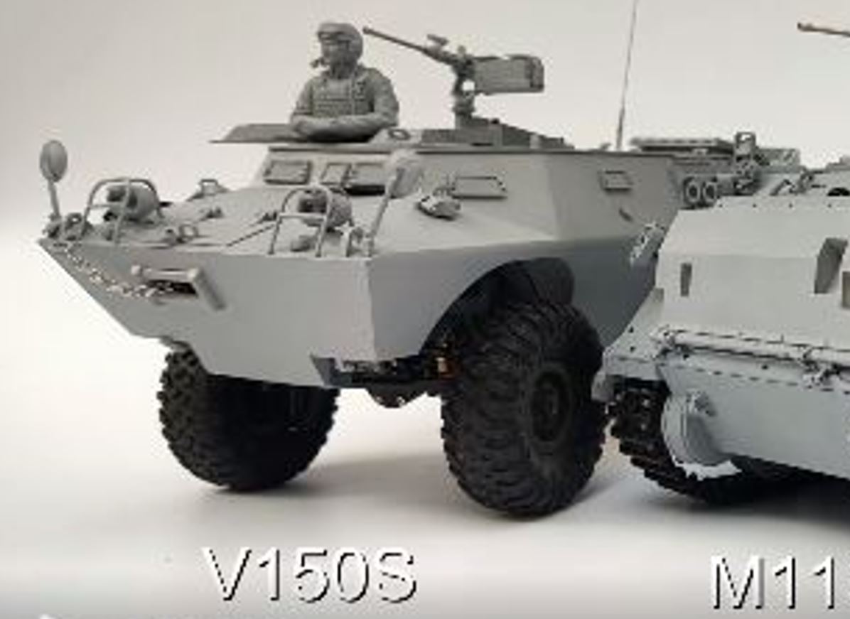

Also shown in the M113 video is the upcoming Cadillac Gage V150S. The S means it is the rare stretched version which is 46cm longer than the other. The V150 comes in many versions but i think DKLM has picked one of the least interesting one. It seems to be the standard personnel carrier version with pintle mounted Browning M2 and without parapet. As such, its just to drive around. A version with a turret mounted 20mm or 90mm gun would have been a lot more interesting. Hopefully, they will release other versions.
