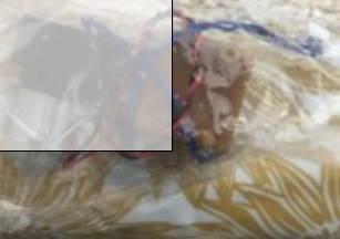

Hello
Can I convert a heng long 1/16 6.0S. smoking unit to run off a Taigen V3?
Thanks in advance
Frank

Hi Topper,
Yes you can but you will need to join the fan motor wires to the heater element wires. That way you will only have one 2 pin plug to fit into the Taigen board. Same position as the Taigen smoker. The fan and the heater will both work at the same time, so if it blows too fast, a small resistor inline with the fan may be needed.
