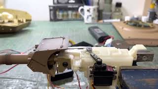

Dear All
Here's how i changed the recoil to servo, by basically strapping on to it!!
https://youtu.be/8pXJwo_DJNs
and how to fit it into the turret, i forgot to add this onto the first vid.
https://youtu.be/IwXfosEtgLA
and sorry if i don't get back quicker to reply's, i use my iPhone mainly, and for reply it tells me there a script error, so wont post, it only works on my PC??

Very informative. What control system are you using and which connections did I you use?

Hi
It’s a haya 6.4 or a heng long 6.1, or 7.1 or any aftermarket board with servo ports.
Sorry for not posting sooner, the random error code comes along
