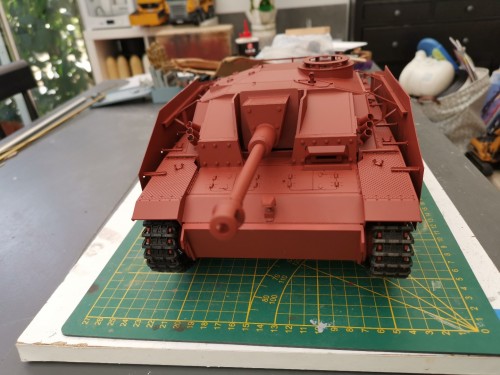

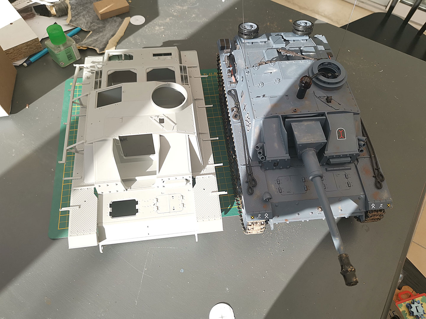

Hey guys,
I decided to take the risk to buy the 1/16 Heller StuG III ausf. G kit to see if I could use the upper hull on the Heng Long chassis. This kit is produced by Trumpeter and released under several brands, depending on where you live on the globe. :)
The kit is very nice and I am been very pleased to see it's a perfect match down to the mm to the Heng Long chassis. It's going to be a great enhancement.
Just a teasing pic :)

Awesome. I have the same kit in the box since Christmas, I'm planning to marry it with taigen lower hull.
One question: did you strengthen front plate? In the Heller kit it lies on the lower hull with little to no connection to upper stucture.
MonsieurTox
Posts: 740
Location: Paris
Re: HL/Heller StuG III ausf. G hybrid
Post by MonsieurTox »
Hello Kaczor,
I havent strengthen it so far, I don't see the need for it but I may change my mind later. Actually the front horizontal plate is glued to the front vertical plate of the hull (the plate with the view port) and to the fenders via straigt angle brackets like on the original so it's quite strong !
Please pics of your build when you start it, we will be able to help each other ! I wont go crazy with this one as this my 5 yo son's StuG III but I will try to make it look much better than the Heng Long. :)

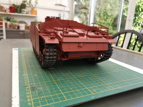

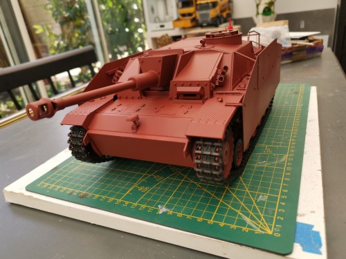

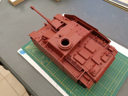

Hello,

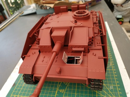

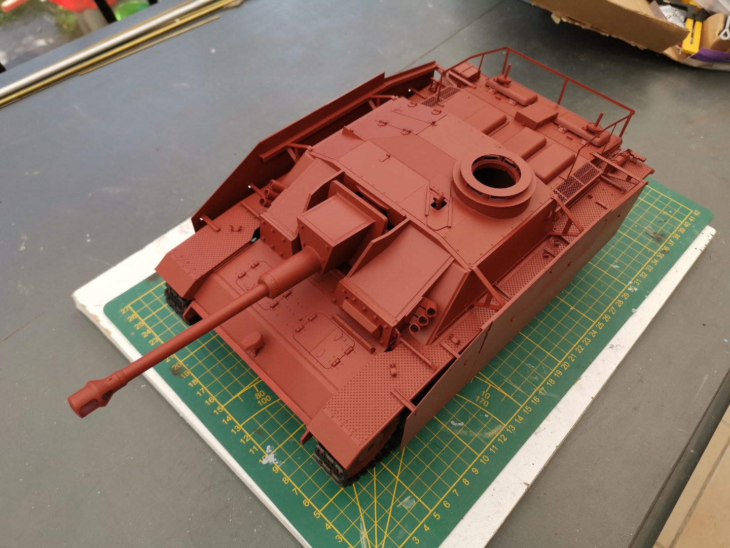

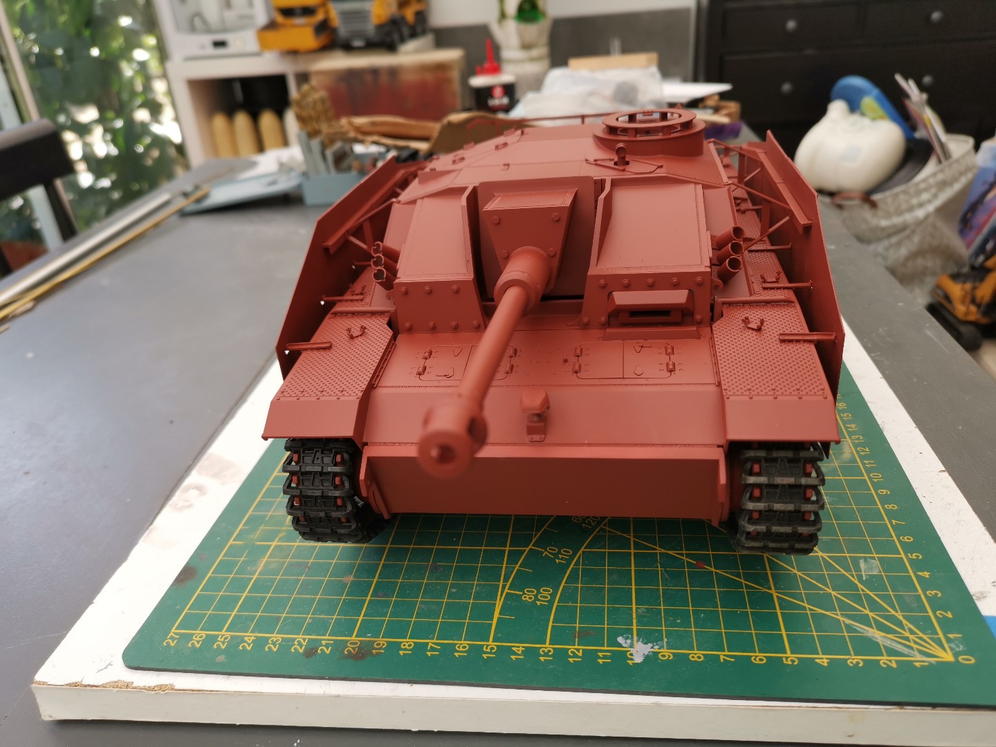

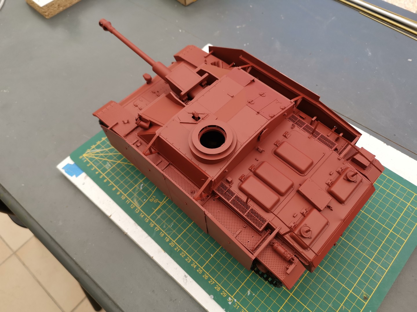

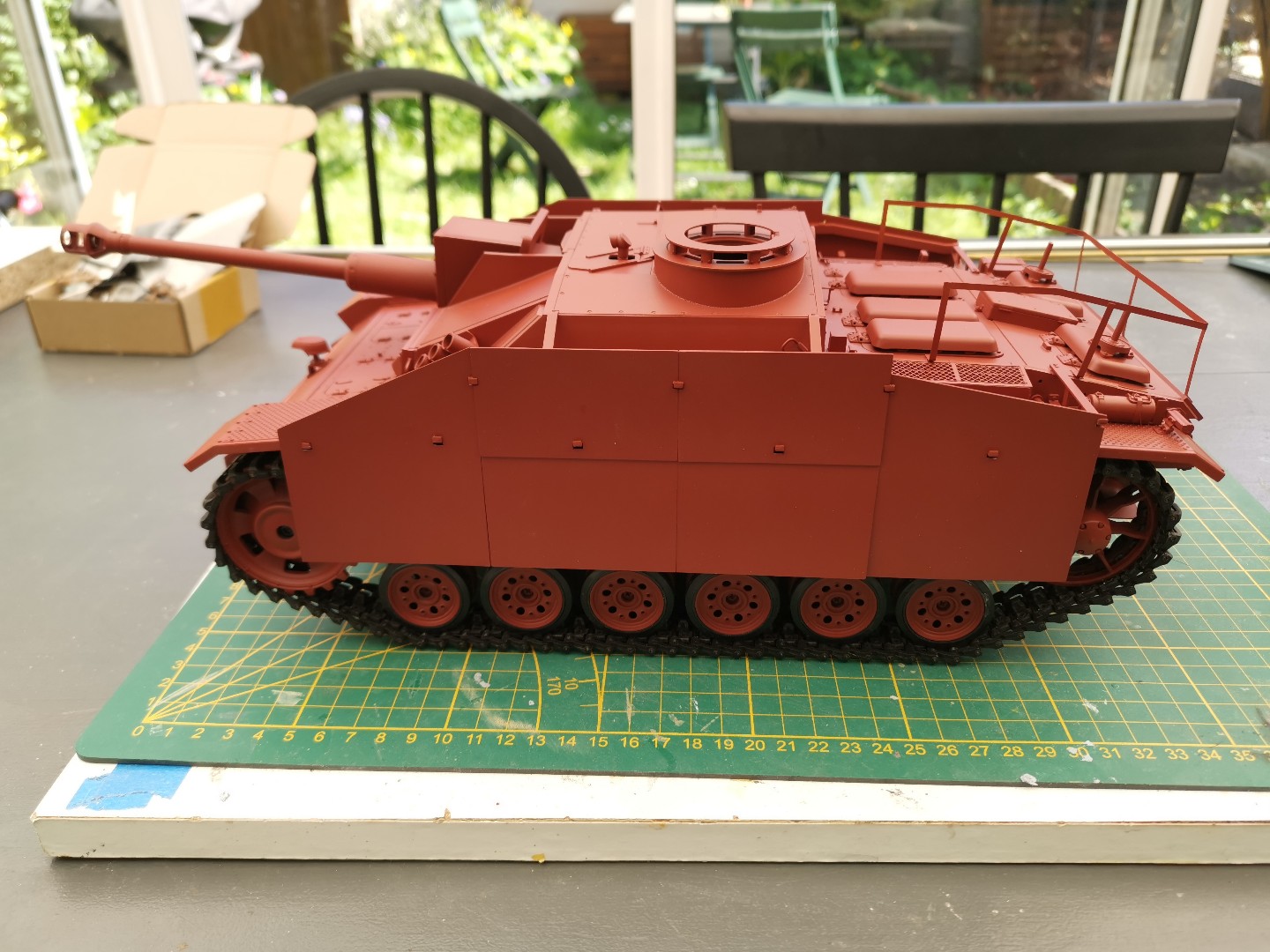

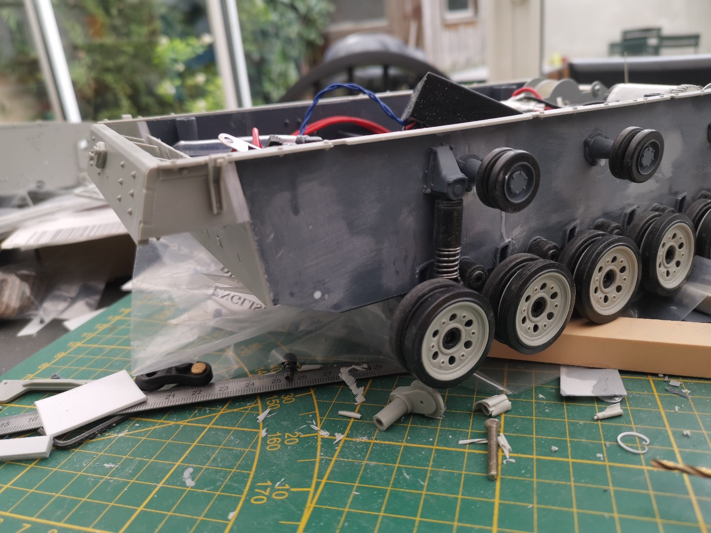

Some news of the HL/Heller Stug Iii.
I did not take a lot of pics.

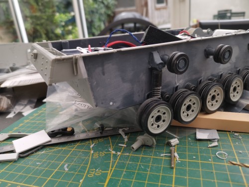

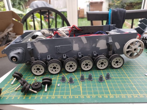

I did some modifications to the HL chassis :
I moved up the return rollers, they were too low. One of them should be lower than the 2 other.
I moved back and up the idler wheel (and I'm using the Heller one which has the correct diameter, much larger than the HL).
I'm using the Heller roadwheels, only the outer ones, I'm keeping the inner HL ones to avoid too mods. They are the same diameters so no problem. The Heller wheels have much better details and are thinner, which is more accurate.
I used the Heller guns with all the elevation brackets which is nice because it can be seen from the top, no need to cover the hideous HL system with a piece of fabric.
I think the Heller schurzen are a bit off in size (proportion of the panels seems off to me), I'm going to make new ones.
The Heller top hull is longer than the HL hull. I had to make the HL chassis longer by about 4mm.
The whole top hull incl fenders are removable. Roof of the hull is also removable and I made functional hinges on several hatches (not all).
This is my 5yo son's tank so I'm not sure the PE stowage rack on the engine deck will last long lol...
I'm waiting for late metal sprocket (even if some G had this earlier style with hub cover).
