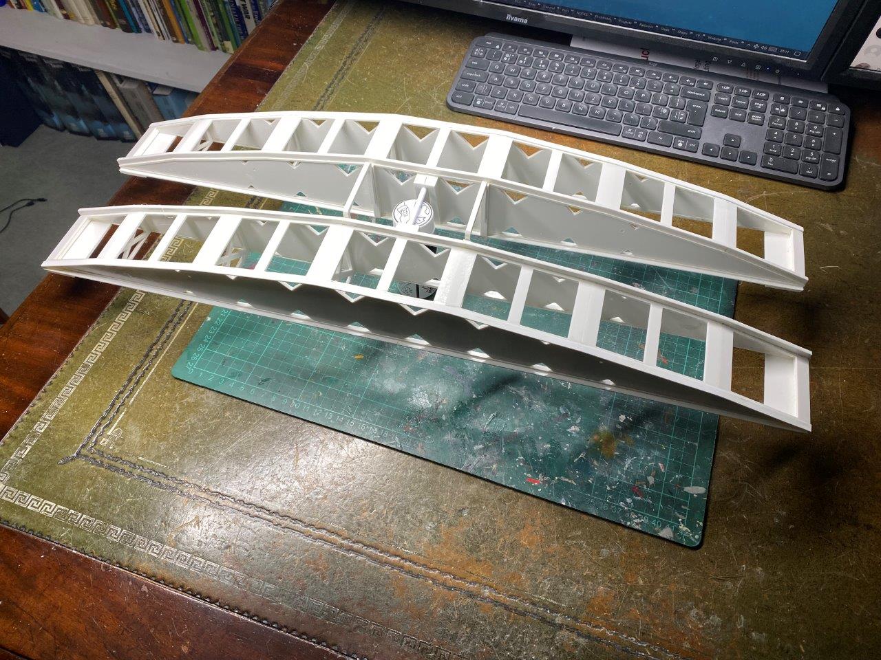

Prototype parts arrived from Ludwig yesterday and they accurately match my CAD so went together very easily. The bracing test parts in 4mm plastic work well and will now be cut in metal for strength.

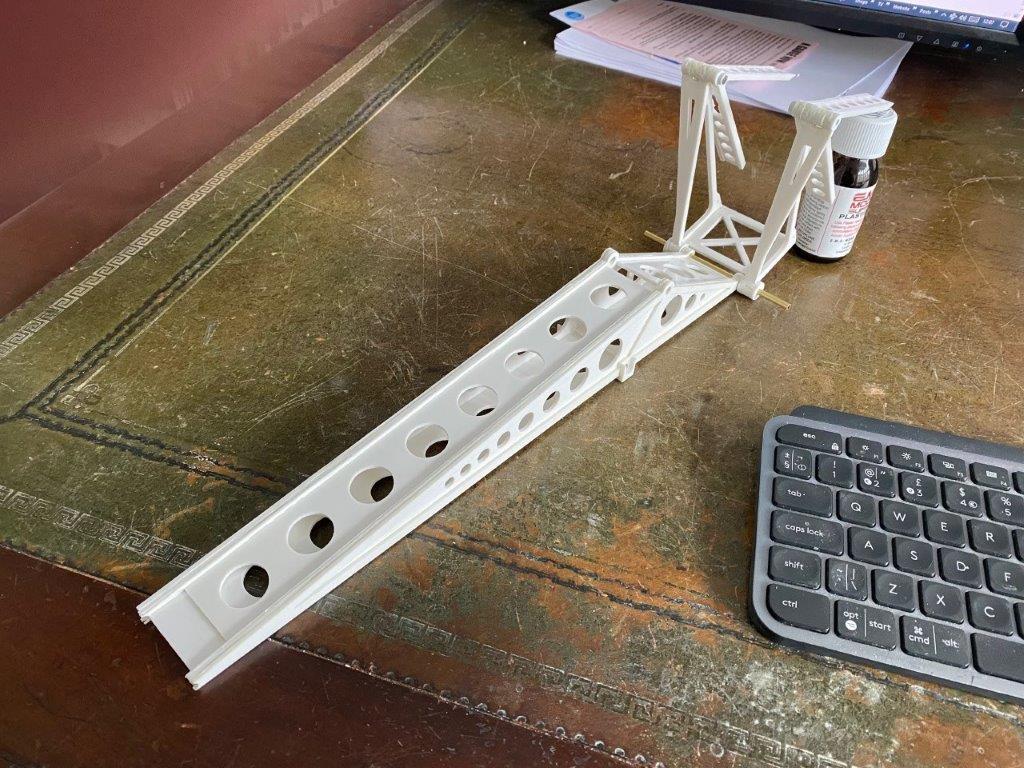

Lifting arm lowered position

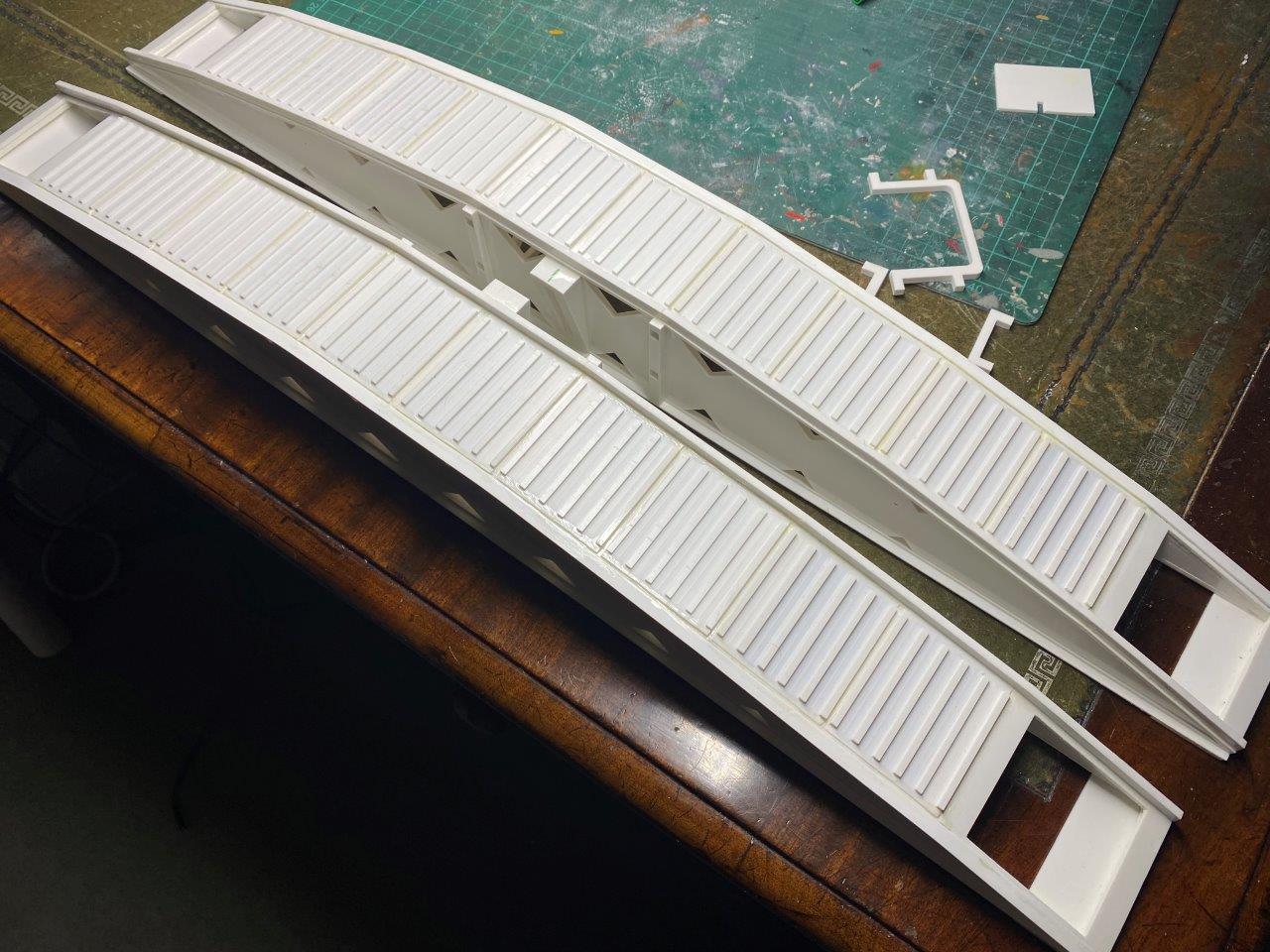

Assembled bridge
Assembled bridge
Bridge 22.jpg (79.01 KiB) Viewed 5153 times
Lifting arm in raised position
Bridge 23.jpg (74.87 KiB) Viewed 5153 times

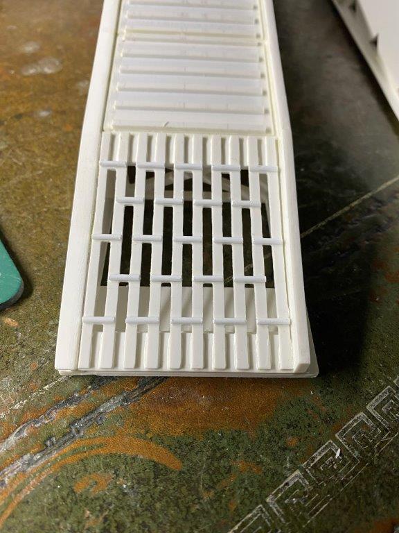

Bridge end grid
Bridge end grid
Bridge 21.jpg (78.12 KiB) Viewed 5153 times

Very cool. Is it strong enough for a tank to travel over it? Looks like it would be with all the crossmember supports.
Snowwolflair
Posts: 61
Joined: Sun Jan 31, 2021 3:08 am
Re: Churchill VII Bridge Layer with Mk3 bridge
Post by Snowwolflair »
Yes, it is a box girder structure so supporting the weight of an all metal tank is not a problem.
