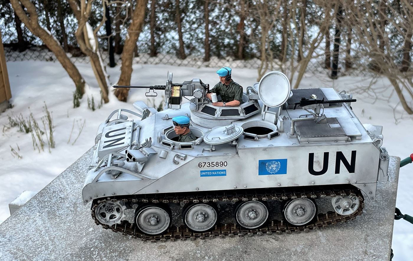

This is the smaller M-113 Lynx Command and Recon version of the M-113, as used by the Canadian army from the 1960s to 1996 when it was replaced by the Coyote 8x8 LAV-25.
The model has the following features;
- Scratch build chassis, turret and most detailing.
- Tank Modellbau M-113 metal tracks with rubber pads, sprockets, idlers, torsion blade suspension, sprocket hubs, tow hooks, road wheel hub caps.
- Ludwig M-113 3D printed road wheels.
- Twin JGA25-370 motorization with drive shafts to sprockets.
- Tamiya M2 machine gun with Aber barrel sleeve, sight, ammo and links. M2 and barrel hollowed with LED for flash.
- Classy Hobby Browning M1919 with Aber metal barrel
- Wired for Clark TK-22 control board
- Turret rotation with HL rotation unit
- Servo M2 machine gun elevation, firing with flash and sound
- Manually operable trim vane, with front and top hatches
- Modified DGS Commonwealth tank crew (the driver is a gift from Dean).
- Shown in UN markings as used during peace keeping missions in the 1970+.
