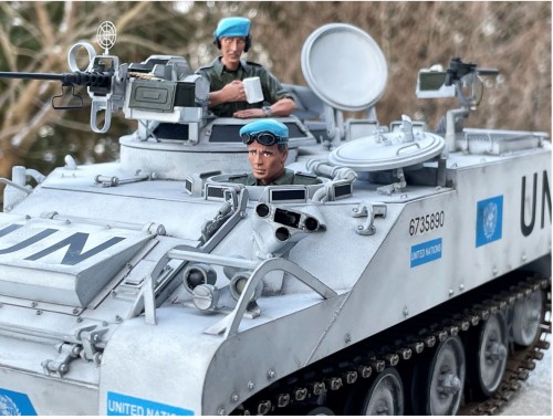

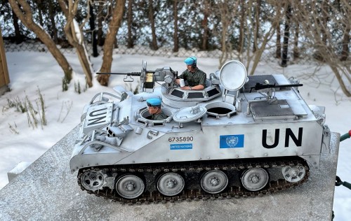

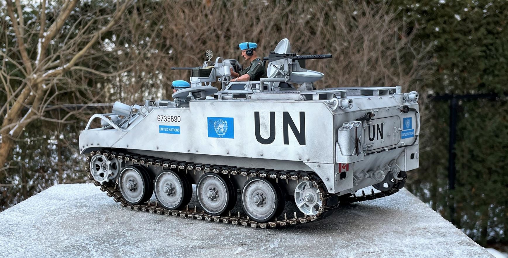

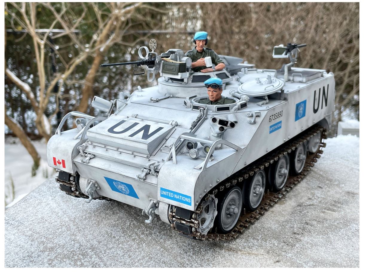

This is the smaller M-113 Lynx Command and Recon version of the M-113, as used by the Canadian army from the 1960s to 1996 when it was replaced by the Coyote 8x8 LAV-25.
The model has the following features;

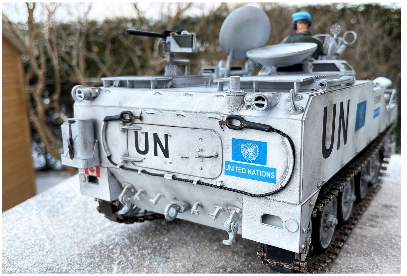

- Scratch build chassis, turret and most detailing.
- Tank Modellbau M-113 metal tracks with rubber pads, sprockets, idlers, torsion blade suspension, sprocket hubs, tow hooks, road wheel hub caps.
- Ludwig M-113 3D printed road wheels.
- Twin JGA25-370 motorization with drive shafts to sprockets.

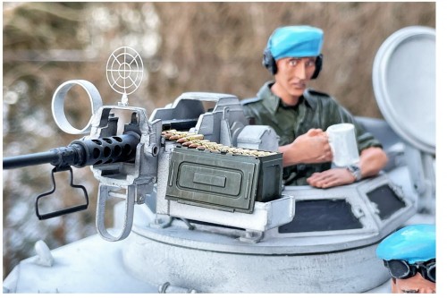

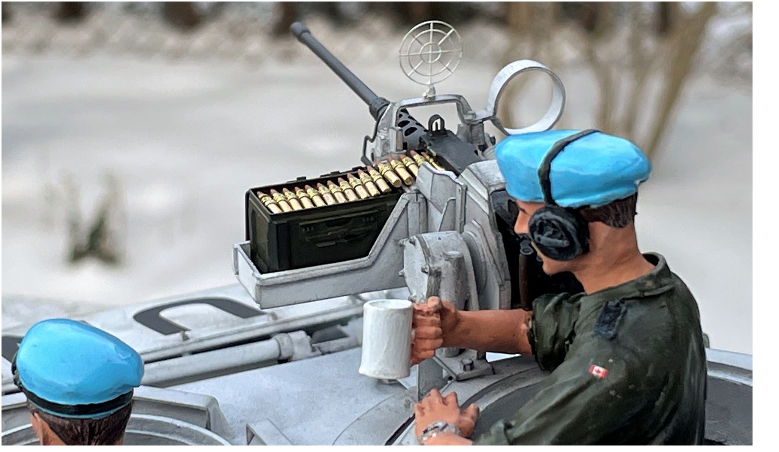

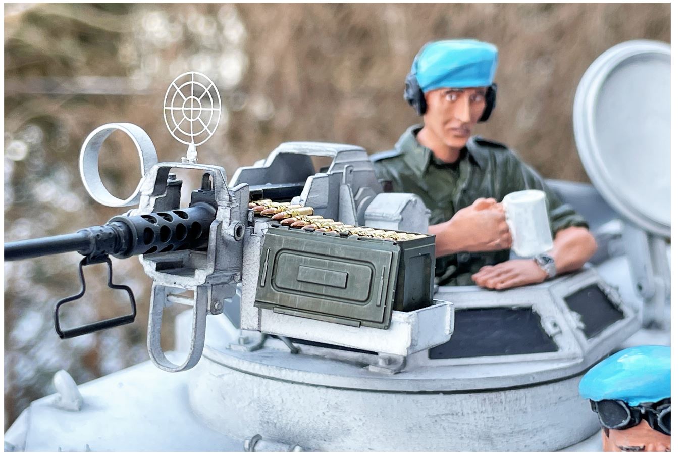

- Tamiya M2 machine gun with Aber barrel sleeve, sight, ammo and links. M2 and barrel hollowed with LED for flash.

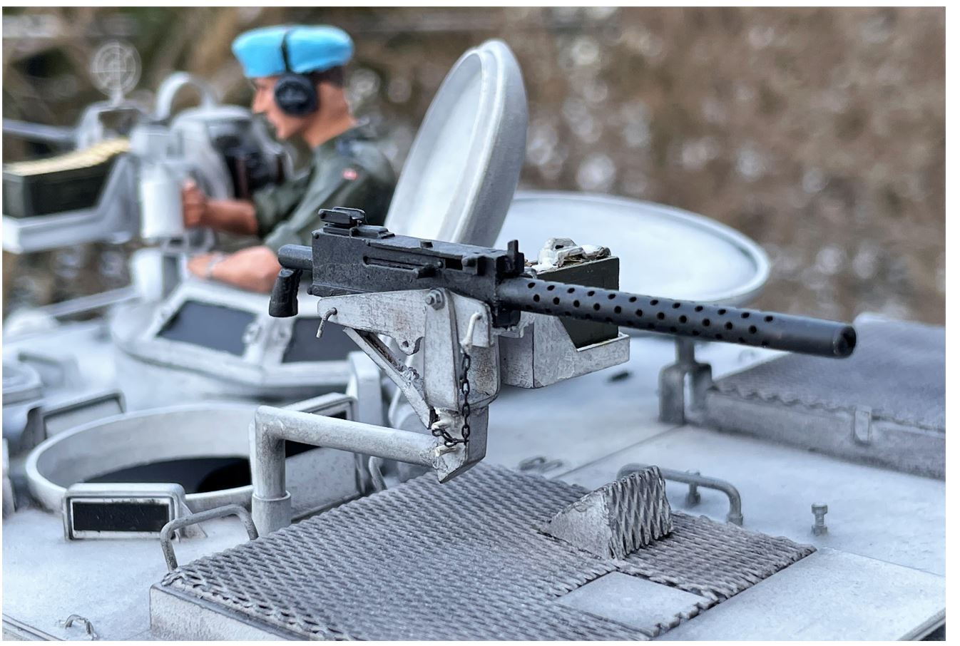

- Classy Hobby Browning M1919 with Aber metal barrel
- Wired for Clark TK-22 control board
- Turret rotation with HL rotation unit
- Servo M2 machine gun elevation, firing with flash and sound
- Manually operable trim vane, with front and top hatches
- Modified DGS Commonwealth tank crew (the driver is a gift from Dean).
- Shown in UN markings as used during peace keeping missions in the 1970+.

Thanks, yes, i will try to make one today, in the snow. It does not go into water though.

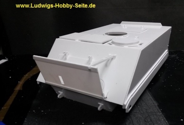

This is my fourth 1/16 M113 based vehicle that i build in past 5 years. All the build reports can be seen in the modern tank section of this website.
First one, the M-113 ACAV uses the Ludwig base kit and panzer III tracks. The second one is using the Verlinden 1/16 resin kit, tank Modellbau running train and scratch building. The Verlinden kit is advertised as 1/15 like many of their large scale resin models but strangely, this one is really 1/16 and a perfect match, so the whole Verlinden upper chassis and interior can be used. Its now very rare to see one for sale. Third one is the Australian M113 MRV with scorpion turret and then this one.
The Tank Modellbau running train parts below are available, expensive and mainly represent parts used on German or Nato M-113. Using them is a project on its own. Its always difficult to adapt parts from different vendors, Ludwig and Tank Modellbau are obviously not talking because none of their stuff is designed to fit together. I usually end up having to redo the Ludwig lower chassis to fit the Tank Modellbau suspension, and hiding those interlocking joints everywhere is killing me. That's why i found it simpler this time to simply scratch build the whole chassis myself with measurements and shapes extrapolated from 1/35 kit.
