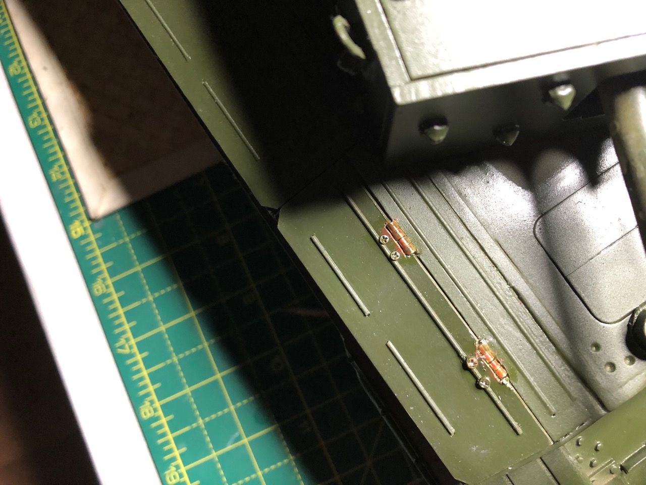

I use concealed brass doll's house hinges with tiny screws, generally. Even the nylon hinges used for model aircraft flaps and ailerons can be used (they're hardy- and have to be). One part would be bonded to the back of the flap, and the other bonded (so it's not visible) to the hull. A suitable strong adhesive- one I use for metal/resin/abs fusions is JB Weld (metal) epoxy. A combination of tiny self-tapping screws (again for a Doll's house or miniature model) and epoxy will hold any pivoting surface in place.
Cromwell storage bin hinges
Here's where I used small doll's house hinges to bond the storage bin lid to the hull of the tank. The lid opens nicely, but underneath both sides of the hinge are fixed with a layer of JB Weld and spectacle self-tappers (bought in a pack of hundreds cheaply, on Ebay). So- it's a reassuringly secure fitting. All it needs now is some Olive Drab SCC15 touchup. :D
Here's a great site for all things miniature (hinges, bolts, nuts- all manner of fastenings).
