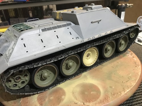

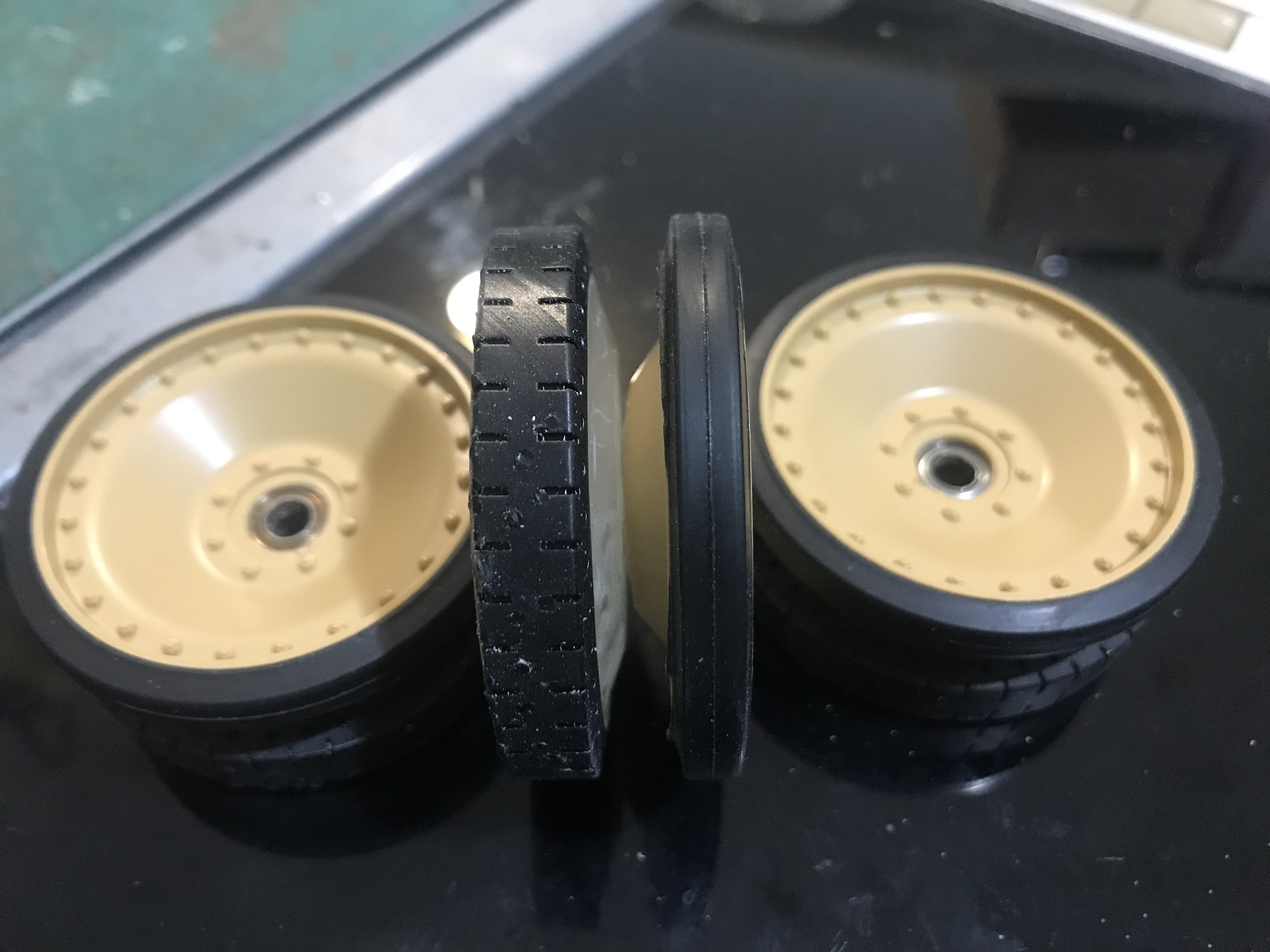

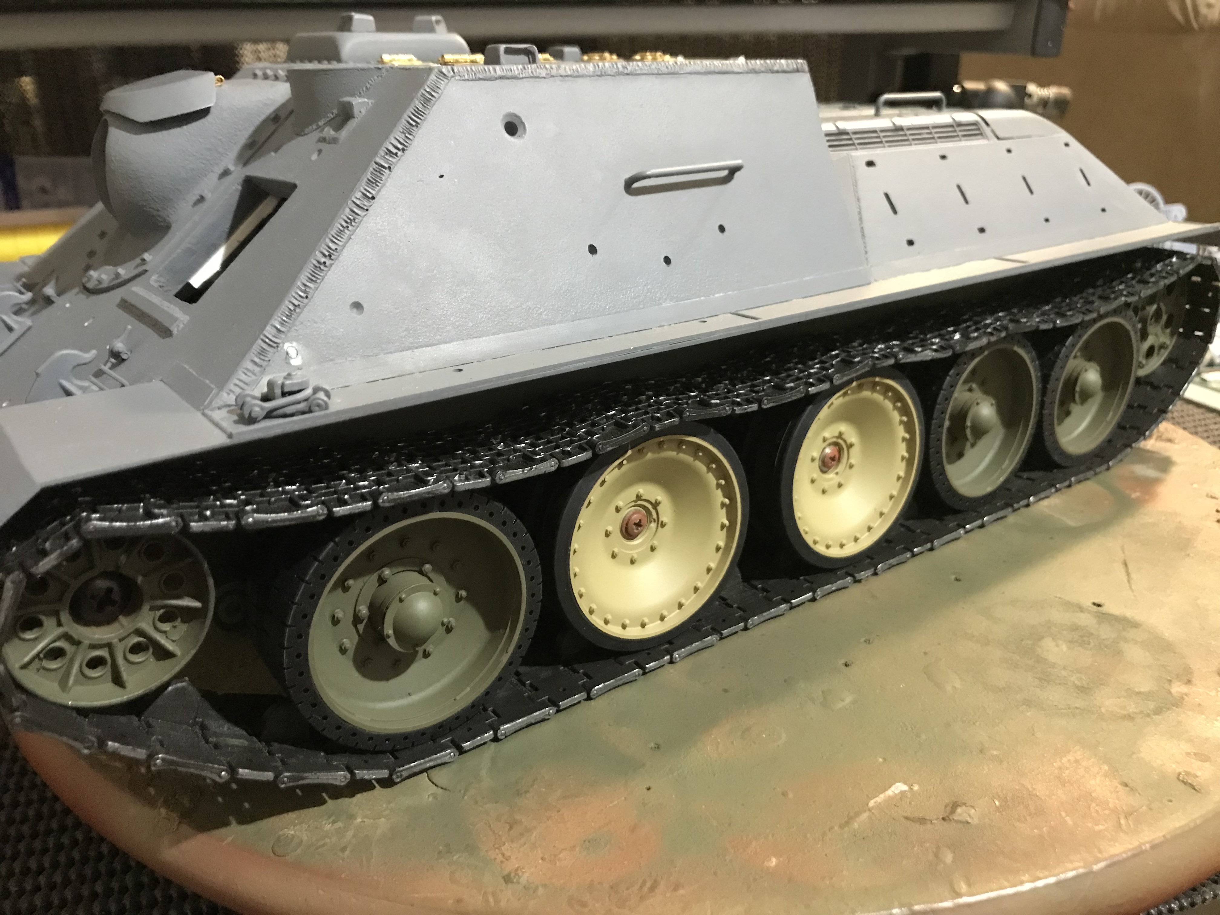

Well, after an hour or so of rough work with my normal tools, I have 3 wheels pairs with Panther outer roadwheels fitted.
Drill the Panther wheels out to 9mm for the Taigen bearing to the depth of the bearing plus a bit for luck.
Sliced the rear of the mounting hub off the wheel leaving a 4mm long stub that goes into the Raminator printed inner wheel.
Punched in the bearing.
Dressed a couple of flats on the short stub and ran the file around the stub to reduce the diameter by .5mm/side.
While not factory perfect, they are near enough.
The track guide horns will not touch the inside of the Panther wheels, but as Im putting these custom pairs in the middle of each side, the main deflection on the first & last wheels should hold in line.
The diameter is about half to 1mm larger on the Panther wheel, but that wont matter I think.
There is enough slop in the H/L suspension componentry that both wheels will still contact the track.
A minor but annoying point is the lovely hub caps that Mr Raminator made to snap fit into the printed wheels wont snap in to Tamiya Panther wheels :/ So I'm yet to figure out a simple & reliable way of holding them on. :think:

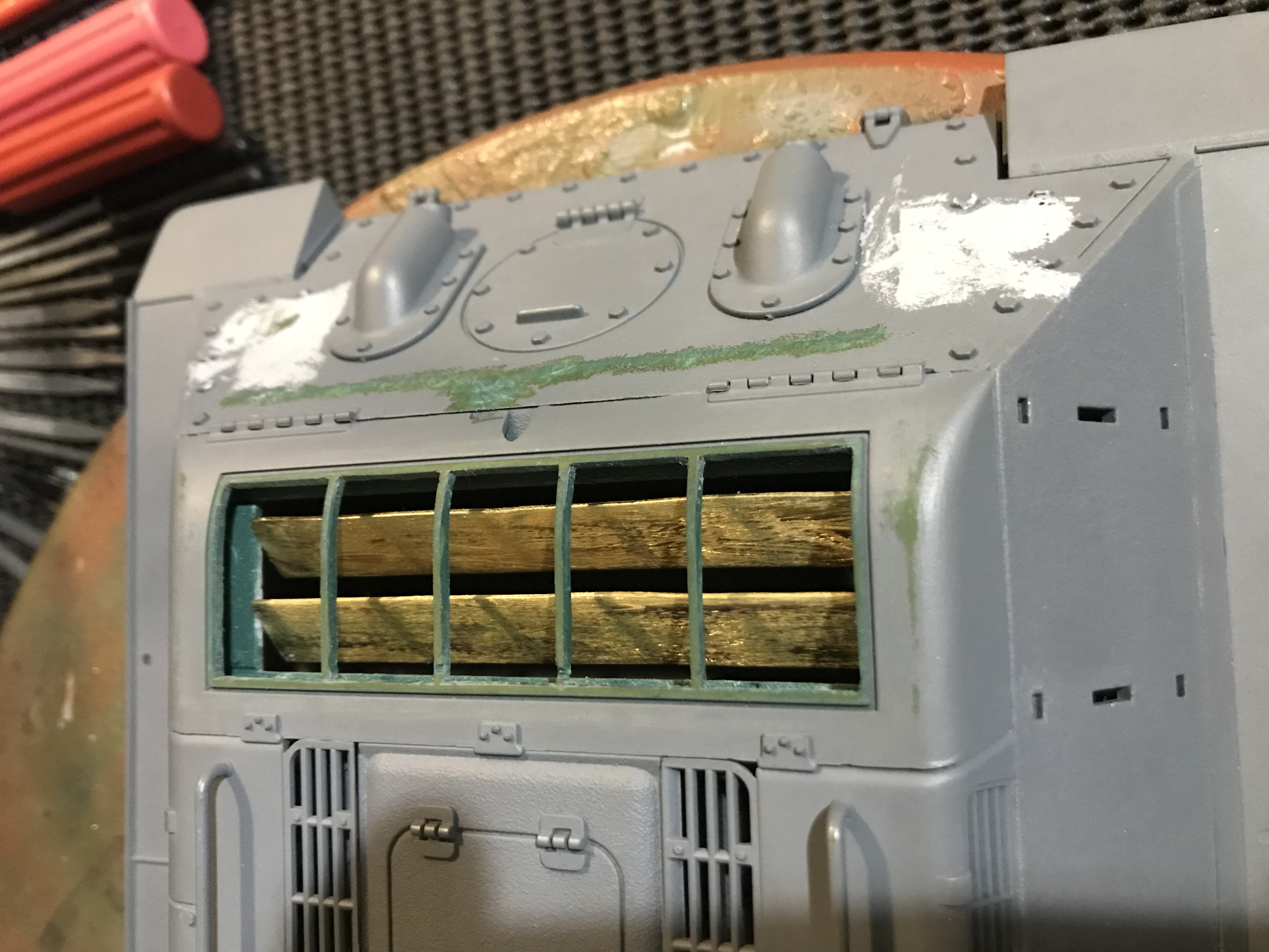

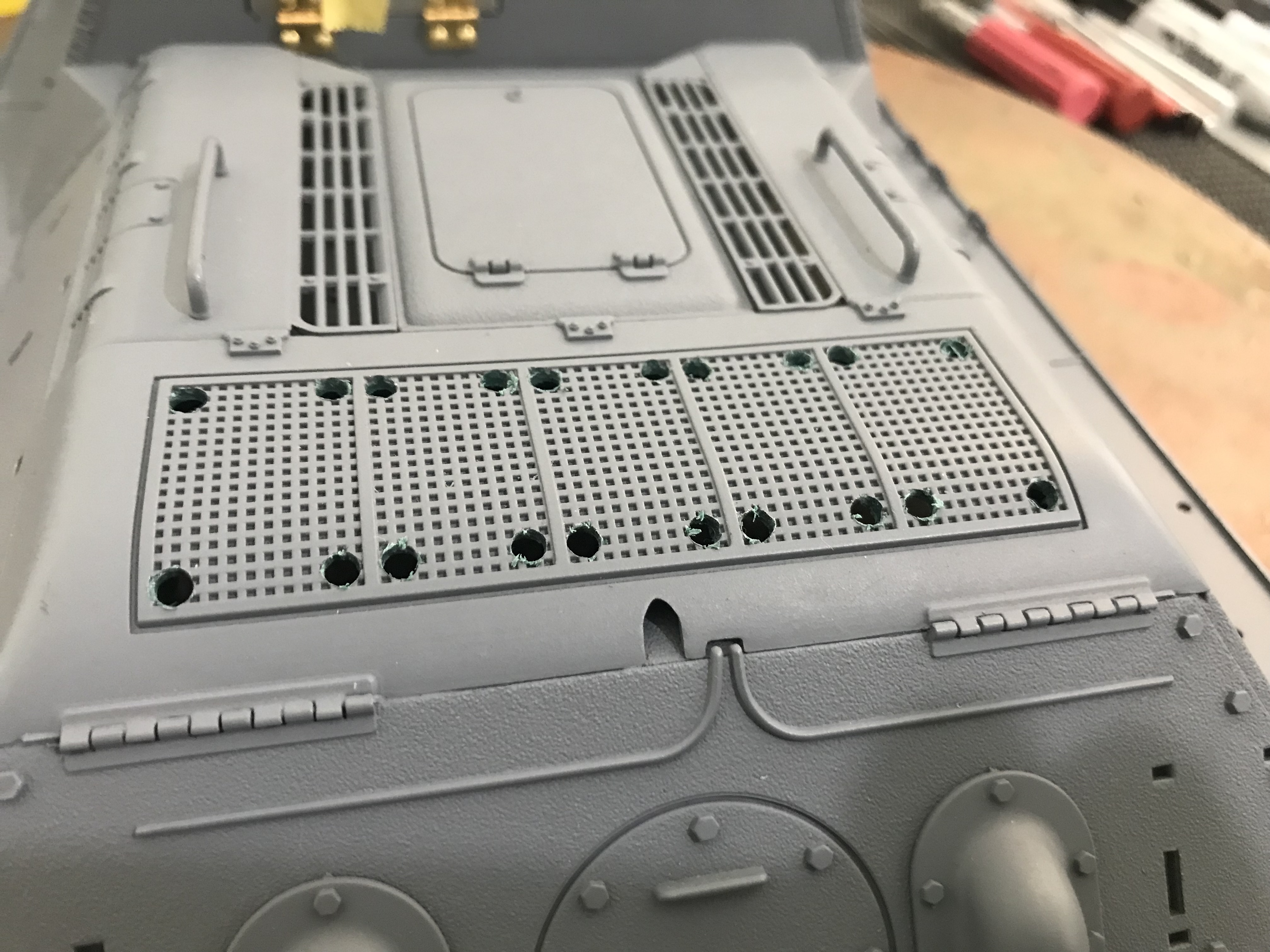

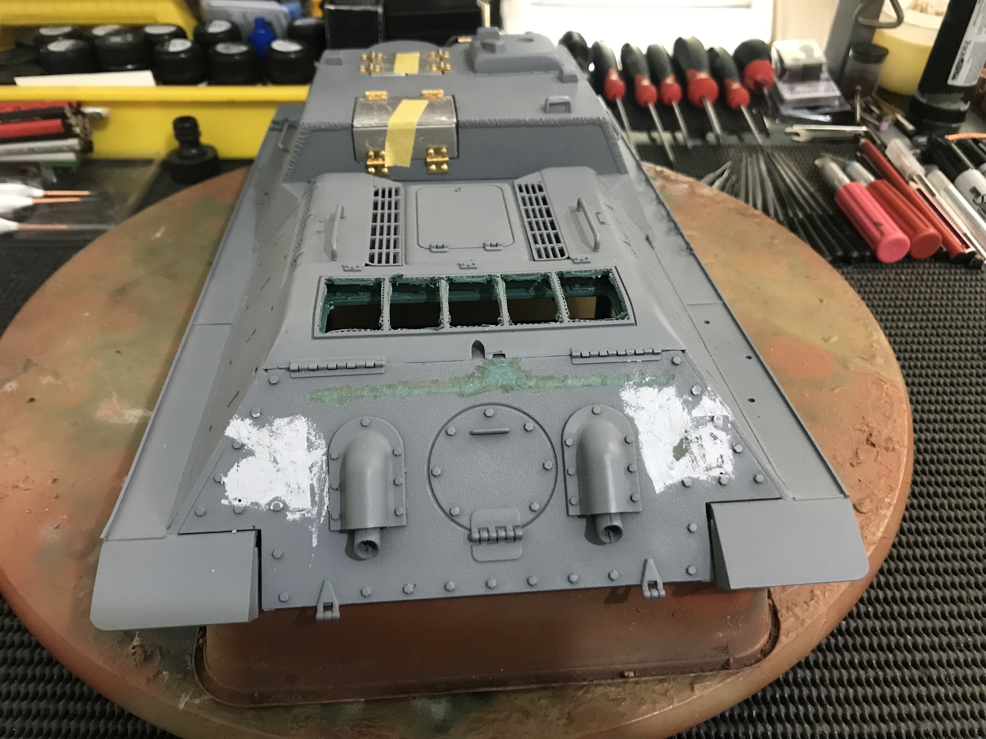

Being the pest that I am to myself, could not let things be & got on with other small jobs to get this thing looking a bit more like it.
As is a must with all T34 mods, the H/L rear transmission cover and louvered armour beneath need to be done properly.
Out with a small drill to punch the corners into the plastic mesh.
Sliced carefully with a cutting blade on my power hobbytool & a shower of green plastic & out they came.
The rest was dressed with a lot of filing & sanding.
I've got some Taigen brass mesh to fit in.

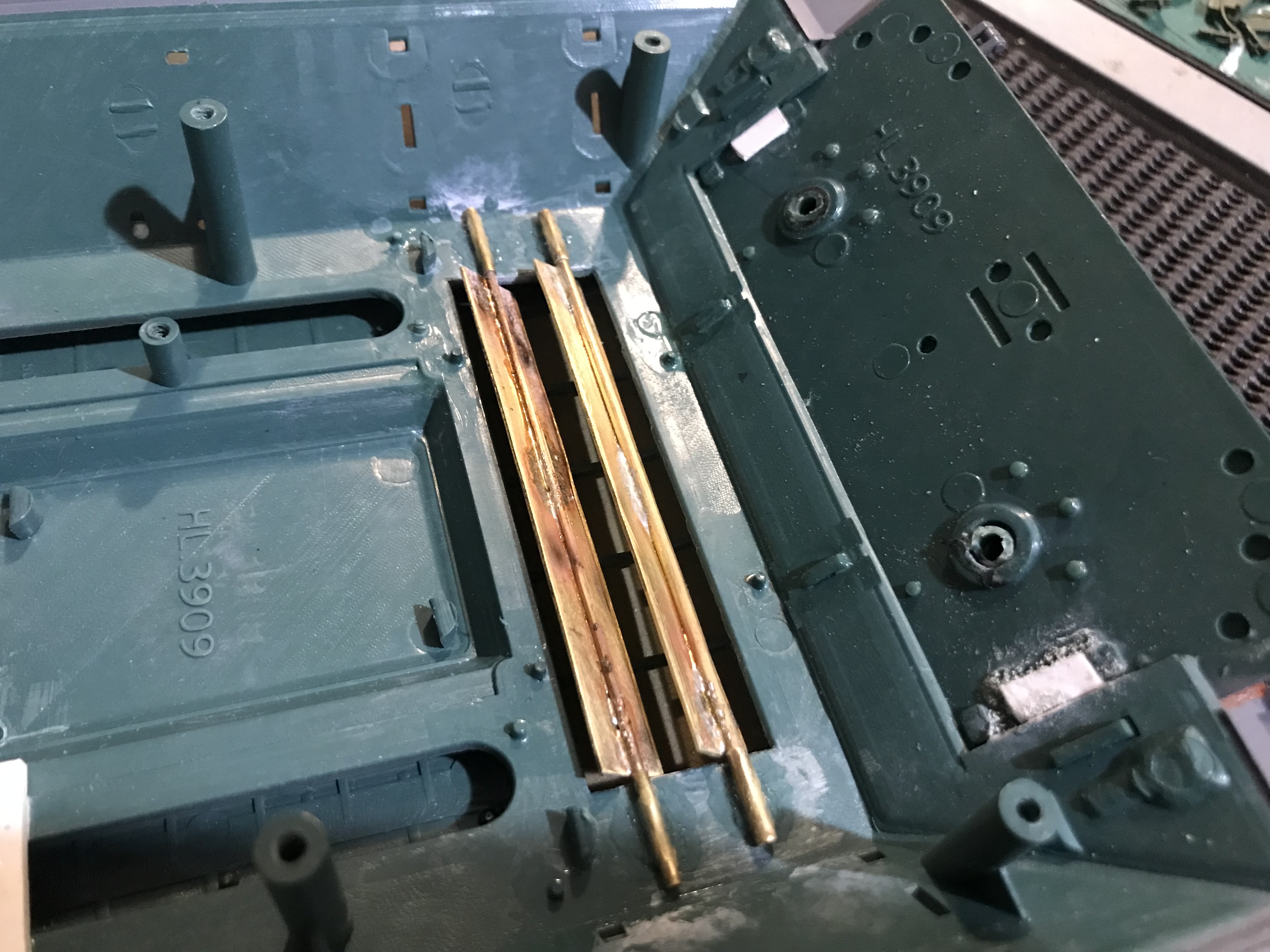

The louvers were chucked together out of scrap brass flat sheet and tube.
Cut to length, the flat was dressed to suit the opening then cross bars were solder pasted across with 8mm sticking out both ends.
Tube that telescoped over the cross bars was cut & slid over each end.
Super glue held them in place.
Its a good mod to do for looks alone, but also to allow more sound out of the hull, and any heat from the motors out during extended running.
Cheap & cheerful but adds a lot I reckon.
I also filled in the sockets for the unused smoke canister brackets as the late SU85's which this is, they were not fitted.
The H/L molded conduits for the release cable for them were also carefully ground off.
I will cover the marks with Mr Surfacer and putty as required.

Just had a thought...........what about paint on the Panther wheels ?
Ive done them in a plain German Dark yellow & they stick out like a Bulldogs youknowwhats against the green background so I had a thought that maybe if the Russian support group that pulled off the repair was well set up enough, surely they would have had paint to blend them ???
What do you guys reckon ? Brush paint a bit of 4BO over the yellow leaving some visible ?

Also a perfect green color match wouldn't be necessary as the tank and wheels would've been painted at a different time.

Interesting project! Were they roughly the same diameter?
How many are you replacing with Panther wheels?
I’d put an odd one in dunkel gelb or red oxide? and another with camouflage on the other side. Once weathered it’ll look fine. One of them with a thin coat of 4BO would look good?
Posts: 11878
Re: SU '85 AN-BRI-RAMINATOR PROJECT
Thanks for the common sense advice lads.
I can certainly chuck a camo pattern on one, and a 4BO rough cover over one, and the single on the other side could also be camo just to break up the green.
I have run out of Tamiya Panther outer road wheels.
2 went on the turret flanks of 111 and 3 are on this.
I gave another 2 away to a mate for a very cool build he’s doing which also needs them on the turret flanks.
I just need to figure out how to properly mount the hub caps on these though. :think:
They look right at home here ;)
