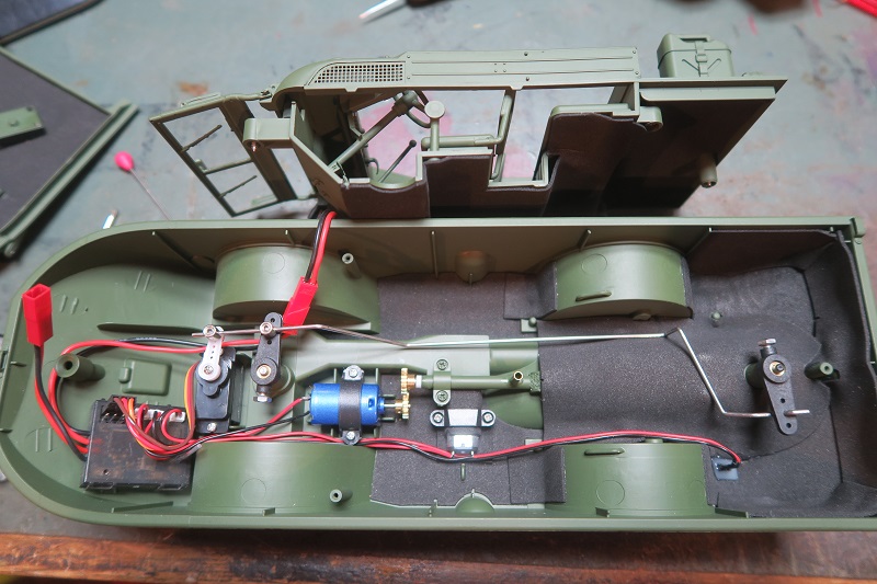

Last sunday i also made a driving test, it works well, but at the ned it stopps, no for- ore bachwardsdriving are possibel......
Here is the video:
And also in this video at the end you can see it swimming with a trailer, maby better with only one person inside:
But after the hilltest...there was no vorward ore backward...so i have to serach for the cause....
I opend the littel part at the bottom:
The 2 geras are was not close together, so it doesent work.
First i try to bring them together with some poly pices:
...dosent work.....so i take a second look if i can adjust the other "Kegelrad" thats locatet at the "Motorwelle".
So i have to open up the GPA.
2 screws are at the front, they easy, the third was a bit hidden under the spareweehl:
And here you can see the inside:
Its an N20 gearmotor (the blue one is only for swimming):
Good the there is a bec plug to seperate the upper.
I try to move the motor, but no way.
So i look again to theKegelrad from the Motor, i have no that smal Inbus (and there is also a lot of screwloking on the imbussrev) , so i try to move the kegelrad with a smal screwdriver a bit in direktion from the other kegelrad....and, well that works out!
Now it drives again :thumbup:
And i put some poly sheets behind the Kegelrad, hopefully it doesent move back agin.
So for now it draives again, will se how long 8)
Ill keep you updatet, greetz, Andy

Thanks for sharing this potential problem with us Andy, glad you found a temporary fix for it but in all honesty you should have no need to be doing this especially after such limited use performing only the functions it was designed to do, this is not good news partically for the price Torro will be asking for it :thumbdown: Hopefully yours will keep working the way it was intended now :thumbup:
