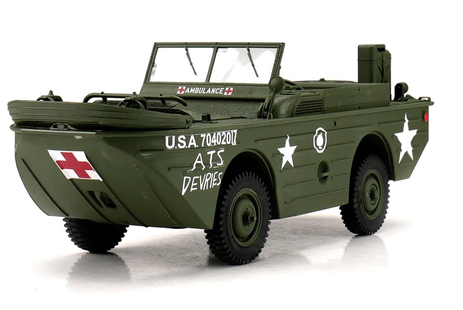

The car :-)

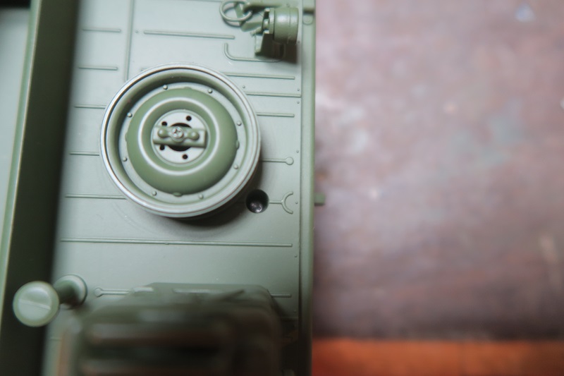

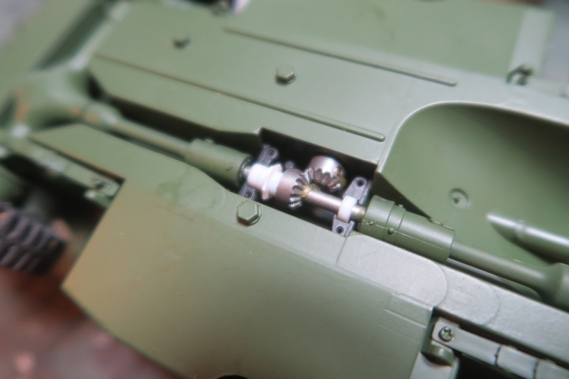

I opend the littel part at the bottom:
The 2 geras are was not close together, so it doesent work.
First i try to bring them together with some poly pices:
...dosent work.....so i take a second look if i can adjust the other "Kegelrad" thats locatet at the "Motorwelle".

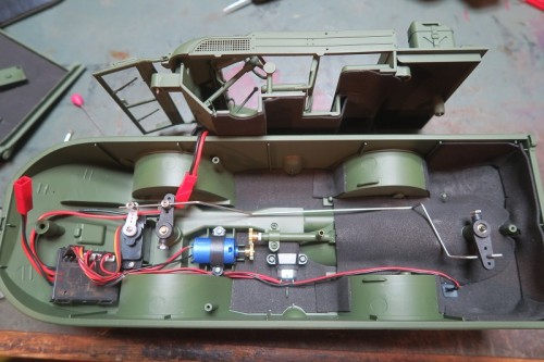

2 screws are at the front, they easy, the third was a bit hidden under the spareweehl:
And here you can see the inside:

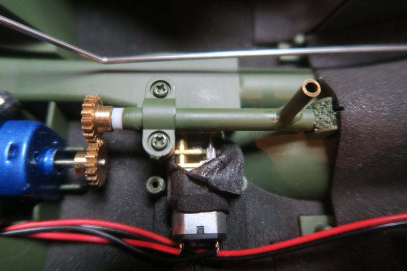

Its an N20 gearmotor (the blue one is only for swimming):
Good the there is a bec plug to seperate the upper.
I try to move the motor, but no way.
So i look again to theKegelrad from the Motor, i have no that smal Inbus (and there is also a lot of screwloking on the imbussrev) , so i try to move the kegelrad with a smal screwdriver a bit in direktion from the other kegelrad....and, well that works out!
Now it drives again :thumbup:
And i put some poly sheets behind the Kegelrad, hopefully it doesent move back agin.
