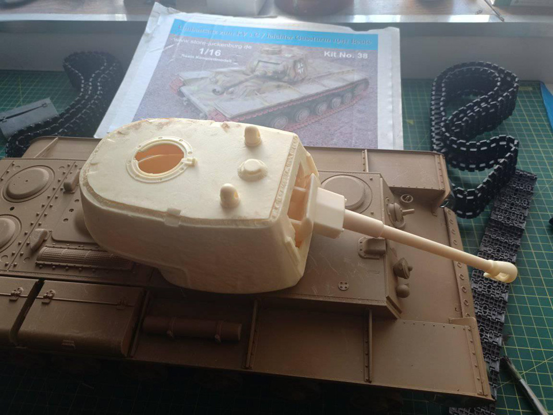

That is an interesting idea was thinking of getting the Heng long Panzer 4 barrel and drilling a hole to allow me to for a recoil module. But I'll looking in to the Soviet gun.
- 43rdRecceReg
- Posts: 6295
Re: Panzerkampfwagen KV-1B 756(r)
Working with resin, requires its own specialised discipline and bonding agents, Stu. The other issue with scratch-building anything is that the mounting brackets, studs, moulded standoffs, captive nuts and so on typically found on RTR ABS/Styrene tank parts, are often totally absent on flatpack and resin kits. You will have to improvise.
Then again, digging around on the 'Net, there's always a chance you'll find a thread somewhere dealing with a successful installation.

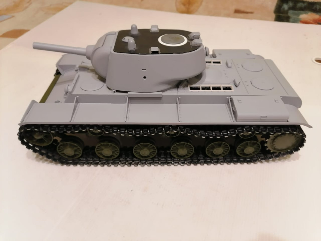

So I've started building this up. Found alot of the stuff I was hoarding was in fact broken. Got this new BB launcher from forgebear. Been parting out a Heng long turret to make the ball run. (What is the best way to cut hard plastics? I'm terrible at it) I've also had to modify the launcher it's self to fit and shave away a tiny bit of the side of the turret. But it should now work... Or deliver balls straight down in the the gearbox so I can have some historically accurate transmission failures!
Sent from my Armor 9 using Tapatalk

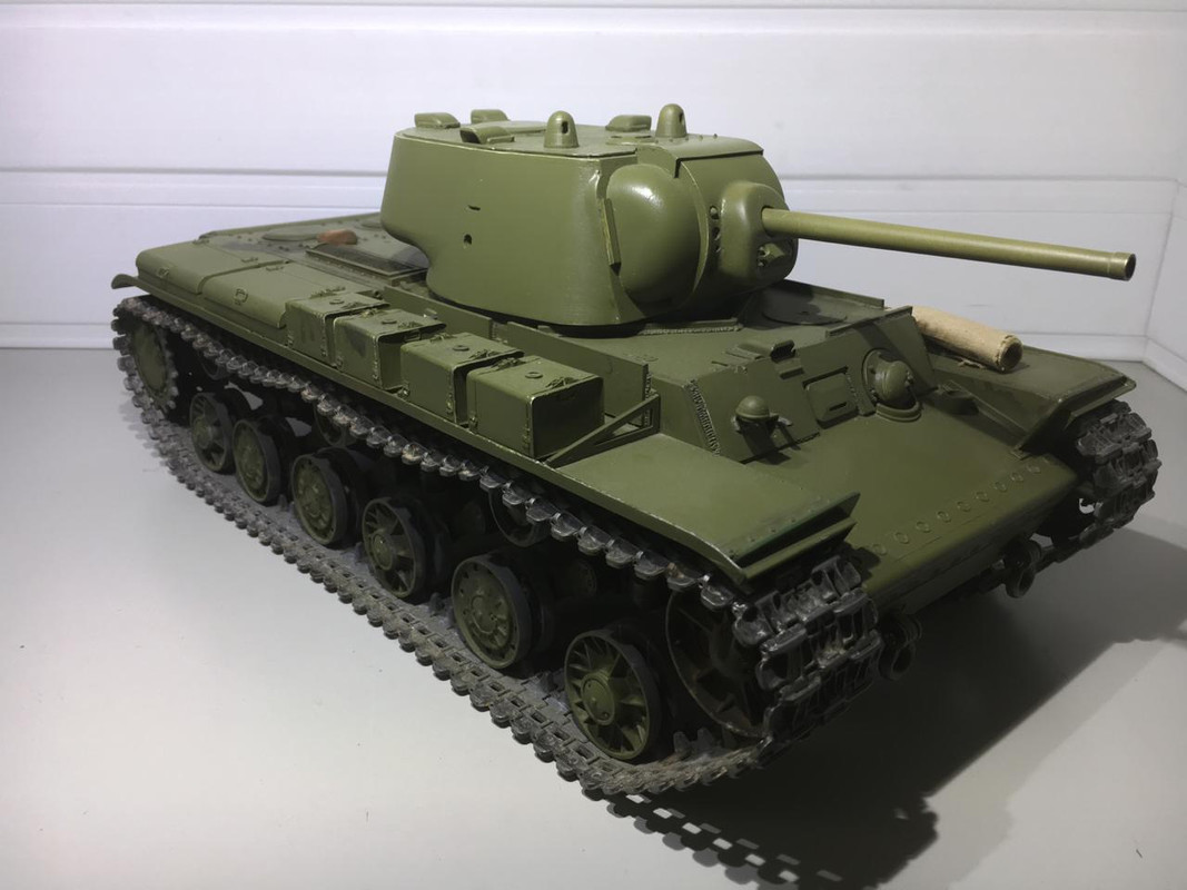

So really not 100% happy with how this has gone so far. Think this will be my last air brushing project. It's just not a process that I enjoy. Was trying to go for a modulation and I wanted to spray a bit of brown on the underside to near the tracks to make look muddy. But was just wrestling with the airbrush and then it started spitting. So I gave up. It's darker than I would like. I am going to just try and add lighter colour weathering pencils to try and blend it all in. The pencils are great because I can keep wiping them off if I don't like the effect. Unlike the air brush that likes to vomit up splodges. but not sure how do deal with the sharp transition from the tracks to the underside.
The slogans should say "victory" and "for the motherland" but I might have been tricked in to writing something very rude on the side!
