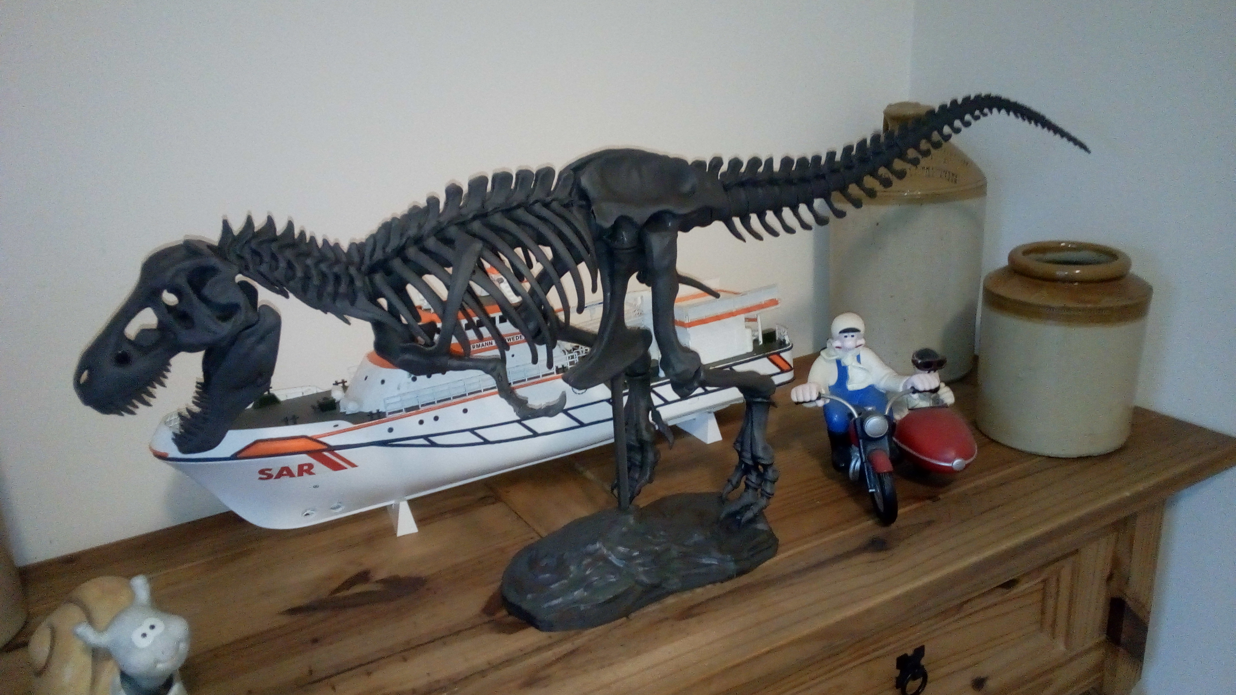

My current prints, not my designs, are huge dinosaurs that make great ornaments. Hundreds of hours of printing though!
