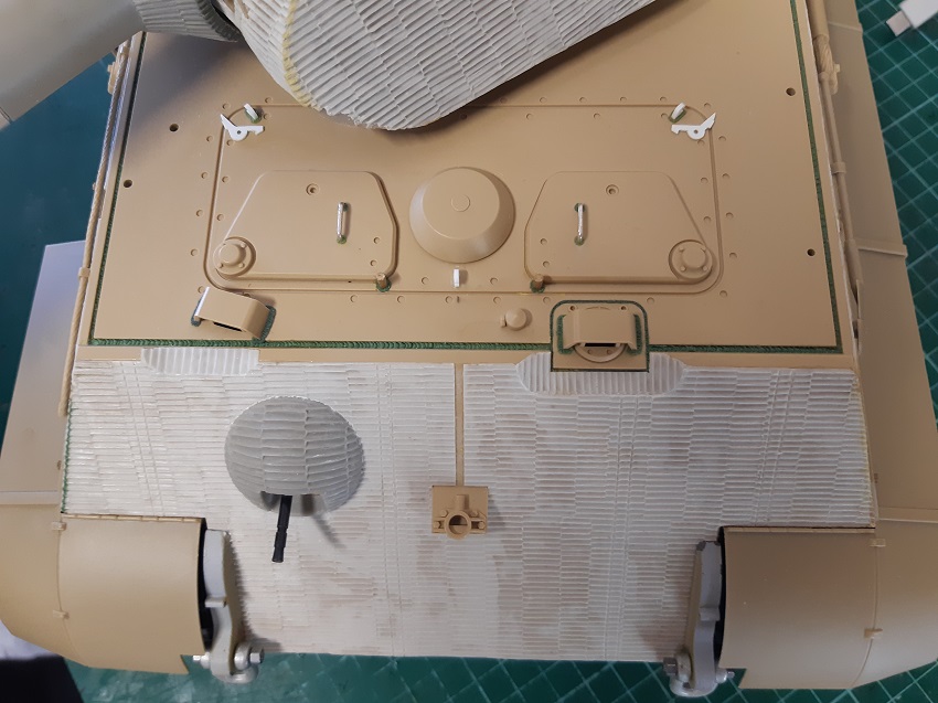

Hi Tankers.
Before going through this post i would like to thank Fredrick The French, Felix from Alxes modellbau and Patrick.H.
I started this build 5 and a half years ago with no particular tank in mind and quickly abandoned it to the shelf as the Atak Zimmert kit I had purchased when fitted had shrunk. I have got more confident with my modelling skills so away we go.
I've found I was very interested in the pre-production King Tiger N0.11 because of the great photos that are available of this tank.

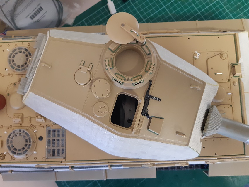

The model will never be correct as it wont have
1. Early tracks with a 18 tooth sprocket
2. The Tamiya deck has the cut out for the ball gunners observation visor, which was not present on the pre-production deck
3. The Tamiya turret only has one hole for the later T.Z.F.9D gun sight where the pre-production had a T.Z.F 9B gun sight, which required two holes.

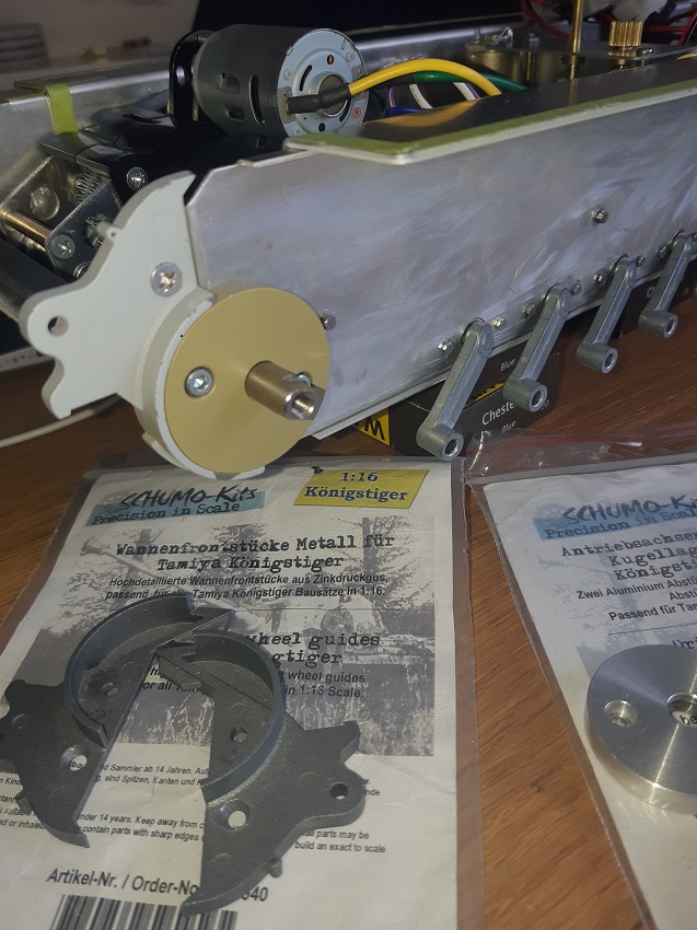

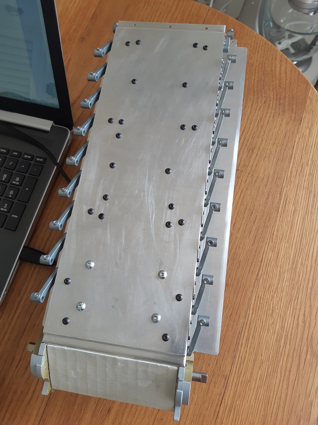

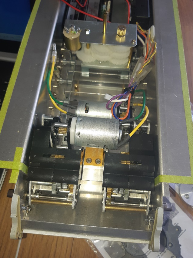

The hull/chassis i have added 2mm Aluminum plate to the bottom,replaced all screws with bolts, added a DLKM Transmission support brace, Schumo metal sprocket wheel guides and Schumo transmission output/axle shaft support bearings. I have reconfigured the transmissions with a full length bronze bushing in the final brass drive gear before the output shaft and shimmed all gears for matching drive faces. I did a post a while ago called [Tamiya transmission fix] which showed what I used to reconfigure the transmissions. You can see I am trying to make this as bullet proof as possible and the hull/chassis is now rock solid with no flex.
Chassis/Hull Components used.
1. Schumo KT0014L Improved track idler system.[Drums]
2. Schumo KT0033 Upgraded idler wheel axles and main axle.
3. Schumo KT0040 Metal sprocket wheel guides
4. Schumo KT0027AL Driveshaft support bearings.
5. Schumo ZUH19 3.1 Reduction gears
6. D.K.L.M Transmission support bracket
7. 2mm Alloy belly plate.[home made]
8. Knupfer 2mmx6mm Bolts and Knupfer 2mmx4mm Bolts
9.Tamiya DMD turret rotation unit .Part no 0P.400
10.Atak zimmert.
The wheel assembly's have been painted apart from the outer faces and I added a shim to these before assembly for a very effective modification that is also easy and cheap. Look for a post of mine [King Tiger wobbly axle fix]all is explained in there.

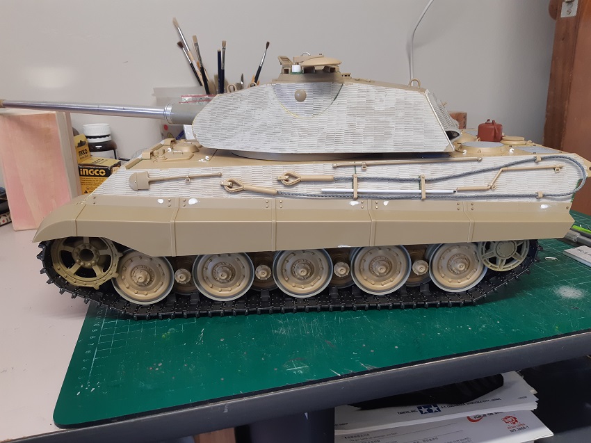

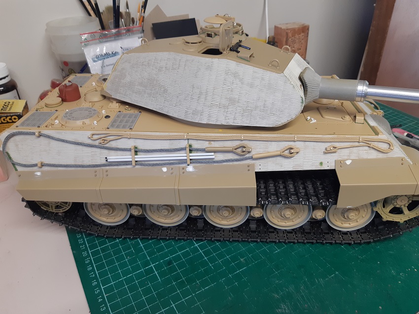

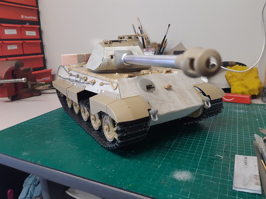

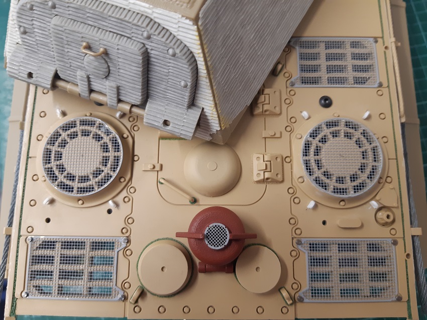

DECK and GUARDS. Tamiya has you attaching the guards to the deck by 3mm P/K bolts which are totally unrealistic and in my opinion make the model look like a toy. I filled these holes with Milliput then used Knupfer 1mmx 5mm bolts, washes and nuts to attach the guards so they can still unbolt and removed a guard section which was missing when King Tiger 11 was found abandoned. Apart from the the rear tow cable brackets and the vertical brackets for the tow cables and barrel cleaning rods I have pinned every thing on the sides. All tools, tow cables, track changing cable and barrel cleaning rods I can just remove and after being able to paint these off the tank ,I don't just have to rely just on glue to hold them on. The kits plastic tow cables are way out of proportion so I used Schumo 2mm steel cable flexible. I love this product. Bend it how you want it and that's how it will stay. You don't have to fight the wire .The secret is the inner core has a nylon thread. Worth its weight in gold, affordable and only available from Axles. Deck grilles are ABER but I used 1.2mm bolts, washes and nuts to bolt them on. Apart from the the three prototypes made[V2 prototype is the Bovington tank museum and is not made of armor plate] N0 11 was one of the first eight to be produced for service and sent to the front so being that early build it had the deep wading snorkel cover attached on the back deck[the first eleven had this feature], no armored turret ring, no anti grenade screens, first version armored exhaust covers and one of the prototype exhaust designs with Tiger 1 type exhaust shields . The deep wading snorkel is made by Patrick.H who is a member on this site. This is sold through Shapeways .Patrick originally did these for a Heng Long but I supplied him with some dimensions and he was kind enough to produce one to fit a Tamiya properly. The kit is a mixture of 56018 full option and Tamiya static Porsche turret I used the full option deck which has turret rollers and also installed Schumo larger turret rollers. Used Schumo kit for hatch handles. Welds every where.
Parts used.
Schumo.ZUH 30 Turret rollers.
Schumo ZUH 07 2mm steel cable flexible
ABER 16 034 .Grilles
Patrick.H .Deep wading snorkel.
Knupfer 1mm and 1.2mm bolts,washes and nuts
I am not a bean counter as I have already mentioned that this model could never be correct but I like it when member's mention what they used, a part number or were they bought it. So helpful guys.
Click on the photos below to enlarge.

Hi Fredrick, No 11 had exhaust shields and I am using your idea of taking Tamiya tiger 1 shields and modifying them to fit. Regards John.
