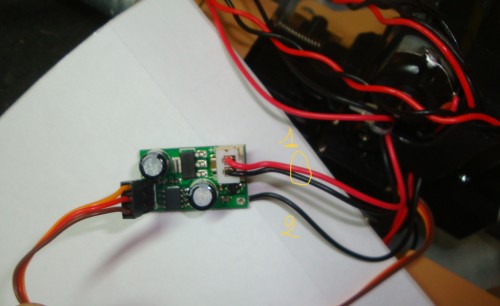

there is also the solution with this HL or Taigen module? for a servo on an RX 18, a friend did it on his Sherman, see attached photo, but no explanations?
http://rctankhobby.com/html/products.html
