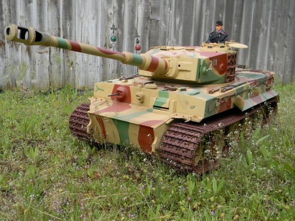

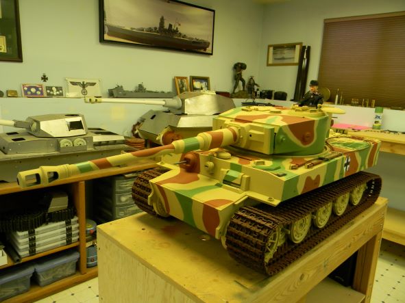

Just a couple pics of my Tiger 1 that i finished a few years back. Almost done with Tiger 2 and then on to the Panzer 4 in the background. Tank shop workers need to get busy, so many projects and so little time! :haha:

Superb Tiger I and growing collection !
You seem to be playing a bit rough with your tanks as i can see the damaged mud flaps and side skirts on the first picture in the field. There must be a not so funny story to tell about what happened.
Everything looks so perfect but I think you have mounted a longer Tiger II gun section on your Tiger I mantlet, any particular reason ?

lmcq11 wrote:Superb Tiger I and growing collection !
Actually just the gun that came with the kit, i believe it is supposed to be a KwK36 and i compared it to my Tiger 2 gun that came with that kit and the barrel and length are definitely a bit bigger.
