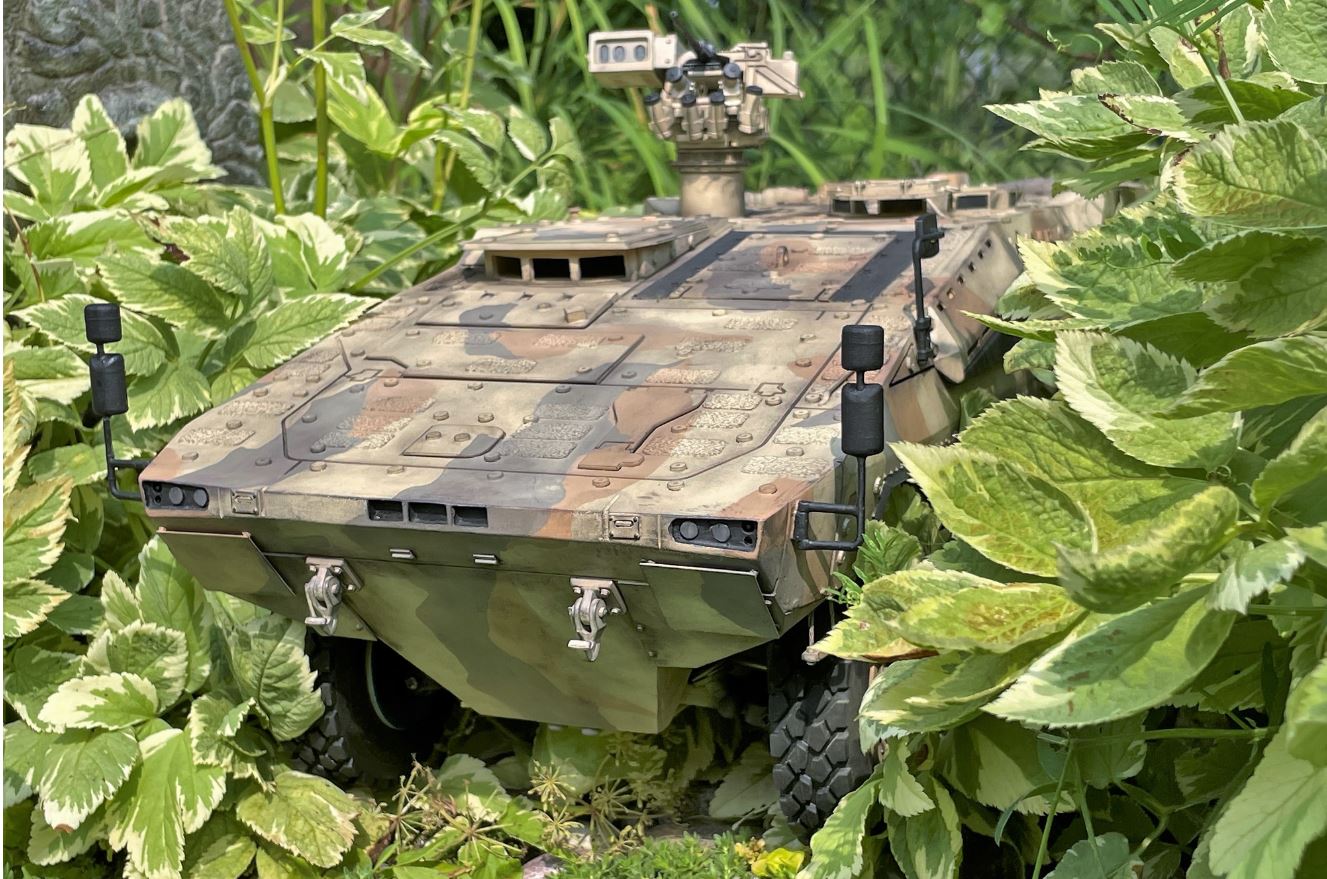

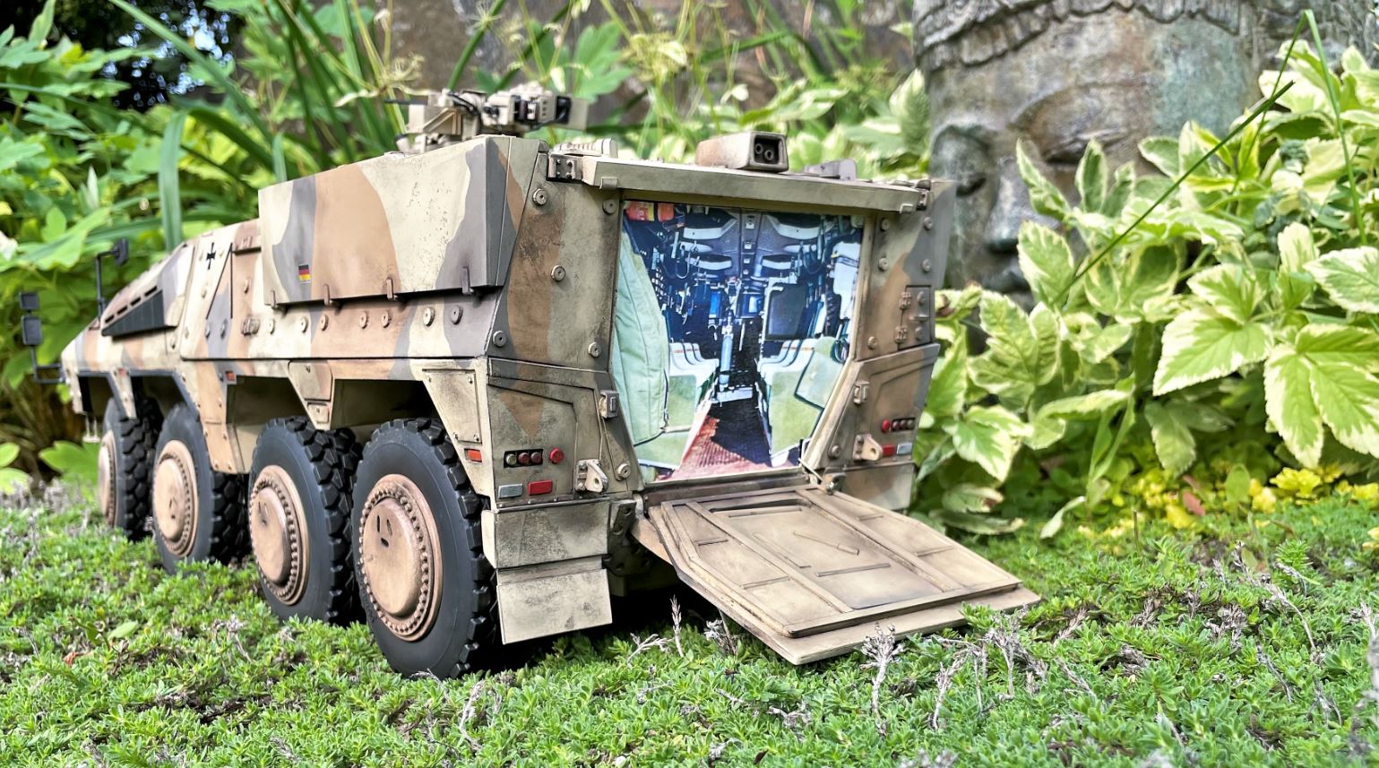

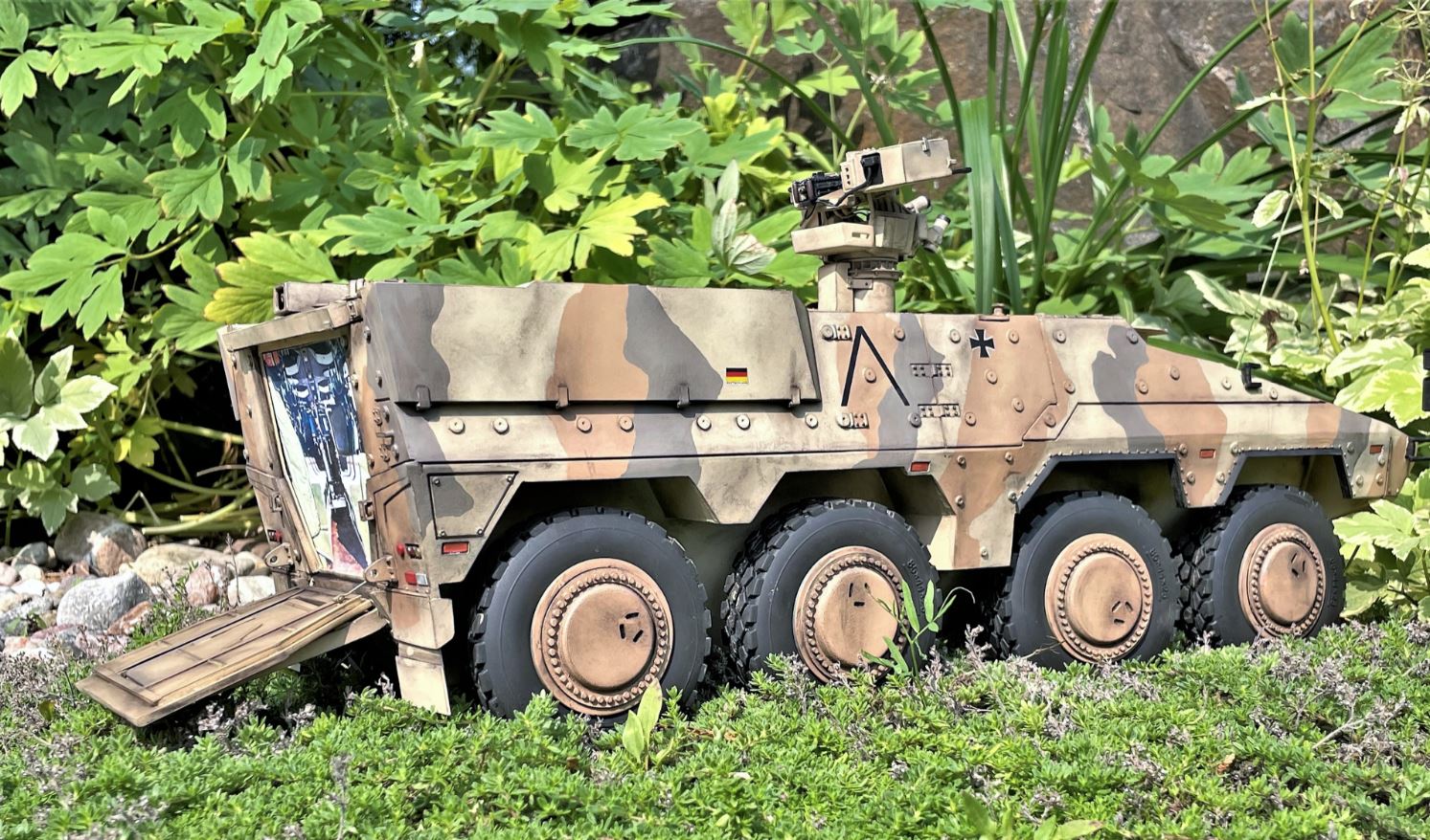

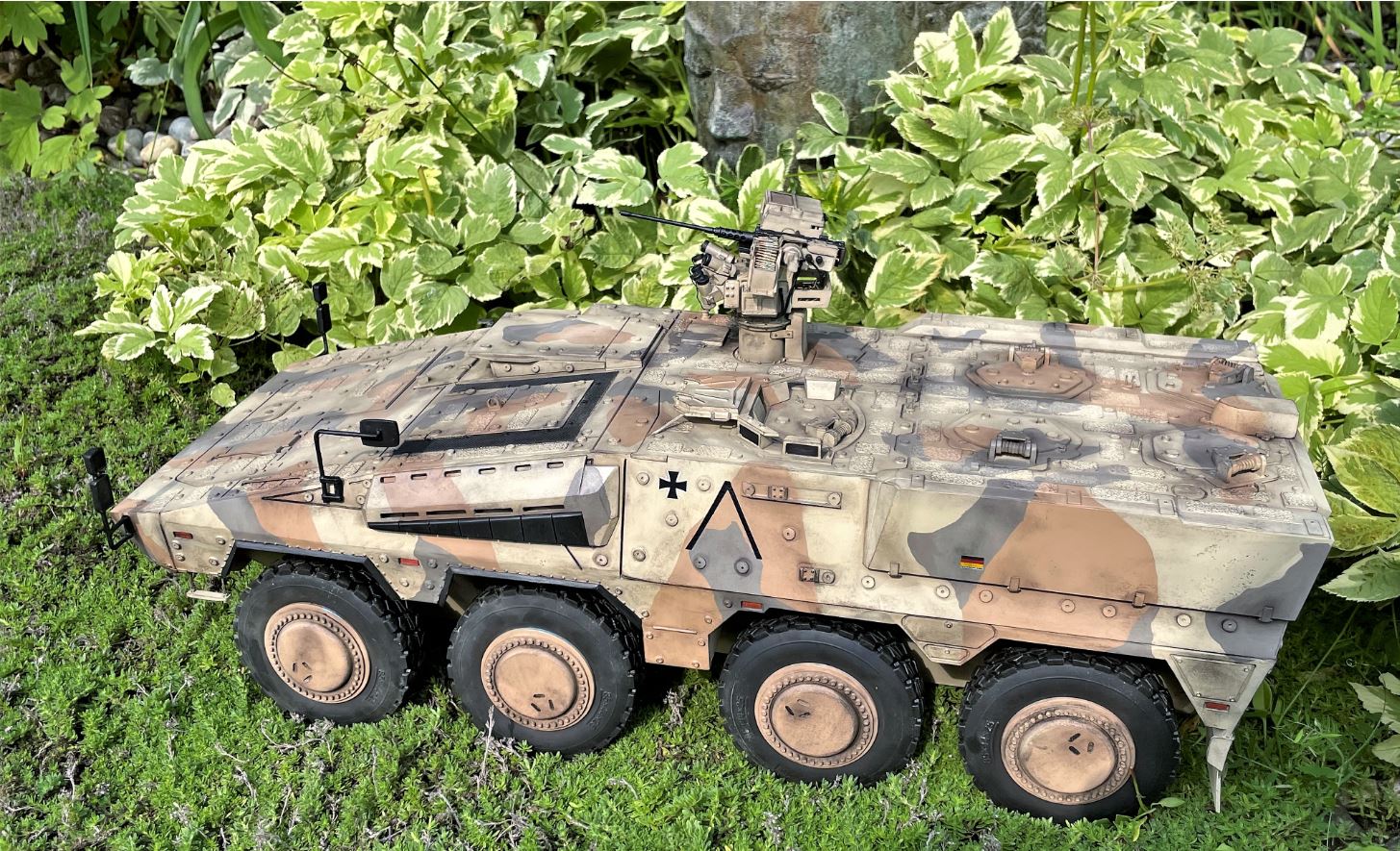

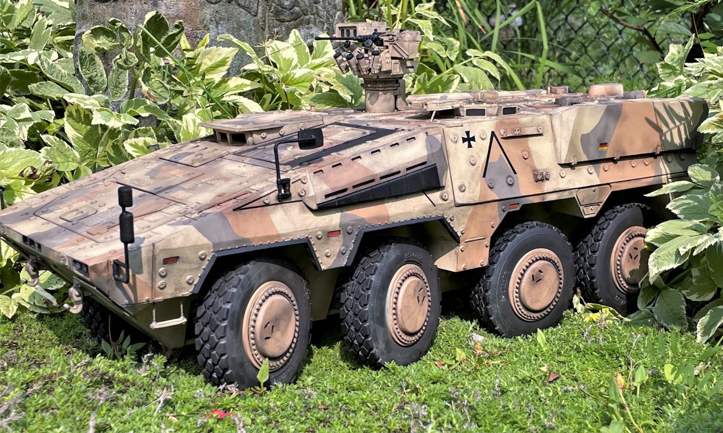

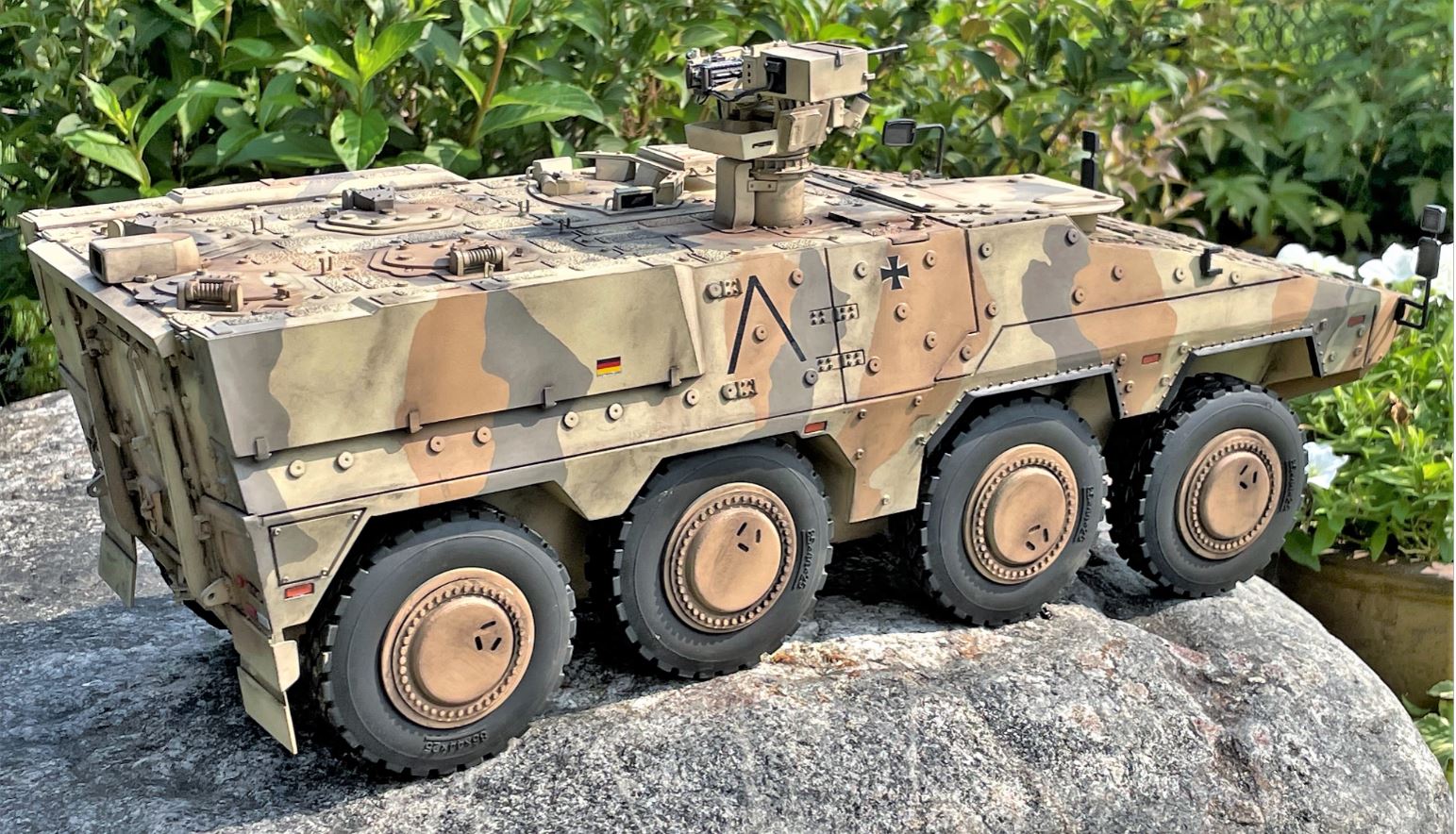

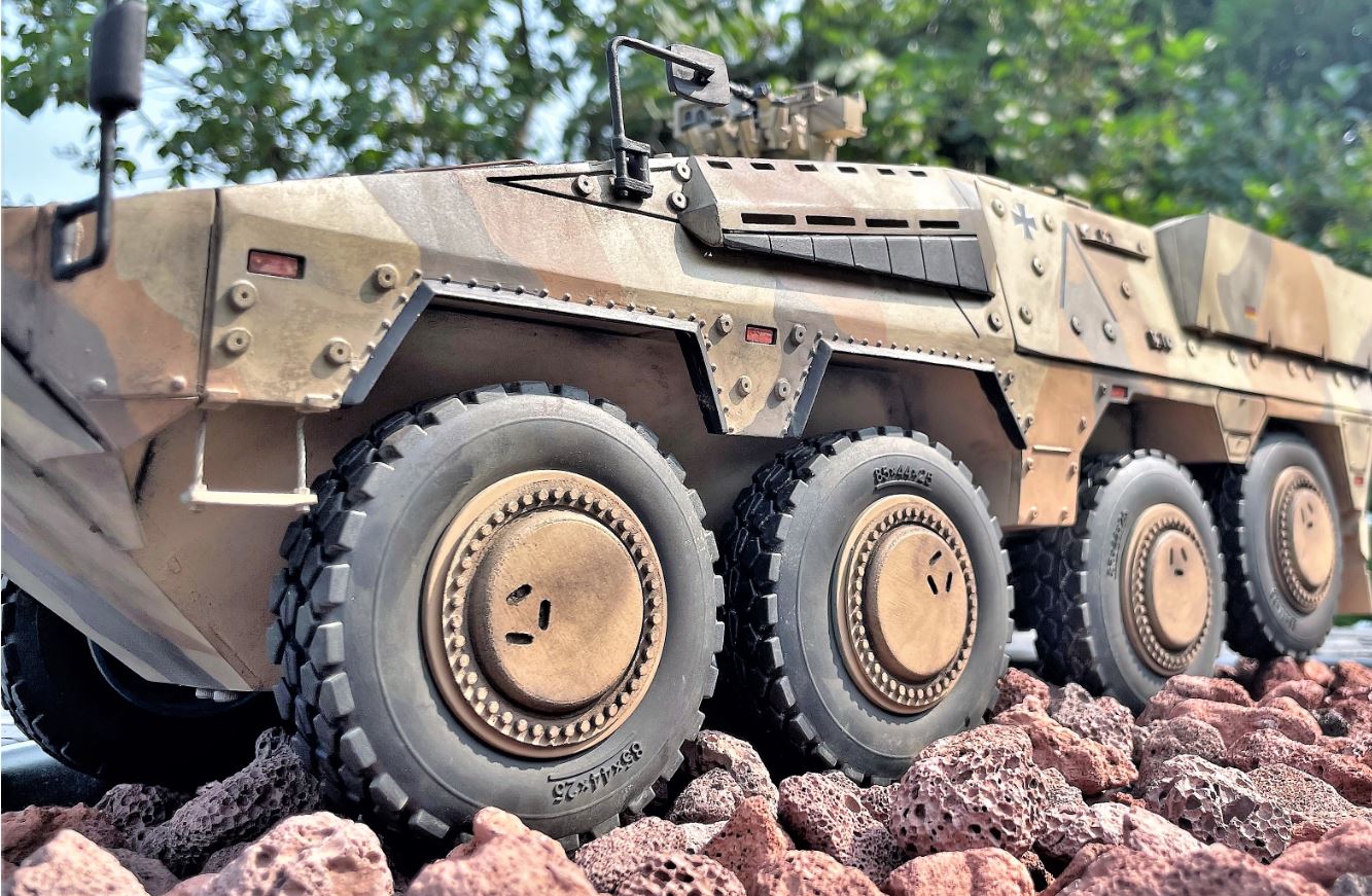

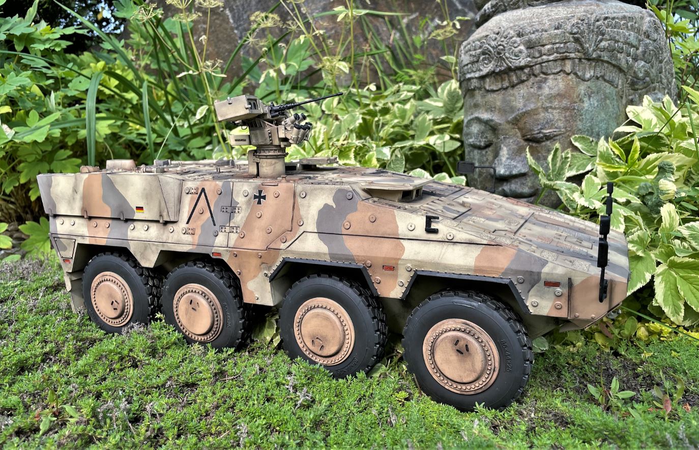

This is a remote control 1/16 scale GTK Boxer wheeled 8x8 armored fighting vehicle of the modern Bunderwehr.
The build report can be viewed at viewtopic.php?f=202&t=31635
The model has the following features;
- Enhanced Ludwig plasticard base kit
- All wheel drive 8 x 8 running train designed using WL A979 buggy components with metal upgrades
- 1/10 SCX10 Axial metal gearbox with 540 motor
- Steering on first two axles
- Clark TK40 control board

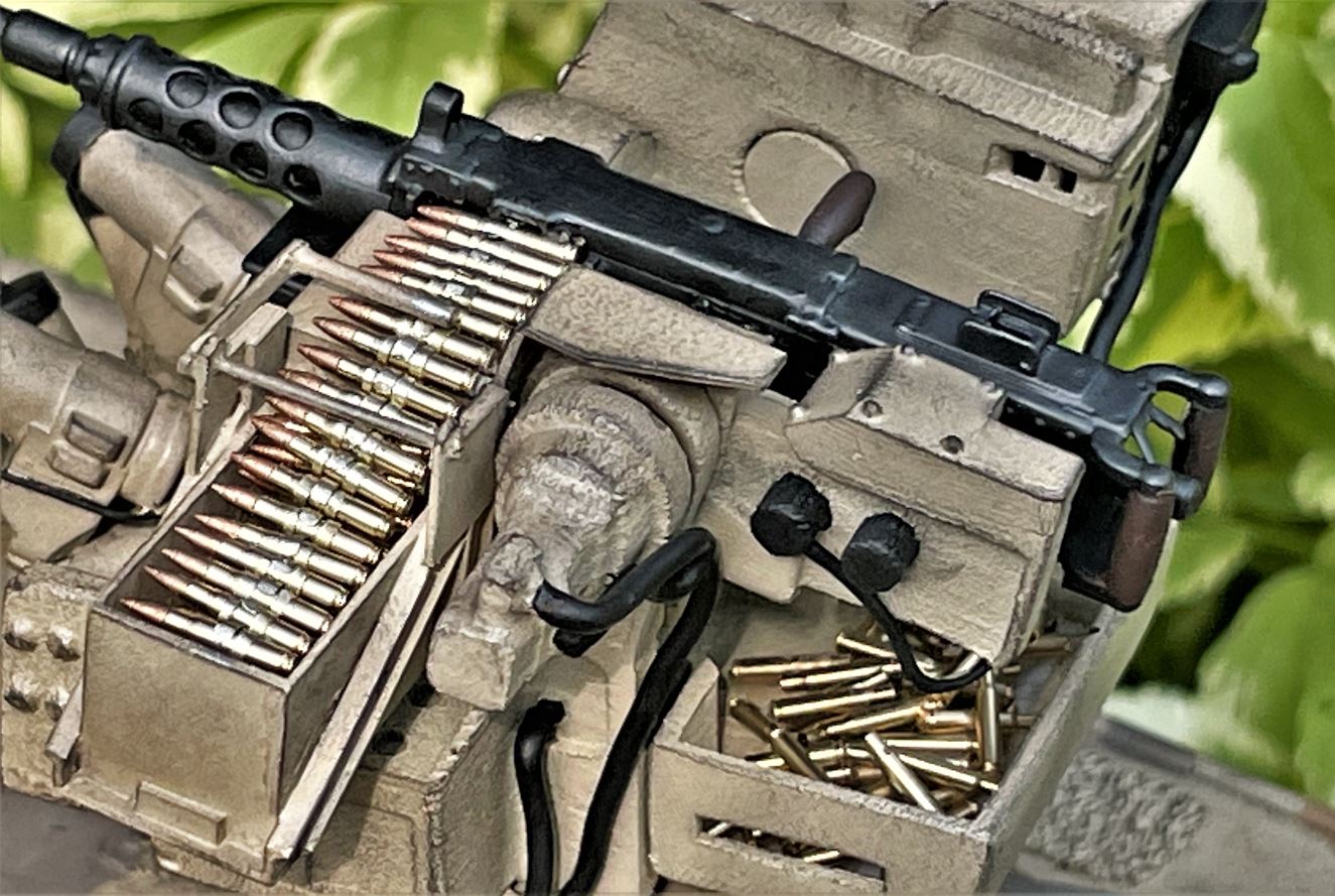

- FLW200 weapon station with Browning M2 was given rotation, elevation, flash and sound.
- Tamiya Browning M2 with Aber/Master upgrades and LED
- Servo opening/closing rear ramp
- Headlights/tail lights
- Camo for Bundeswehr Afghanistan mission done using MIG Ammo paint

Great looking model, very well done. :clap: :clap:

Exquisite work, just the right amount of weathering. Very nice model!
