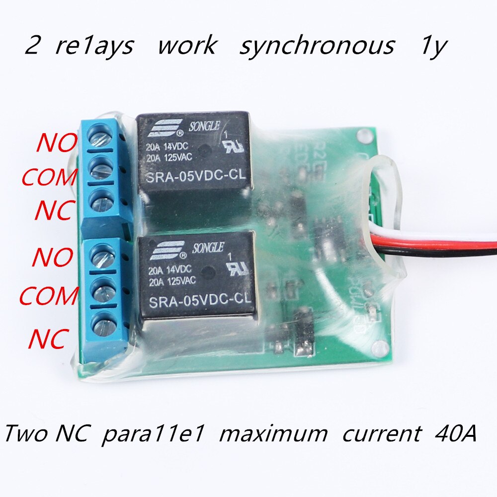

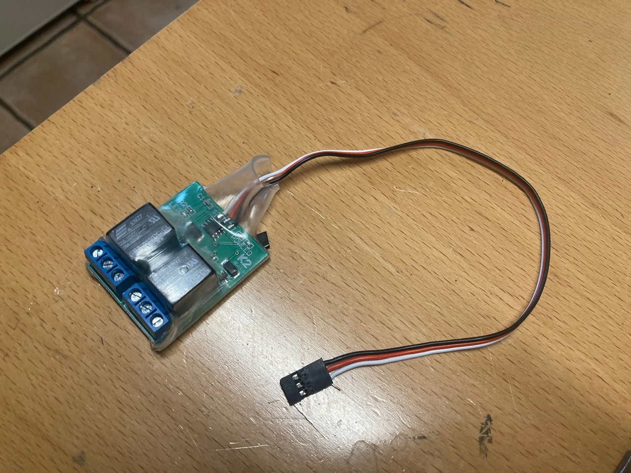

I bourght this in the undestanding that i could get 2 relais functions, using only one channel using a 3 pos. Switch on the TX. However they work in parallel so switch pos 1 trigger both relais, switch in midle borh relais off, switch in pos 2 nothing.
Is there a trick to make this thing do as i want?

That K2 is an On/Off switch using a relay. Not a reversible output.
Typical application
1. Connect
- Plug the signal input cable into an idle receiver channel that corresponds to a switch on the remote.
- The power indicator will be illuminated when connected to the receiver.
- The work indicator lights up when the switch channel is open and vice versa.
2. Working mode
- The red LED light indicates the power indicator.
- The blue LED indicates the relay's operating status.
3. Trigger
- Turn the switch on the remote control (OFF->ON), the green LED lights up and the relay starts to work.
In Off position, power travels through the NC/Com circuit. In ON position power travels through the NO/Com circuit.
Those NO/Com/NC can handle up to 20A each relay.

So the K2 is a simultaneous switch of both relays which is what you posted.
A Q1 version is what you need to be looking for.

dane61
Posts: 118
Joined: Sat May 26, 2012 7:30 pm
Location: Denmark
Re: Double relais for servo imput
Post by dane61 »
Thanks for your interest.
I have tried a pot. channel and its the same. Full stick trigger both relais, half stick off.

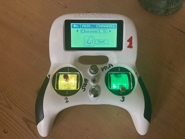

Pic of my tx.
