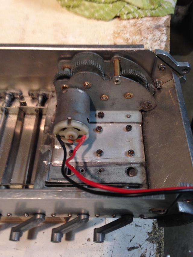

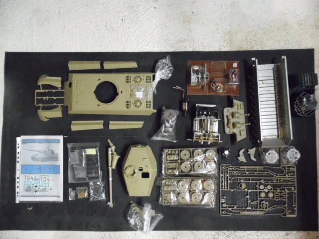

So I'll show you, my modest transformation from a 1st generation KT Tamiya.
Here is what I started from !!

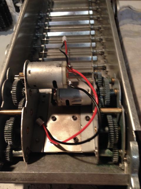

engine adaptation, Heng Long

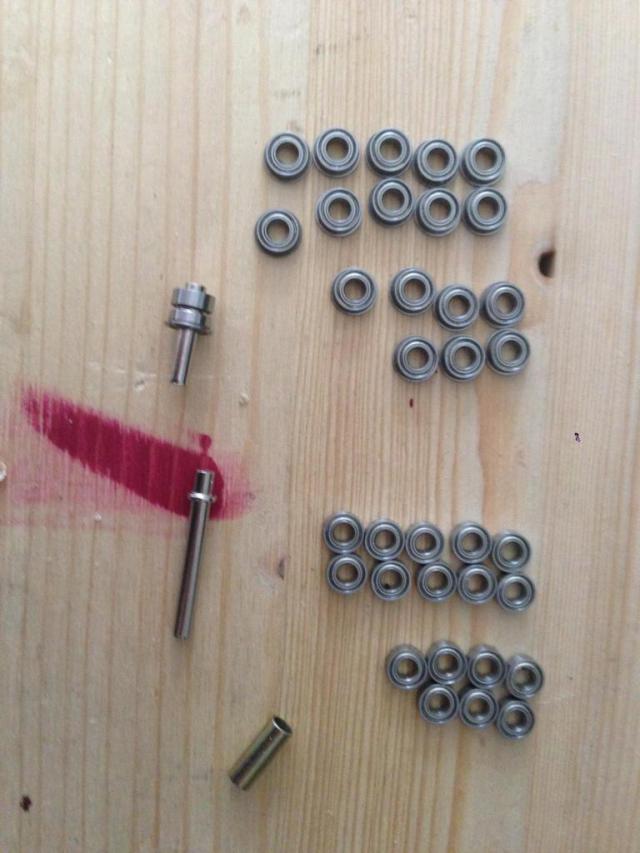

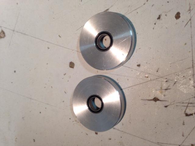

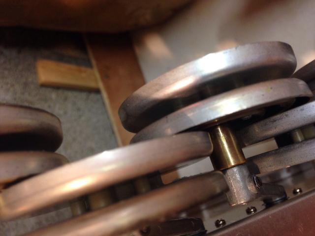

running gear, bronze bushings, replaced by ball bearings,

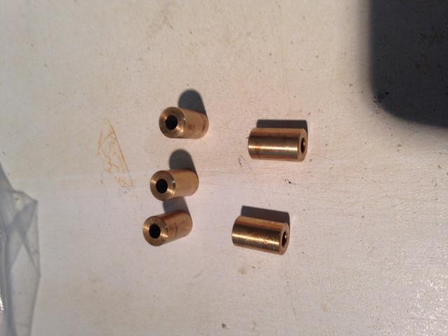

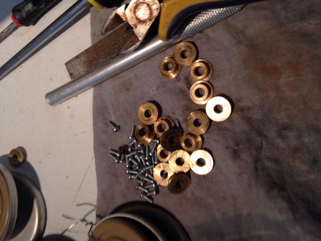

Realîstion (by a friend) of brass spacers rings, and bearings supports, axles outputs boxes

I need to do this as well to a Gen 1 KT hull.
What were your bearings used on the running gear?
For the axle shaft assemblies, is the flanged bearing on the inside and with flanged side towards the hull?

Hello Jarlath :)
I had found these bearings on Ebay (china) but dating from 2015, the link in my possession is no longer valid, sorry. I will try to find it differently.

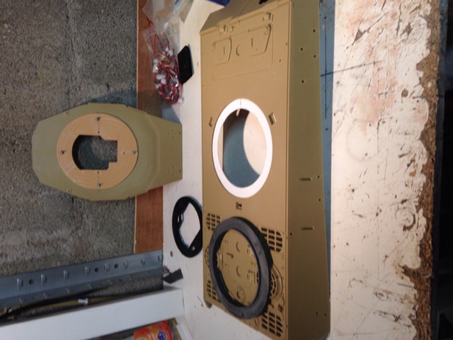

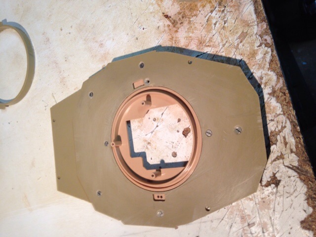

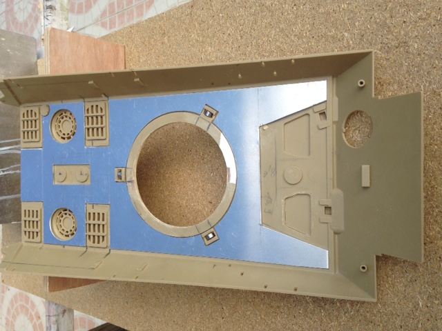

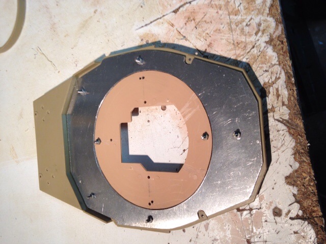

Hello everyone,
fitting the brass spacer rings on the roller axes
reinforcement of the upper frame
HL crown adaptation on upper frame, and turret well base plate
