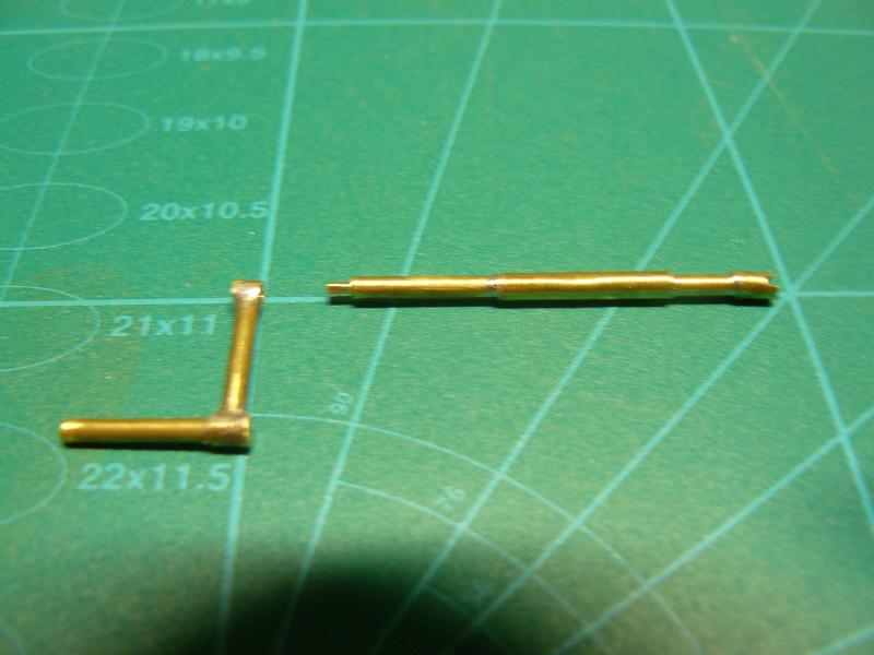

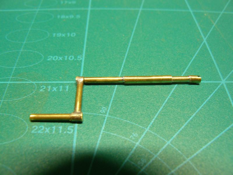

Why not make with brass tube of different dimensions?

Get some thin walled brass tube to the correct outside diameter. Then get some genuine piano wire that's a good fit in the brass tube.
Make a sharp 90 degree bend in the piece of piano wire.
Cut two bits of brass tube, the long length, and the shorter length that make up the main part. Cut one end of each tube to a 45 degree angle. Cut a small slot in the other end of the short brass tube, the side which is longest. The slot needs to be the depth and width of the piano wire.
Now fit the two tubes on the piano wire to make the angled/mitered ends meet, the tubes may need tweaking depending on how sharp the piano wire is bent.
You can either glue or solder the long tube on the wire which should be cleaned.
Now bend the piano wire sticking out of the short brass tube 90 degrees and causing it to bend into the slot. You will have to hold the short brass tube at the base of the slot to achieve this and not cause the wire to make the slot deeper and altering your dimensions. Glue or solder the short bit of tube.
Now you can fit the last bit of tube for the handle, again, glue or solder it on.
It would be easier to have the piano wire a little longer while doing this, then trim and clean later, but if you use solder, you can have it shorter to plug up the ends of the tubes.
You can however purchase small diameter bendable brass rod from model suppliers, but I don't know how well they bend, especially tightly. But I know piano wire is good for bending, especially small diameters, even cold.
You can also add on other bits of thin walled tube to make it more detailed like Jofaur86 shows.
