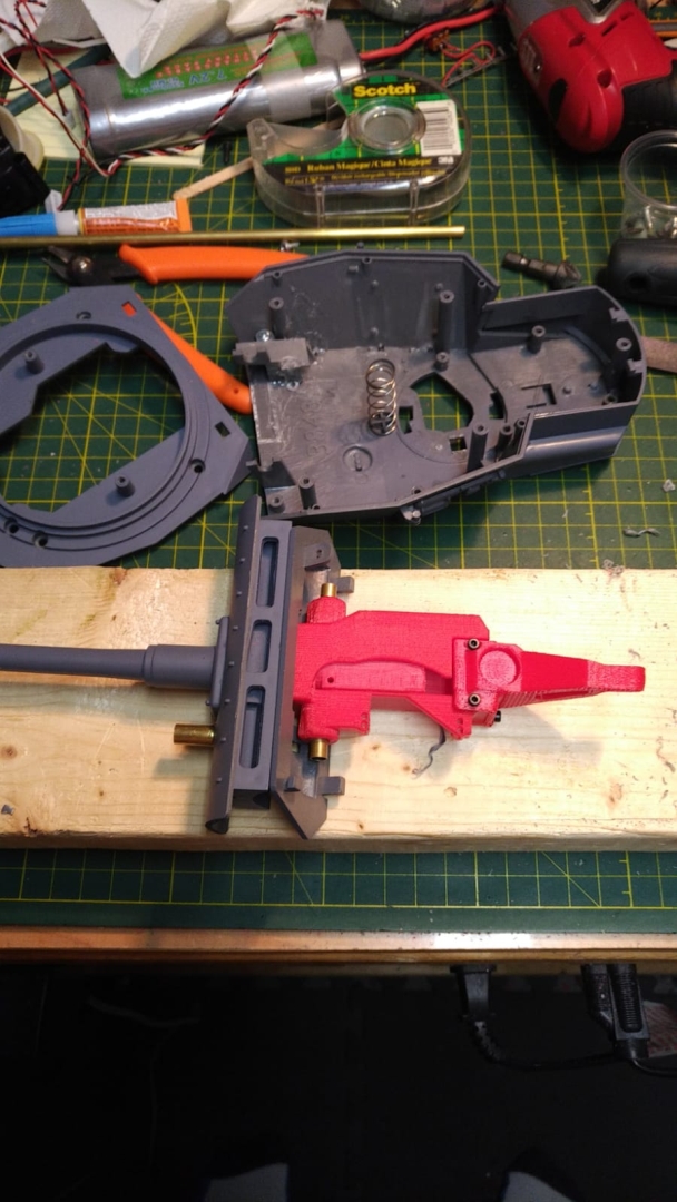

15. rebuild BB unit/mantlet with JCC Recoil unit (& non-std servo, I'm awaiting a shipment) and add IR tube to mantlet.

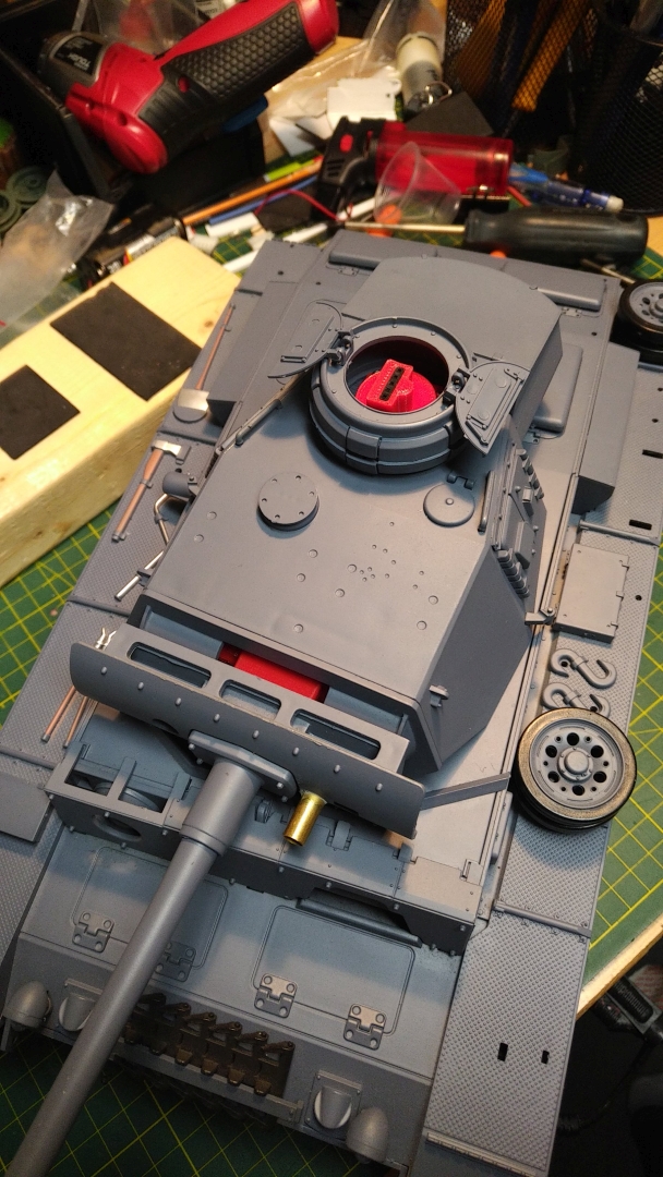

Bottom tested onto the turret. JCC Recoil unit!

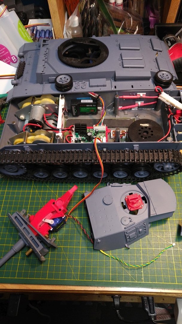

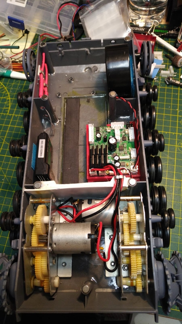

RX, TK-40S, Speaker wired up

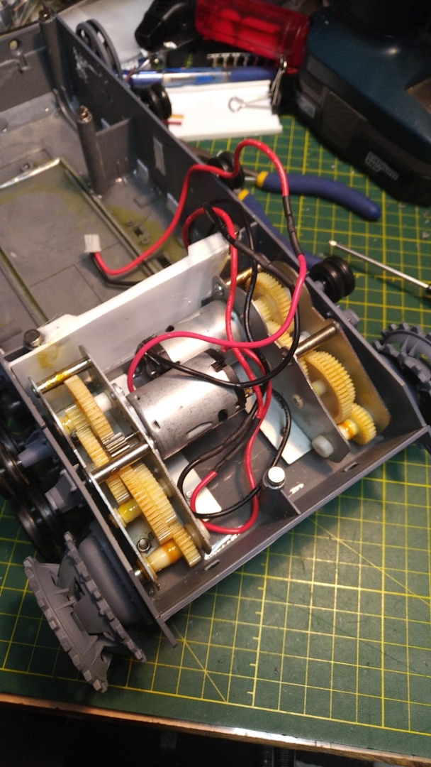

Original plastic motors mounted. Zero movement in hull.

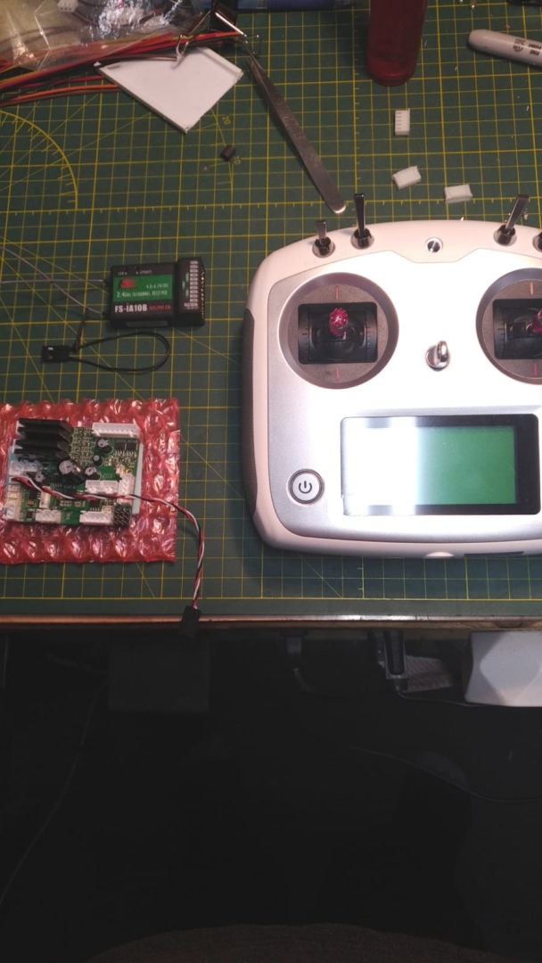

TK-40S & FS-I6S TX/RX to be installed.

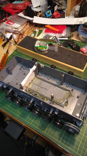

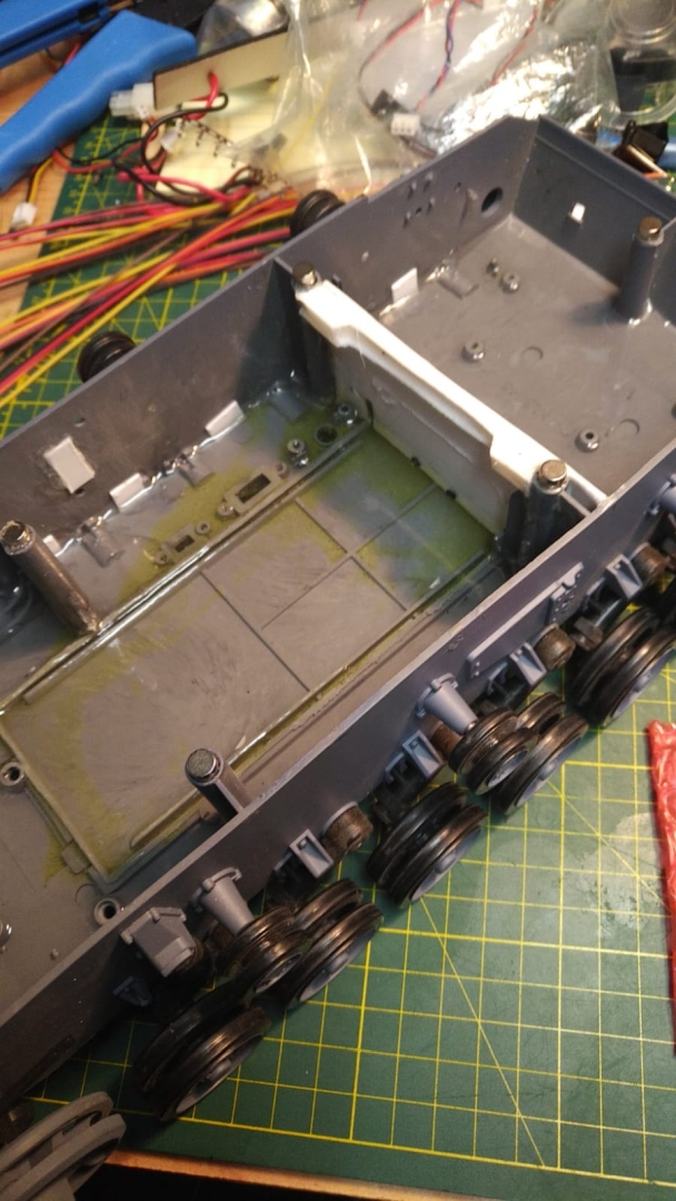

Resin bottom poured in place for motor mount strength and mounting surfaces.

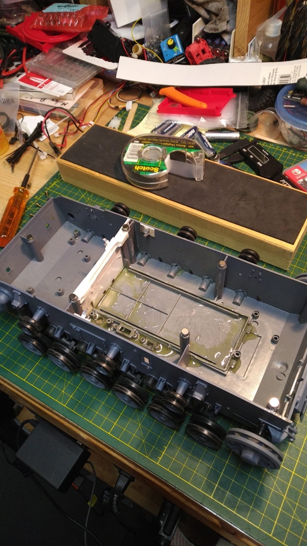

PZ III Stripped with Battery box epoxied in.

Lots of room at the back. Is it nose down at all, with all the weight at the front?
Jarlath
Posts: 413
Location: Ontario, Canada
Re: Quick IR battle upgrade - Panzer III
Post by Jarlath »
The plastic gearboxes help. Would definitely be more front heavy with even pot metal gearboxes... Battery sits on the foam pad which helps distribute mass.
If it does seem to be a tad front leaning, I'll just adjust the second set of swing arms to be a tad stiffer.

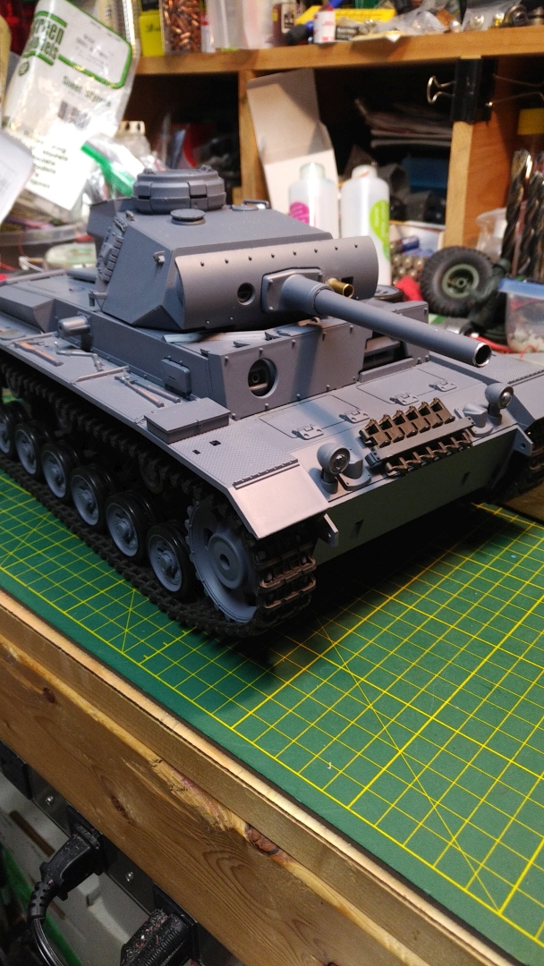

Completed the PZ III upgrade to be an IR Battler. Very basic setup. No smoker, stock speaker, no Flash (neither LED nor HID). Stock driveline.
The stock tank had no MG wiring either, which was odd IMHO, but <shrug>. I can always add them in later (along with barrel flash).
I tested and setup everything. Proper servo direction, medium Tank IR Battle setup, No more Super Spin (YAY!), IR hits and takes hits.
Many thanks to DGSSelkirk for the having the TK-40S and FS-I6S available on such short notice and allowing me to acquire them.
Accessories and painting to left to the owner (Not me).

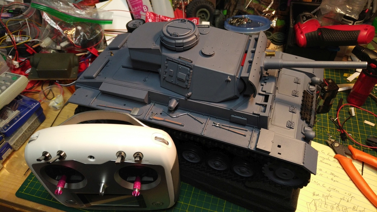

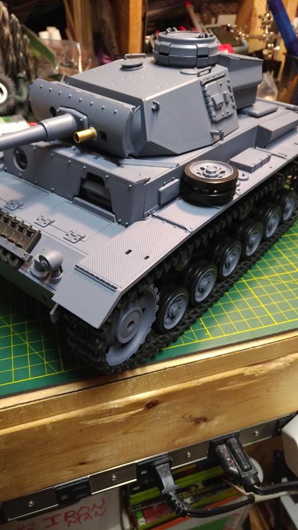

The complete unit with FS-I6S TX.

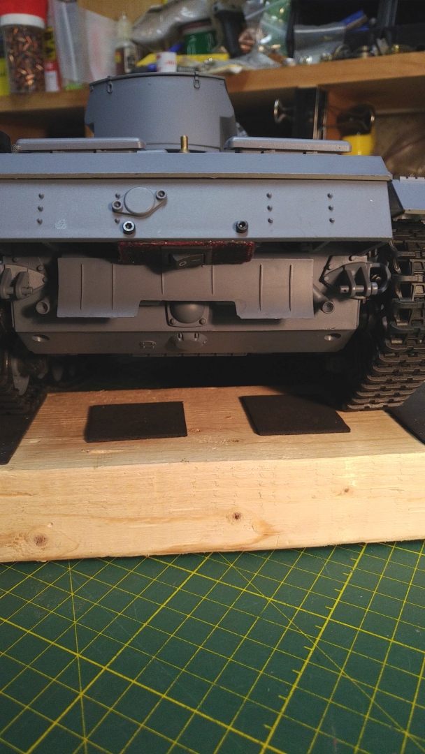

The main power switch with the only external items visible (the 2 screws, which are not really necessary)

Tank front 3/4 view from left side of tank.
Tank front 3/4 view from right side of tank.

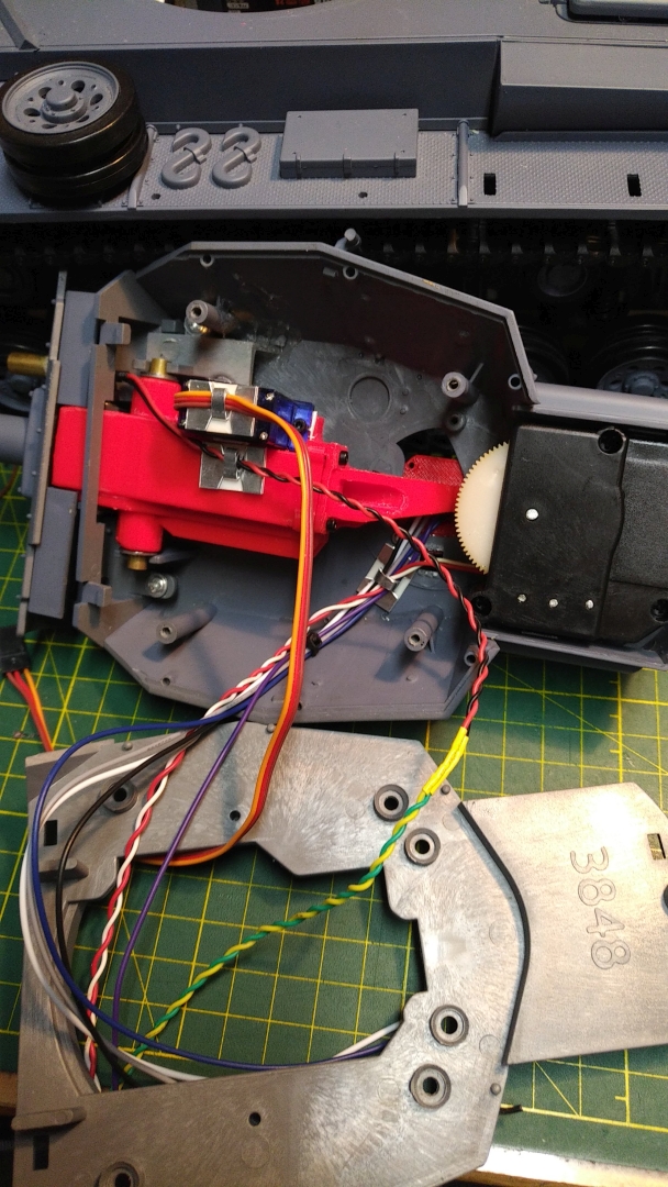

The JCC Compact recoil unit installed, IR cable pivots with the unit.
