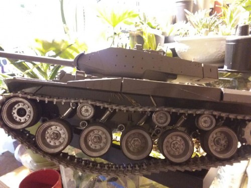

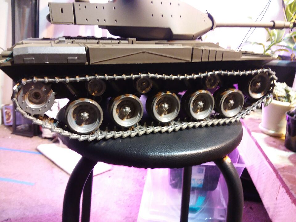

Well that was several painful hours for the thumbs & forefingers! Those pressure fitted knurled posts are no joke! Oy! Ended up using a cotter pin from an rc car to lock the spring in the depressed position while holding the piston out in order to finagle the receiver onto the post... After I reamed the receiving portion of extra metal (which I found out the hard way!)...
But, 74 tank treads for both sides, some tightening of the drive wheels, and those shocks rocked my tank!! Tread didn't derail once, and I ran it through some choppy forest. Runs like a dream now!! All the wheels still articulate, and it is a bit too springy now, but I'm not worried about it as there is more metal coming.
A couple of pictures for the occasion.
